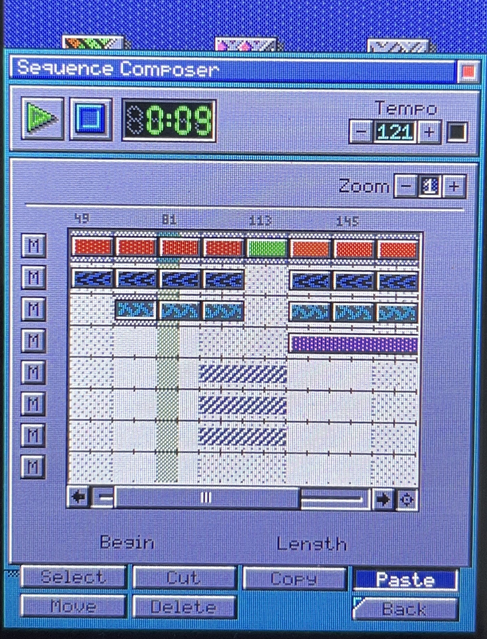

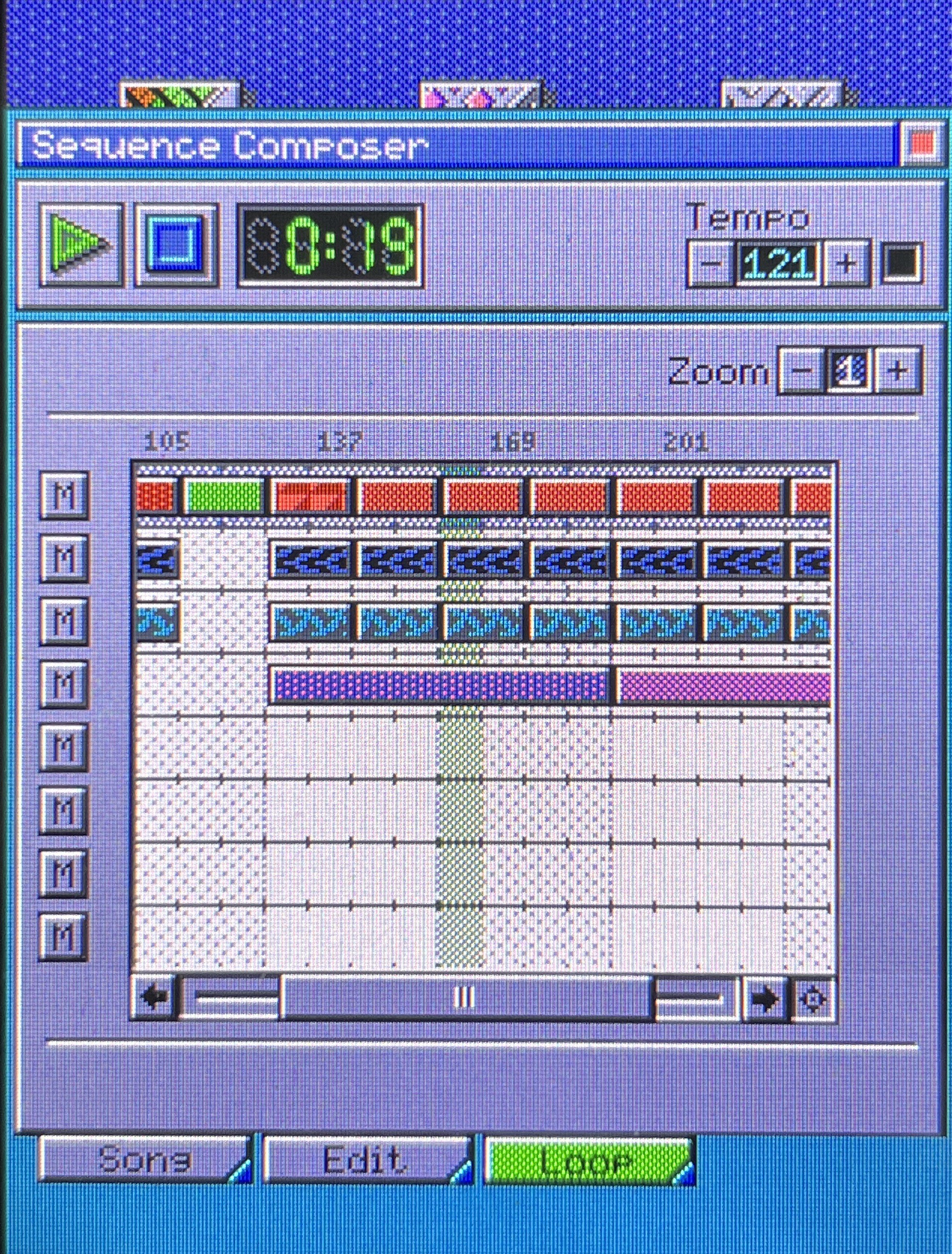

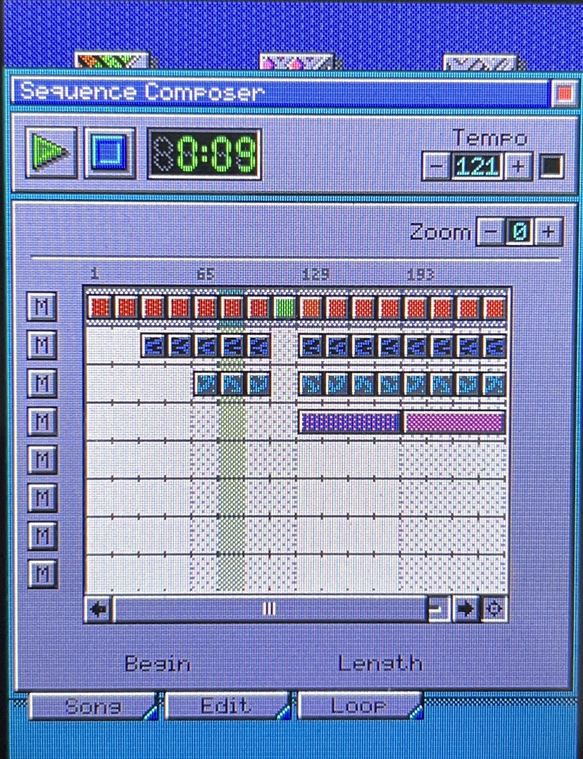

Today's log will be about the new composer module. In the past I think I already mentioned how the composer has become the most legacy part of the OPL Studio code and that it was due for an update. Now it is finally time to talk about this as I've made some great progress on the new composer.
I started really optimistically with the kind of mindset that every manager in the tech field has these days: "I'm going to use AI and all the work will be done in 2 weeks!!". And sure enough things progressed really quickly. I asked the AI to generate the code for all the algorithms I needed to build songs from sequences. I asked the AI to generate the code for some new playback routines. I asked it to generate the code I needed for the editor. It all looked very convincing and the small issues that I found were quickly fixed. But as soon as the implementation had to move on from just the basics of the composer and playback to something more advanced things started to fall apart. The code was turning into slop and it was getting out of control quickly with some very fundamental bugs. I ditched the AI and all of its code. It was time to take over the wheel again and face the reality that it would be some very challenging code to write...
The most challenging part of the composer to write was the new workflow. In the old composer sequences are dropped into the song by clicking on a track and then you're more or less stuck. You can't move the sequence, let alone move multiple sequences. And copying / pasting is done more or less blindly. This makes for a very clunky user experience and a frustrating workflow where you're often spending a lot of time correcting mistakes due to a simple miss-click.
The new composer streamlines the workflow of creating songs mostly thanks to its drag and drop capabilities. You can now select a bunch of sequences and as you move them around the song the composer grid will show you a ghost of your selection so you're no longer working blind. This also counts when pasting a block into the song, you now know for certain where you're pasting your selection. Which also helps is the new zoom control for the composer grid. You're no longer restricted to an extreme close-up of your song which makes editing a lot simpler.
Another improvement in the new composer is that it can now switch between the sequence editors and the composer without having to close the app. For example if you're adding an empty sequence to the song it will launch the drum or melodic sequencer depending on the type of sequence that you're adding. Once you're done creating the sequence and you close the editor you will return to the composer with your new sequence added to the song. Also if you're not happy with one of your existing sequences, simply press the edit button to launch the editor without having to close the composer first.
Thanks to the improved handling of the playback routines, OPL Studio will also better handle playback in the background. You can play the song from the composer or a sequence in a sequence editor and open the patch editor to tweak some of the instruments, or get into the synthesizer setup to change some synthesizer parameters and immediately hear the result.
It will still be a few weeks before the composer is ready. As you can tell from the screenshots the UI is not ready yet and there are still some bugs that need fixing. The upcoming release will also fix some of the bugs from the current v2.5.0 that are fixed as part of the composer branch. Since I initially thought it would be a quick development cycle I didn't put these fixes into separate branches to get them released quicker.

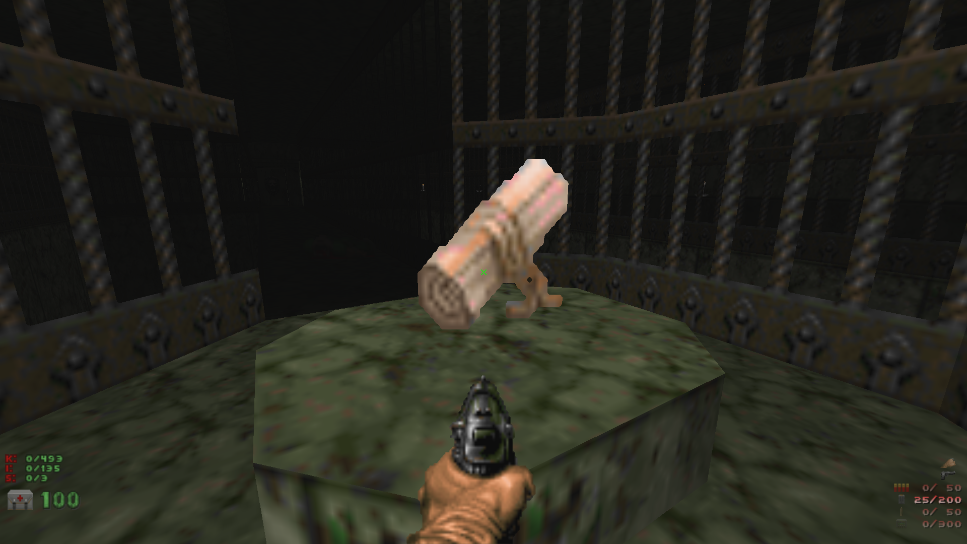

When you have OPL Studio connected to your PC you can select it as a MIDI device in GZDoom. However in older OPL Studio versions the DOOM music, which a lot of us probably know very well, would sound off. Just a few seconds into E1M1 when the first pitch bends happen the music would break and sound terrible.
This is now fixed in this software update, but it requires chaning a setting on the MIDI settings panel. The problem is that GZDoom is not resetting the pitch bend, or it's assumes that pitch bend is reset on key release, while OPL Studio uses a continuous pitch setting.
In order to have proper pitch bends in GZDoom go to Settings > MIDI and disable the 'Continuous pitch bend' checkbox.
What has also changed in the MIDI settings is that you are no longer limited to a 1 or 2 semi tone pitch bend. You can now choose from anywhere between 1 and 12 semitones, but 2 remains the default.
And if I can make a little recommendation: get the Dead See Scrolls mod. The music for which was made by Shapeless Cube using OPL Studio.

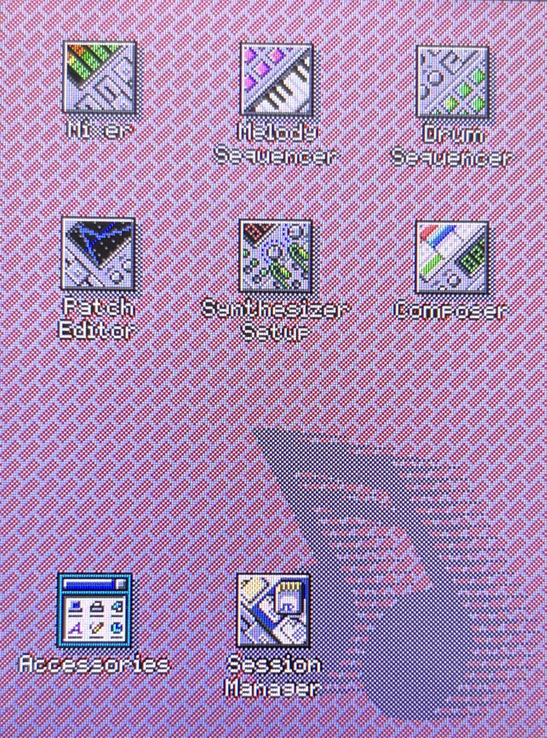

I've added additional background patterns to the display settings that allow you to customize the home screen more to your liking. The new patterns were all taken from the Windows 95 background settings to stick with the theme of the UI.

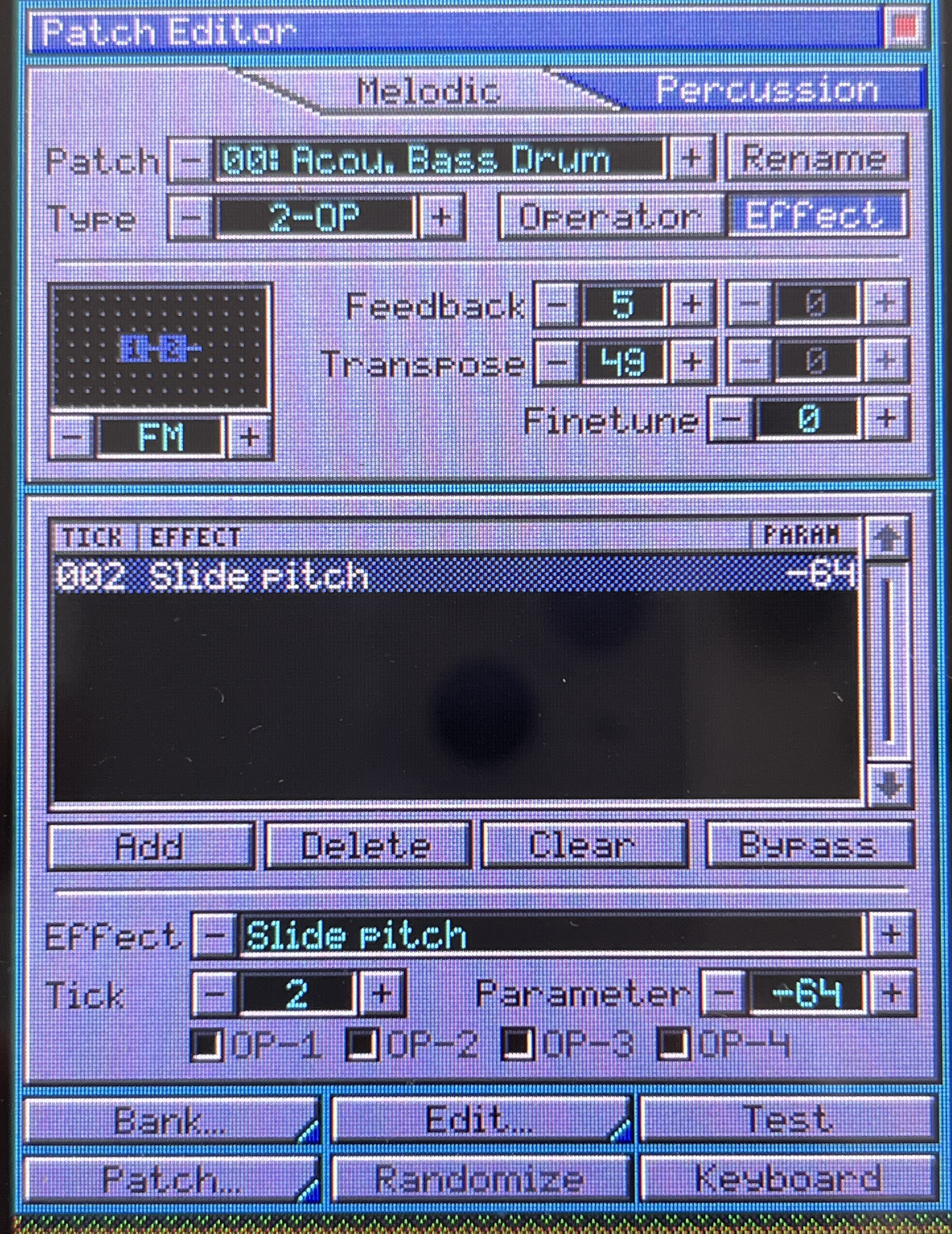

OPL Studio v2.4.0 is here and I'm happy to introduce the new patch editor and most of all the new patch effects feature! The new release can be found on Github and on the website www.cheerful.nl
In the previous log I already talked about patch effects. If you know about Adlib Tracker II macro's then you'll be instantly familiar with OPL Studio's patch effects, but if you're not then let me explain.
Patch effects allow you to create much more complex and better sounding instrument patches, because you can change the parameters of a patch for individual notes while they are playing. A good example of this would be a bass drum. The regular bass drum patch of OPL Studio is a very familiar DOS / Windows 95 / Sound Blaster MIDI instrument that sounds very flat. But thanks to patch effects we can make it much better sounding. We will do this by, after the initial kick, quickly lowering the pitch of the drum note. Something you may be familiar with if you ever listen to C64 SID tunes or other chip tune music.
When a note starts playing it gets assigned a tick counter which is incremented every 1/60th of a second. If the patch that's being used by the note has an effect, or multiple effects, that should be applied on the current tick then OPL Studio will update the OPL parameters for the OPL channel where the note is playing. This works on an individual note basis and you can still apply MIDI CCs or analog CCs on top of this for the MIDI channel. In other words patch effects allow you to completely change the patch for a note while it's playing!
This may sound very complicated, but once you start to play with it it all starts to make sense.
Of course with the new patch effects the Patch Editor module needed an update. On top of the screen there are two tabs to select between the melodic and perussive instrument banks. This replaces the small slider we had before and it makes room for the editor mode selection where you can choose between the familiar operator ecitor and the new patch effects editor.
When you select the effects editor the screen will change and shows you a list of all the effects that have been set for the patch. The list shows you at which note tick a prticular effect will be applied, the type of effect, it shows you the operator(s) that will be changed when applicable and it show you the value of the effect.
Below the list we have the buttons to add, remove, clear or bypass the effects. This should be clear, though bypass may need a little more explanation. When bypass is enabled (it will show red) all patch effects will be bypassed and you will only hear the basic sound from the operators and any MIDI CCs that you have applied. This can be handy when you're tweaking your instruments.
Nelow the buttons there are the controls to setup the effect. You choose the effect to apply, clicking on the effect name will open a list where you can select from all available effects. Next you can set the note tick where to apply the effect. Notice that as you change the tick your effect will move up / down the list. Finally we can set the effect parameter value and choose the operator where to apply the effect to.

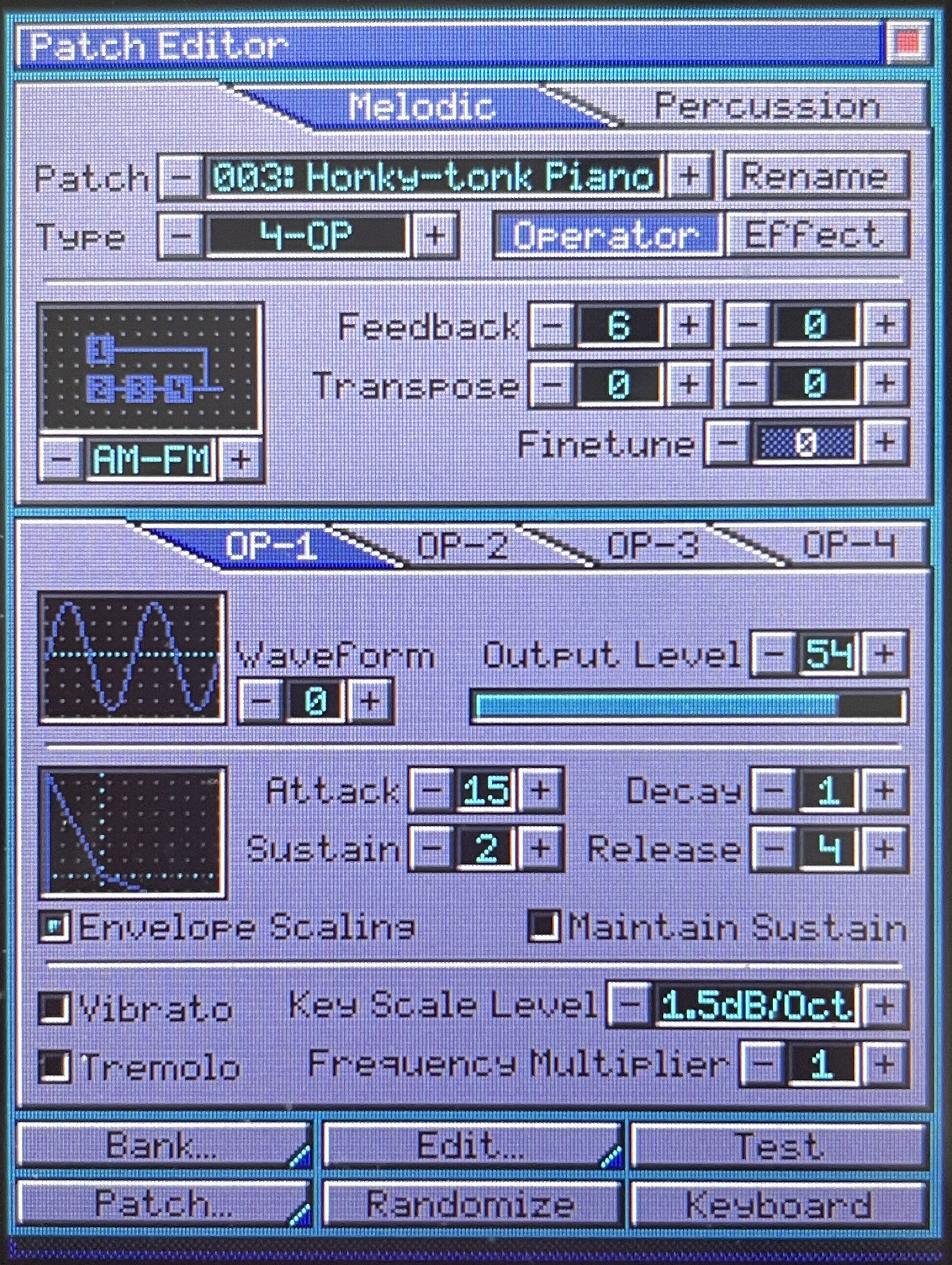

Read more »It's a month since the last update and I'm very happy to announce that the new patch editor is almost ready!
It's had a complete rewrite over the course of several weeks with many small improvements such as the tabbed view to make it more clear that you're working with melodic or percussive patches.
The menu bar at the bottom of the screen is much cleaner now with bigger buttons and sub menus that are indicated by small tabs at the bottom right corner of a button. Now that the menu has been broken up features like loading and saving have also becom more clear. On the old patch editor, for instance, there would be a load and save button that was both used to load/save complete instrument banks or indiidual patches. This has now been made more clear: the 'Bank' menu is used to access functions for the instrument bank such as new, load and save. The 'Patch' menu is used for patch functions such as clear the patch, revert, import and export a single instrument patch.
However the biggest change in the Patch Editor comes from the Operator and Effect buttons in the top part of the window. This changes the editor between the operator editor and the all new patch effects editor.
Patch effects allow you to change patch parameters while a note is playing, similarly to how many trackers work. For instance apply a pitch slide to a patch and every note that is played will have a built-in pitch change without any MIDI input needed.
The patch effects editor shows a list of the effects that have been added to the patch and the order in which they are applied when a note is played. Each effect has a tick, a 60 Hz update tick that starts counting when a note starts playing. On every tick OPL Studio will apply all the patch effects that are supposed to be triggered on that tick. So the list shows you the tick where the effect occurs, the effect to apply, the affected operators and the parameter value to set. This means that you can almost completely reconstruct your patches while they are playing and allowing for some really cool effects!
Now that the Patch Editor is feature complete I will spend some time to test it all and to update some of the related code. For example the OPL Studio session files need to be updated in order to save patch effects. There will also be two new file types for OPL Studio banks and individual instruments to handle the patch effect data.
