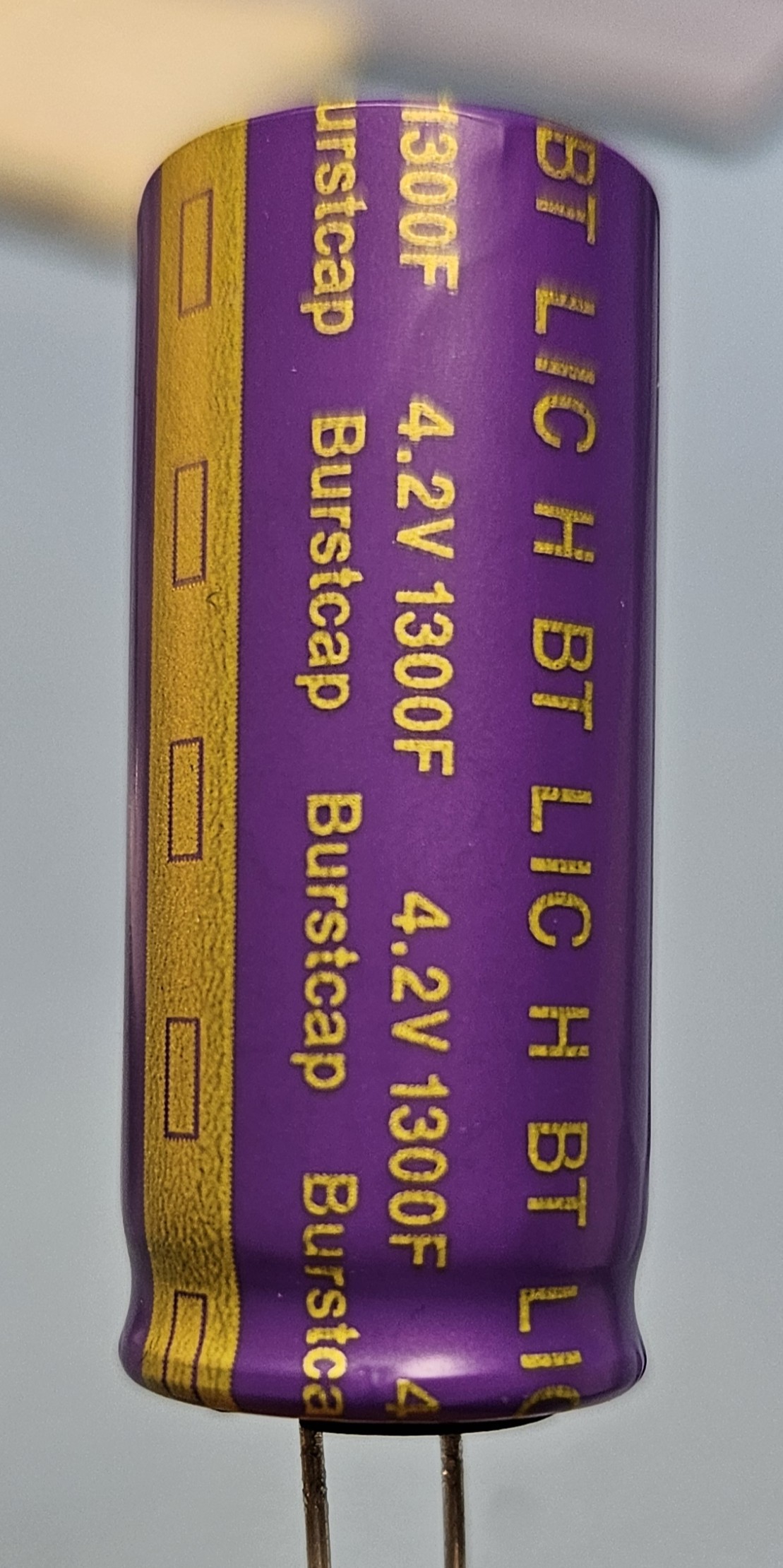

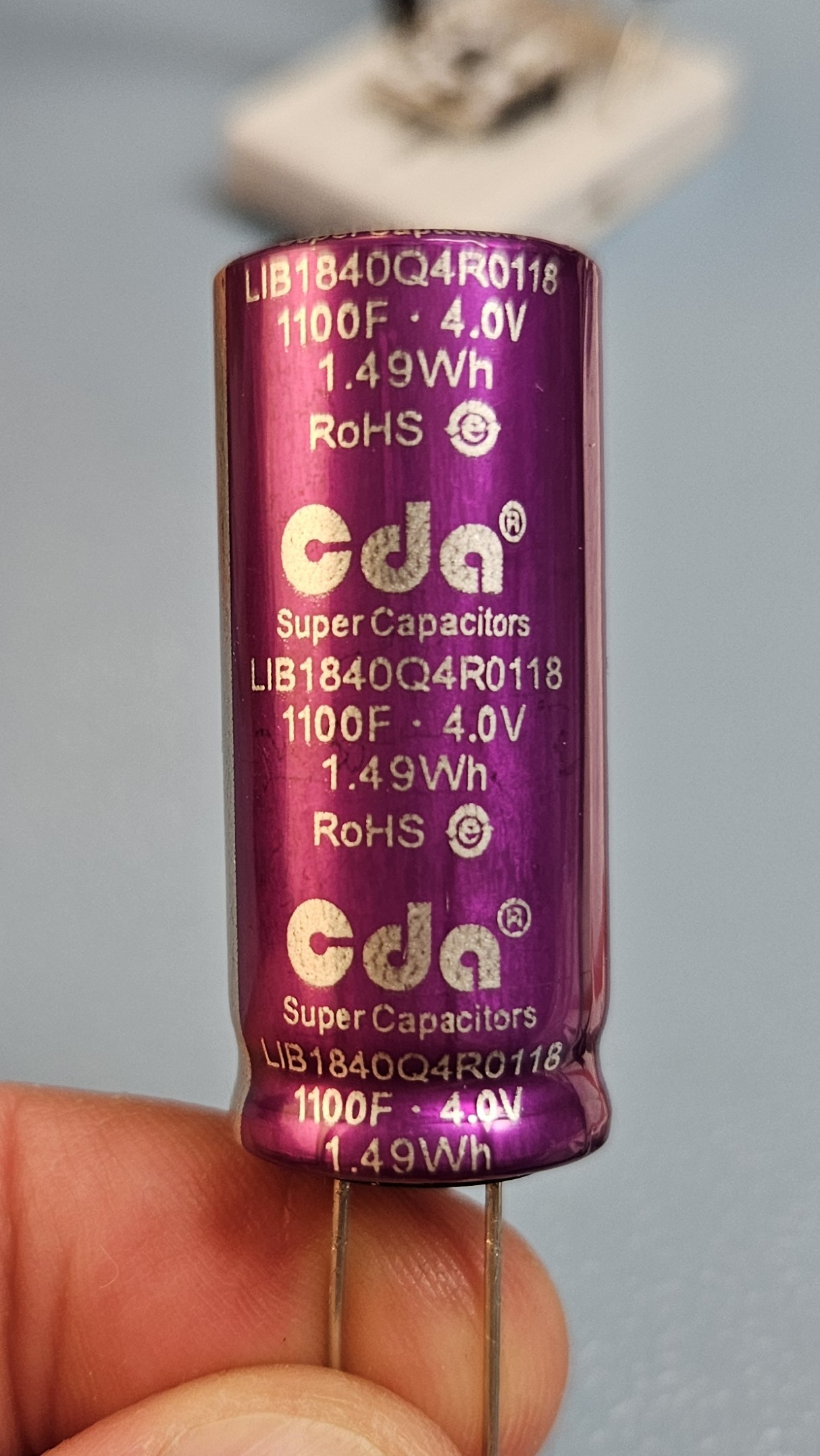

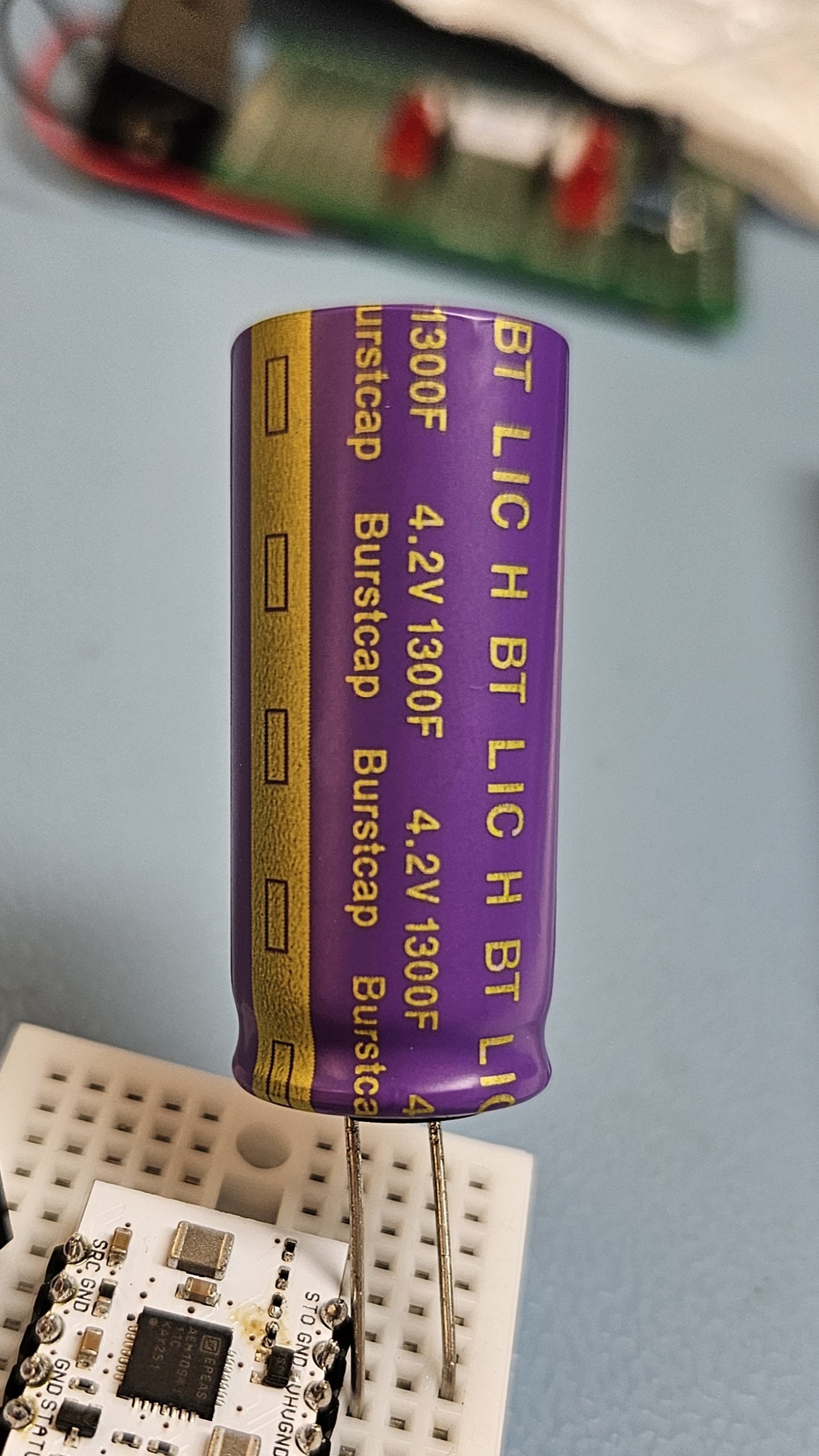

    Previously Lithium Ion Capacitors (LICs) were 3.8V, however recently there are 4.0V and 4.2V LICs, and they have huge capacitance 1100F and 1300F. In another log I have tested capacitance and leakage of these huge LICs.
    Cda LIB1840Q4R0118 1100F 4.0V
     BT LIC1840H4R2C1300 1300F 4.2V

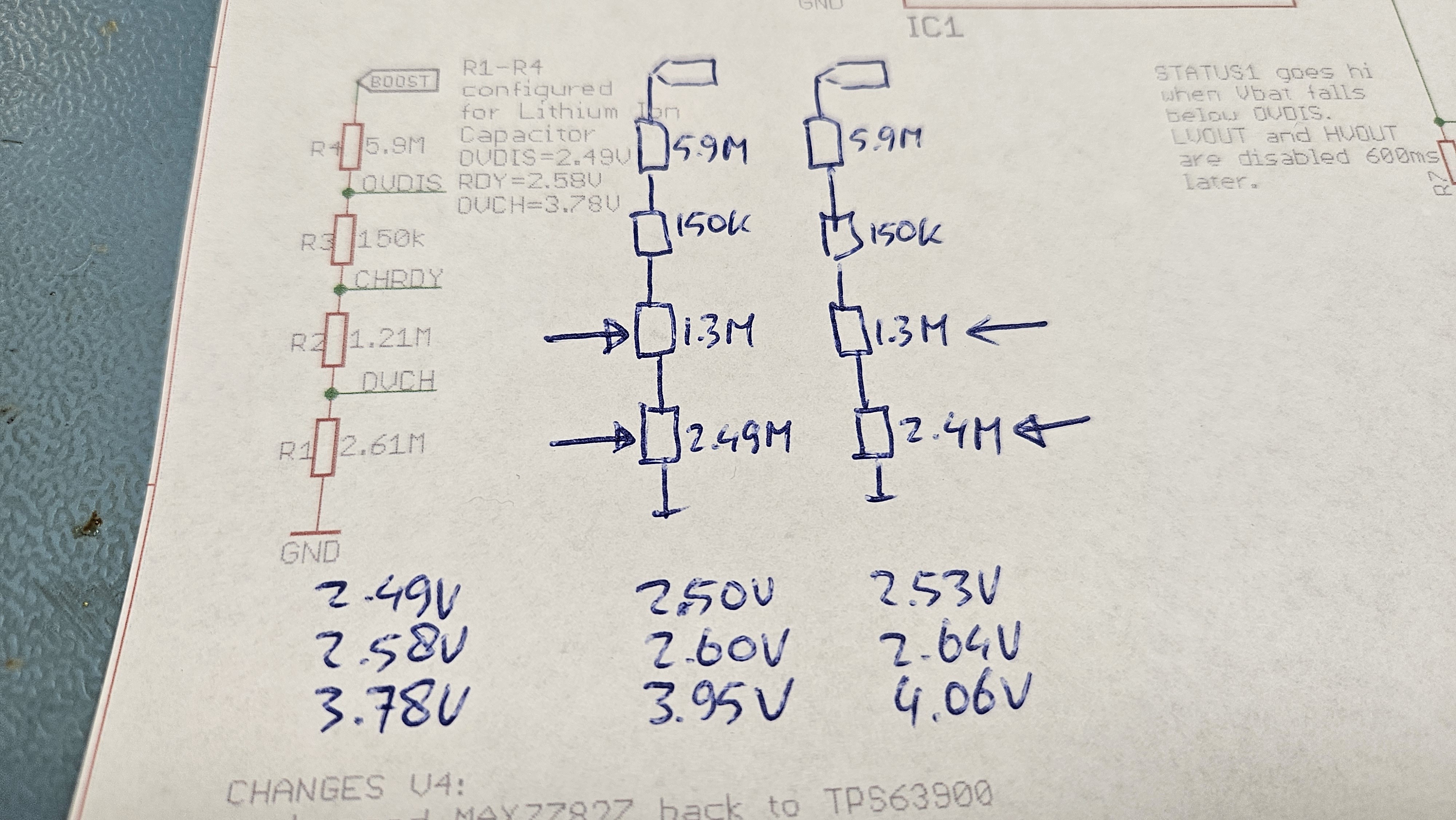

    In AEMLIC the charge voltage is set using 4 resistors and the values can be calculated using a spreadsheet found on E-peas AEM10941 product page. To test charging to a higher voltage I have adjusted a AEMLIC resistors R1 and R2.
    to following values
    In picture above) you see the disable voltage (~2.50), the enable voltage (~2.6V) and the charge voltage (~3.8V or ~4.0V or ~4.2V) and the resistor values. Always use 1% resistors. I have tested and confirmed AEMLIC is able to charge to these voltage levels. I do not recommend changing these resistors because you need serious soldering skills for these 0402 size resistors. I don't support questions about changing these resistors.

    There are newer Lithium Ion Capacitor (LICs), with higher voltage than the 3.8V LICs I had tested before. Manufacturer Cda calls the 4V variant the LIB series and it ranges from 200 to 1100F. And I recently ordered 4.2V LICs that are 350F and an 1300F. I compared capacity, ESR and leakage current of 5 large LICs. To test capacitance I used my electronic load to discharge them at a constant 750mA down to 2.5V and I could read the capacity (mAh) from the display. I converted LIC specified capacitance (farad) to capacity (mAh) using the formula Q= C * V / 3.6.
    To measure the leakage I measured the voltage decay over the days with a bench multimeter. After 72 hours I calculated leakage using the formula I(A)=C(farad)*(yesterdaysvoltage[V]-todaysvoltage[V])/t[s]
    BT LIC-H-1840Cda LIB1840Q4R0118Cda LIB1330Q4R0357Cda LIC1840Q3R8757Vinatech VEL13353R8257G
    Capacitance  specified (F)1300F 4.2V1100F 4.0V350F 4.0V750F 3.8V250F 3.8V
    Calculated capacity (mAh)613mAh458 mAh145 mAh270 mAh90 mAh
    Measured capacity (mAh)668 mAh550 mAh136 mAh273 mAh96 mAh
    diameter, length (mm)18,4018,4013,3018,4013,35
    ESR specified90 milliohm65 milliohm100 milliohm60 milliohm100 milliohm
    leakage specified-23 uA4uA23 uA5 uA
    leakage measured >72h31uA11uA4uA13uA5uA
    Price€10.29 qty1€8.61 qty1€5.67 qty1€8.46 qty1€6.76 qty1
    Conclusion: The capacitance is amazing and the leakage of the Cda and Vinatech is low enough for very low power applications. I definitely recommend using these.
