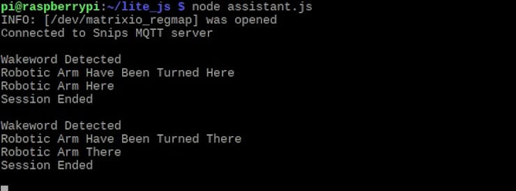

    TEST

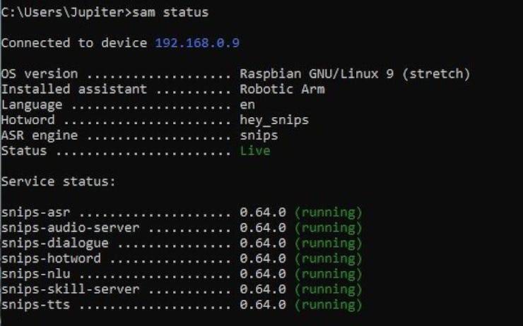

    Before we start to do tests, we need to do next actions:
    On your Raspberry Pi type node assistant.js
    On your computer's terminal type sam status and sam watch
    Congrats! now you can test your robotic arm

    The prototype worked very well, and is very useful to develop more complex actions with the robotic arm. however, I also had some difficulties such as:
    • The board worked very well with 5 servos and when I used 6 servos the system was collapsed and the robotic arm made strange movements. Also in the servomotor configuration I changed to the value of: min_pulse_ms: 0.2 and the robotic arm worked much better.
    • As I explained at the beginning of this tutorial, I had problems configuring the audio board, but this was successfully solved and now the MATRIX Creator board is very efficient even when it receives keywords at half a meter.

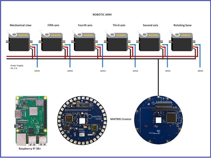

  • Step 7. Wiring the Robot Arm
    Guillermo Perez Guillen06/28/2021 at 02:17 0 comments
    Below you can see the electrical diagram with the connections of this project, it's recommended to do it patiently so as not to make mistakes because there are many cables to be connected.
    I suggest you not wire the servo 5, since in the tests I carried out the system collapsed when I connected the six servos. Then I decided to disconnect the servomotor that was less used.

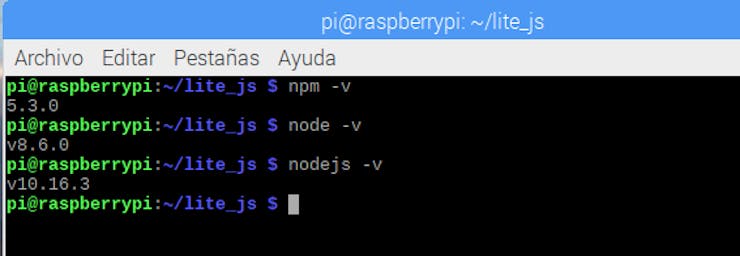

    Setting Up the Hardware
    Once everything is well installed on your Raspberry Pi board, You can check the versions of: npm, node and nodejs.
    In my case, I had two serious problems with the configuration of my hardware and these are the solutions:
    FIRST SOLUTION: to activate the pcm.speaker, I had to add a rate of 16000 in the assound.conf file.
