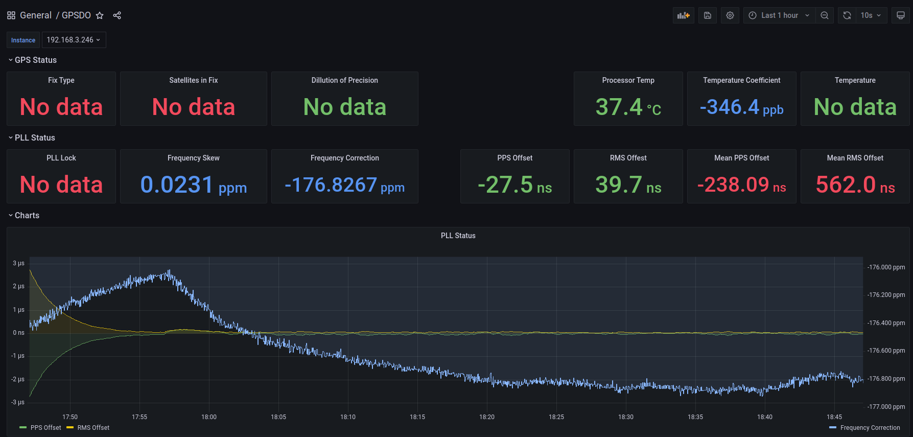

    $ echo -n 'gpsdo' | nc -uW1 -w1 #.#.#.# 23
    pps locked: yes
    current offset: -88 ns
    mean offset: -17.6 ns
    rms offset: 42.9 ns
    frequency skew: 0.0215 ppm
    frequency correction: -175.9287 ppm
      - pll trimming: 0.0839 ppm
    compensation: -176.0126 ppm
      - temperature: 37.834 C
      - bias: 37.230 C
      - coefficient: 0.4296 ppm/C
      - offset: -176.2722 ppm

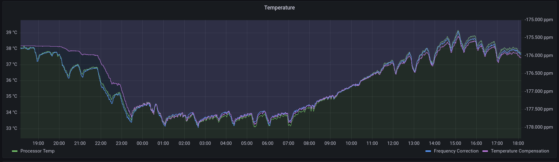

     Temperature Compensation Settling:

    Robert Rouquette05/28/2022 at 23:49 0 comments
    I've implemented SNMP and the GPSDO logic.  The software is currently using the frequency trimming support in the PTP hardware to under-clock the PPS and steer the edge alignment.  Otherwise, the temperature compensation and PLL logic are working as expected.  I still need to make a breakout board for the DXCO and I2C temperature sensor.
    Temperature Compensation:
    PPS Tracking:
    Comparison against GPS NTP server:
