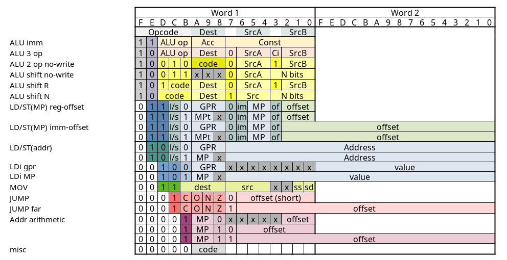

  • General update on the ISA
    Pavel03/07/2026 at 09:23 0 comments
    As I mentioned in previous post, I came up with idea of combining shift operations with arbitrary rotations into a single unit. This leads to reconsidering instruction encodings, and the update is needed to be made here to make their descriptions up to date.
    I also have take a look into other instructions, and saw the possibilities for improvement in several places.
    I am teetering on the verge of making decision of narrowing memory addressing to 24 bits, this will also lead to slight adjustments in memory transfer instructions.
    Here is preliminary overview of updated encodings:
    There will be updates in blog posts corresponding to each class of instructions with new encodings and descriptions.

                  Instruction bits
    Mnemonic:     F E D C  B A 9 8  7 6 5 4  3 2 1 0
    SETIM #M      0 0 0 0  0 1 1 1  m m m x  x x x x    Set interrupt mask #M
    CLRIM #M      0 0 0 0  0 1 1 0  m m m x  x x x x    Clear interrupt mask #M
    SETPR #P      0 0 0 0  0 1 0 1  p p p x  x x x x    Set prefix #
    EINT #I       0 0 0 0  0 1 0 0  i i i i  i i i i    Enter interrupt #I
    DMA           0 0 0 0  0 0 1 1  x x x x  x x x x    Direct memory access
    RESET         0 0 0 0  0 0 1 0  x x x x  x x x x    software cpu reset
    HLT           0 0 0 0  0 0 0 1  x x x x  x x x x    halt execution
    NOP           0 0 0 0  0 0 0 0  x x x x  x x x x    empty operation

    a - bits of Memory Pointer pair index, PC = 00, SP = 01, FP = 10, BP = 11
    r - bits of register address (X) that holds offset value
    o - bits of immediate offset value
    x - "don't care" bits - have no effect on result
  • Immediate loads
    Pavel10/23/2022 at 08:43 0 comments
    Loading hard coded value into one of the registers.
    The instruction is 2 words (32bit).
    There are 2 types of this instruction - one for loading a word (16bit) into General Purpose Register, and other for loading a double word (32bit value in range 0x00000000 - 0x01ffffff) into a pair of Memory Pointer registers.
    Here are layouts:
                         Instruction words:
                         bits of word #1      bits of word #2
    Mnemonic:            FEDC BA98 7654 3210  FEDC BA98 7654 3210
    LDir rX 0xffff       0010 0ddd xxxx xxxx  vvvv vvvv vvvv vvvv
    LDim MP 0x01ffffff   0010 1ddv vvvv vvvv  vvvv vvvv vvvv vvvv
    d - bits of register address (X or MP)
    v - bits of data value to be loaded
    rX - General Purpose Register #X
    MP - Memory Pointer register pair, one of Program Counter (PC), Stack Pointer (SP),
     Frame Pointer (FP) and Base Pointer (BP)
    There are no corresponding Store Immediate instructions, as it is has no practical use -- the write will be into program area at address that cannot be readily predicted and utilized at code writing time.
    General layout of instruction types
