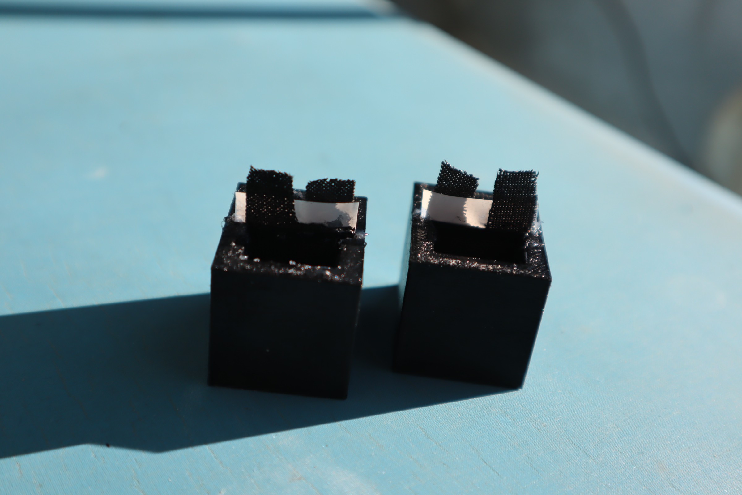

    Part 1: Flow Cell using a PH gradient
    This flow cell generates electricity by differences in electrode potential in manganese dioxide over a PH gradient, like a fuel cell that uses acids and bases instead of oxygen and fuel. This type of technology, albeit probably with different electrode materials optimized for the task, is being investigated for use in concentration gradient cells for collecting power from salinity gradients at the mouths of rivers as they feed into the ocean.
    To build one, you just need to separate two bodies of water with a membrane which restricts the diffusion rate, then place the two electrodes on each side of the membrane, as close together to each other as possible. In the above paper and in our implementation, this is done with carbon fabric and a Celgard 3501 nonselective membrane held close together by a frame for mechanical reinforcement. In the paper this was chosen because it is more cost-effective and robust than ion-exchange membranes used for the same application, at the cost of some efficiency. If you do choose to use an ion exchange membrane instead of Celgard, the rest of the instructions are the same, just make sure it never dries out once assembled, or it may deform and tear or form microcracks.
    The container for the bodies of water can be any shape, size or configuration as long as the membrane and electrode materials are cut to size and the electrodes can be electrically contacted (ideally in a way that keeps the electrical contacts from getting wet with the electrolytes, which may corrode the contacts). For best results, the membrane and electrode stack should seal well to prevent any leaks between the two bodies of water from going around their edge: in our implementation we do this with silicone. We have provided some 3D models to construct the following example system:
    This device holds some acidic and basic water in two compartments, with a separator in between them. The carbon fabric electrodes have very different electrode potentials in the two solutions, and the membrane allows ion conduction, producing power in a manner similar to a fuel cell. The preparation is simple, but with a few nuances worth mentioning:
    1. Prepare the electrodes
      1. The electrode ink recipe is the same as described in part 3 of these instructions. It may be easier to prepare in larger batch sizes depending on the sensitivity of your weighing scale. The ink needs to be shaken before each use, making sure to thoroughly break up any clumps. Also make sure you store the ink in a container that will not allow the acetone to evaporate over time, and/or mark the acetone level  with a pen for long-term storage so the ink can be reconstituted.
      2. Cut the conductive carbon fabric to size. For our system that ends up being 20mm by 20mm square, but you'll want to leave a tag roughly 5mm by 5mm above the main electrode to serve as an electrical contact. It may be easier to cut the carbon fabric at 45 degrees to the way it is cut when received, because this helps prevent fraying which can lead to shorting of the electrodes in later steps in the assembly.
      3. Seal the electrical contact tag: once wet the carbon fabric can wick water up to the electrical contacts, where evaporation and corrosion can produce a false signal. To avoid this we apply a few drops of superglue at the interface between the 5 by 5 mm tag and the 20 by 20 mm electrode surface. This ensures the capillaries between the threads are all sealed up, preventing wicking.
      4. Shake the ink thoroughly before applying it to homogenize, then with a pipette or eye dropper, apply 4-5 drops per 20mmX20mm electrode surface and spread it to coat evenly. Then allow the freshly prepared electrode to dry.
      The process should look something like this:
    1. Assemble the remaining components
      1. The separator membrane should be cut slightly wider than the electrodes to help prevent shorting between the electrodes. If the electrodes are a little too big, you may want to trim them and stack the separator and electrodes to check that the separator
      2. 3D print the provided frame and container files.
    2. Assemble the cell
      1. Stack the cell components: frame, electrode, separator, electrode and frame.
      2. Carefully
        apply a small amount of silicone around the edge of the assembly, avoiding the electrical contacts. Make sure not to get any silicone on the exposed electrode surfaces. It may be prudent to allow this assembly to dry for a few hours before proceeding, so that it holds together when being inserted into the container, but it isn't so dry that the silicone has the chance to delaminate when sheared.
      3. Apply a bead of silicone to the groove in the container.
      4. Insert the frame assembly into the groove in the container.
      5. Allow the assembly to dry for 1 hour then test for water tightness (the electrodes will initially be hydrophobic). If there is a leak, add more silicone where needed. It is better to do this before the other silicone dries completely, to ensure a strong mechanical joining.
      6. Allow the silicone to fully dry overnight.
      7. Apply a small drop of dish soap to each electrode. This will get the carbon fabric electrodes to wick water when the acid and base solutions are added.
    3. Add Solution and measure results
      1. Prepare two solutions, one of sodium hydroxide and one of acetic acid, both at 1 M concentration. You will want approximately 20-25 mL of each solution
      2. Carefully use a pipette to fill each side of the flow cell with different solutions.
      3. Allow the electrodes to soak up the solution.
      4. Attach alligator clips to each of the electrodes and measure the voltage
  • 2
