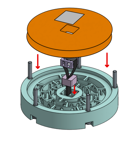

5Part 3: Bipolar Membrane Flow Cell
The Bipolar Membrane Fuel Cell is designed to take the concepts shown in Parts 1and 2 and apply them to a small battery-like device that outputs minute amounts of power. It should be noted that gloves need to be worn for this, and the work area needs to be clean and free from contaminants. The bipolar membrane device is sensitive to introduced compounds, especially the salts and oils on your skin. If care isn’t taken, it can invalidate the results. All solutions should be prepared with deionized water, distilled or even reverse osmosis water would introduce contamination that would interfere with the results.
- Download and Print Parts for Bipolar Membrane Device
There are four different components used in the bipolar membrane fuel cell. All four can be found in the files section. You will need one top chamber and one bottom chamber, and two electrode frames and chamber caps.
When printing the parts, we used clear PETG. The plastic used is important for this project, it needs to be both impermeable and unreactive. From the testing described in part 2, the clear PETG was the best material found for this project.
We printed on an Original Prusa i3 MK3 printer.
We recommend printing the top and bottom chambers with the interior sections facing upward and supports on the build plate only. It is difficult to remove supports from the interior of the chamber. The electrode frames should be printed with a brim, and if all pieces are printed together the settings should be changed to have both an outer and inner brim. - Electrode Prep
In order to measure the output for the bipolar membrane device, we use an electrode. Prep for this begins with the electrode material. You first need to make manganese dioxide ink to put on the carbon fabric.
To make the ink, in a small, sealable container dissolve 0.1g clear ABS plastic into 20ml of acetone. Once the ABS is fully dissolved, add 0.7g of manganese dioxide (MnO2) and 0.2g of carbon black. Seal the container and shake for 5 seconds. Place into an ultrasonic cleaner for 800s to ensure all the particles are broken down and combined to form a homogeneous mixture. Each fuel cell only uses .5-1 ml of ink, so many can be made with a single batch of ink.
While the ink is mixing, cut the carbon fabric into strips 7mm wide and 70 mm long. It does not need to be exact; the important part is that it is thin enough to fit through the chamber caps, and it is long enough to attach the alligator clamp to for measuring the output when it is wrapped around the electrode frame. You will need 2 electrodes for each battery, though we recommend preparing 3 or 4, in case they rip while being inserted.
Using a pipette, put approximately 15-20 drops of ink onto each carbon fabric electrode, spacing them along the entire length of the fabric. The fabric should be soaked completely when done. Set aside the finished electrodes to dry before putting them in the frame. - Electrode Assembly
The electrode assembly consists of one of the prepared strips of carbon fabric. This should be wrapped around the electrode frame, along the bottom and up the sides. The two tail ends sticking up should be about equal in length. Bring these ends together and feed it through the chamber cap. Pull the chamber cap all the way down the strips until it is sitting directly on top of the electrode frame. Refer to step 4 for a diagram of what this will look like.
Once the electrode is situated within the electrode frame and cap, use superglue along the opening of the chamber cap, on the side of the tail ends. This will serve two purposes, fixing the electrode assembly in place, and preventing evaporation of the solution through wicking.
When both electrode assemblies are dry, insert them into the chambers. Do this by placing the assembly through the center hole of each chamber, with the chamber cap facing outwards. The electrode frame should sit flush with the center surface of the chamber. - Membrane Layering
There are three sheets of material used in the membrane assembly: the anion membrane, the cation membrane, and the separation membrane. The membrane assembly will be sandwiched between the top and bottom chamber.
It does not matter what order the anion and cation membranes go into the chamber, but we recommend making a note of which one is on which side, especially if you plan on making more than one device. This will allow for better comparison.
The membrane assembly can be done directly in the bottom chamber. Carefully cut each membrane into a circle 65mm in diameter, and then in the center of that, cut a square 16mm on each side. This should result in a membrane that fits into the bottom chamber, overlapping the edges and having an opening around the electrode frame area.
Cut a Celgard 3501 nonselective membrane into a square 20mm on each side. This will be used as a separation membrane and put in the center of the fuel cell to separate the electrodes. It should lay over the holes cut into the anion and cation membranes. - Chamber Assembly

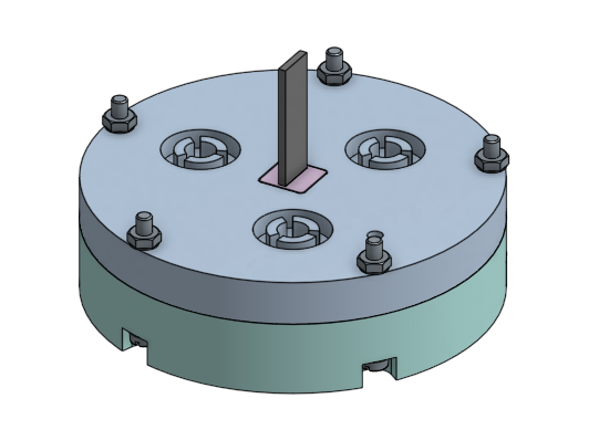

Once the top and bottom chambers are prepared with the electrodes, and the membranes are situated in the bottom chamber, the entire device can be assembled. Holding the electrode assembly on the outside so it doesn’t fall, carefully place the top chamber over the bottom chamber, being sure to line up the bolt holes on the outside of the chambers.
Feed the nylon bolts through the holes and tighten the nuts. Be careful not to over-tighten, as the bolts are soft. - Initial Soak
Once the chamber is assembled, before sealing the chamber, it needs to be filled and soaked in dilute sodium hydroxide. Submerse the chamber in a glass container of 0.005M sodium hydroxide solution. There are holes in each side of the chamber to allow the air to escape and the solution to enter. Flip the chamber around to make sure both sides are filled.
If there are bubbles in the chamber, use a pipette to force solution through the holes to help fill the chamber. Once the chamber is full, allow it to soak for a day. Use a safe material like glass to weigh the chamber down or flip the chamber a few times over the course of soaking in order to fully soak all parts of the chamber. - Drain and Rinse
After soaking, fully drain the chamber. This may require forcing air into the chamber through the holes. Shake it around to get as much liquid out as possible. Do not, however, leave the chamber to dry out, as this could damage the membranes.
When as much of the sodium hydroxide solution as possible has been removed, rinse the interior of the chamber with urea borate solution. Use a pipette to force solution through both sides of the chamber. Once the chamber has been thoroughly flushed, fill it completely and let it sit in a urea borate solution for at least an hour. - Fill and Seal
Once the chamber has been soaked in the urea borate, drain the chamber, and dry the outside. Melt some paraffin wax and seal along the outside edge of the chamber, as well as around the chamber cap and electrode. Do not seal the holes in the top and bottom yet. Use a pipette to fill one side of the chamber with fresh solution. Remove any air bubbles by tapping the chamber lightly on the table surface, and make sure it is filled to the top. Work quickly as the solution will begin filtering through the membranes. Seal the holes on that side of the chamber with some paraffin wax and repeat on the other side. Once both sides are filled, check for leaks and seal with wax. - Measure Results
Once the chamber is fully sealed, you need to wait for the chamber to equilibrate before measuring the results. This should take 1-3 hours. We used a Keithley DMM6500 multimeter to record the results in real time with high accuracy. While this is very nice, not everyone has access to such an expensive instrument. While the data won’t be as in-depth, you can measure the voltage across a resistor.
