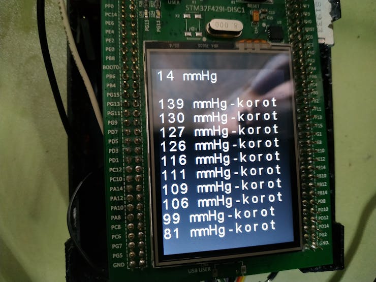

    I've getting ten Korotkoff sounds in this test, and we can see them in the figure below:
    Ten Korotkoff sounds

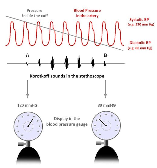

    Korotkoff sounds:
    • 139 mmHg
    • 130 mmHg
    • 127 mmHg
    • 126 mmHg
    • 116 mmHg
    • 111 mmHg
    • 109 mmHg
    • 106 mmHg
    • 99 mmHg
    • 81 mmHg
    Finally, I had check my blood pressure and compare it to the second test.
    Notes:
    • At that time I was suffering from a slight flu, so the values can be considered justified.
    • The OMRON digital pressure gauge detects Korotkoff sounds while the cuff is inflated. My design detects Korotkoff sounds while the cuff deflates.
    CHECKING MY BLOOD PRESSURE
    DATA COMPARISONS:
    • My device: according to the theory seen on sections 2 and 3, my systolic pressure is 139 mmHg, and my diastolic pressure is 99 mmHg (or 81 mmHg).
    • The OMRON device: it tells me that my systolic pressure is 137 mmHg, and my diastolic pressure is 95 mmHg.

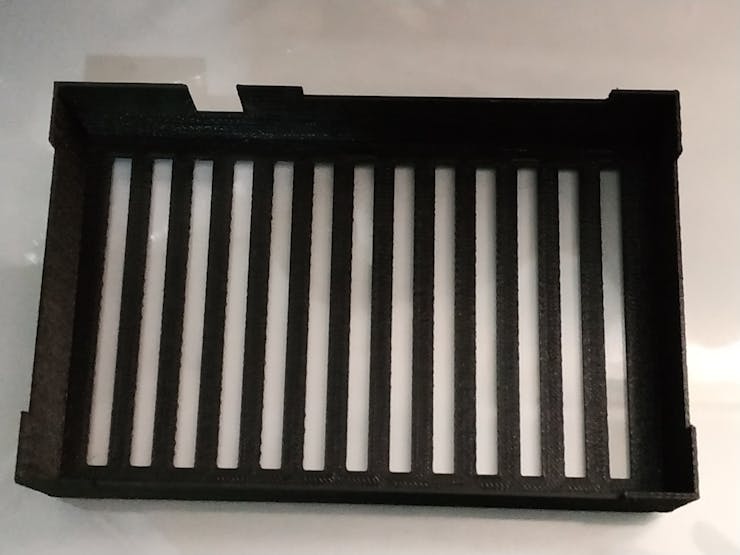

  • 9. Assembling the device
    Guillermo Perez Guillen05/29/2023 at 06:35 0 comments
    The hardware is assembled in a box for the best handling of the device, in the figure below we can see the box made with a 3D printer, and whose STL file you can get in the download section.
    Box

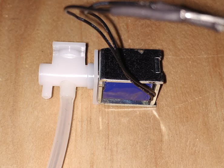

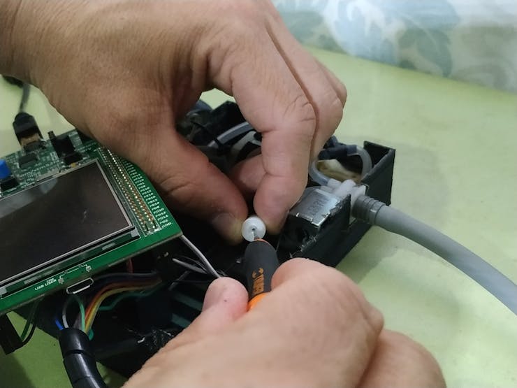

    Next, we join the solenoid valve with the connector through which the cuff can be connected.
    Pneumatic solenoid valve + connector

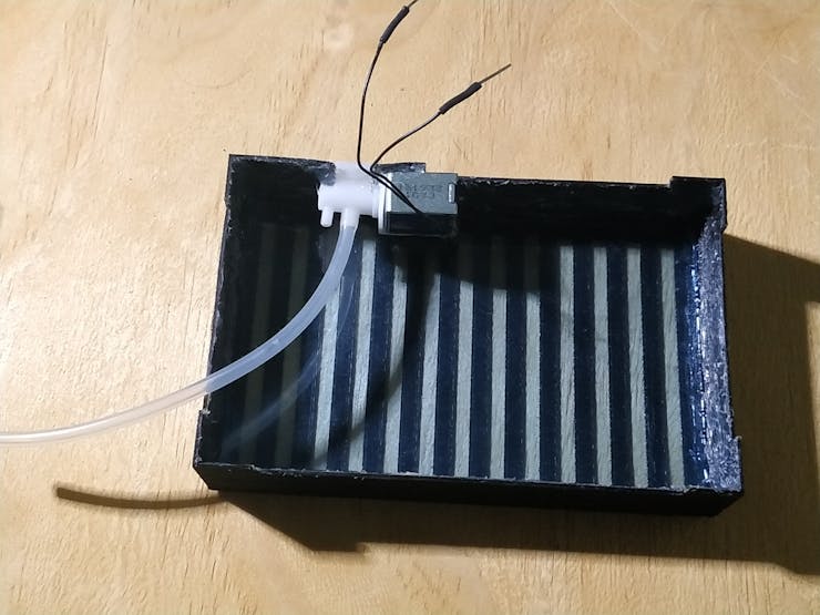

    Now we glue these pieces with silicone over the box's groove shown in the figure below.
    Glue the pieces indicated on the box

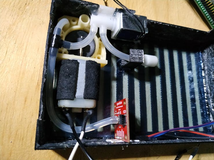

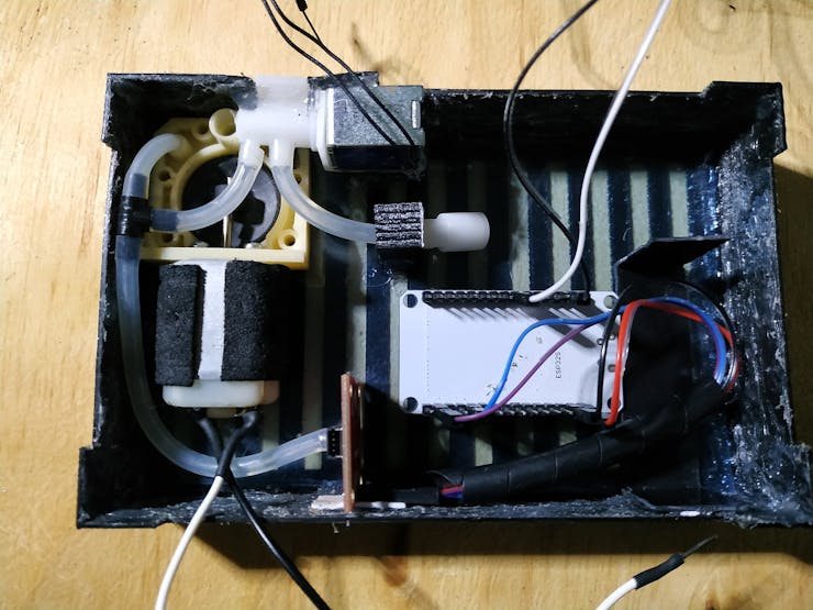

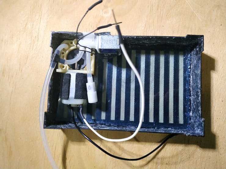

    I have used a smaller air pump to best fit in the box. So, we join this air pump to the cuff connector with an air hose as shown in the figure below. Also we join the air release valve to the cuff connector with an air hose.
    Air pump + air release valve
    We connect the micro pressure sensor with the air pump with an air hose. Then we fix the pressure microsensor as shown in the figure below.
    The next step is to fix the ESP32-WROOM-32 board as shown in the figure below.
    Fixing ESP32-WROOM-32 board

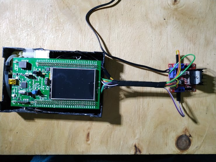

    Finally, place the STM32F429I board and the L298N driver as shown in the figure below. All electrical connections are followed as in the schematic diagram.
    STM32F429I board + L298N driver

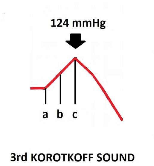

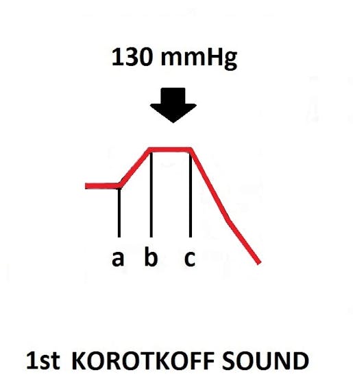

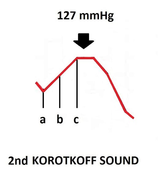

  • 8. Calculation of the Korotkoff Sounds
    Guillermo Perez Guillen05/29/2023 at 06:34 0 comments
    • We already have all the data stored in the "PressureArray" matrix. Now our goal is to find these points where the Korotkoff sounds occur.
    • I did a test, send and graph to excel all the points of the curve of my blood pressure to see the points where the Korotkoff sounds occur, and this is what I saw.
    Detecting 10 Korotkoff sounds
    Here you can get a tutorial to send the data to Excel: https://github.com/gsampallo/serialToExcel
    And you can download my excel file at this link: Korotkoff_sounds_excel
    • In the graph above I found ten Korotkoff sounds. I did an analysis and in all Korotkoff points I found the following two constants: 1) point b is greater than point a, and 2) point c is greater than point a.
    130 mmHg > 129 mmHg and 130 mmHg > 129 mmHg126 mmHg > 125 mmHg and 127 mmHg > 125 mmHg
    123 mmHg > 122 mmHg and 124 mmHg > 122 mmHg
    • Through a for loop I'm going to go through 130 records of the "PressureArray" matrix. Next, I assign the first record to the variable "var_a", the second record to the variable "var_b" and the third record to the variable "var_c".
    • If the variables "var_b"> "var_a" and "var_c"> "var_a", then I print the variable "var_b" as Korotkoff sound.
    • Any other combination I only delay 1 ms. and I don't print anything.
    • According to the theory read at the beginning of this tutorial (sections 2 and 3), systolic pressure is the first Korotkoff sound, and diastolic pressure is the last Korotkoff sound.

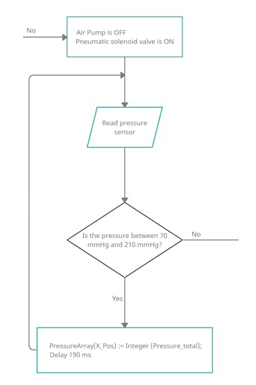

  • 7. Deflation of the Cuff
    Guillermo Perez Guillen05/29/2023 at 06:31 0 comments
    • Continuing with the narration from the previous section. The cuff starts to deflate from 170 mmHg.
    • Remember that the solenoid valve is closed, so now the air leak is in the air release valve. Here, the recommendation is that the deflation process of the cuff is between 17 and 21 seconds. So we must calibrate this air release valve with a flat screwdriver, so if we turn it clockwise then the valve closes, and counterclockwise the valve opens.
    Calibration the air release valve
    • The next step is to measure blood pressure values between 70 mmHg and 170 mmHg and save them in the "PressureArray" matrix every 200 ms approximately.
    • I have programmed a maximum value of 210 mmHg in the while function in case, during the inflation of the cuff, it exceeds the limit of 170 mmHg, for example 180 mmHg.
    • The values stored in the "PressureArray" matrix and per test are between 120 and 130.
    Flowchart
    Flowchart
    while Pressure_total > 70 and Pressure_total <= 210 loop
                Start_Conversion (Converter);
                Poll_For_Status (Converter, Regular_Channel_Conversion_Complete, Successful);
                Raw := UInt32 (Conversion_Value (Converter));
                Volts := UInt32  ((Float (Raw) / 4096.0) * 3000.0);   -- 4096 ADC = 3000 mV
                Pressure := UInt32 ((Float (Volts) / 3000.0) * 255.0);   -- 3000 mV = 255 mmHg
                Pressure_total := UInt32 (float (Pressure) - 8.0);   -- 3000 mV = 255 mmHg
                Print (0, 0, Pressure_total, " mmHg"); -- print blood pressure
                PressureArray(X_Pos) := Integer (Pressure_total);
                X_Pos := X_Pos + 1;
                delay until Clock + Milliseconds (190);
             end loop;

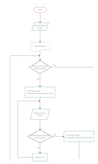

  • 6. Inflation of the Cuff
    Guillermo Perez Guillen05/29/2023 at 06:29 0 comments
    • The analog port PA5 of the STM32F429I board is connected to the DAC_1 port of the ESP32-WROOM-32 board, so we will monitoring each mmHg of the pressure sensor in real time.
    • When we press the user button (blue) that corresponds to port PA0, then the air pump and the pneumatic solenoid valve are turned ON.

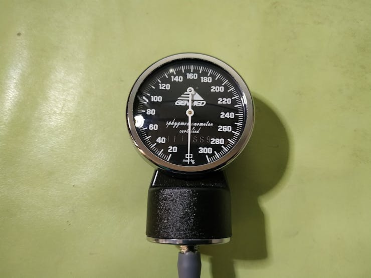

    • In this solenoid the valve closes and doesn't allow any air leakage, so the air pump begins to inflate the cuff, and the pressure sensor tells us how the pressure increases inside the cuff.
    • Each increase in pressure within the cuff is printed on the LCD screen of the STM32F429I board.
    • You have to note that before printing the total pressure I do a subtraction of eight units, this is because I found a small error of + 8 mmHg approx in all my readings. I did this verification with an aneroid gauge.
    Aneroid gauge
    Aneroid gauge
    • When the pressure inside the cuff reaches 170 mmHg, then the air pump is stop (OFF), and the solenoid valve continues closed.
    Flowchart
    Flowchart
    if STM32.User_Button.Has_Been_Pressed then -- Btn pressed then go to 170 mmHg
             Solenoid_valve.Set;   -- solenoid valve is ON
             Motor.Set;   -- air pump is ON
             Enable_a.Set;
             Enable_b.Set;
             while Pressure_total <= 170 loop
                delay until Clock + Milliseconds (75);
             end loop;
             Motor.Clear;   -- air pump is OFF
             Enable_a.Set;
             Enable_b.Clear;

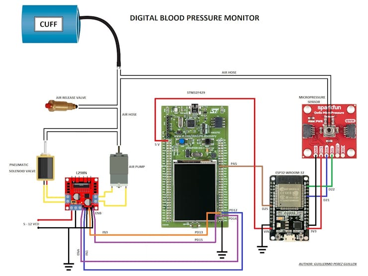

    Our schematic diagram is shown below:
    Schematic diagram
    Schematic diagram

         min_pressure=sensor_pressure;
      sensor_pressure = (mpr.readPressure(INHG)*25.4);
      int pressure_total = sensor_pressure - min_pressure;
      dacWrite(DAC2, pressure_total);
      Serial.print(pressure_total);
      Serial.println(";");
      delay(200);
  • 3. Systolic and diastolic blood pressure
    Guillermo Perez Guillen05/29/2023 at 06:23 0 comments
    Traditionally, the systolic blood pressure is taken to be the pressure at which the first Korotkoff sound is first heard and the diastolic blood pressure is the pressure at which the fourth Korotkoff sound is just barely audible. However, there has recently been a move towards the use of the fifth Korotkoff sound.
    Reference: https://en.wikipedia.org/wiki/Korotkoff_sounds
    Blood Pressure, Heart
  • 2. Korotkoff sounds
    Guillermo Perez Guillen05/29/2023 at 06:22 0 comments
    Korotkoff sounds are the sounds that medical personnel listen for when they are taking blood pressure using a non-invasive procedure. They're named after Dr. Nikolai Korotkoff, a Russian physician who discovered them in 1905, when he was working at the Imperial Medical Academy in St. Petersburg, Russian.
    Korotkoff sounds
    Korotkoff sounds
    If the cuff of a sphygmomanometer is placed around a patient's upper arm and inflated to a pressure above the patient's systolic blood pressure, there will be no sound audible. This is because the pressure in the cuff is high enough such that it completely occludes the blood flow.
    If the pressure is dropped to a level equal to that of the patient's systolic blood pressure, the first Korotkoff sound will be heard. As the pressure in the cuff is the same as the pressure produced by the heart, some blood will be able to pass through the upper arm when the pressure in the artery rises during systole. This blood flows in spurts as the pressure in the artery rises above the pressure in the cuff and then drops back down beyond the cuffed region, resulting in turbulence that produces an audible sound.
    Eventually, as the pressure in the cuff drops further, the sounds change in quality, then become muted, and finally disappear altogether. This occurs because, as the pressure in the cuff drops below the diastolic blood pressure.
    Notated Korotkoff sounds
    There're five Korotkoff sounds:
    • Phase I—The first appearance of faint, repetitive, clear tapping sounds which gradually increase in intensity for at least two consecutive beats is the systolic blood pressure.
    • Phase II—A brief period may follow during which the sounds soften and acquire a swishing quality.
    • Phase III—The return of sharper sounds, which become crisper to regain, or even exceed, the intensity of phase I sounds.
    • Phase IV—The distinct abrupt muffling of sounds, which become soft and blowing in quality.
    • Phase V—The point at which all sounds finally disappear completely is the diastolic pressure.
