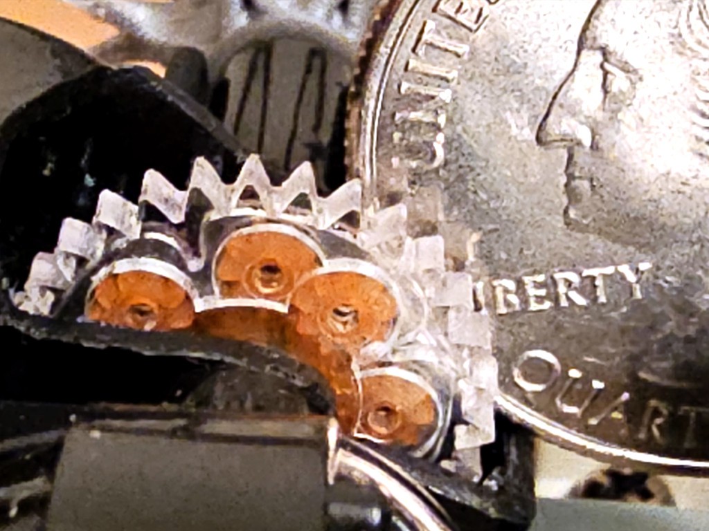

First I'll show this little bevel gear,...
... because the "3dp" 3d printed mill that is the object of this project actually for real cut that gear at MRRF. So I hope you'll accept some parts cut by the earlier laser-cut version of this CNC as an illustration of capability:
Spider gears and structure parts for a little differential with a US "quarter" coin for scale.
The spider gear assembly in the complete differential is smaller than my fingernail. There's a <4 min. video about that over in the "2dc" project but it's old work and too much about the earlier laser-cut design to include in this project.

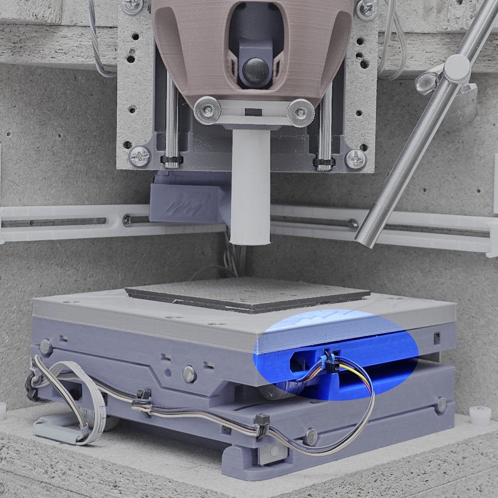

The CNC mechanics consist of an XY table and a separate Z axis. The two parts need some sort of frame to hold their positions relative to each other. The frame can be very basic. But I want to use my machine in a smallish urban condo with no "shop"-like space.  So I've put a little more effort into the frame and packaging..
The "telescoping" slide design allows very compact non-operating footprint.
More about packaging -- which is already obsolete because I haven't yet written up several improvements like cleaner DC supply and integrated logic-switched AC for the dremeloid.

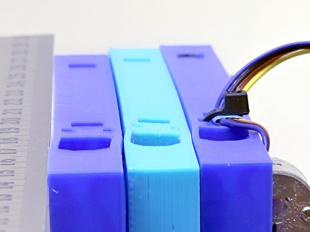

    These three iterations of the evolving "top" part show the same sag around the X motor:
    So that's been happening for a while. I've let it go on without much thought because it hasn't caused much trouble.
    Part in context:
    left = left; right = front; X axis = down-left to up-right

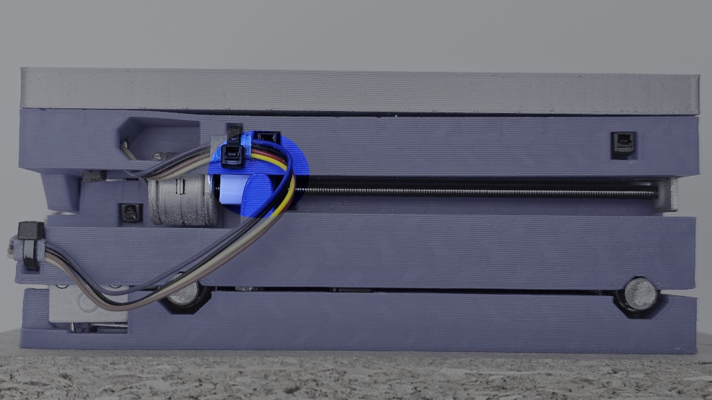

    That was a predictable weak spot, analyzed by the method of build-it-and-see-how-it-breaks. The part gets thin over the motor frame and adjacent bearing clearance which weakens cantilever support for the motor. The left and right sides provide better cantilever support for the front corners which support the front edge which would better support the front side of the motor frame if no big chunk of ventilation were cut out from it. Tying across the top and bottom of the vent opening resists bending along the front edge, but the resulting parallelogram does little to resist shear. Diagonal bracing across the vent opening might help, but obstructing airflow doesn't feel like the right solution to a heat problem.
    So stuff sags after a while. This has two effects:
    1. The motor and motor end of the screw drop. I've assumed imprecise vertical separation between the layers of the XY stack from the very first try at the basic idea, so tolerance for a little droop of the motor+screw unit was already in there, and proves more tolerant than expected. This has been a non-problem.
    2. Deformation relaxes the zip tie around the motor end of the motor+screw unit. This has been mostly a non-problem because that mostly doesn't affect axial constraint. Once (maybe twice?) the tie got slack enough to let the corner radius of the motor frame drop to the level of the relatively shallow end of the pocket into which the motor fits (maybe that needs a picture...) which let backlash grow enough to matter when I wanted really small backlash. So when mostly-not-a-problem got to be enough of a problem to notice, the fix was to replace the tie holding up the motor.
    Flipping the motor down to the top side of the more substantial "middle" part would be easy, but that would expose the screw to falling debris, which I've been able to avoid so far.
    A while (um, half a year by now...) ago I noticed that the sagging front edge of the "top" part was in solid contact with the "middle" part. I guess that explains why all three examples above had sagged to the same extent.
    That apparently is also a non-problem because, even though the parts are firmly in contact through about half of the slide travel, the rounded part of the middle part has no edge and the bottom edge of the top part is burnished smooth. Where "firmly in contact" means firmly pinch and hold a sheet of paper forced in between the two parts. The fact that it all works fine shows that this makes a sliding interface with very little friction. Maybe I could sell that as clever mechanical design if it wasn't so obviously not.
    So... nothing. If you're thinking about building one of these for yourself, don't stop for this.

    To repeat a theme: this project focuses on the CNC mechanics, and the shortest path to building your own and making it work includes not following me down the fancy box rabbit hole. Yet. This is enough to get started:
    Made from a few rough scraps, drywall screws, and eyeball "measurements"
    If you have access to a table saw, or some other way to make straight square cuts, you can make a slightly less haphazard version of the same thing:
    Same thing but looks better if you have means to make straight square saw cuts
    While square parts look good, that's still only "slightly less haphazard" because the four frame parts are sized by eye with no measured dimension. Keeping it simple!
    Placement of Z over X&Y
    The frame's job is to hold the vertical axis over the horizontal axes. That's the relationship that matters. Here are some dimensions to help set up that relative relationship. The numbers are millimeters, but "looks like this" is close enough.
    View from front; bottom edge of fixed base of Z axis about 10.5-11 cm above the deck; tool axis about 2 cm in from left edge of XY stack
    View from above; vertical face for mounting the Z axis about 7cm back from the front edge of the XY stack
    Left and right clearances
    View from front; leave room on the right side of the XY stack for your vacuum cleaner "crevice tool"; the X axis extends 75 mm to the left, so leave 8 or 9 cm on that side
    Just a little bit less simple
    Closing off the lower back of the frame will go a long way to making cleanup easier.
    A bit of cardboard and tape will do the job:
    For just a little more effort when cutting parts, a couple more pieces cut to the same width as the vertical transverse piece will both close off the back and also make the frame significantly more stiff. And if you're going that far, a third piece across the top will add another increment of stiffness to the Z axis.
    Chunky material like the 3/4" (18mm) slabs illustrated here will probably be plenty stiff enough on their own for a minimal four-piece frame. If your material is thin or otherwise uninspiring, the three extra pieces shown above can very significantly stiffen the frame. If using the narrow horizontal pieces behind the top and bottom edges of the vertical Z axis support, they should be attached along those spanwise edges as well as at their ends.

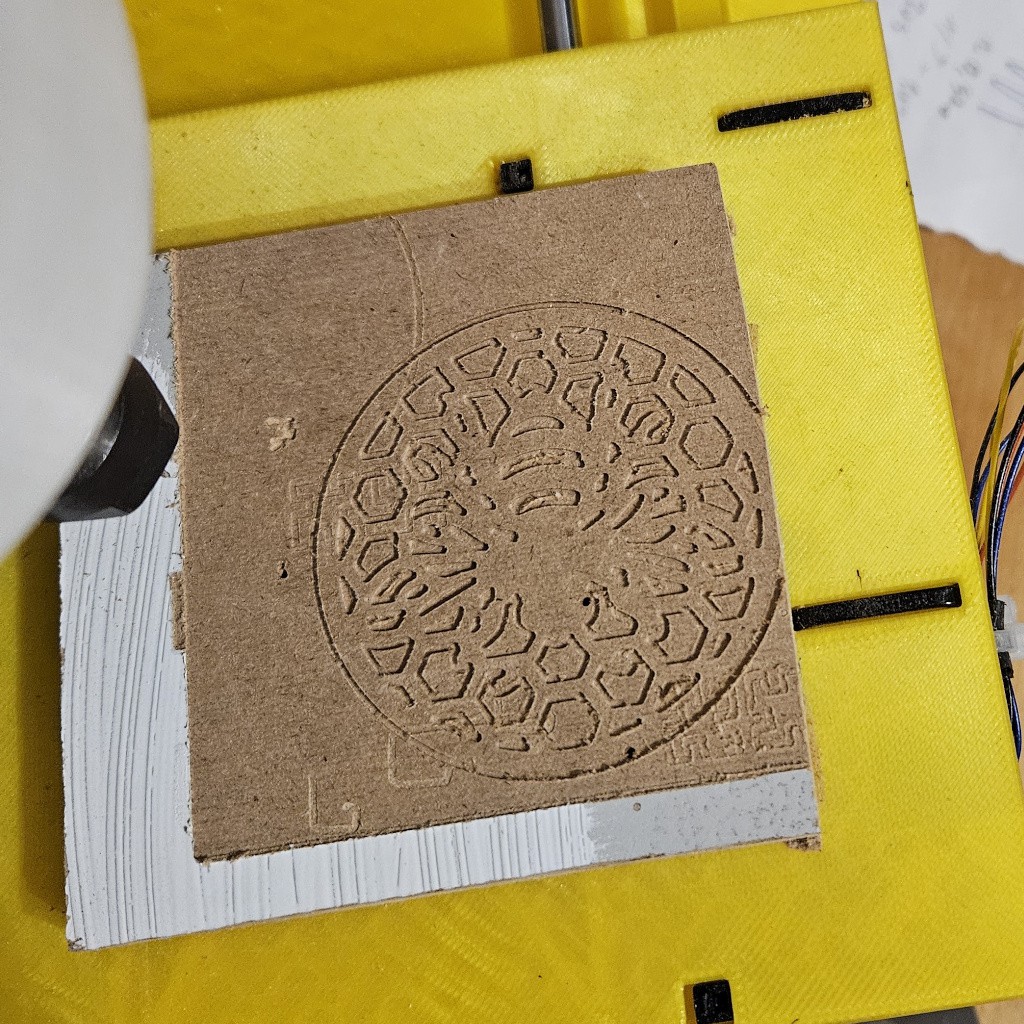

  • FR-2 = "wood" for very fine detail
    Paul McClay01/13/2025 at 22:33 0 comments
    ...and tough too!
    In the previous entry about contacting local scale model builders to ask if they might appreciate an accessible little CNC machine, I mentioned a couple tries at making a "trail board" for a Midwest Model Shipwrights member.
    People have been making scaled-down models of inconveniently large things for a long time ... and I've abandoned hope of summarizing that in a sentence. Making detailed wooden models of wooden ships stands a little aside from the model-making mainstream as we approach the 21st mid-century AD, but the venerable practice persists and practitioners gather nearby.
    Wood has grain. Scaling down wooden parts has the effect of scaling up the wood's grain. Very fine grain woods mitigate that with good success well established[1]. But trying to capture finer detail at smaller scale eventually turns into trying to carve a tea set from a stack of sewer pipe.
    From last time:
    • I wrote about FR2 exceeding expectations as a machinable material not entirely completely unrelated to wood but with essentially no grain. "FR2" is an imprecise term for the brown resin-saturated paper board used for the cheapest, simplest circuit boards.[2] Similar material is available by other names. Contrast with FR4 which is glass fiber+epoxy and hostile stuff to work with. I'm thinking this paper+phenolic stuff looks promising for compatibility with wood model construction, but that remains untested by actual model builders -- that I know of. But maybe I'm just the last guy to get the clue. Some "phenolic paper" material is advertised for "enhanced" or "finest" machinability. "FR" = flame retardant.
    • I had started off in the wrong direction with the first couple of whacks at the "trail board" example. Further information clarifies that what look like scrollwork borders of a flat board appear straight only in profile. The ornamented part is parallel with the mid-plane so it can be taken directly from the drawing. And the builder already has the structure and only needs the decoration.
    So, back to the drawing board.
    Then milled a patch of FR2 down to 0.3 mm thick (or so I thought, but it came out more like 0.34mm -- dunno why) and from that cut out a mirrored pair of figures using a 20°, 0.1mm Vbit. I didn't feel like testing how deep it could cut without breaking the tip or deflecting when I really wanted the best narrow cut and sharp inside corners, so I ran six passes at very conservative ~0.05mm steps down ("~" because a little more to match four Z motor half-steps). I expected that to cut through or very nearly so. But it didn't. So I ran a few more half-steps down until the bottom of the cut looked different. I was complicating this for myself by trying to cut no deeper than necessary because deeper makes the V cut wider.
    When I peeled that up it turned out of that I still hadn't cut through. My current guess is that maybe the glossy surface layer has a different consistency so the top of the bottom skin looks different, but I don't know. In any case, that was initially disappointing. Then I tried sanding the remaining thickness off the uncut side, and that worked quite well.
    Some beauty shots:
    That's a half-millimeter scale. (labeled "MM" in CAPS and numbered by cm. :-/ )
    Check out how thin the thin parts are! Earlier I didn't have any great ideas for how to avoid bending that if made from something like brass or styrene, or breaking it if possibly something like that could be cut from boxwood (which I have yet to try). That's where the FR2 works great. Not only is it possible to make those, but also to handle them. They are, of course, fragile. But so far I've been able to handle them "carefully", in the ordinary sense of "careful".
    I gather that a chronic challenge / mark of skill among model builders is matching reflected pairs of parts or features like this. To demonstrate...
