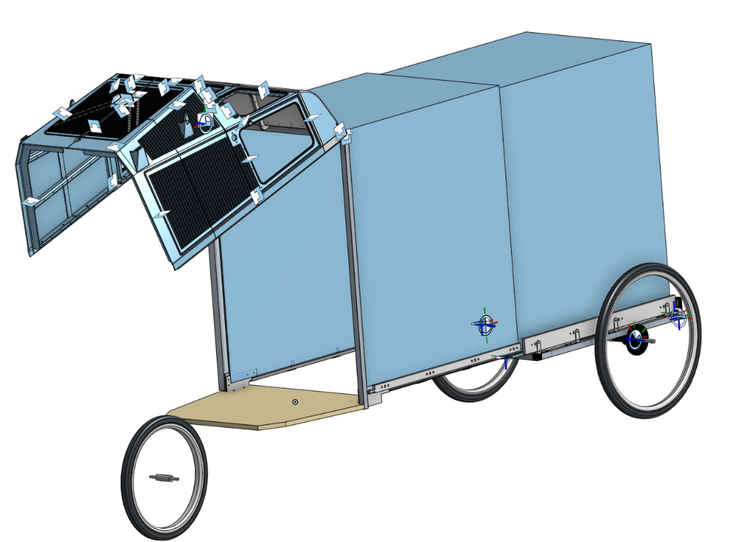

Front platform
The front platform is a about 500mm long in front of the slider. The idea is that the front can be opened and one can access the stuff inside, plan is also to make this a way to climb into the wagon and a place to sit and rest or eat on the road.
I also wanted to see if I could make the front non square so that is also a big reason for using 750mm sliders and adding this platform infront outside the sliders compared to just using 1000mm sliders and having a much easier design. I also want to be able to detach this fairly easy for transportation.

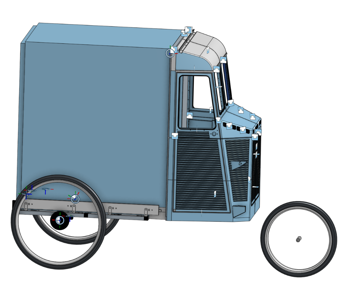

Front holding structure
The front will open frontwards using a 20x20 square aluminum frame as door frame and the front part on hinges fasten between it and two U shape 25x25 aluminum beams (one on each side) The idea with the U shape is to make sure rain and wind do not enter the living area. On the two U shaped beams a skeleton construction to reassemble the front of a Citroen Hy bus is created using plastic (PVC) L shape 30x20x3mm beams and 3D printed corners (more about that in another build step)
First the front door frame is created using the same aluminum 20x20 pipes and x-fasteners as used for the frame before. this frame is fasten ... The hight was used to 900mm
I use two M6 screws to fasten this on each side lite this:
Front holding structure is in place

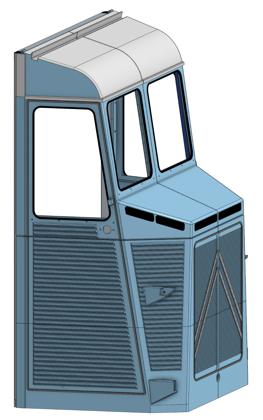

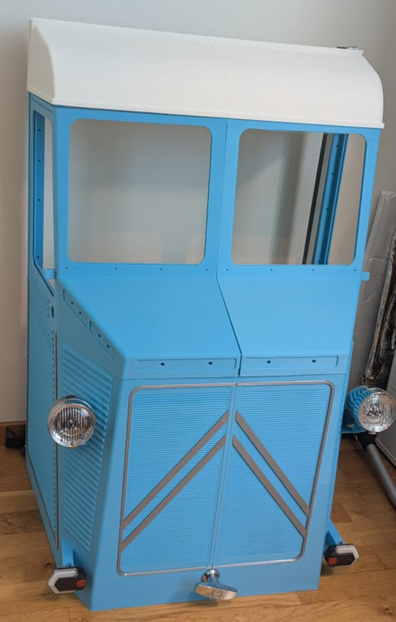

The front will be fasten with hinges to a U shape aluminium beam slightly larger then the holding structure to (25x25mm) to make the door more water and wind prof. The aluminium beam will cover the structure. (some holes had to be cut out on the inside to make it fit)
Print the files, you need at least 420x420 print bed size. I have printe most of it on a SV08 Max, I used sky blue (Elegoo PLA Sky Blue) for all but the roof part where I used white (Elegoo Rapid PLA+ White)
I have not decided it I would like to be able to open it both on the middle and also the whole front so the CAD is prepared for both. There are holes for M4 inserts from Ruthex on a few places along that should end up againts the U25 beam, I ended up using 4 on the lower part. Use M3 for fastening left and right sides and top part and side windows holder, there are quite many holes use how may you like. I have also prepead a lot of extra M3 holes here and there for future fastening of stuff if needed so I do not need to reprint the whole thing. For left/right and white root to blue front window pices I used M3 12mm lenght and glue is used for the smaller parts platics parts like the "chrome/silver" around the door and the front.
I bought precut 2x 250x250x2 acrylic sheets for the two front windows and a 400x300x2 sheet to the side windows that need to be cut. (not done yet so I hope it works)
