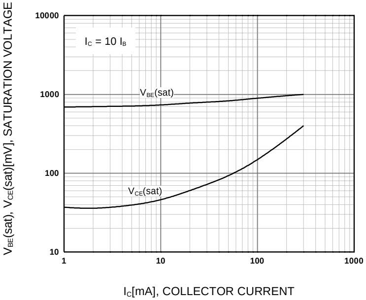

I have no Schottky diodes, but I do have open-collector TTL gates: 7406, 74LS125 and LS126 . Their outputs have V_CE_sat around or lower than a Schottky diode. Their data sheets for the state the worst case at maximum load, but not at the small loads used by this application. V_CE_sat is smaller at smaller collector currents.
So I looked at data sheets for the Fairchild BC239C (the transistor I have). The V_CE_sat graph looks like this:
V_CE_sat is under 40 mV when collector current is under 6 mA, so I put 40 mV (and 100 mV video offset) into my spreadsheet and got these resistor values:
R2,3,4 = 390, 404, 1856.
390 is an E24 value.
404 is nearly 390 + 15 = 405
1856 = 1800 + 56 exactly
