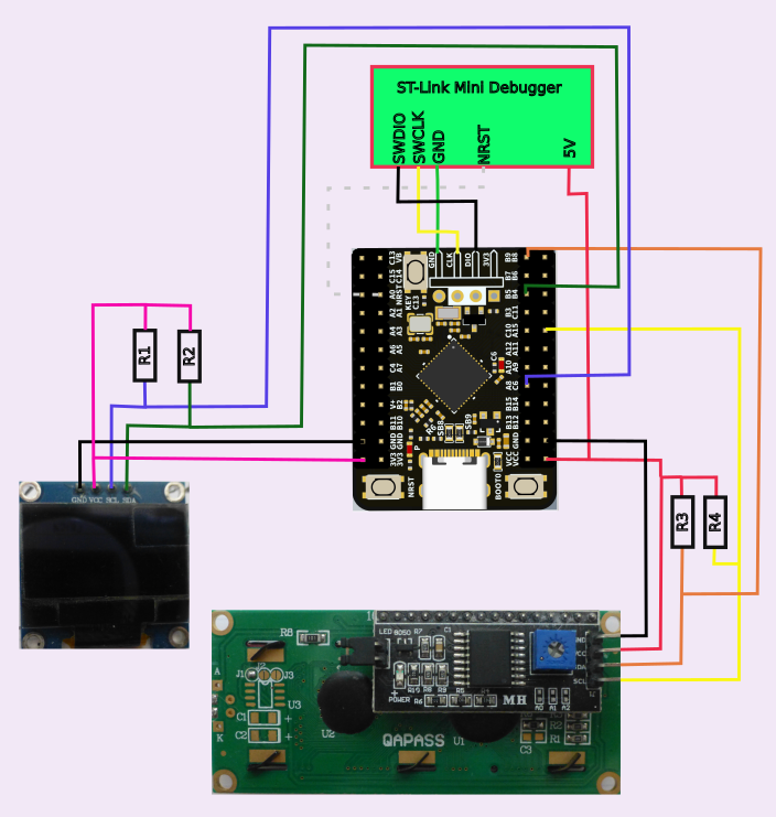

Since the 72x40 display uses 3.3V, the I2C lines are pulled up to 3.3V using 1.8K resistors.Dual I2C displays version:
Parts:WeActDuino (STM32G431)
128x64 LCD with SSD1306 controller; I2C interface, 3.3V
16 x 2 line LCD with HD44780 controller and PCF8574 I2C Interface, 5.0V
2 1.8K Resistors
2 5.1K ResistorsHook up:
Component Component Pin WeActDuino Pin Comment ST-Link Mini Debugger SWDIO DIO 4 Pin Header ST-Link Mini Debugger SWCLK CLK 4 Pin Header ST-Link Mini Debugger GND GND 4 Pin Header ST-Link Mini Debugger NRST NRST ST-Link Mini Debugger 5V Vcc 128x64 Display Vcc 3.3V 128x64 Display SCK A8 (SCL3,D21) 1.8K to 3.3V pullup 128x64 Display SDA B5 (SDA3,D31) 1.8K to 3.3V pullup 128x64 Display GND GND HD44784 Display Vcc 5V HD44784 Display SCK A15 (SCL1,D28) 5.1K to 5V pullup HD44784 Display SDA B9 (SDA1,D35) 5.1K to 5V pullup HD44784 Display GND GND ![]()
Notes:
Two I2C displays are used. The HD44780 runs at 5V while the SSD1306 runs at 3.3V and will be damaged by operating it at 5V. Separate I2C channels are used so the lines can be pulled up appropriately. The 5V tolerance of the G431 is perfect for this application. The SDA and SCL lines for the two ports are chosen from WeAct_Pin_Map_R1.png for I2C 1 and 3.
Let's consider the software now. Use the procedure described above to load G431_Dual_I2C. We use two different display libraries as noted in the comments. Since the libraries for both displays allow the I2C object to be passed in, we first create the TwoWire objects. Then we instantiate the display objects and pass in the names of the TwoWire (I2C) objects. These names will be used in all calls to the display libraries and we need not worry further with them. Note that the SCL and SDA pins for each of the TwoWire objects were passed when the objects were created (or "instantiated"). -
