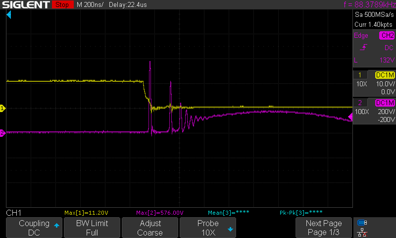

Yellow is mosfet gate, purple is mosfet drain. With a transformer turns ratio of 1:10 that's theoretically 5kV+ of output, which roughly corresponds to the maximum arc length I can draw.
Toroid ignition is 100% reliable with this design. It works every single time, and it works no matter where on the globe I touch the HV output.

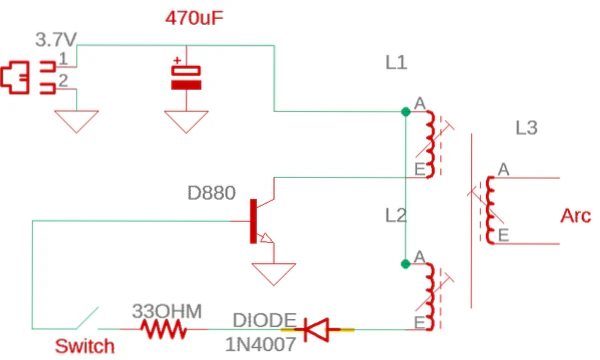

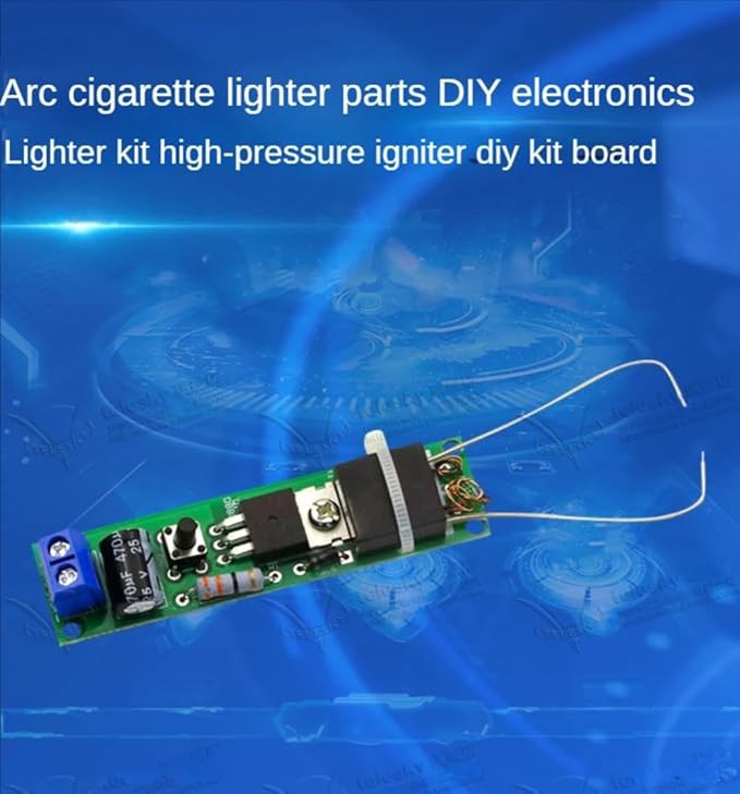

During development of plasma toroid v1 I tested using a generic "arc lighter kit" to start ionization. See example listing photo:
It didn't work well at all, so I abandoned the line of inquiry. Only later did I realize I missed something very obvious: I needed to tie one of the transformer secondaries to the toroid driver's ground. Having done that, it became a fully reliable ignition method.
Obviously I didn't want to just ziptie this piece of tat on to my PCB, so instead I set to re-implement their circuit. Here's a handy reference schematic from Quartz Components![]()
The transformer is an inscrutable black potted cuboid with primary, feedback, and output windings. The primary and secondary irregularly emerge from the potted block as thin wires coated with an enamel that's basically impossible to solder through. BJT D880 uses the feedback winding to self-oscillate. Based on measuring output inductance I estimate a primary:output turns ratio of something like 1:65. These transformers are available all over aliexpress for very cheap, but it took me ages to track down the actual part number as XR000425 from shenzen yuandongan electronics.
The specific D880 BJT isn't available from US vendors. For my test implementation I chose a BJT that seemed probably close-enough.
My trial board did oscillate and produce a mediumish high voltage, but way less than what I needed. Changing values of the feedback resistor didn't help much.Asking myself "what problem am I actually trying to solve here?" lead to grabbing breadboard, a same-footprint mosfet, and a 555 to drive with a fixed duty cycle.
which worked quite a bit better, starting the toroid reliably.

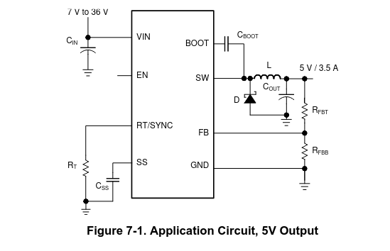

The better method is a dynamic high-side current limit.I'm accomplishing this with a buck converter based on TI's "Simple Switcher" line of ICs, specifically LMR14030SDDAR. This chip is a monolithic buck converter with integrated mosfet, and it really is simple to implement. It's also capable of running at up to 97% duty cycle which is perfect for a low minimum dropout. Here's the reference circuit from their datasheet:
---------- more ----------![]()
This is a perfectly normal buck converter topology. Most buck converters are designed to hold a fixed output voltage -- in this case, the ratio of resistors Rfbt and Rfbb create a voltage divider. Voltage at the pin FB is compared to an internal 0.75V reference, and the switching duty cycle is adjusted accordingly.
But we don't want a fixed output voltage. Instead, we want to measure the device current, and if the drawn current is too high we want to reduce the output voltage until current falls to the desired limit.

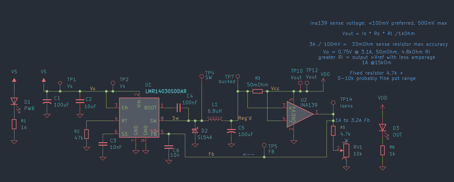

Here's my circuit:
---------- more ----------INA139 (ic U2) is a current-sense amplifier. It measures the voltage drop across the shunt resistor R3 and outputs a small voltage, with gain set by the combined value of R5 and RV1. This voltage is fed back to the feedback pin of the buck controller IC. The small capacitor C6 adds some low-pass filtering to reduce oscillation, plus some noise rejection.
If the measured current is low, a correspondingly low voltage is produced by U2 and the gain-set resistors. As a result the buck controller thinks it needs to raise the output voltage and increases the duty cycle (up to the 97% maximum). If the measured current is high and U2 outputs a higher voltage than the FB pin internal ref of 0.75v, the buck controller reduces the duty cycle until equilibrium is reached. RV1 being a potentiometer makes this current limit adjustable.
I'm leaving in my messy notes about trying to work out component values to make this transfer function do what it's supposed to. Seems like a good illustration of the design process -- these circuits don't come fully-formed from pure inspiration. These component values will probably still change!On The Bench
Although I had some initial befuddlement due to soldering the controller IC on backwards, the circuit worked perfectly. I'm able to fully and smoothly control the allowable current all the way from USB-PD supply max down to below the minimum needed to sustain the toroid. This control method is much more stable and robust than shifting the mosfet bias voltage. Hooray!

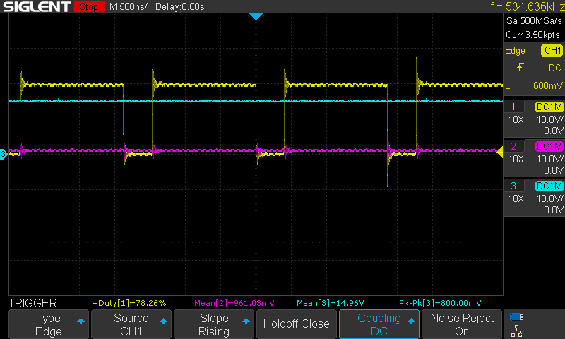

I didn't start testing this module directly with a plasma toroid driver board. Initial basic functionality was verified using a li'l 12V peltier module as a load -- it's the closest thing I had on-hand to something purely resistive.Here's the scope view:
Yellow is the buck switch, purple is the feedback voltage, blue is the output voltage (input is 20v). Switching frequency is about 500kHz. Everything is nice and well-behaved.

My first attempts were using cheapo "arc lighter ignition modules" sold on aliexpress or amazon. (I won't bother linking, because those listings seem to have a half-life of like six months and dead links suck.)
zap
BigCliveDotCom has a great video explanation into how this circuit works. I think it could be best described as "aggressively cost-optimized.
Holding the contacts against the globe could occasionally start ionization, but that was rare. Most of the time it did nothing, regardless of positioning.
This was a dead end.

Here's the scope traces with the xenon going full donut.
As previously, the yellow trace is gate, purple is drain, and blue is gate bias (note the different y-axis scale). Those waveforms look basically ideal (and I think some of the remaining wigglyness on the drain is due to mediocre scope probing, since I only have so many hands to use pokey leads and not clips). The shape on the drain trace does morph a bit in response to changing drain voltages.
The L1 input choke inductor value was increased to 6.8uH. The previous 2.2uH inductor had been chosen low in an attempt to constrain circuit power draw, but tbh I really should have just planned on setting limits on the supply side.
Adding a 1nF rf-bypass capacitor to the bias voltage network does indeed smooth out that waveform. (Also, turns out I had once again been seeing spurious wigglyness due to an over-large loop area with the ground clip.) Replacing the bias voltage divider with a zener reference also makes striking the toroid quite a bit more stable and reliable. I'm currently using an 8.2V zener but will swap it down to 4.7V soon, to make better use of the full potentiometer range.
