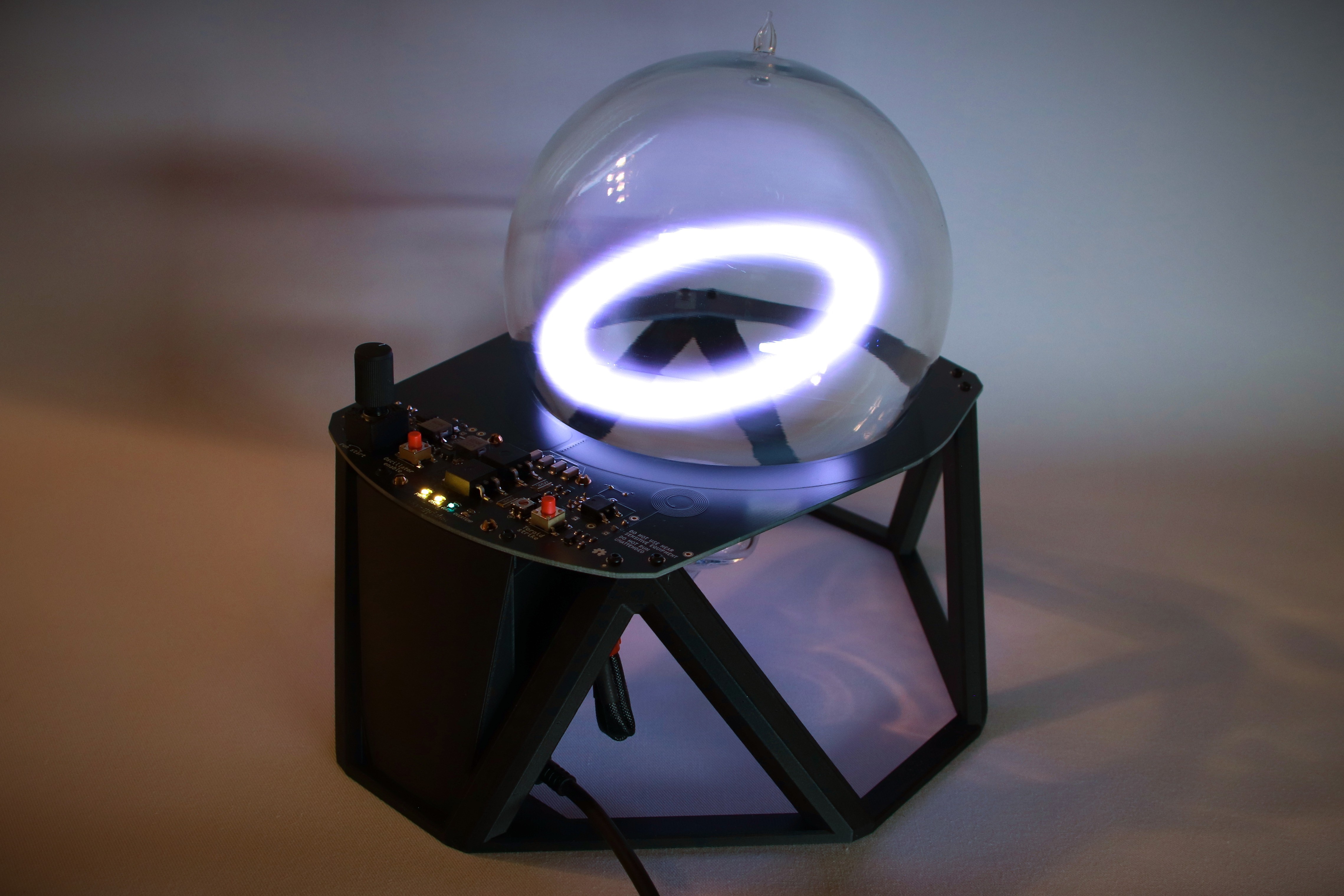

An inductively coupled xenon plasma toroid. All electronics (including primary inductor) are part of a single PCB running on USB-C-PD power.
The driving electronics is a "class E" self-oscillating circuit. A 2µH loop inductor is driven at 13MHz and 800V, creating a strong electromagnetic field.
If a 1-liter globe of 15 torr xenon is placed in the middle of the inductor, the xenon will ionize into a conductive loop analogous to the secondary winding of a transformer.

  • #14: version 2, COMPLETED
    sky-guided01/10/2026 at 21:03 0 comments
    Plasma Toroid Version 2 is complete. You can even buy an assembled board!

    Revision 0.3 of the induction driver creates a plasma toroid that's stable and controllable, and does so without overheating.
    I'm closing in on a finalized version of the driver. Soon, both the induction coil and driver circuit will be unified into a single monolithic PCB.

I built one thanks to your detailed writeup and documentation! Still waiting for the xenon globe itself but had no trouble assembling a couple of the driver boards and mechanical assembly. Wasn't able to get such fancy clear soldermask, but they also look awesome in black mask with ENIG from JLCPCB. They appear to run, and spark, I'm excited to actually try them out soon. Thanks so much!
sky-guided wrote 09/17/2024 at 20:08 point
Rad, I'm happy to hear it!!
Send me a pic when things light up :)
Matthew Sylvester wrote 09/18/2024 at 18:56 point
I got it running! But not quite long enough to get a picture. The arc striker didn't work well for me, I am using a 14cm globe I purchased on AliExpress which seems to have very thick glass. Not sure if that's related.
At maximum power a diffuse glow started in the globe, and then I was able to get a filament by touching the thinner glass near the tubulation. by spinning the globe around to twist the filament into a ring I got the toroid to form. i was so mesmerized I forgot to dial the power down. The red LED turned on and almost immediately after that the toroid vanished and smoke came off the driver board.
On inspection it looks like it arced over from the bottom side drain polygon to one of the GND traces that run through it, using the heatsink to get started. It could probably use greater clearances in that area, and definitely needs a non-metallic thermal interface to keep the heatsink away a little.
I think I can repair this board and I've got another one built where I removed the pre applied foil and paste on the heatsink and used heatsink tape instead. I expect I'll have it running shortly!
Update: This thing is badass
