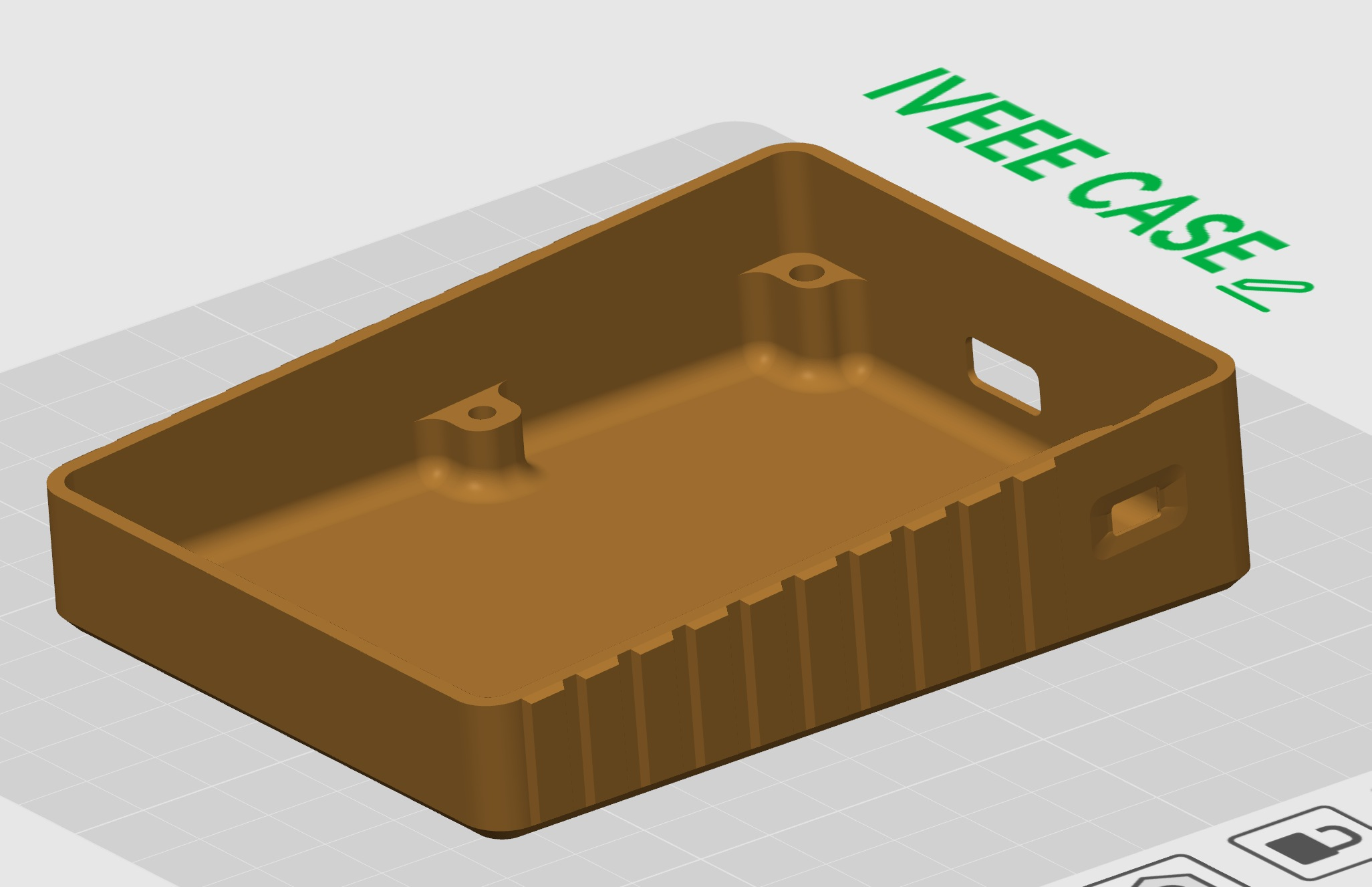

    svofski • 08/08/2026 at 10:02 • 0 comments
    With a sturdy case the calculator somehow becomes a much more useful tool.
    I made the .3mf project available as well as FreeCAD models and .step exports.
    All on github: https://github.com/svofski/calculator-ivee/
