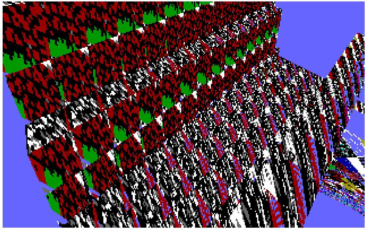

I managed to get it to work with a monitor using my #RA8875 VGA card, and it is working rather well:
I'm getting around 20-30 FPS, depending on where I point the camera. With the RA8875, I can use 8-bit color, so the colors look a lot better than have previously been shown on this project. The cost, is that there is no longer any transparency, but this isn't noticeable yet. It took me a bit to get the new color system working, so the above picture is taken after I fixed the color issues, but the video below does not have them fixed yet. It was related to how the color data is saved on the SD card to make it easier to load.

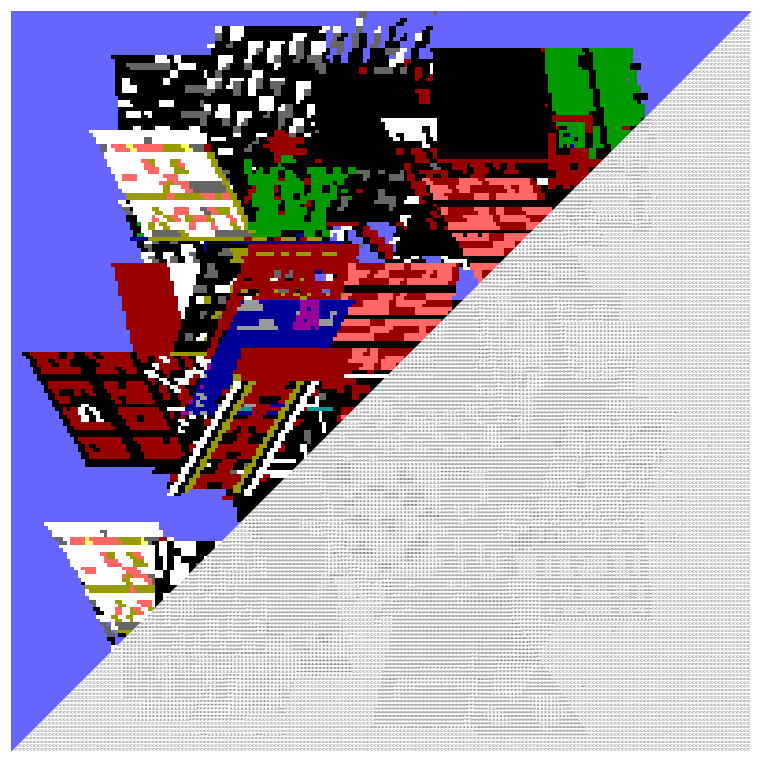

This is much better. The quads in this image are diamond shaped and rotated, but the textures are almost perfect! The shape of the terrain isn't too hard to make out, and with a more interesting scene, it could probably look a lot cooler. We do see nearby textures bleeding into the dirt texture though. To fix this, we can add a simple if block to prevent the texture coordinates from going out of bounds. Certainly, this can't affect our render time much. Certainly... right?

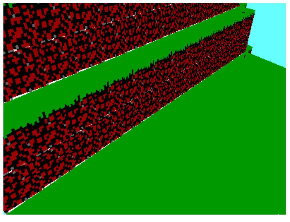

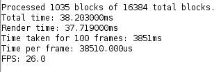

At this point I was doing some profiling to see what's eating up my CPU time. The first thing I wanted to know was the overhead of the map floodfill algorithm; turns out it's really tiny. I knew it wouldn't be more than half, but I had no idea it would be this small:
Processed 1035 blocks of 16384 total blocks. Total time: 43.820000ms Render time: 43.351000ms Time taken for 100 frames: 4412ms Time per frame: 44120.000us FPS: 22.7
Less than half a millisecond - ore just more than 1% of the render time. About 98.5% of the render time is spent on the 3D rendering code, and of that probably about 99% is spent on computing and drawing individual pixels - not even matrix multiplication or any actual 3D projection. Ok, so let's see how much time we add by just adding some if blocks to check the texture coordinates:

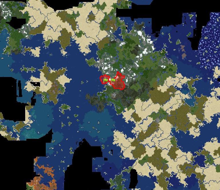

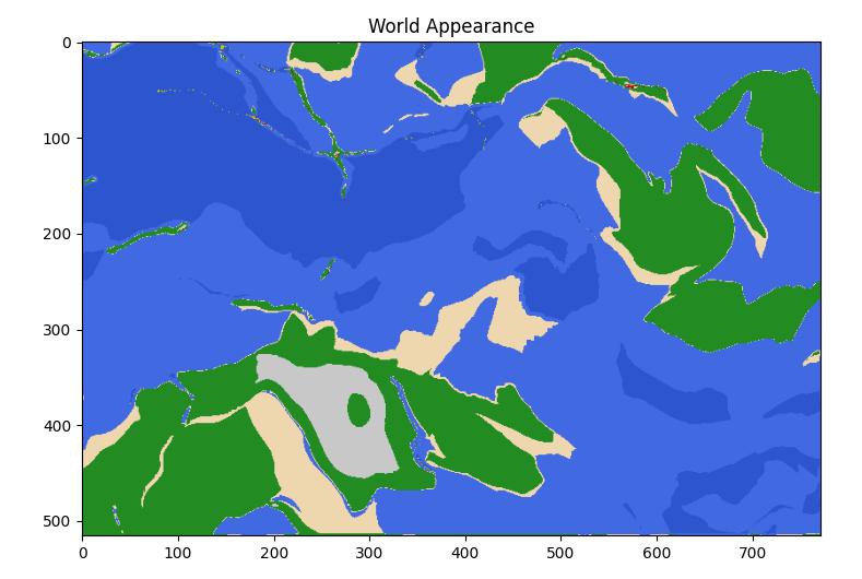

I have the rendering pipeline mostly working, but I need something to actually render. At some point world gen will be required, so I thought I should just implement it now.
Most world gen uses perlin noise to create the heightmap, which is a critical feature of the terrain - perhaps the most important feature. The problem, is that it isn't very realistic on a larger scale. Here is a map of a rather large Minecraft world, generated with perlin noise like this, and it does not have realistic continents, islands, biomes, etc:In real life, there are island chains, separated continents, deep trenches under the oceans, mountain chains, etc. All of these features are created by plate tectonics. But how can be simulate plate tectonics in a procedural generation algorithm?

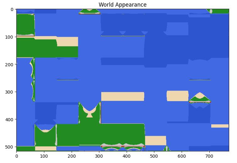

Plate Tectonics in an Infinite Procedurally Generated World
When I started working on this world generator, I started by thinking that maybe I could generate a list of nearby points to a chunk, and make faultlines as lines between them, maybe modified with some noise. The issue, is that with a procedurally generated and infinite world, keeping track of and searching these points is not really feasible, and as far as I know, there is not an algorithm to compute the nearby points based on arbitrary given coordinates. This is important, because when we generate the world, we generate it one chunk at a time, where a chunk is a 16x16x64 tower of blocks that forms one section of the world. We cannot generate the entire world at once, because the world may be too large, even infinite. In essence, it isn't feasible to generate tectonic plates themselves. Thankfully, there is a great workaround.
A procedural world generator like this is, in essence, a function that describes the characteristics of the world at point x, y given a seed value. So, we need a function that describes the tectonic plate and/or nearby plates at the coordinate x, y. And we must do this without having a list of tectonic plates to pull from, as the number of tectonic plates is infinite.
Bent Space
Instead of generating the tectonic plates, it works far better to start with a square grid of tectonic plates, then project the x and y coordinates onto this grid using a bunch of cool math. Here is the same world as the one I showed in the first image, but without coordinate transformation. Note that faultines are still simulated:As you can see, it is very blocky. All I did to get from this to the world you saw in the first image, was apply changes to the x and y coordinates. This makes the blocky grid disappear, and allows us to bypass that tectonic plate issue.
Steps of Coordinate Alteration
The sequence of steps I apply is as follows:
For each of these features, a world config controls their strength, and the strength is then modulated with more perlin noise. Each layer of perlin noise should have a different seed, although looking at my code, it seems I didn't do this. Anyway, different regions of the world should have different coordinate-altering characteristics, leading to differences in the way the terrain looks and feels in different regions.

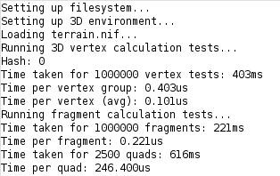

This is the first big question. With speeds approaching old phone processors, which ran Minecraft Pocket Edition, it feels like there's a chance; but I imagine those phones had hardware to accelerate graphics. We don't have that. So, I've translated some of my Java LWJGL code into something arduino compatible, and ran some speed tests:
Considering the above numbers, we can draw about 65 30x30 pixel quads every frame, if we want to hit 60hz. That's not much, but it's certainly something to work with. Each block is drawn with 3 quads, but at least one quad is almost always very small, so we can call it 2 quads - this gives us about 32 blocks we can render each frame at 60hz. I'm sure there's some optimizations or hacks I can do to improve this - it's a work in progress. Nonetheless, this is certainly enough to run a (small) 3D game, no?
Other math: I want a display with about 192000 pixels. If about 2/3 of the screen is to be rendered on average, then this gives us 128k pixels to render every frame. Each pixel is rendered as one or more fragments, so we have a minimum of 128k fragments to render. Each fragment takes about 0.3us to render when including quad processing, so the minimum render time should be approximately 38.4ms, or 26 FPS. That's actually not that bad, all things considered; I expected it to be much lower. I mean, I wouldn't notice that FPS; I used to play Minecraft at 14 FPS when I was a kid :)
