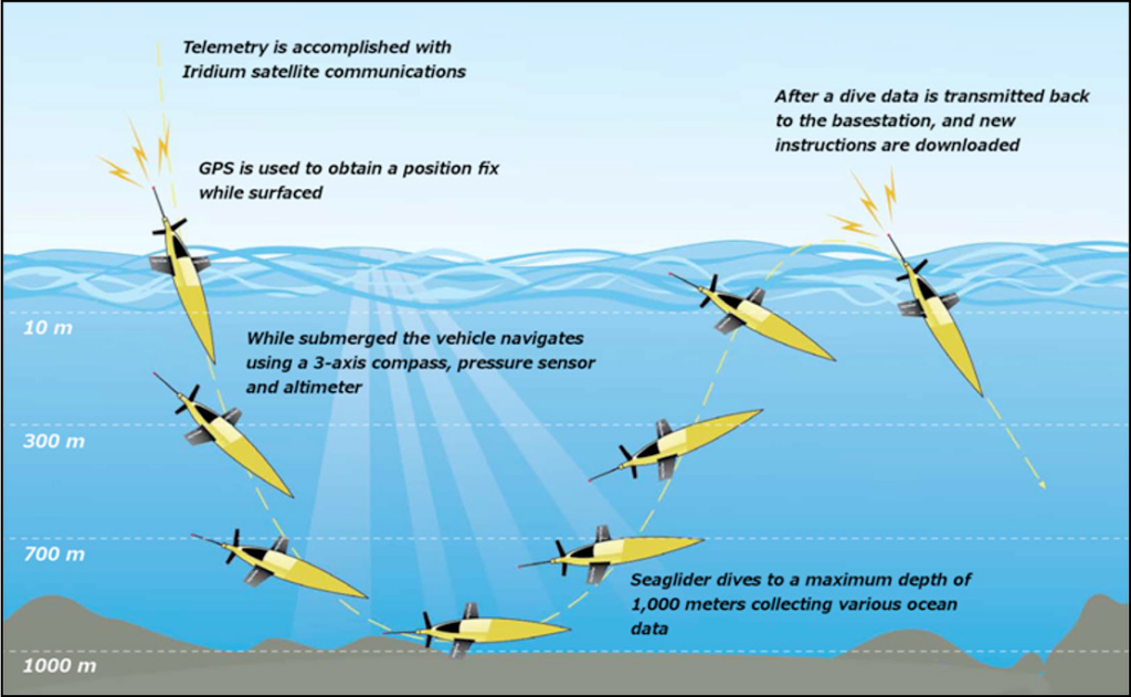

An underwater glider operates on principles similar to those of an aircraft glider, but in water instead of air. Like their airborne counterparts, underwater gliders do not use propellers for propulsion. Instead, they move forward by converting vertical motion into forward glide using their wings.
The key difference lies in how they return upward after descending. Underwater gliders use a clever buoyancy-based mechanism: they are designed to have a density very close to that of the surrounding water. By slightly changing their volume—using systems such as a piston pump or an oil-filled bladder—they can adjust their density. This allows them to alternately become slightly heavier than water (to descend) or slightly lighter (to ascend), effectively “flying” up and down through the water column.

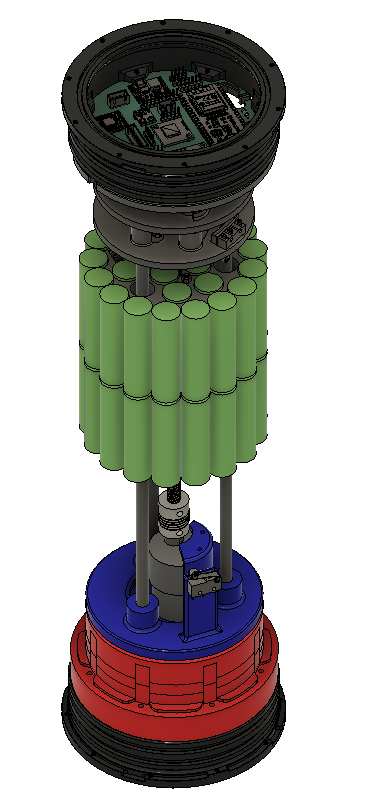

To control their movement, gliders shift an internal mass—typically the battery pack. Moving this mass forward or backward changes the pitch, controlling ascent and descent angles. Rotating the mass laterally induces roll, which in turn allows the glider to steer and maintain a desired heading.
The glider will consist of three separate sections. These are buoyancy drive, mass shifter and electronics sections. Each section will be housed inside a 5" BlueRobotics pressure housing. This way, later we can upgrade the buoancy drive section to reach the full 1000m depth.

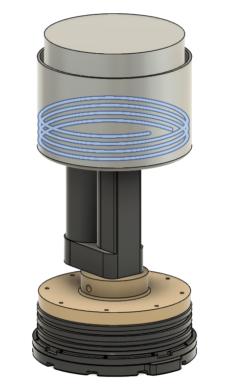

Initially I will focus on making a simple but robust buoyancy drive system. This will inistially consist of a custom-made rolling diaphragm and a linear actoator. Next step is to focus on the mass shifter system. As for comms, I am planning to use GSM and LoRa at the beginning and add Iridium at a later stage. The aim of this first build is to quickly and cheaply put together something functional and see what major changes needs to be done for the next version.

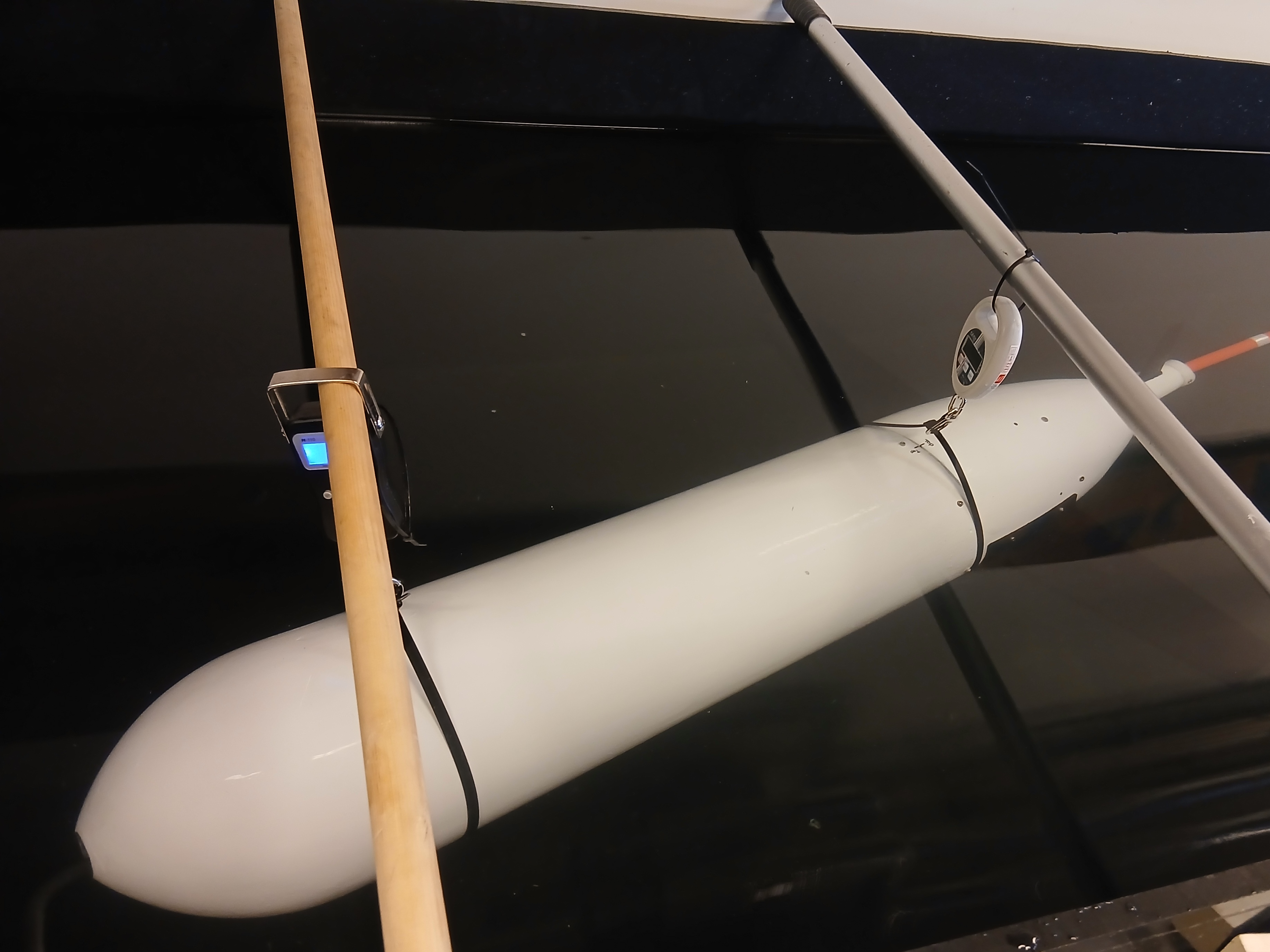

  • Ballasting
    Ehsan Abdi4 hours ago 0 comments

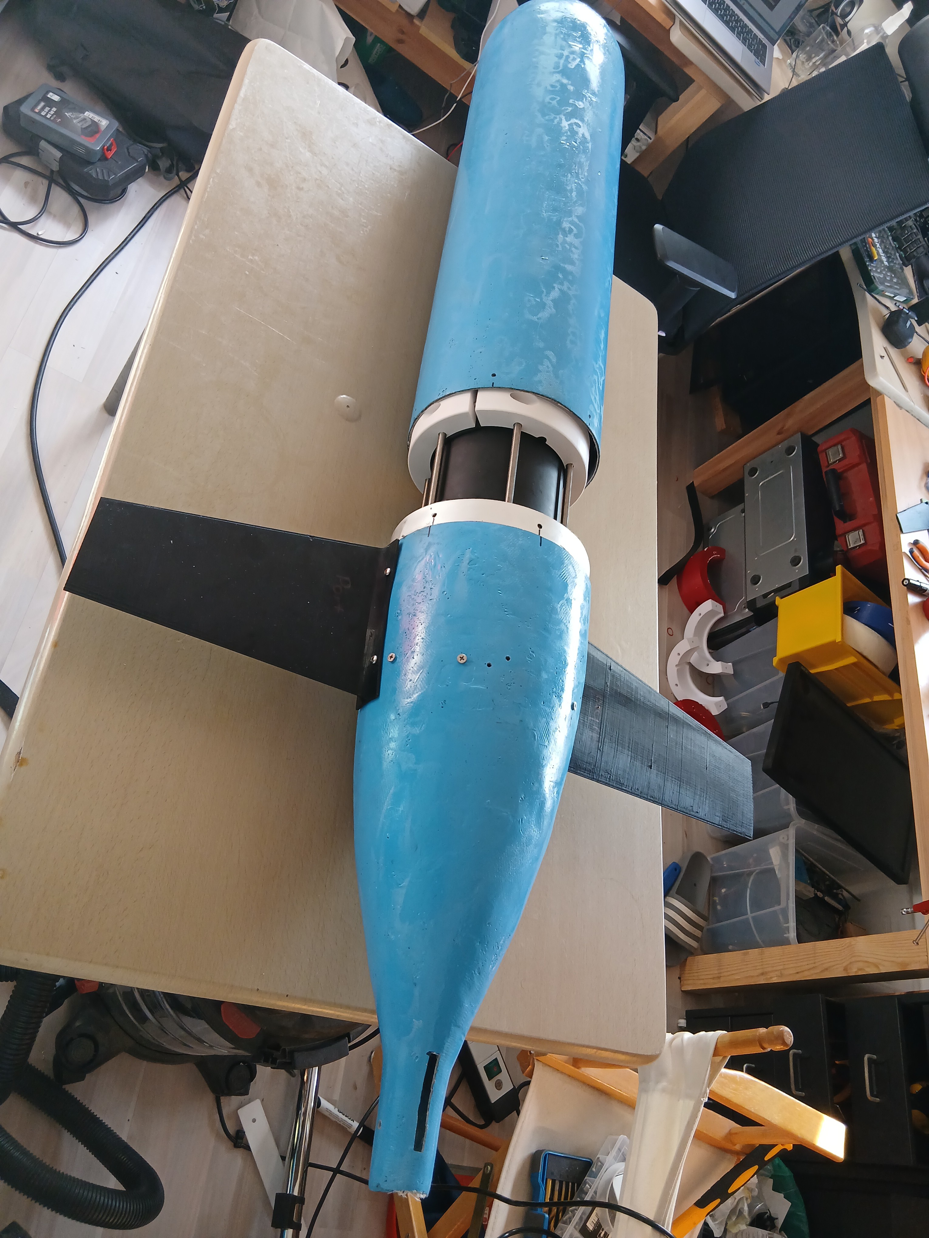

    After polishing the fairing a bit, it's now time for ballasting

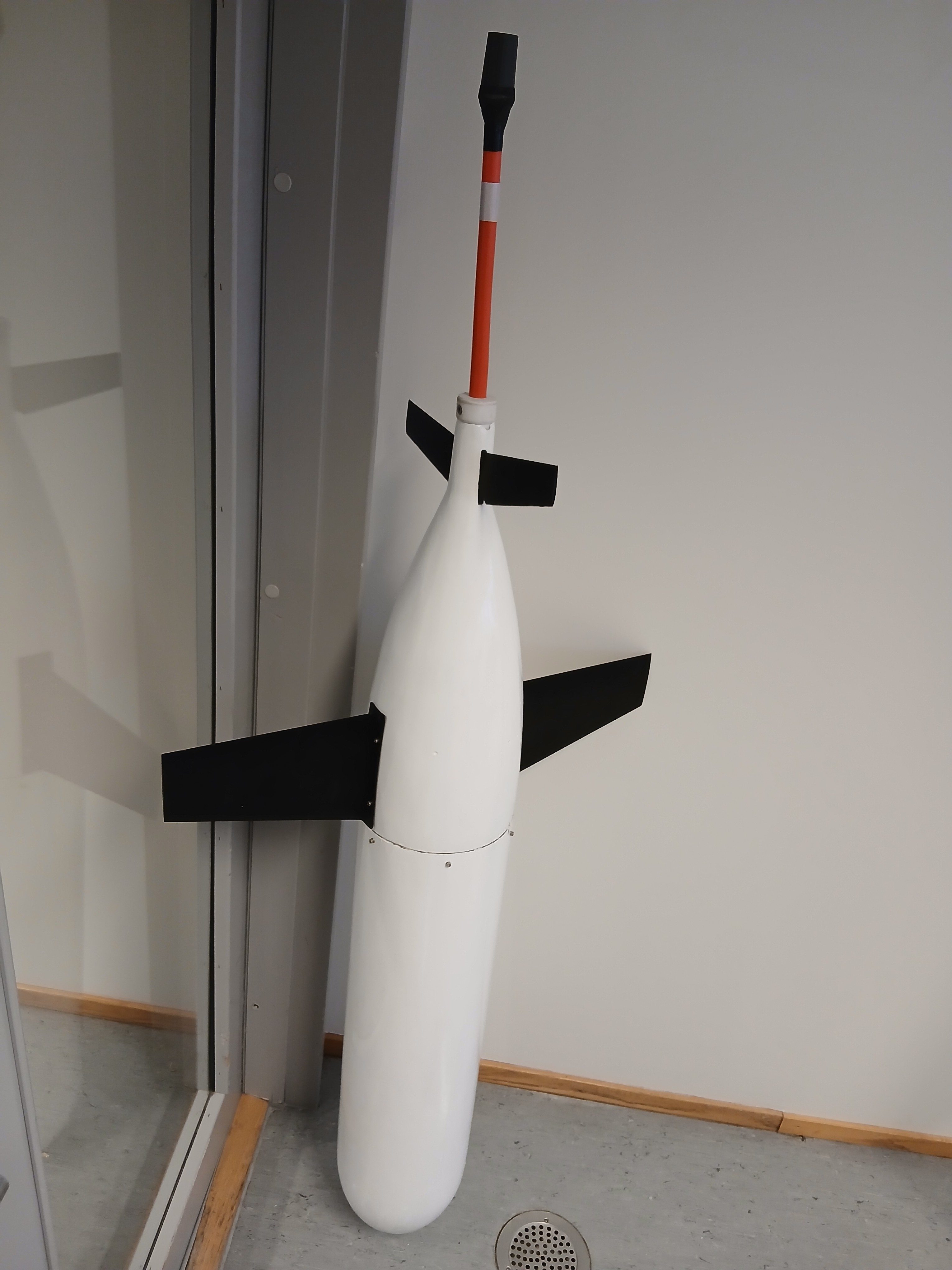

  • Almost ready for the first test deployment
    Ehsan Abdi02/18/2026 at 20:56 0 comments
    Moving the more detailed week to week logs to Discord. But I will try to post some updates here as well from time to time.

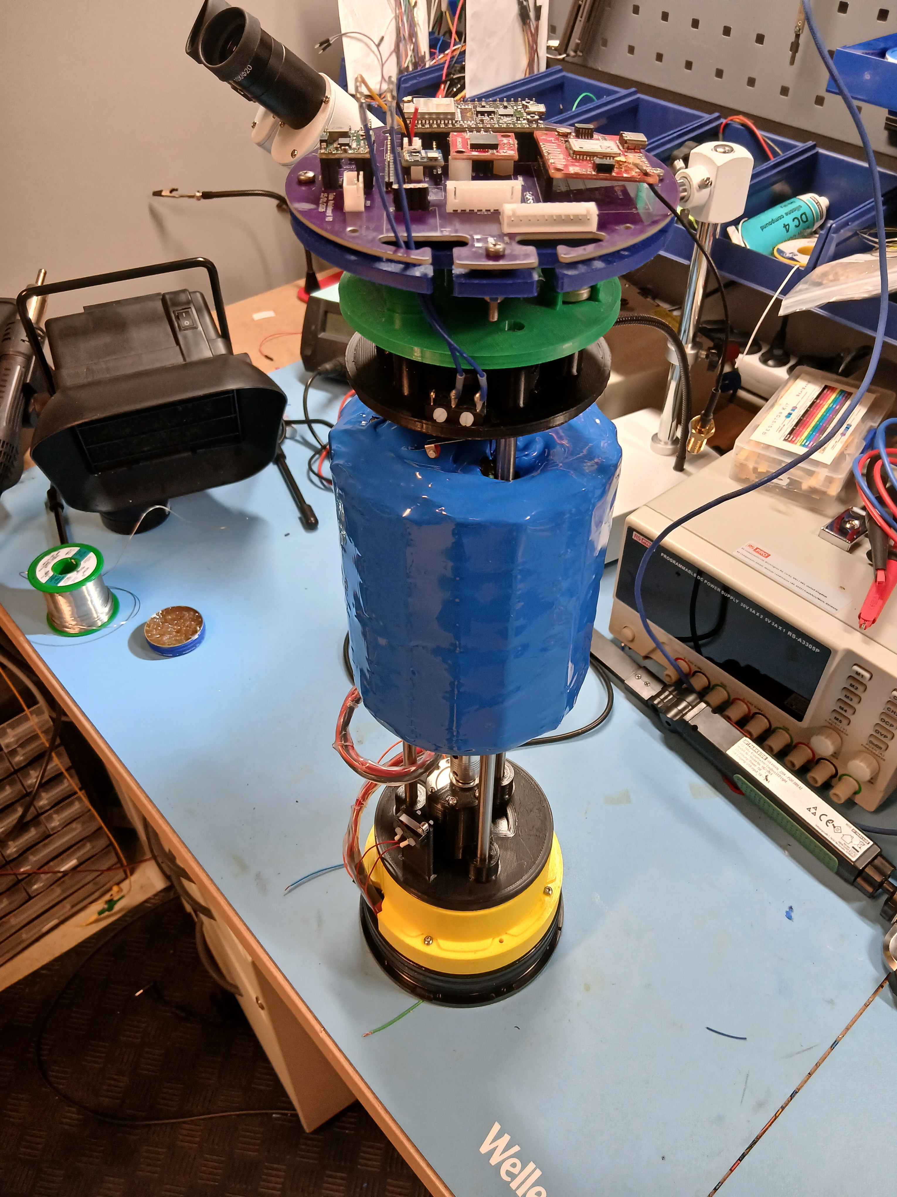

    I did some major changes to the mass shifter assembly
    and made a proper battery pack for it.
    Added limit switches for pitch as it's the most critical part that really needs them for now but eventually roll, pitch and the pump would all need to have pots to keep track of where they are.

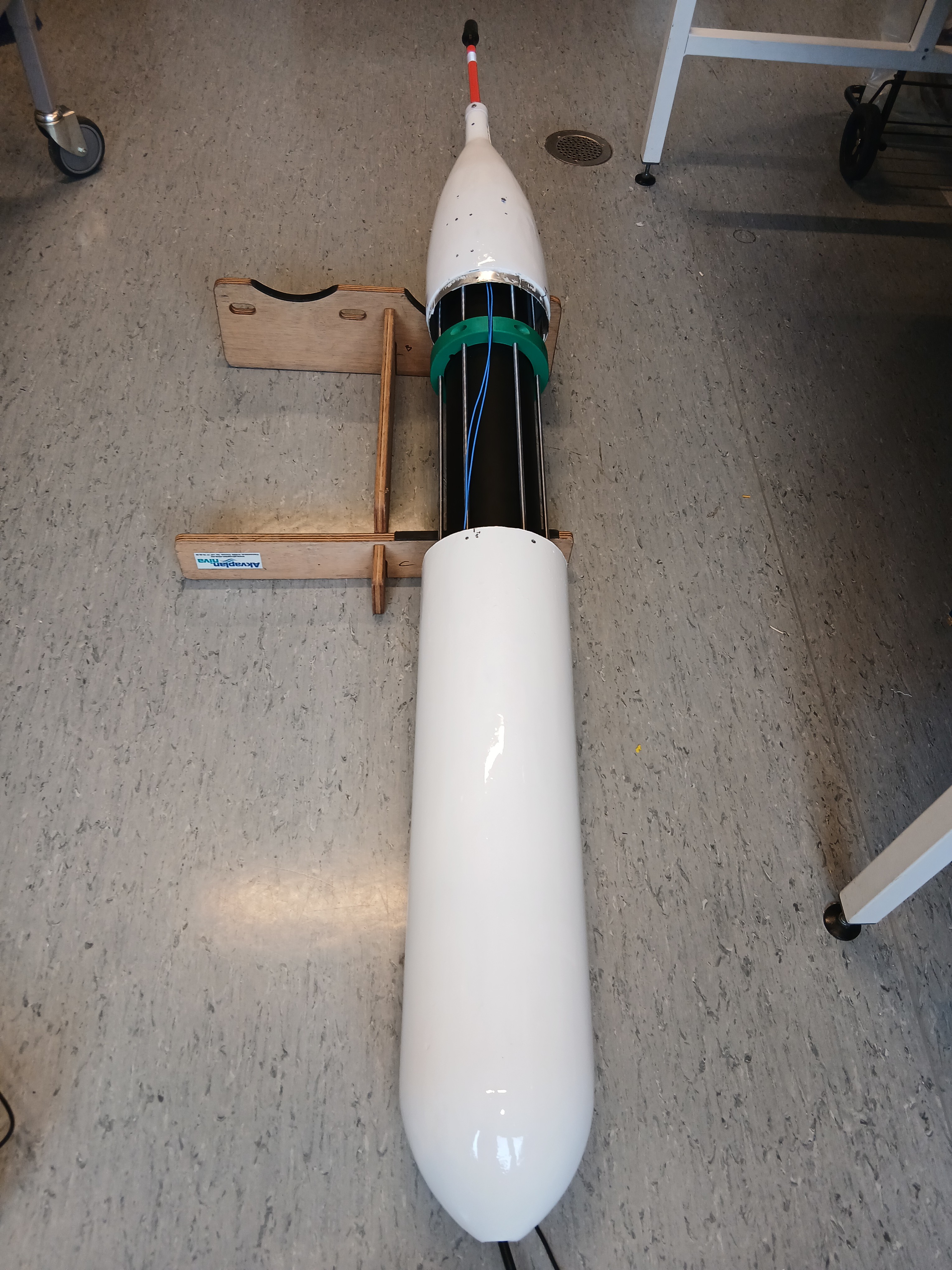

    Had a friend make fiberglass fairings and we almost went for a deployment, but then decided not to rush it and make some more refinements.

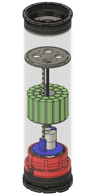

    For the mass shifter, steppers weren't strong enough so switch to geared DC motors. Since these motors are slightly larger, I needed to switch to the 50cm housing instead of the 30cm one.
    It's a quick and dirty design but does the job for now.
    For the buoyancy drive, I played quite a bit with different types of molds for the diaphragm and finally managed to make one in silicon that has no holes. As for the seal, I used this parametric spring tool to make a large snap ring that would push the diaphragm to the housing and create a seal.
    This together with a little bit of silicon adhesive did the job and I managed to pull a partial vacuum to test for leaks. Then I tested it in water and it does work! Managed to test it down to 5 meters but only have this shot from the initial test.

    I'm still making some slow progress. I'm still experimenting with the design of the mold for the rolling diaphragm seal. I haven't managed to get the result I am looking for just yet. As for the attachment of the seal to the housing, I am now thinking about using some type of snap ring to exert a constant pressure on the walls and create a seal like that. But since I'm waiting for a new order of silicone rubber to arrive up here in the Arctic, I started experimenting with the design of the mass shifter section. I thought it would be easy enough to simply use NEMA steppers for both roll and pitch. I found this cool herringbone planetary gear which would do well for roll mechanism.
    After printing and putting things together and some testing, it seems llike the NEMA steppers won't have enough torque to do the job, at least not reliably. So I will probably move to geared DC motors and potentiometers.
