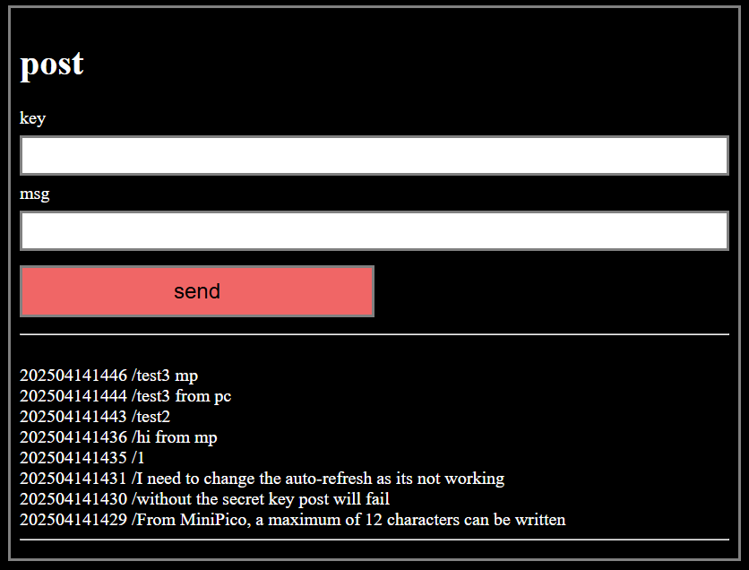

    I also wanted to find a way to send a "tweet" (I don't know what they call them anymore now that it's not twitter) to my X profile. I tried messing around with the X API directly, but to no avail. Then it appears that most people are using IFTTT, but now they charge for webhooks. So that's a no go.
    So my solution was to create POST, and host it on my website. Basically this is a "chat" that if someone has the secret key, they can post a message to.
    If connected to WiFi, the MiniPico is able to read all messages using the command "s.g". I had to implement text wrapping to OLED output, as well as add the ability to page up/down the console output history. Currently there are 21 lines that fit into the history, or 3 pages. That's enough to read the whole list of 8 posts.
    On the server side, it's a text file that every time a post is written to, it bumps the last one off, and adds the new one. Pretty simple really.
    The secret key is hardcoded into the MiniPico's firmware, so to make a post all that is needed is to write "s.p <message goes here>". I need to implement the ability to write lines longer than 16 characters, as this allows for a maximum of 12 characters to be posted.

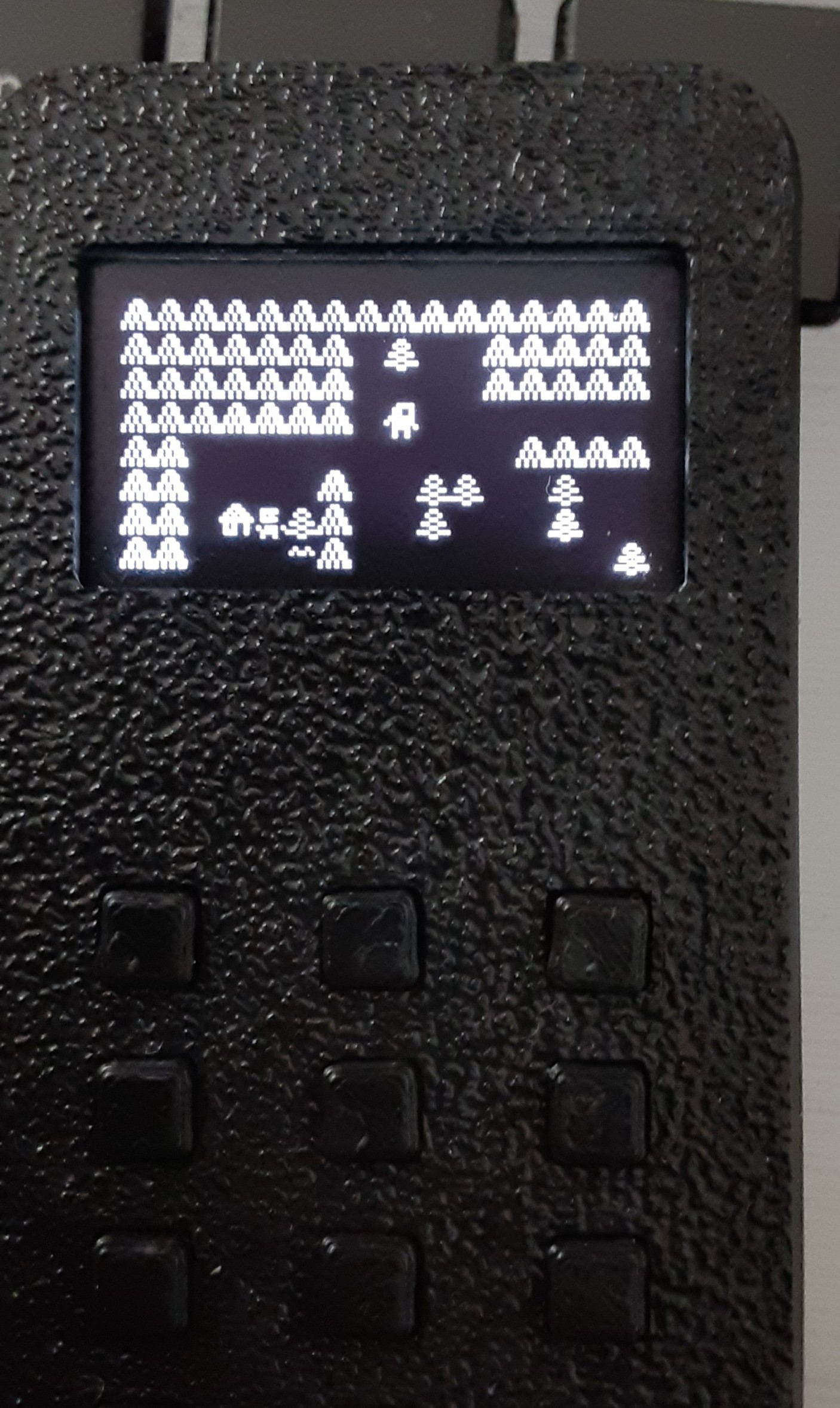

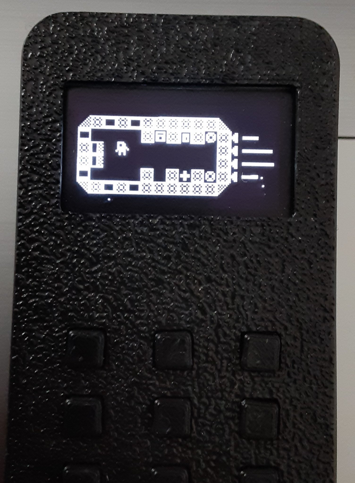

  • Space Roguelike Game/UI
    Gordon04/01/2025 at 16:58 0 comments
    I have had little time to work on this project, but instead of continuing with the interpreter/device code, I started making a little roguelike game the device.
    The basic idea for the game is the player has a ship, and can travel between several different planets. Possibly do some trading.
    Landing on a planet will generate a map, essentially an 8 level dungeon with enemies and a boss at end level.
    After making a playable map, as well as some basic item interaction I got the idea that I could use the game itsel as the UI for this device. While the player is in the ship, they can access the console screen, or check device battery levels or other device settinngs.
    Travel between planets will use constant accelleration. The old "Turn and Burn" procedure.
    All tiles are 8x8, and as the device screen is monochrome, the sprites are stored in bytearrays, so each individual sprite is only using 8 bytes of memory. This will allow many available sprites. The goal for the game itself is to have each planet have its own tileset, enemies, items, and resources.
    I also want to look into prcedurally generating different types of sprites, specifically terrain types and enemies.

    4. [ s.wc<n> ] connect to the network of number specified from networks in list, this will prompt for a password. if command is run without a number, it will try to connect to the last saved network running [ s.w ] will do the same thing as   [ s.wc]
    5. [ s.wx ] turns off wifi, whether AP or Client, it goes off. I have it set up so only AP or client can be run at same time.
    I will later impliment a save file on flash that will have different saved settings including saved networks and passwords. when running [ s.w ] in that case it will automatically scan and see if there is a saved network that matches, then connect.
    I have also created a new function specific to the Pico Picow for easier printing of lines and getting input from anywhere in the devices code. While running the interpreter, the device is basically always stuck in an input mode. But I realized these system tools will need the ability for input that can be accessed out of the interpreters command line.
    I really want to get back to adding functions for the interpreter, but wanted to make sure 100% that it was all going to work on the device okay before I went any further. So far so good. I have a better backup system I am using right now too.
