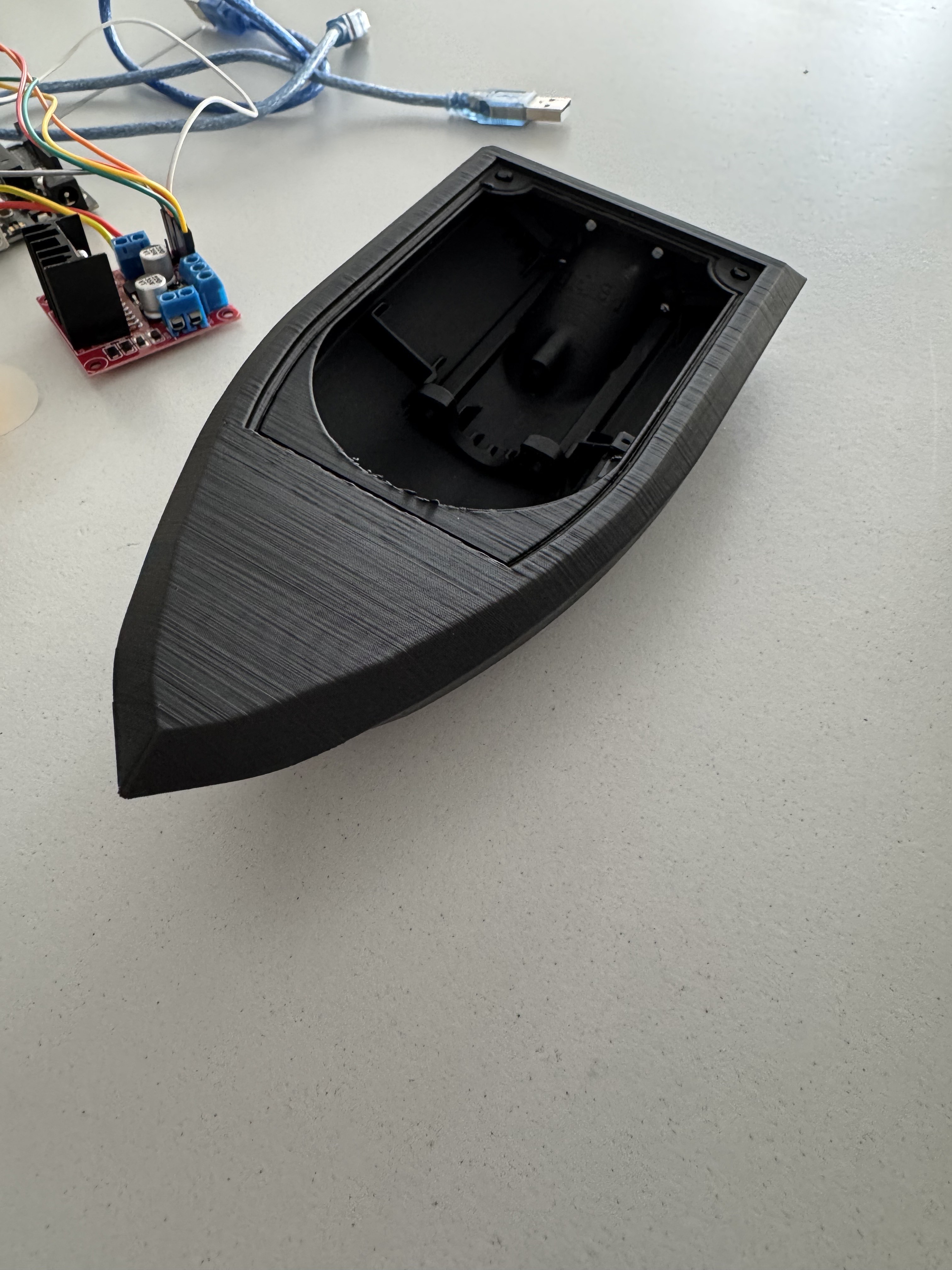

As part of a mechanical engineering project, we designed and built a miniature motorized boat, capable of moving forward, backward and changing direction.
- Boat structure:

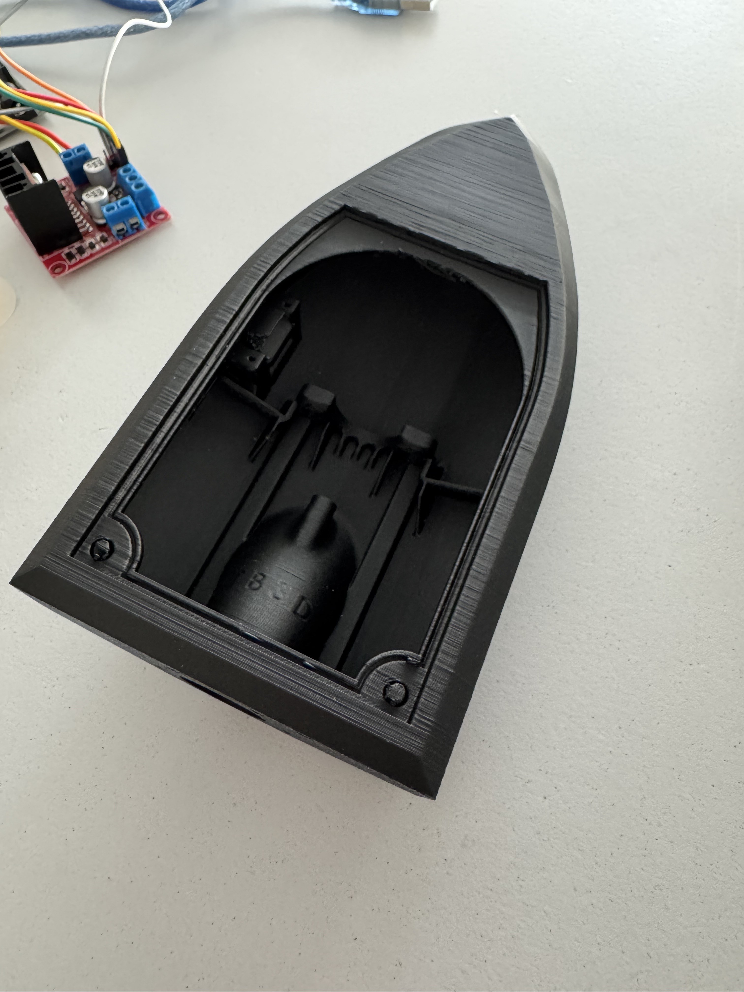

Version 1: an initial cardboard version was used as a test prototype, enabling us to validate component layout and basic functionality.
Version 2: a 3D-printed watertight hull was also designed with a view to future enhancement of the project for more realistic and sustainable sailing.

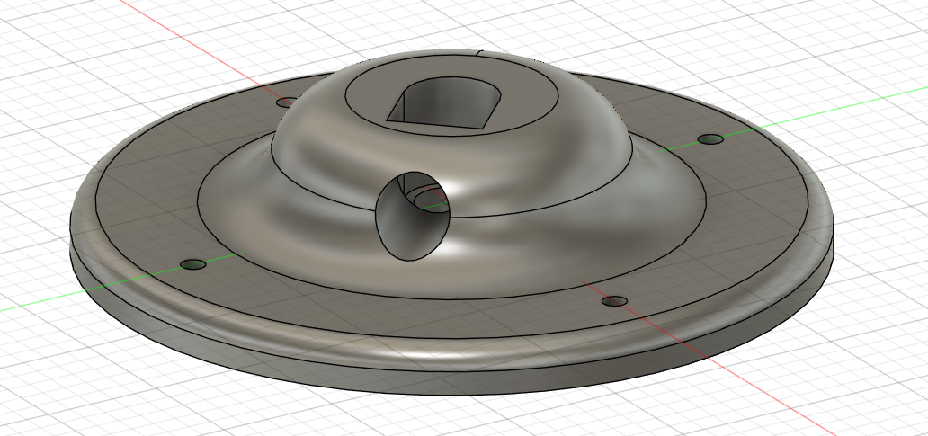

Flasque v0.stl
flange for gears
Standard Tesselated Geometry - 351.25 kB - 05/27/2025 at 09:57

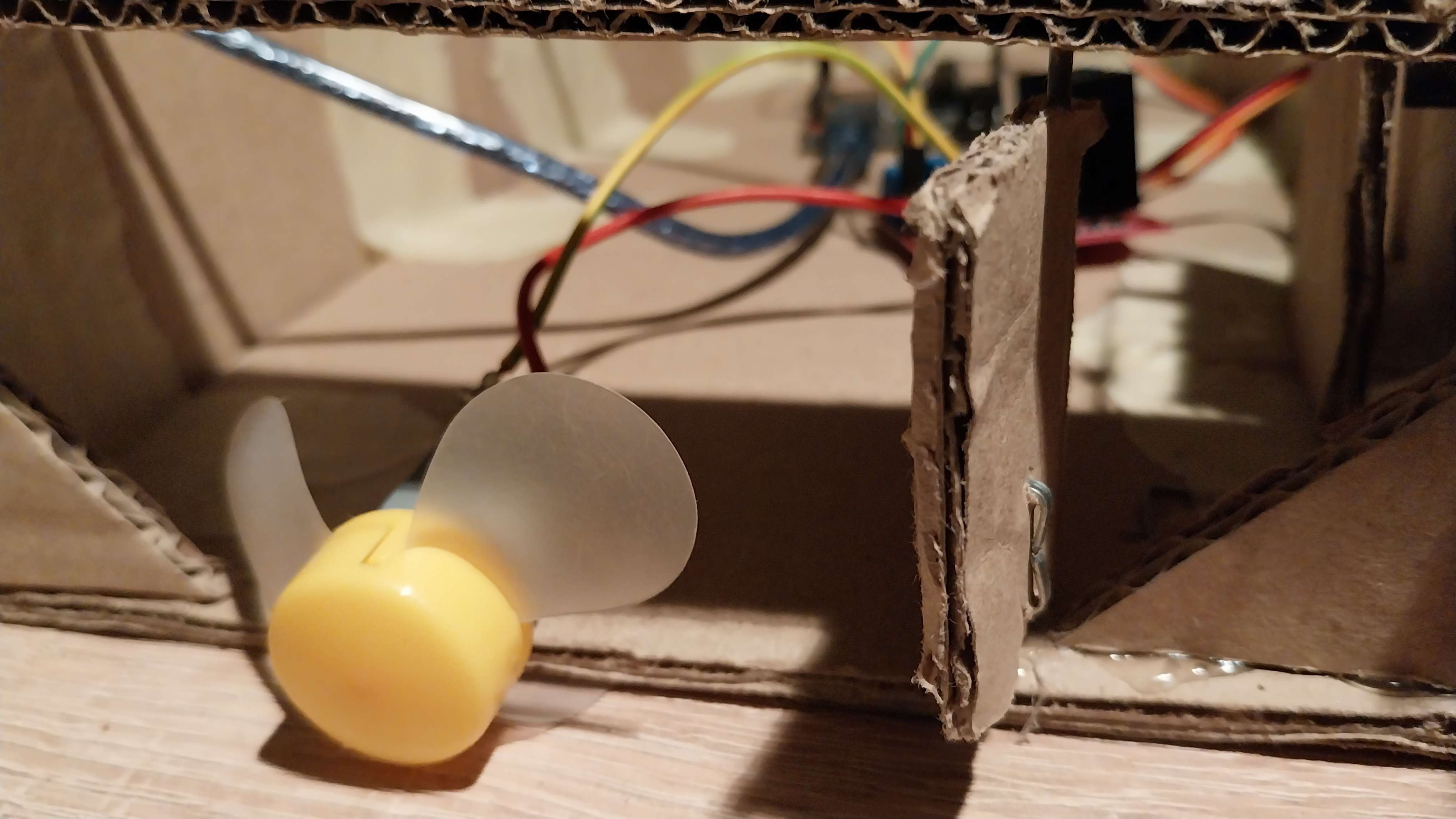

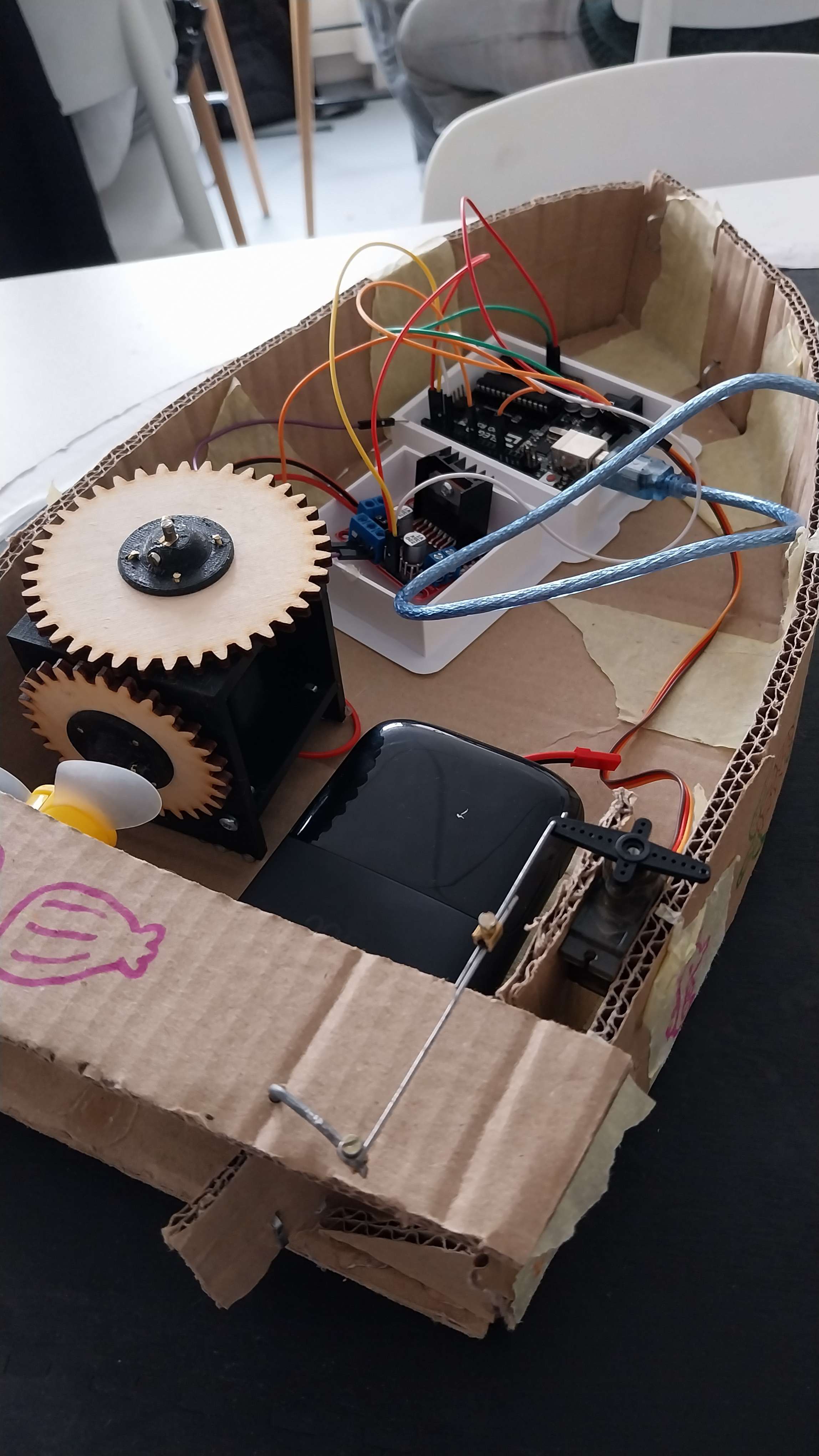

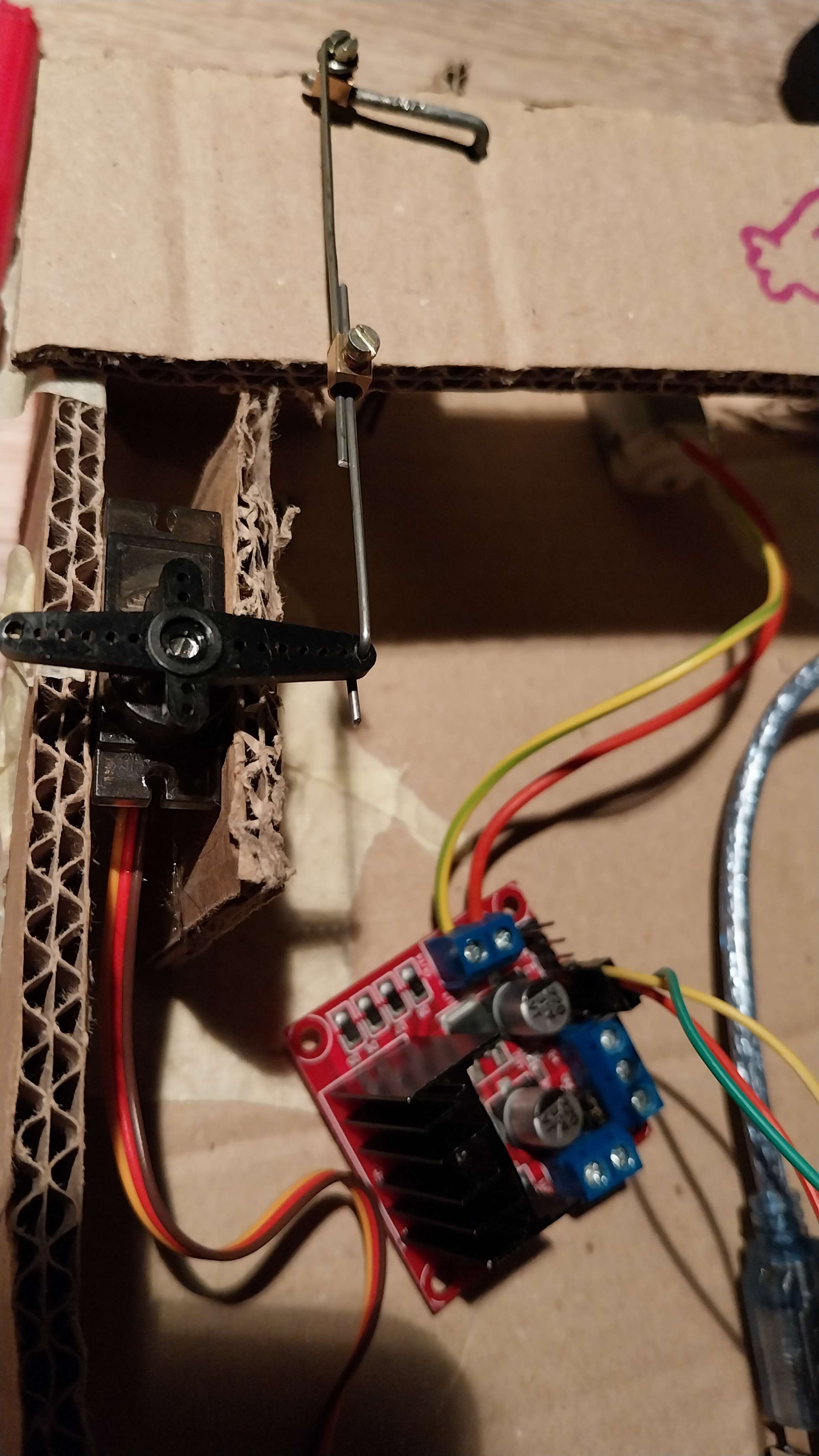

  • Log 11 - 13/05/2025
    theo.ducarne • 05/13/2025 at 13:46 • 0 comments

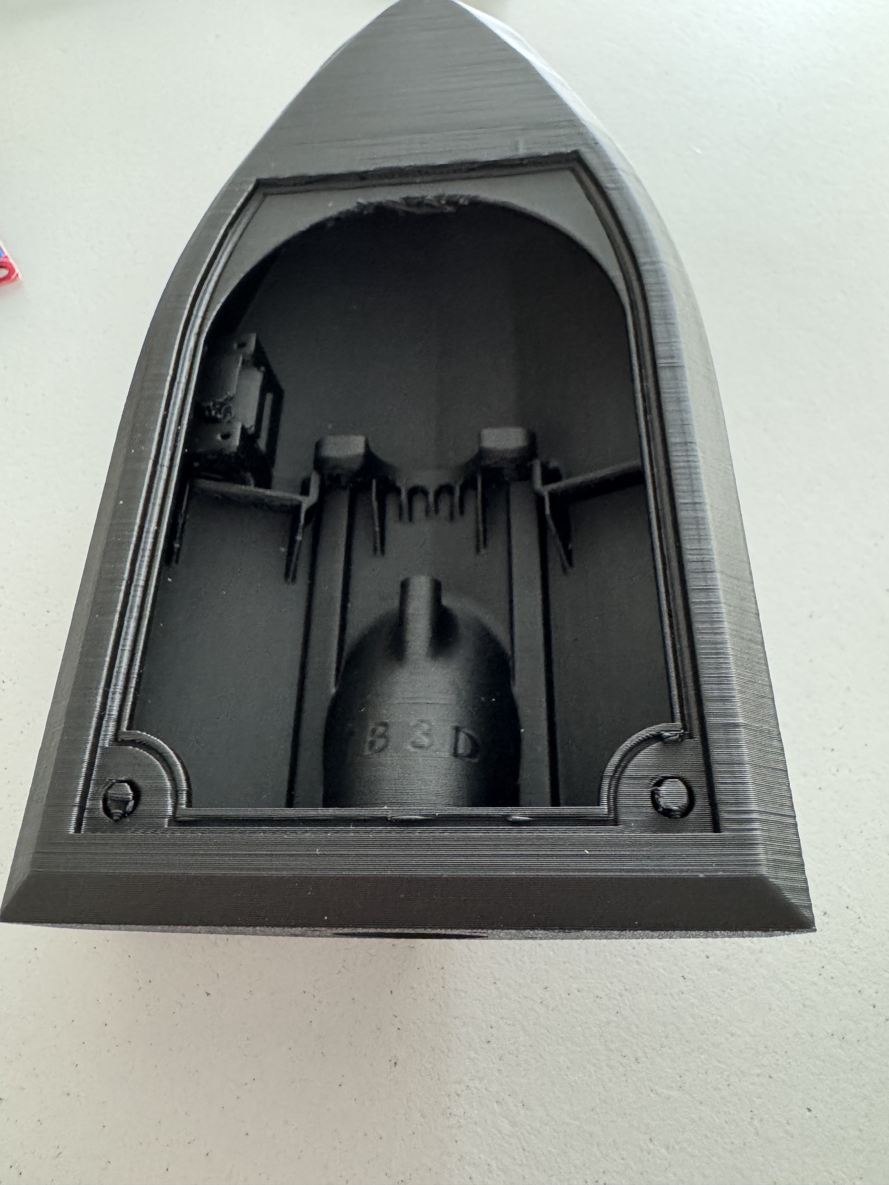

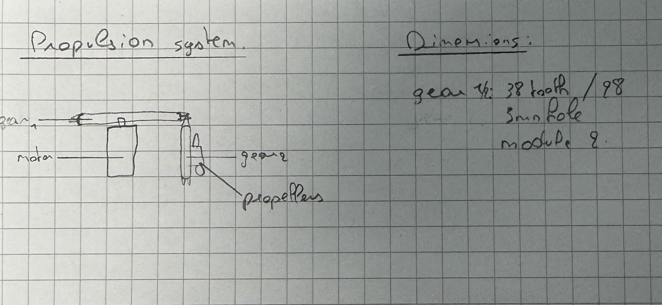

    Functional prototype with gear drive
    - Session summary:
    Improvement session following the functional prototype. We strengthened the assembly by adding protections for the electronics and integrating a more advanced gear-based propulsion mechanism.
    - What we did:
    We designed and 3D printed custom boxes to properly secure the various Arduino boards inside the boat, improving both the protection and organization of the components.
    We also replaced the propulsion system with a gear-driven mechanism: two cogwheels now transmit the movement of the motor to the propellers. This system offers better control and greater mechanical complexity.
    - Results / Progress:
    The boat is still running smoothly after these modifications. Components are better secured and protected, and the gear system works as intended, making movement smoother and more realistic. The project now features a more robust and realistic propulsion system.
    - What remains to be done:
    Finalize the documentation of these improvements, including schematics and design files for the boxes and gears. Gather feedback on mechanical integration and performance.
    - What we're going to do next (future project):
    For a future version, the aim will be to use a fully waterproof 3D-printed hull (like the V2 version) to ensure long-lasting operation and better water resistance.

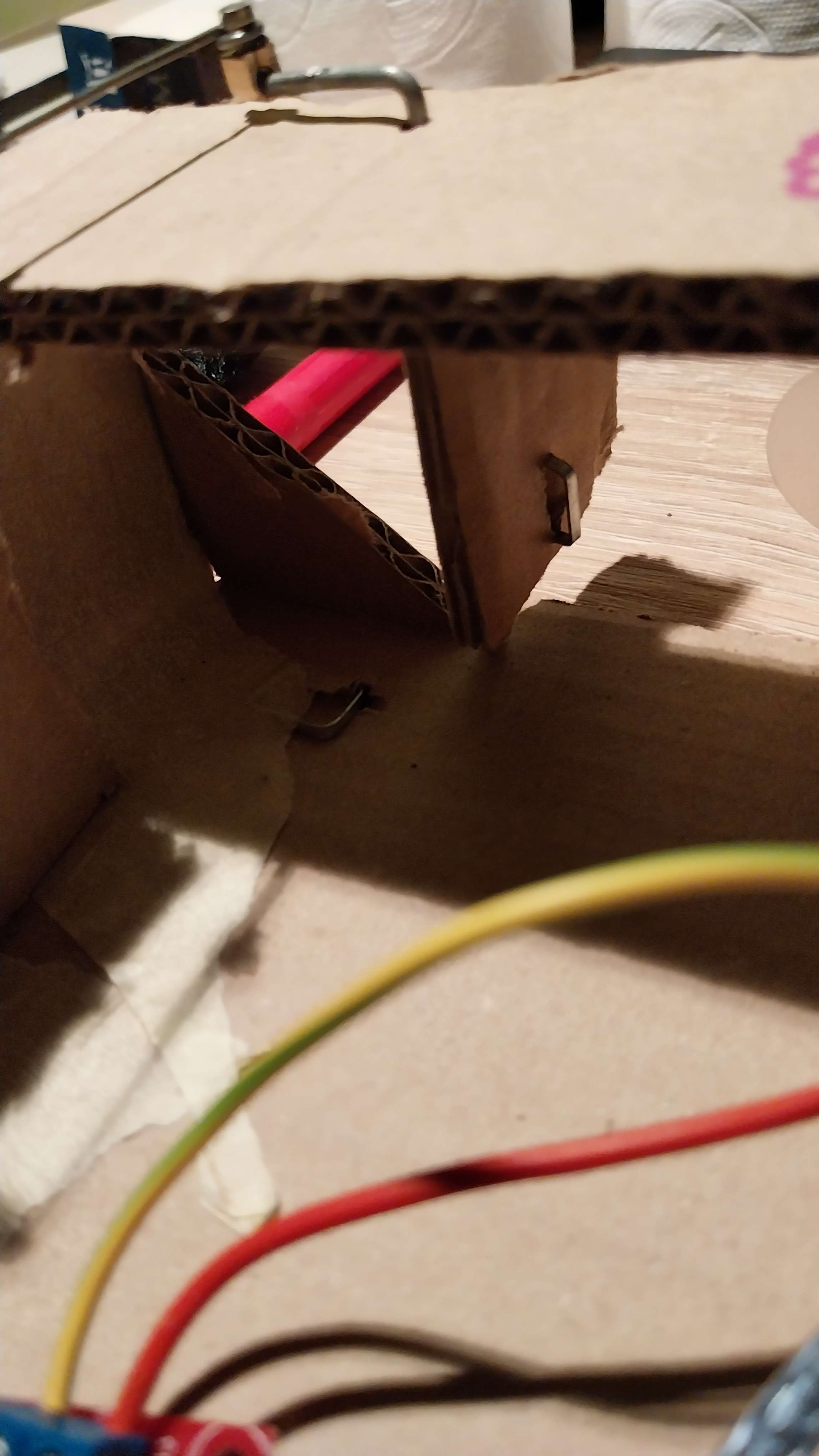

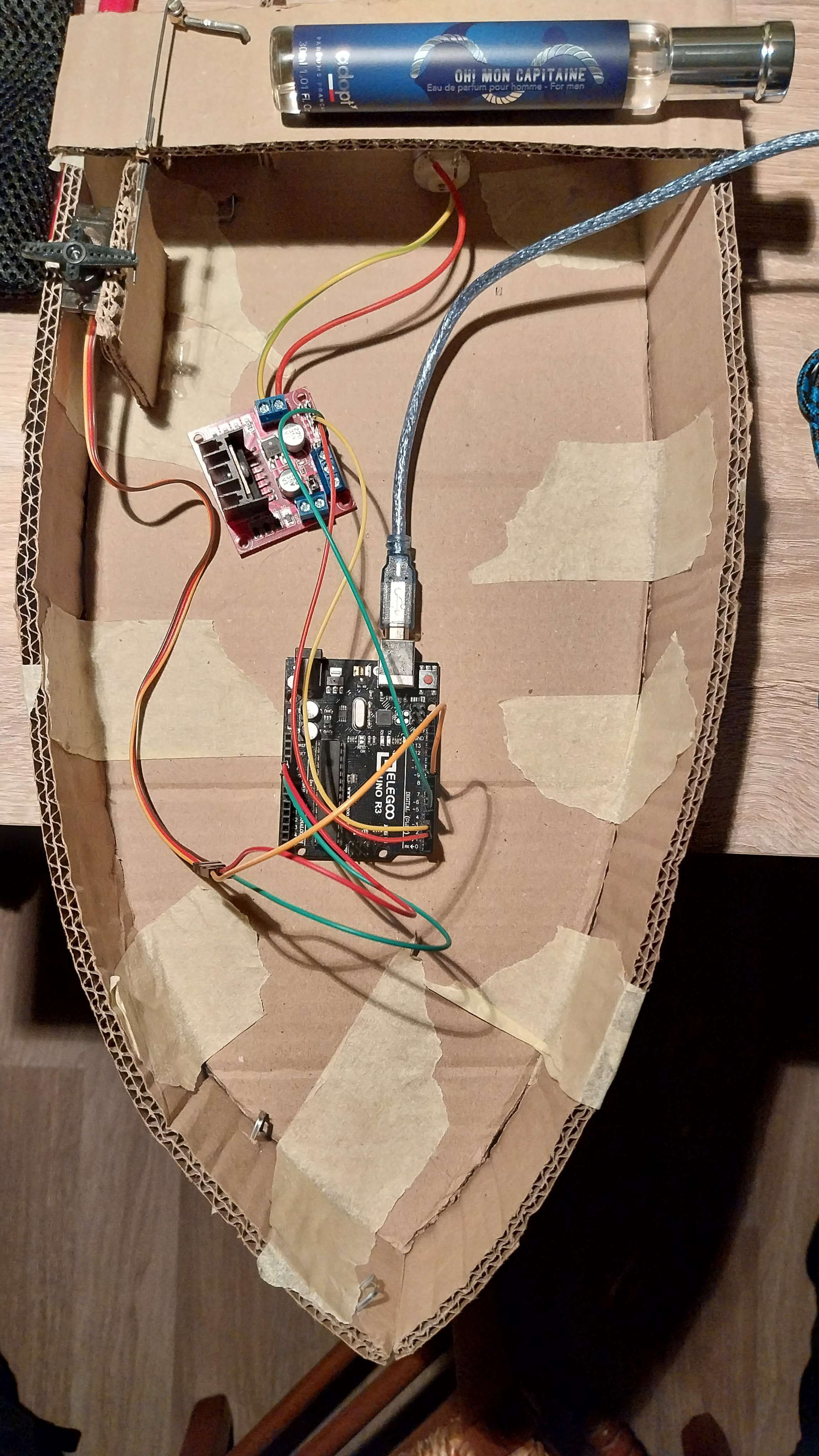

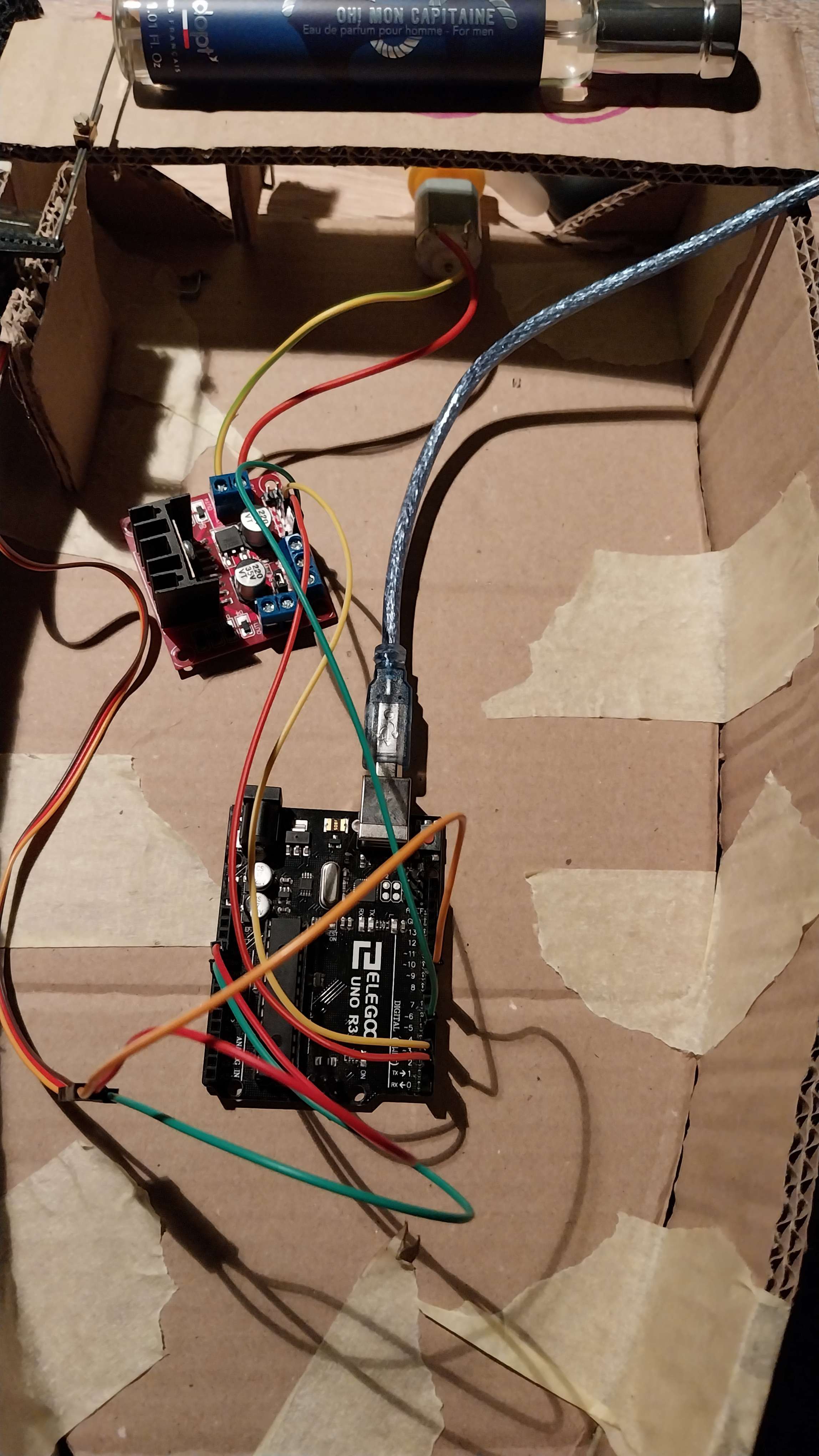

  • Log 10 - 12/05/2025
    theo.ducarne • 05/12/2025 at 16:48 • 0 comments
    Finalizing the project - functional prototype
    - Session summary:
    End of the project with a functional prototype based on a cardboard shell, all components operational.
    - What we did:
    We finished assembling the boat with the cardboard hull. All components - propulsion and steering motors, control board, battery - have been successfully installed and tested. The system responds to commands, and tests in simple conditions confirm overall good operation.
    - Results / Progress :
    The prototype is fully functional. Steering reacts well and propulsion is efficient, even with a hull made of provisional material. This model has validated the whole concept.
    - What we need to do:
    No immediate tasks for this prototype, but we need to document the project and keep the feedback.
    - What we'll do next (future project):
    For an improved version, the aim will be to design a boat with a truly watertight hull, like the one we've modeled and 3D printed (version V2). This will make the watertightness more reliable, ensure greater stability, and enable the boat to be used for longer in real-life aquatic environments.

  • Log 7 - 22/04/2025
    theo.ducarne • 04/22/2025 at 10:08 • 0 comments
    3D printing and material list
    - Session summary:
    Continued building the boat and acquiring materials.
    - What we did:
    Initiated 3D printing of the hull.
    Established a complete list of components required, with references (battery, motor, shaft, nuts, threaded inserts, gaskets, adhesive tape, heat-shrink tubing...).
    Material validated and printing in progress. We have everything we need to assemble the boat.
    Assemble components as printing is completed.
    - What we'll do next:
    Run the motors and prepare the electrical connections.

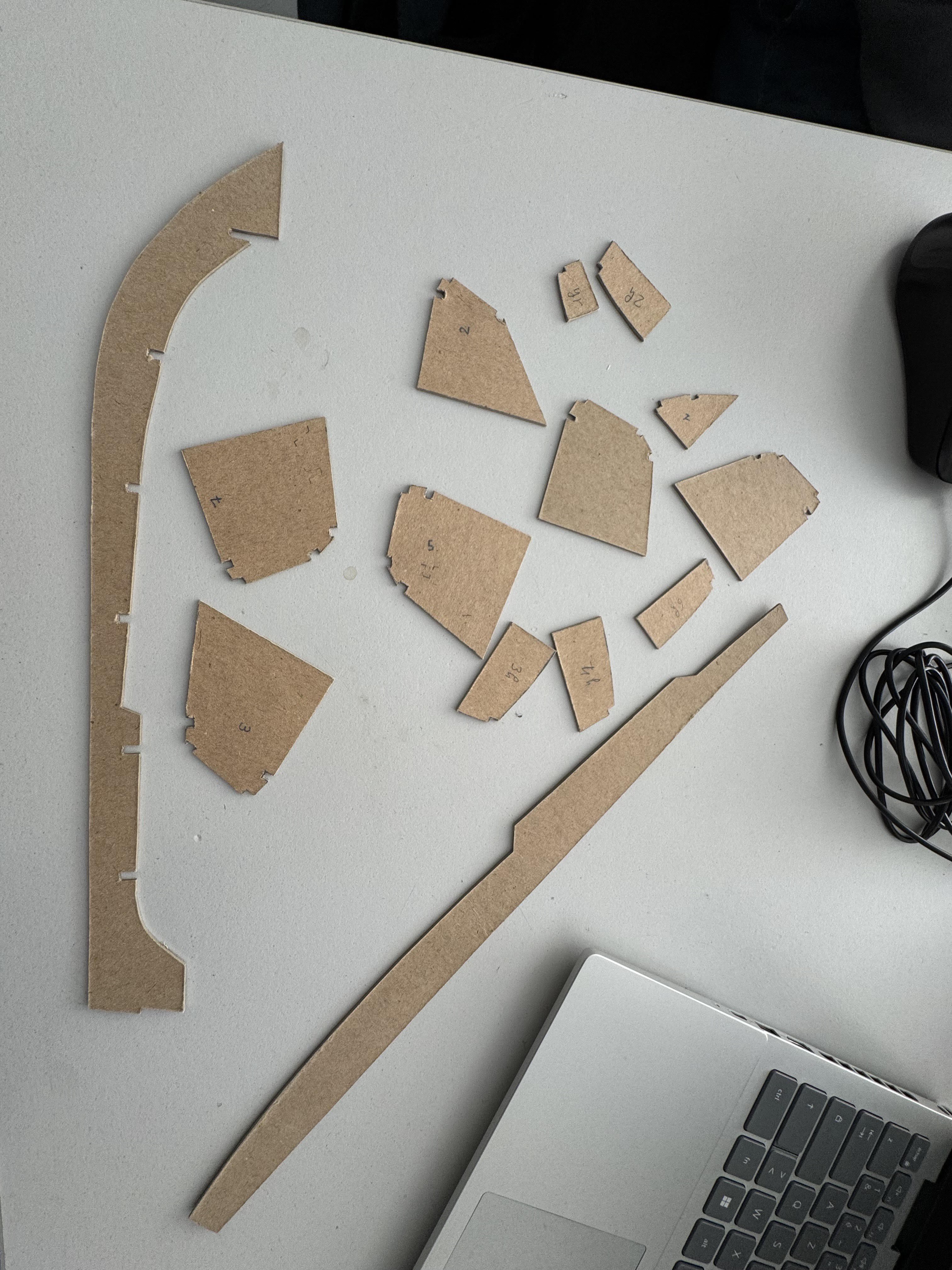

  • Log 5 - 01/04/2025
    theo.ducarne • 04/01/2025 at 10:45 • 0 comments
    Direction study and start of 3D printing
    - Session summary:
    Working on the boat's steering and improving the modeling.
    - What we did:
    Brainstormed on propeller shape and steering system. Needed a fast servomotor to transform rotary motion into linear displacement.
    Modified the 3D model of the boat (moved some parts, strengthened the rudder).
    Start of 3D printing of the hull.
    https://eduscol.education.fr/sti/sites/eduscol.education.fr.sti/files/ressources/pedagogiques/17682/17682-hydrodynamique-comment-faire-avancer-un-bateau-ensps.pdf
    Significant progress on the directional plan and start of physical tests via printing.
    Test the printed rudder and validate the design.
    Continue component assembly and validate the interior layout.

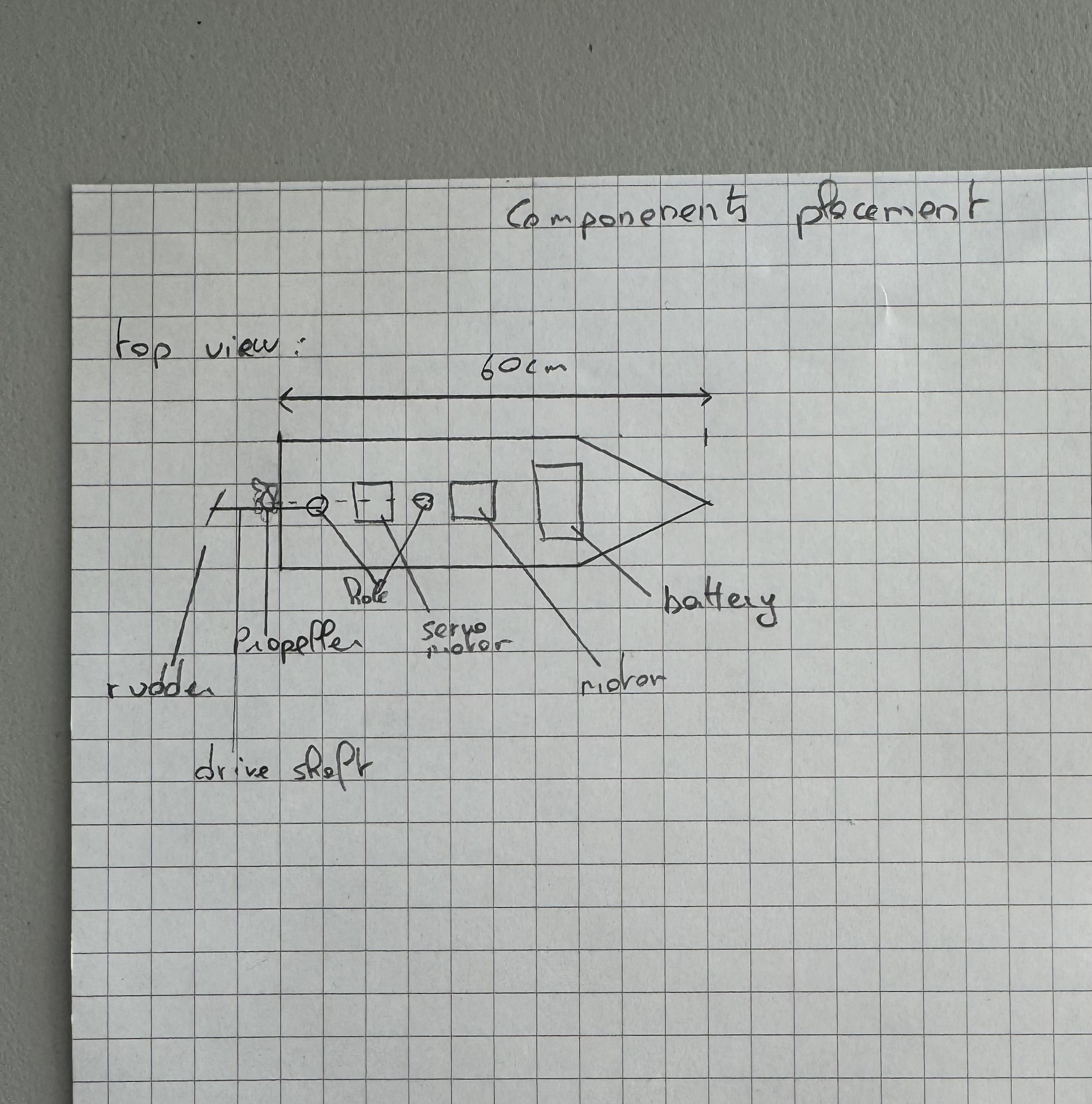

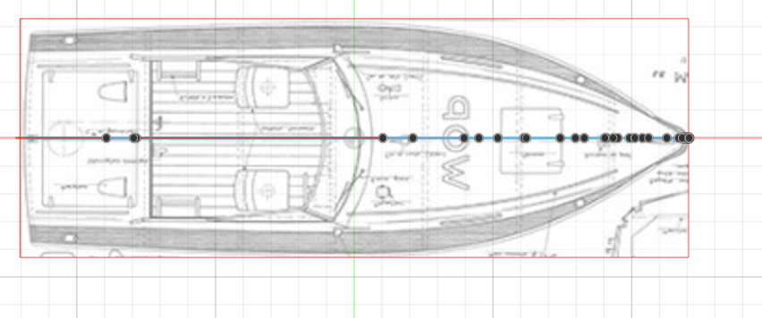

  • Log 4 - 18/03/2025
    theo.ducarne • 03/18/2025 at 10:24 • 0 comments
    Propulsion study and V2 modeling
    - Session summary:
    Work on the boat's propulsion and the materials to be used.
    - What we did:
    Study the link between engine and propeller via a drive shaft passing through the hull. Choice of water-resistant materials (stainless steel, brass, engineering plastics).
    Revised boat dimensions: 60 cm long, 18.5 cm high.
    Start of modeling in Autodesk Fusion. Launch of version 2 (V2) of the boat.
    Better adaptation of dimensions to internal layout. Good basis for propulsion.
    Complete digital modeling of the hull and engine system.
    - What we'll do next time:
    Finalize the 3D design of the boat on Autodesk fusion.

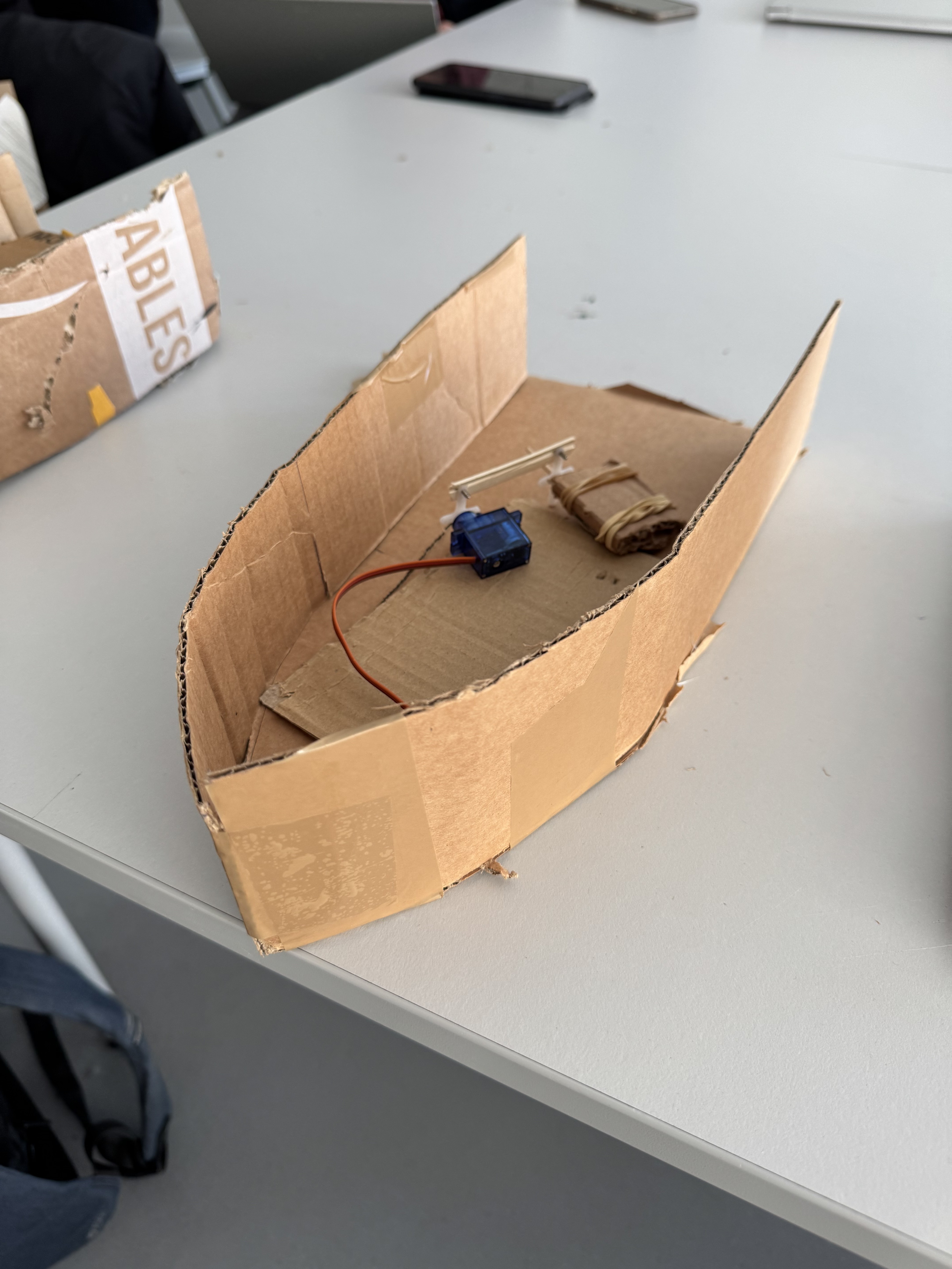

  • Log 3 - 11/03/2025
    theo.ducarne • 03/11/2025 at 11:46 • 0 comments
    First mock-up and feasibility tests
    - Session summary:
    Feasibility tests with a first cardboard model.
    - What we did:
    We made a first model to test whether the motors could be integrated and whether access to the components was easy.
    We also assessed potential buoyancy and began to consider the assembly of the wooden structure.
    Testing different motors and placing components.
    The chosen size seems to be suitable. Components can be integrated, buoyancy seems manageable.

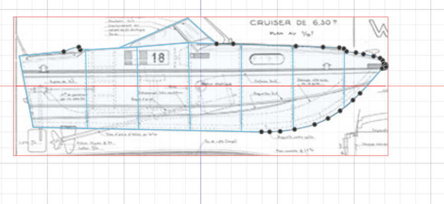

  • Log 2 - 04/03/2025
    theo.ducarne • 03/04/2025 at 09:51 • 0 comments
    Dimensions and choice of components
    - Session summary:
    Beginning of the technical design of the boat with determination of its dimensions and basic components.
    - What we did:
    We defined the dimensions of the boat: 35 cm long, 12 cm wide and 8 cm high, to accommodate the mechanisms.
    The main material will be wood, with plastic elements for the glazing.
    Two motors were chosen: one for propulsion (forward/reverse) and one for rudder (steering).
    Beginning of the boat sketch.
    First draft validated, with consistent choices on materials and components.
    - What we need to do now:
    Finalize sketch views (bottom, side).
    Complete the sketches with all the views required for modeling.

  • 1
    Preparation
    Gather the necessary components (see Components section) and basic tools (glue, cutter, soldering iron, etc.). Familiarize yourself with the general project plan and hull dimensions.
  • 2
    Building the hull
    Produce a first version of the hull in cardboard, to be used as a functional prototype. The dimensions of this hull are approx:
    Length: 35 cm
    Width: 12 cm
    Height: 8 cm
    Carefully assemble the walls with hot glue or waterproof glue, and provide a top opening for inserting the electronic components.
  • 3
    Component assembly
    Fasten all components inside the hull, following the diagrams in the project logs.
    The motor is positioned aft and submerged.
    The servomotor is connected to the rudder.
    The Arduino and battery are positioned centrally to ensure good balance.
    Brackets and housings are made as required, in cardboard or printed parts.
    To avoid direct drive and make propulsion more realistic and efficient, we implemented a gear system between the motor and propeller. Two gears were designed and 3D printed: the first, 60 mm in diameter, is fixed directly to the motor shaft; the second, 80 mm in diameter, is mounted on an independent shaft connected to the propeller. (see files)
View all 7 instructions
