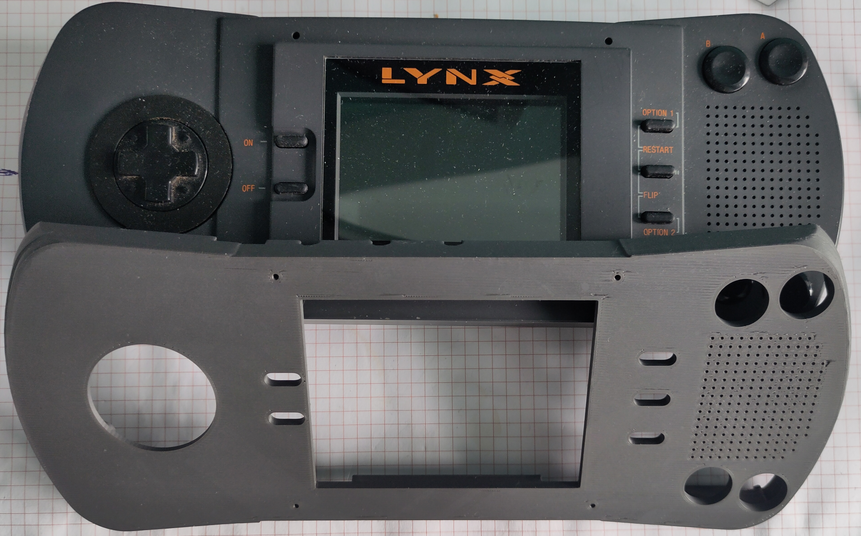

So the assembly is almost finished, and then I suddenly noticed something strange when I placed it next to the original:
The width is wrong. Somehow there is something missing on the right side, and there is more space surrounding the joypad than in my design. Which I have not noticed until now. How could this happen?

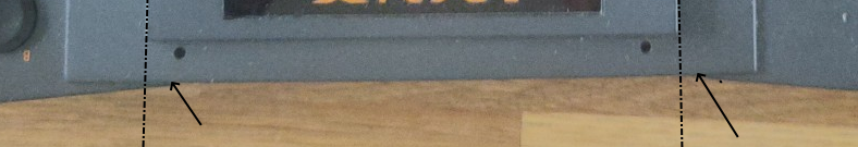

Well, it turns out the Lynx is just not symmetrical, something I assumed all the time while designing my replica housing. Which you can see here:
The screen is in the middle, but the side-sections start at a different distance from the edge of the screen. And once this is corrected, the front indeed looks even more like the original:

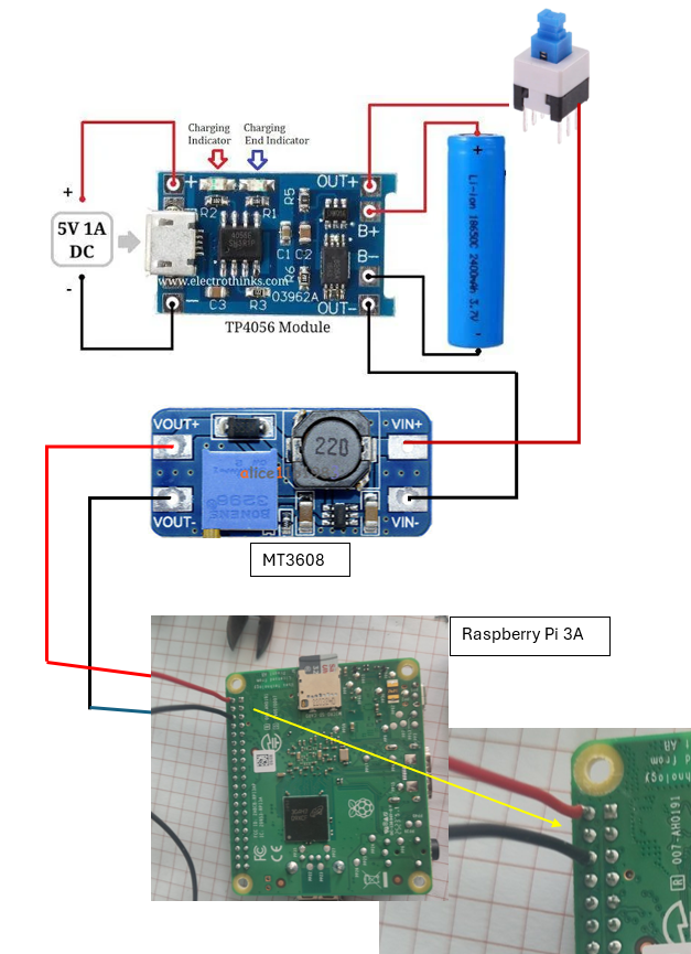

How the power is wired:
The Battery is connected to the TP4056 charger. From there the battery voltage (3.7V) is routed through the switch to the MT3608 voltage converter which is set to exactly 5 VDC output. This voltage is applied directly to pin 2 and 6 of the Raspberry Pi GPIO header.
And so we can test the final circuit. It works!

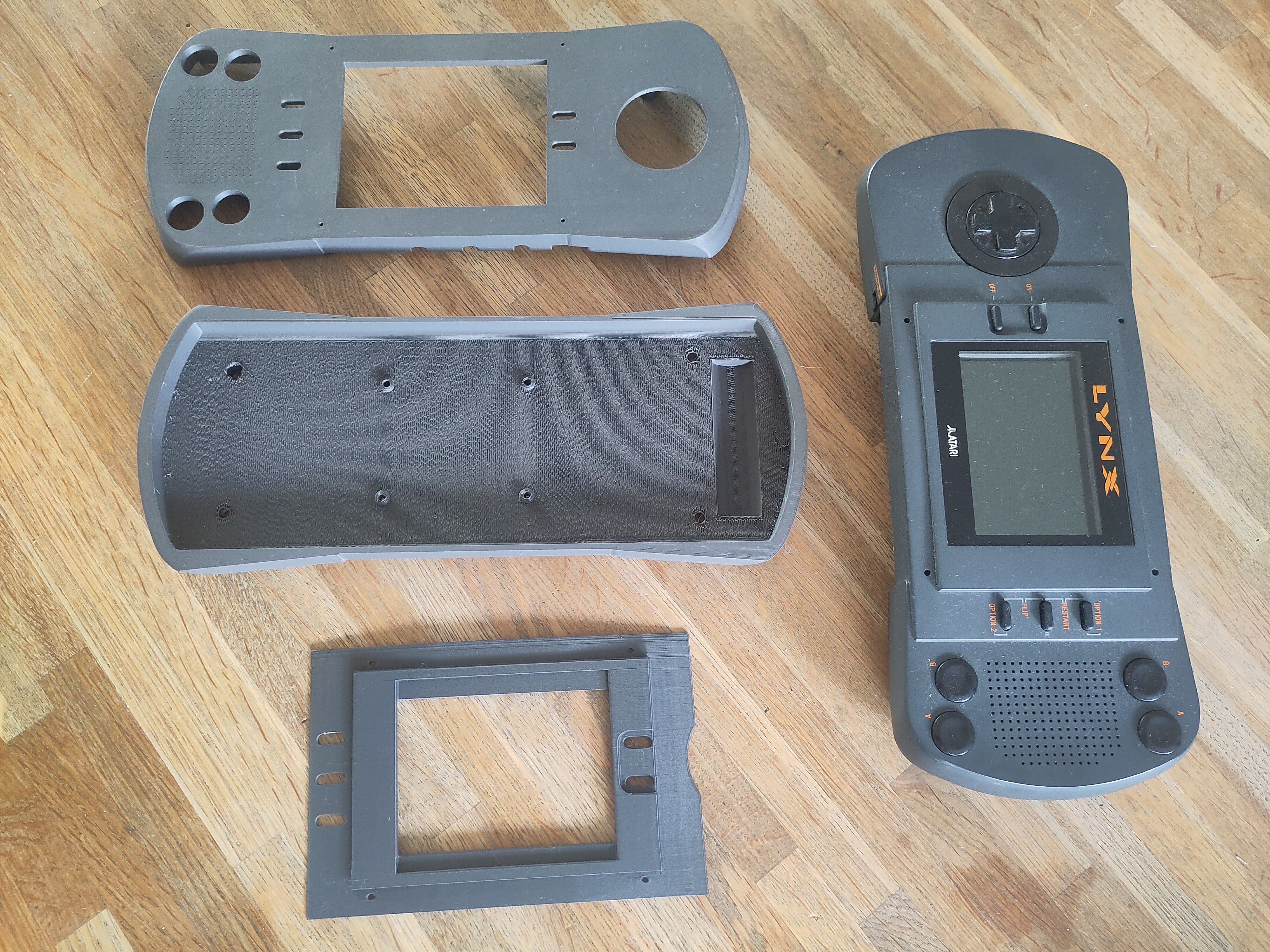

As always, drawing all the tiny little details takes way more time than expected. But I finally got to the point where I could start printing. And it turned out great! Using the 'Polymaker Panchroma™ PLA Matte filament Ash Grey' turned out to be a really good match for the original color.
The top section was printed in two parts. By printing the 'curved' section vertically it gave a real smooth finish.
Yes, it does require a lot a of support material...

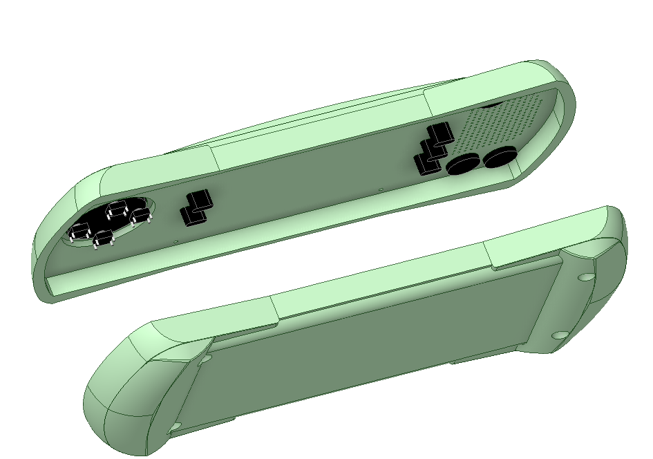

There are a few 3D models of the LYNX available, but I decided to model it myself in DesignSpark Mechanical.
