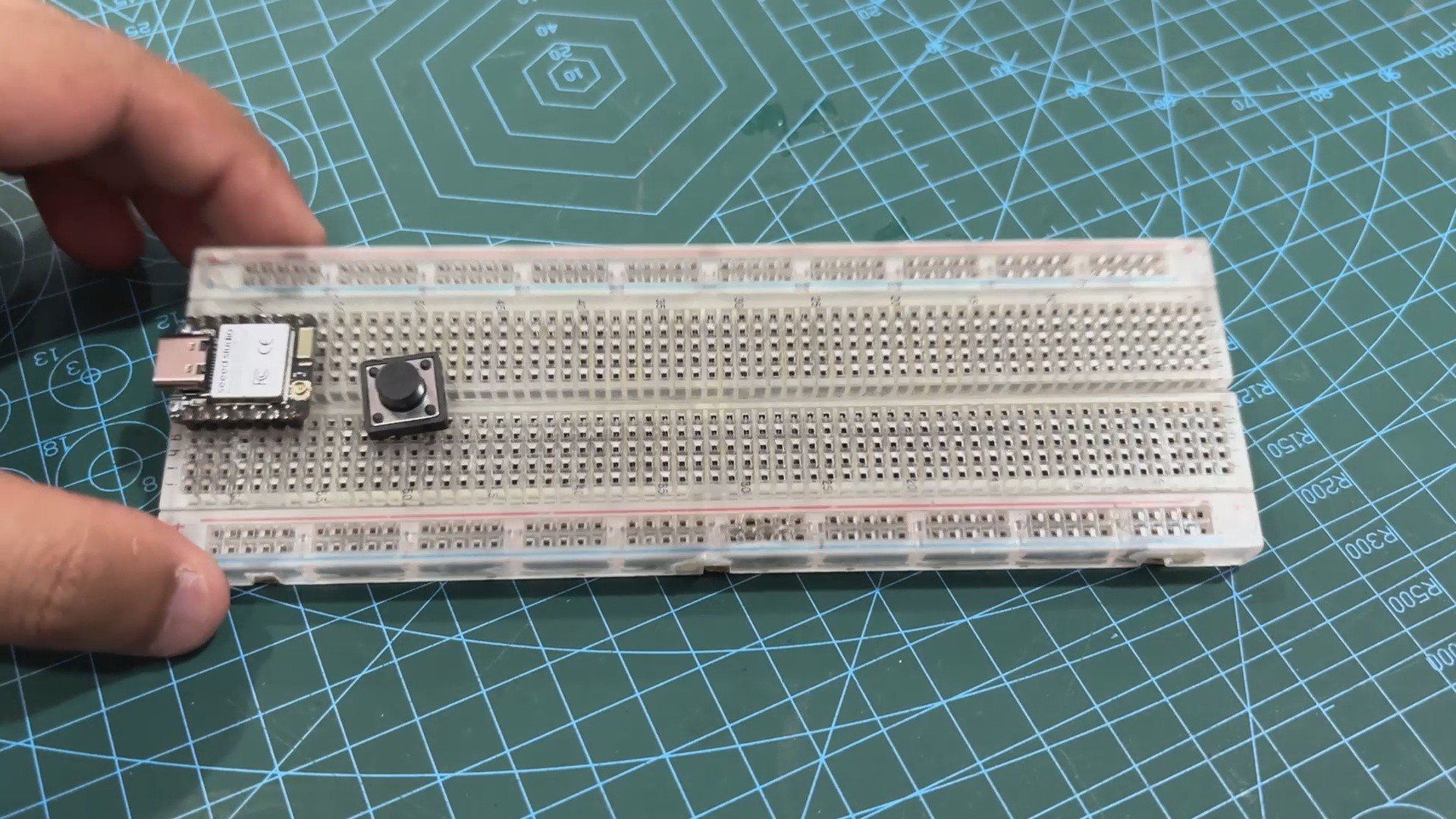

    BREADBOARD ASSEMBLY
    • To begin assembly, we place the XIAO ESP32 C6 microcontroller on the breadboard. Then, we add the Push Button next to it.
    • We begin the wiring process by connecting the matrix's VCC to XIAO's 5V.
    • GND of the matrix is then connected to GND of the XIAO.
    • We wired one terminal of the Push Button to GND and the other to GPIO 1.
    • The matrix data wire connects to the GPIO0 of the XIAO.
    The wiring process is now completed.
