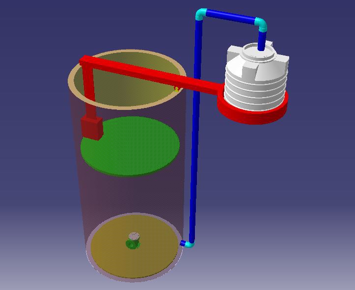

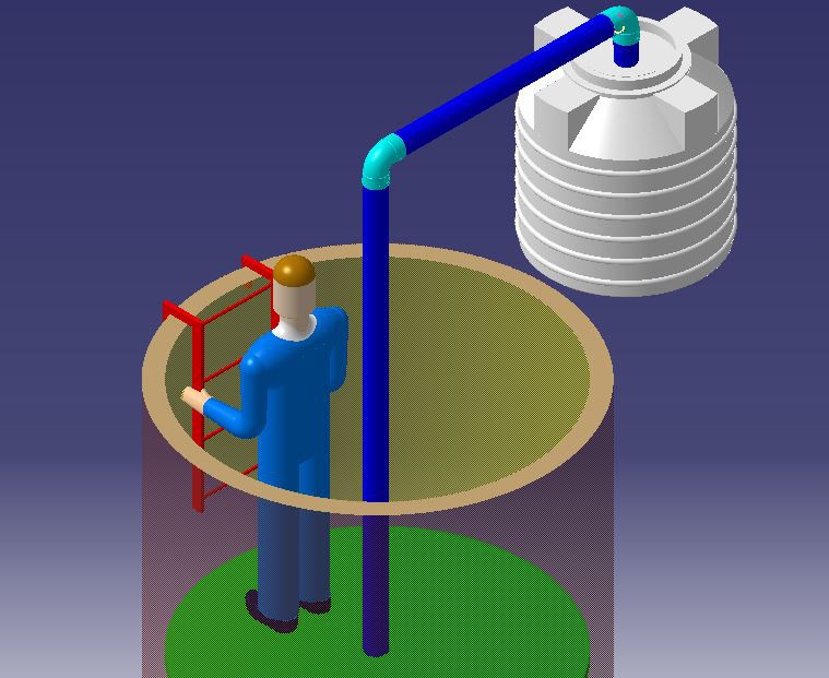

This is done by using the wall casing of the well as a large cylinder with surface area A1, a plate that act as piston on the static water level which is 4.76m to 7.8 meter depth so that a person(s) can stand on it acting as a self-pushing piston rod with force of F1 to push the water found at the static water level down forcing the water up in to the pipe with surface area A2 found on a center of the well with high force of F2 to direct it in to water tank found higher elevation.
The peoples who stand on the large pistons use an extendable ladder or rope ladder to go up without affecting the operating system of the piston. The peoples exert force of F1 that can be calculated from summation of their weight on to the water down ward since the only path of water is through the pipe located on the center of the well, water travel with a force of F2 calculated by multiplying F1 with surface area of the pipe divided by the surface area of the wall casing. This F2 force can also give as the height it will travel upward with ρgh analysis.
The only remaining system that is being developed at this time is the upward return system of the standing piston towards the static water level. We will use the rope ladder or the extendable ladder for people to go up and stop the force on the piston to reverse the mechanism.
This new design is about using a weight balance system to push the piston downward incase weight of person is not enough to overcome the pressure of the water in the well. This will automate the whole system avoiding a person contact by using the water tank as a counter balance weight when enough weight water enters in to it. In opposite side of the weight balance there will be a load of X Kg enough to push water in the well to Y meter depth. Ideally the load weight and the water tank full of water have same weight. When the water tank is empty the load in the well will push the ground water down ward filling the water tank. As the water tanks starts to fill up it will start pulling the load up balancing the weight which will act as an automatic filling mechanism. When people use the water in the water tank the load will start pushing the piston down ward starting the filling process again.
3D model is not in actual size shown here. https://hackaday.io/project/202915-water-well-design-50/log/240442-piston-plate-downward-push

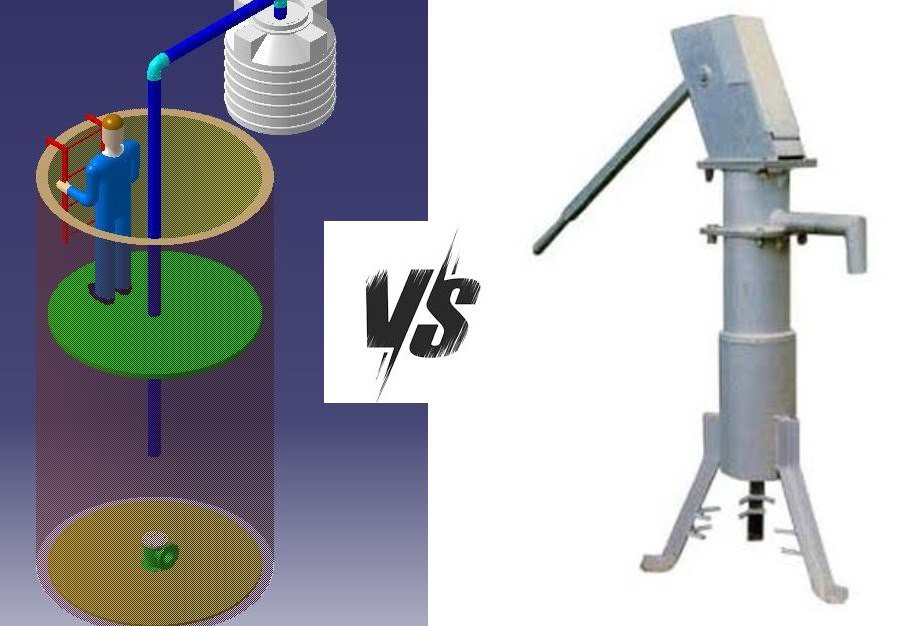

    It is with tangible reasons when we say our well will be game changer. The following are the reasons why we need to switch from hand pump to this version of water well.
    Rural women face several challenges when relying on hand pumps for water access, including physical strain, maintenance difficulties and the potential for pollution or contamination. Lack of proper maintenance, including spare parts and trained personnel, also contributes to these struggles. Specific challenges include:

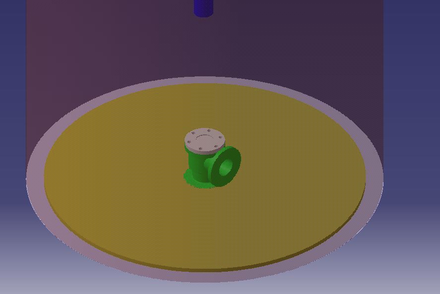

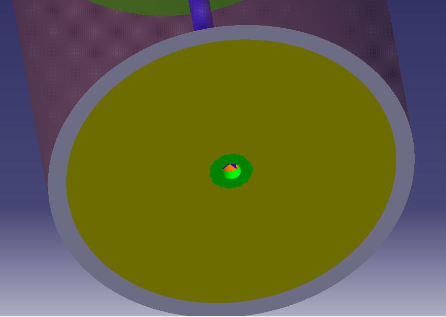

     This water well is also equipped with non-return valve at the base of the cylinder where ground water can enter the well but not out of it which only force user to use the water available at the cylinder rather than over pumping the ground water distributing the water table.

@Florian Festi  Thank you very much for your comment. It is because of you I saw my design flaw.  Please see the improved system of the well and do tell me your thought https://hackaday.io/project/202915-water-well-design-50/log/240442-piston-plate-downward-push
Florian Festi wrote 05/07/2025 at 11:59 • point
The whole idea is just beyond repair. You think a normal pump is too complicated and cumbersome. But you suggest building a pump with cylinder of 1.8m diameter and 5m height.
There are so many things missing or based on bad or at least questionable assumptions. Like
* The wall of the well is straight and smooth enough you can seal against it
* Water won't just be pushed out of the well and back into the ground
* The wall of the well is tight (most wells need large porous areas to let the ground water seep in).
* The piston needs some means to prevent it from tipping and/or jamming
* Water is not accumulating on top of the piston
Using the tank as a counter weight can only offset the increase in pressure from lowering/raising water levels but not the basic lifting. At the beginning the tank is empty and has (more or less) no weight. Using a static weight won't help you much as you need to lift is again to allow water back into the well.
If you don't like existing pump just build a better one. One that can be actuated by the feet or the whole body weight. The main thing about piston pump design is that you can easily match the force available to the pressure needed by choosing the right piston size. This whole idea is backwards in this regard.
