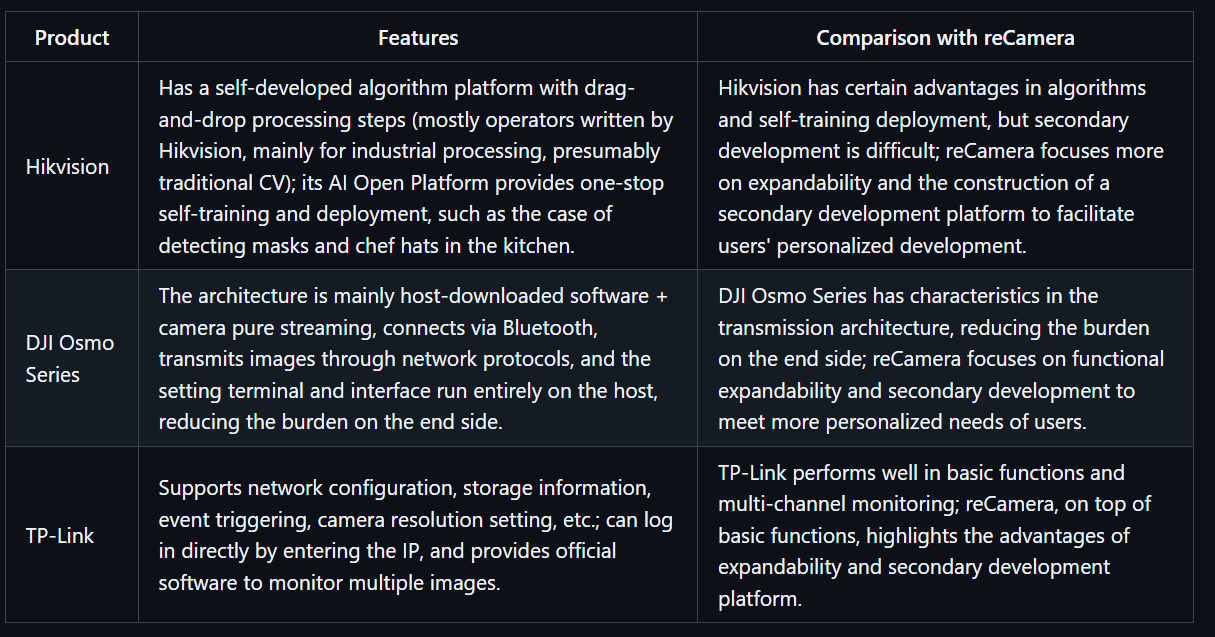

⛳Our vision is clear: to build a comprehensive matrix of AI cameras that meets diverse real-world needs. Last year, we took a significant step forward by launching reCamera 2002—an open-source AI camera reference design hailed as "the shortest pathway to a market-ready AI camera."
From its earliest development stages, reCamera 2002 (please find a comprehensive intro below👇) was shaped by invaluable feedback and suggestions from our vibrant community. It was your collective voice that helped us craft this beloved first-generation device. 💚
Therefore, as we began planning the next evolution of reCamera and the specific construction of our broader AI camera matrix, we knew we wanted to share everything with the community, embracing a radical open-source spirit! 🫶

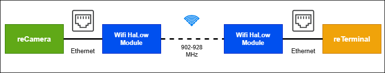

    System Architecture
    The system is built around a simple concept: reCamera connects to a Wi-Fi HaLow module via Ethernet, the terminal device (such as reTerminal or a laptop) connects to the second HaLow module, and both sides communicate wirelessly over a long-distance HaLow link. The reCamera pushes an RTSP video stream and sends AI detection results via WebSocket, while the terminal receives and displays both in real time.
    What You Need for This Project
    1. reCamera (any model) - provides on-device AI inference.
    2. Two Wi-Fi HaLow Transmission Modules/Gateways - create the long-range sub-GHz wireless link.
    3. Terminal device – reTerminal, Raspberry Pi, laptop, or any edge device with Ethernet + display.
    4. USB-C cables (×3) – one for reCamera power, two for powering the HaLow modules.
    5. Ethernet cable – connects reCamera ↔ HaLow / terminal ↔ HaLow.

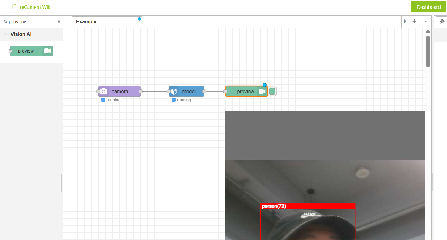

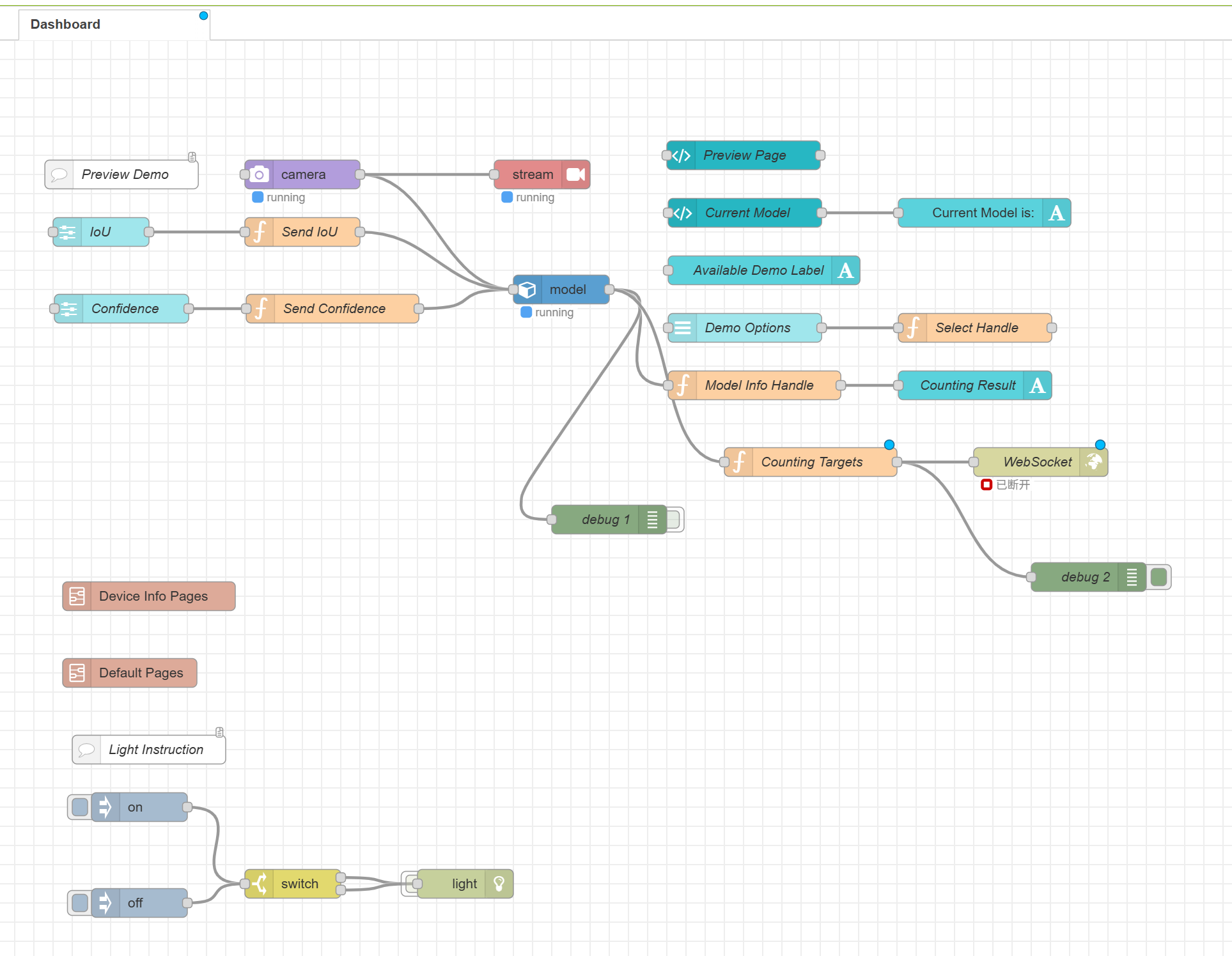

    Step 1 : Log into reCamera, set the camera node (e.g., 480p/5fps), add a Stream node for RTSP output, add a WebSocket node for AI results, and assign a static IP (e.g., 192.168.10.100).
    Step 2: Set one module to AP mode and the other to STA mode, then press the pairing buttons to establish a long-range wireless “virtual Ethernet cable.” The image below demostrates the STA/AP mode selection button and pairing button:
    Step 3: Disable NetworkManager (if using Linux), set a static IP for the terminal (e.g., 192.168.10.3), reboot, and prepare tools like ffplay or VLC to receive the RTSP stream. The final result is illustrated below:
    Step 4: Use ffplay (or VLC) to open the RTSP stream, and run wscat -l 9000 to receive real-time WebSocket AI detection results in the terminal.

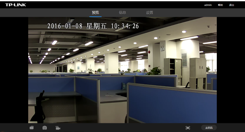

    (Insert image here: final effect — RTSP video + WebSocket text)

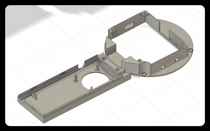

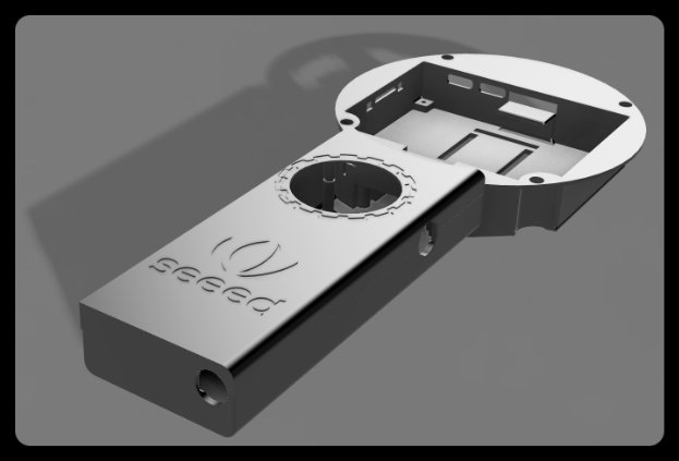

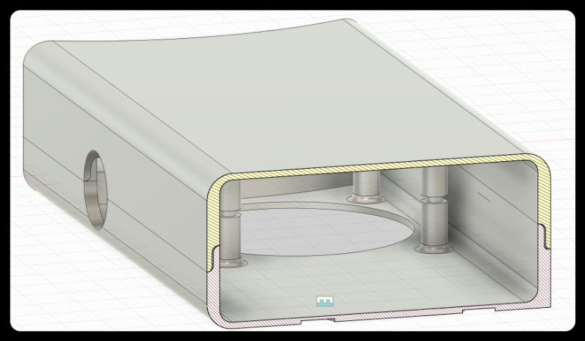

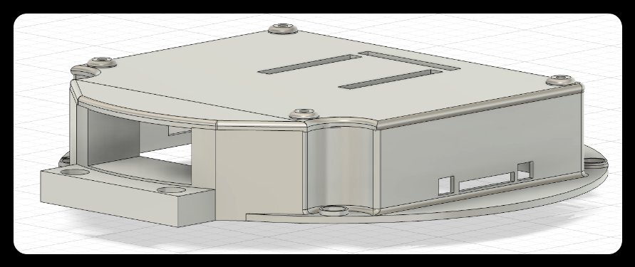

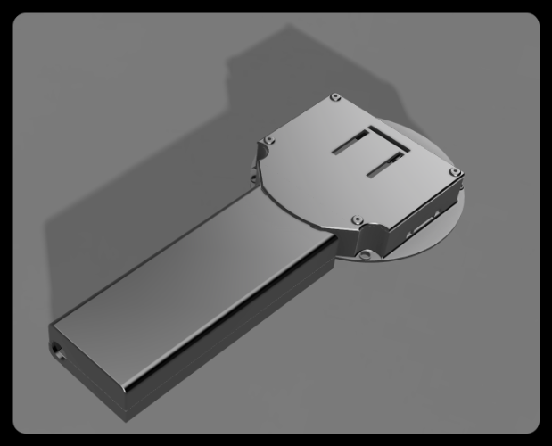

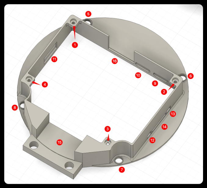

    The SensorCam P4 is a handheld device similar in shape to a magnifying glass. To ensure convenience during 3D printing, we divided the device into the handle and the head. The overall design is shown in the figure below:
    • The handle and the head are connected through a mortise and tenon joint,
    • the front cover and the back cover of the handle are combined by means of a buckle,
    • and the back cover of the head and the main body are combined by magnetic attraction.
    The combined state is shown in the figure below:
    1. Diagram of the connection between the handle and the head
    2. Connection Diagram of Handle Front and Rear Covers (Cross Section)
    3. Magnetic connection diagram of the head and the back cover
    Below are the design details of each module.
    Head
    ❶❷❸❹: Magnet placement slot.
    ❺❻❼❽: Screw fixing hole.
    ❾❿: Type-c port.
    ⓫: USB port.
    ⓬⓭: Button port.
    ⓮: SD card port.
    ⓯: Wire channel.
    ⓰: Reserved space for camera interface.

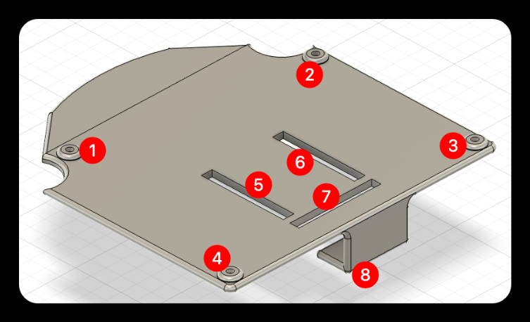

    Head cover
    ❺❻❼: Reserved slot for the female header of the main adapter board.
    ❽: Adapter board support, preventing the adapter board from deforming inward when the module is inserted.

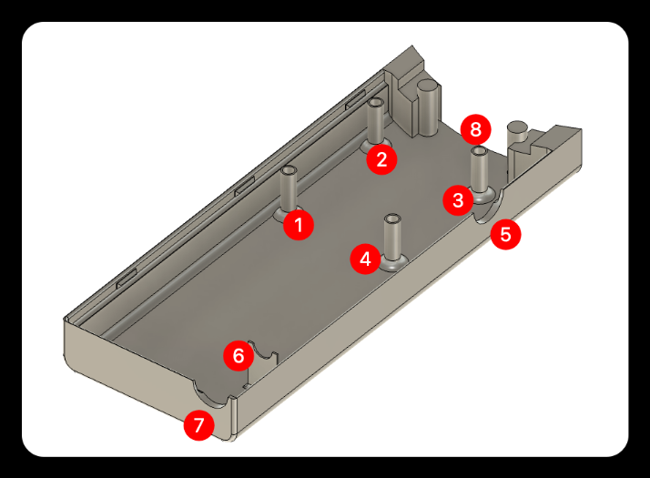

    Handle back cover
    ❶❷❸❹: Coupling female socket.
    ❺: Knob reserved hole.
    ❻❼: Battery DC charging port support.
    ❽: Wire channel.
    Overall effect
    Front Side
    Back Side

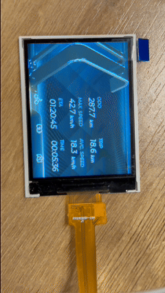

    During the process of selecting a screen for the SensorCam P4, after our comprehensive evaluation and multiple rounds of testing, we finally selected two representative display screens:
    Display A: 2.83-inch 480×640 resolution non-full lamination TFT-LCD screen, supporting 16.7M color display capability and touch function, with a 40pin 18-bit RGB+SPI interface.
    Display B: 2.4-inch 240×320 resolution fully bonded TFT-LCD screen, supporting 263K color display, without touch function, using a 14-pin 4-wire SPI interface.
    These two screens represent different product positioning: Display A is more excellent in terms of pixel density, color performance, and functional integrity; Display B has advantages such as low cost, easy procurement, and a narrow-bezel full lamination structure. Below, we will systematically compare their performance in parameters such as static and dynamic resolution, pixel density, brightness, color gamut, and refresh rate. Considering that the SensorCam P4 is mainly used indoors, we chose to conduct the test indoors.
    Comparison of static display effects
    It can be intuitively seen from the real-shot comparison chart the differences between the two screens in terms of pixel fineness and color reproduction (Display A is on the left, and Display B is on the right):
    1.Display complex images to compare the detail expression between the two
    It can be seen that Display A is significantly superior to Display B in terms of pixel density and edge sharpness, with stronger detail expression.
    2.Display color-rich images to compare color display effects
    It is obvious that the overall display effect of Display A is significantly more delicate and has richer color gradations.
    3.Display the comparison of thermal imaging UI prediction screens
    The performance of the two screens on such images is similar, with no obvious differences.
    Dynamic display performance test
    Display A:Supports MIPI interface, with stable and smooth frame rate performance, fully meeting dynamic display requirements.
    Display B
    ● When using the screen refresh function for color gradient testing, the frame rate can reach 63fps, which is basically smooth.

    Market Cases:
    Most products from large companies are toB types, making it difficult for users to conduct secondary development.
    Hikvision Algorithm Platform:
    Self-developed platform with drag-and-drop processing steps (operators written by Hikvision, mostly for industrial processing, presumably traditional CV). However, Hikvision's AI Open Platform provides one-stop self-training and deployment.
    Hikvision AI Open Platform Case: Detection of masks and chef hats in the kitchen.
    If we focus on expandability, providing a secondary development platform is crucial.
    DJI Osmo Series:
    The architecture is mainly host-downloaded software + camera pure streaming. It connects via Bluetooth and transmits images through network protocols, while the setting terminal and interface run entirely on the host, reducing the burden on the end side.
    TP-Link:
    Network configuration, storage information, event triggering, camera resolution.
    Login directly by entering the IP.
    It also provides official software to monitor multiple images.

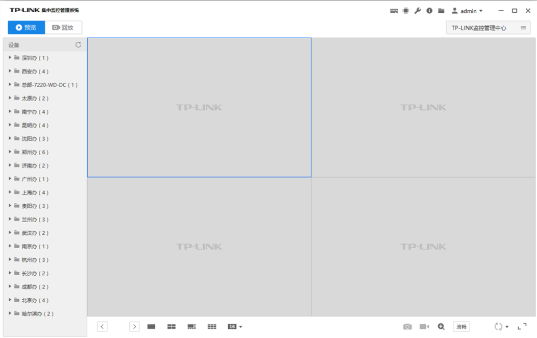

    VCN 19 - Computer client remote monitoring method - TP-LINK Visual Security
    Edge Computing Box - AI Algorithm Box - AI Edge Box - Kunyun Technology:
    Supports SDK interfaces, mainstream frameworks such as PyTorch, customization, 4 Tops computing power, 4K@60fps, but more like re.
