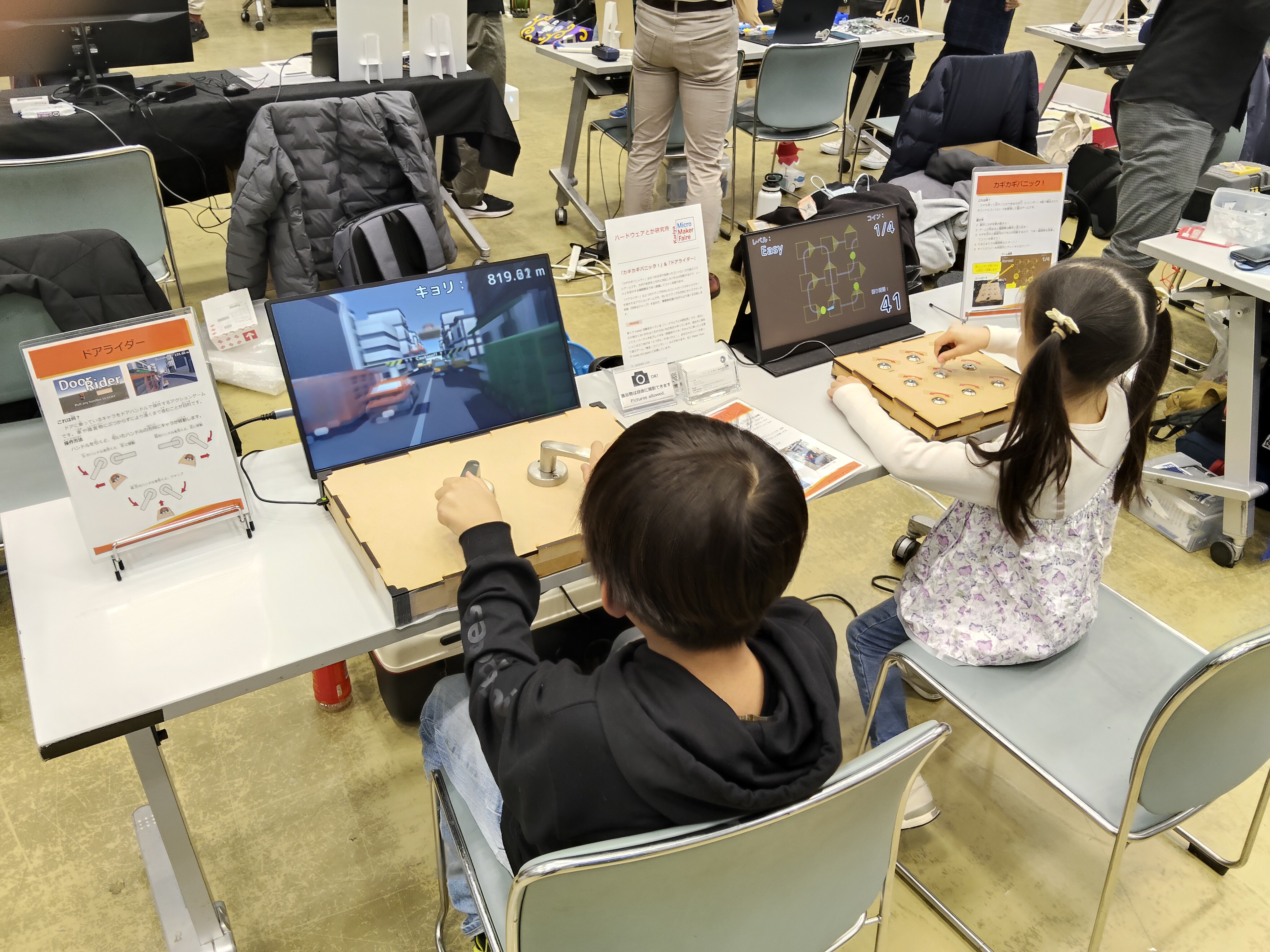

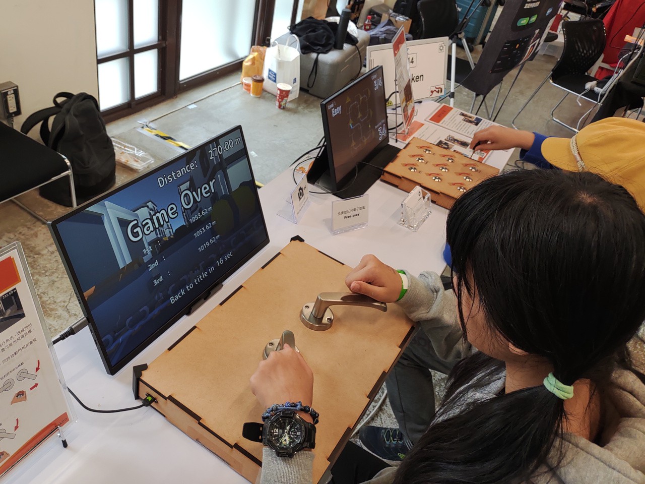

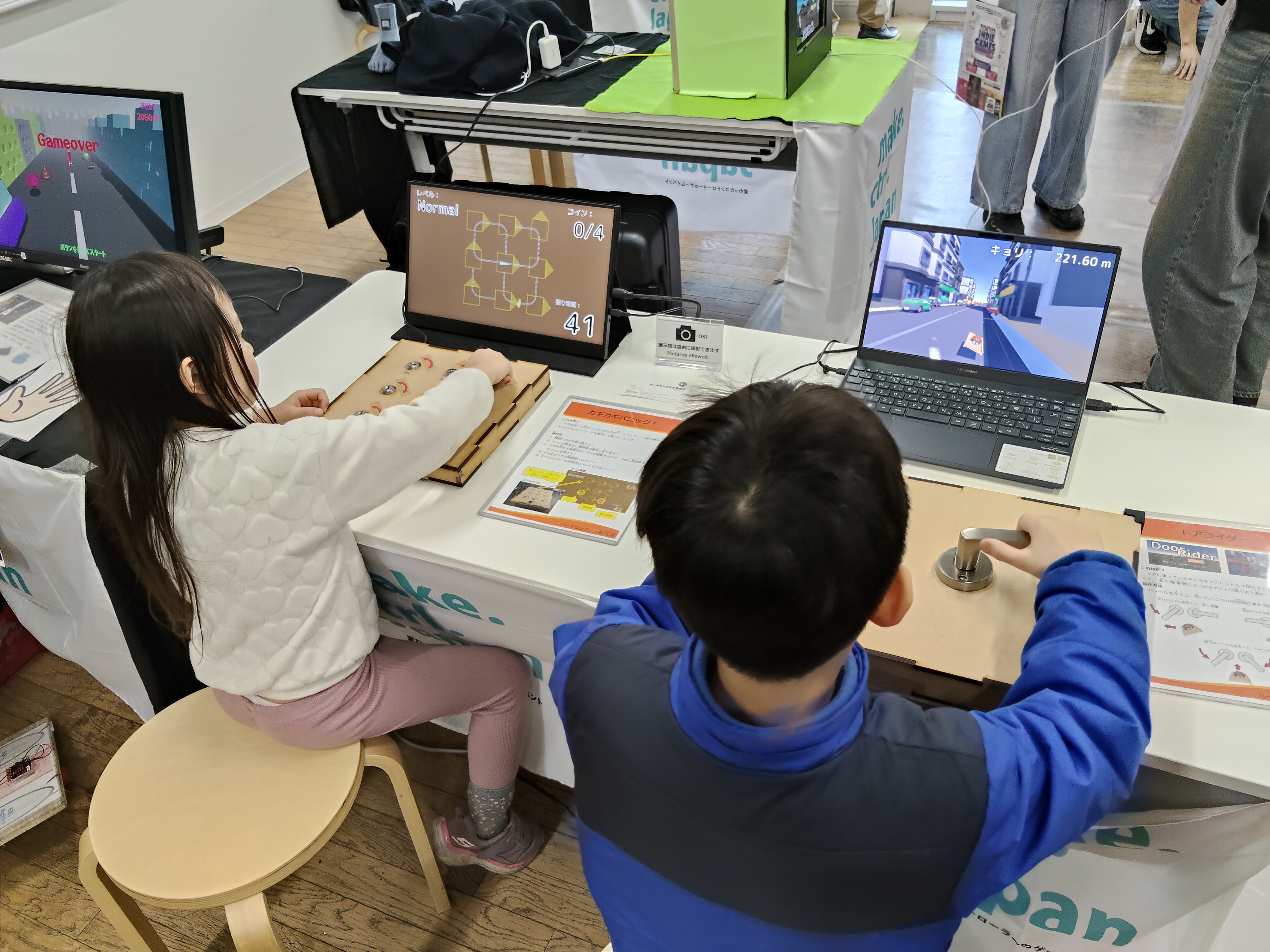

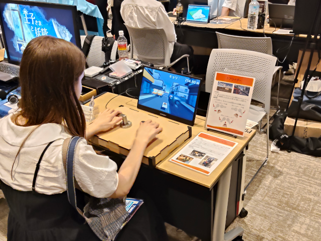

"Door Rider" ("ドアライダー" in japanese) is a action game I made.
This game consists of an original controller and a PC.
The player operates by pulling the door handle on the original controller.
Introduction Video
how to play
The game starts when you pull any handle on the title screen. When the game starts, the character riding on the door will start flying forward automatically. This character can be controlled with two handles. When you pull the handle, the character will move according to which handle you pull. If you pull the left handle, the character will move left. Same for the right handle. If you pull both handles at the same time, the character will jump.
The goal is to go as far as possible without hitting cars or obstacles.
Controller
The controller has 2 handles, those handles are pre-made and sold as a set of two handles. The angle of the handle is detected by a potentiometer(variable register). The part that connects the potentiometer and the handle is made using a 3D printer. The controller also includes a Raspberry pi Pico.
The controller has a USB connector. When you connect this controller to a PC, it will be detected as a USB keyboard. This feature makes debugging easier during developing games. Because if I use a keyboard instead, I can test the game without a controller.
The outside is made of laser cut MDF (55mm thick).
