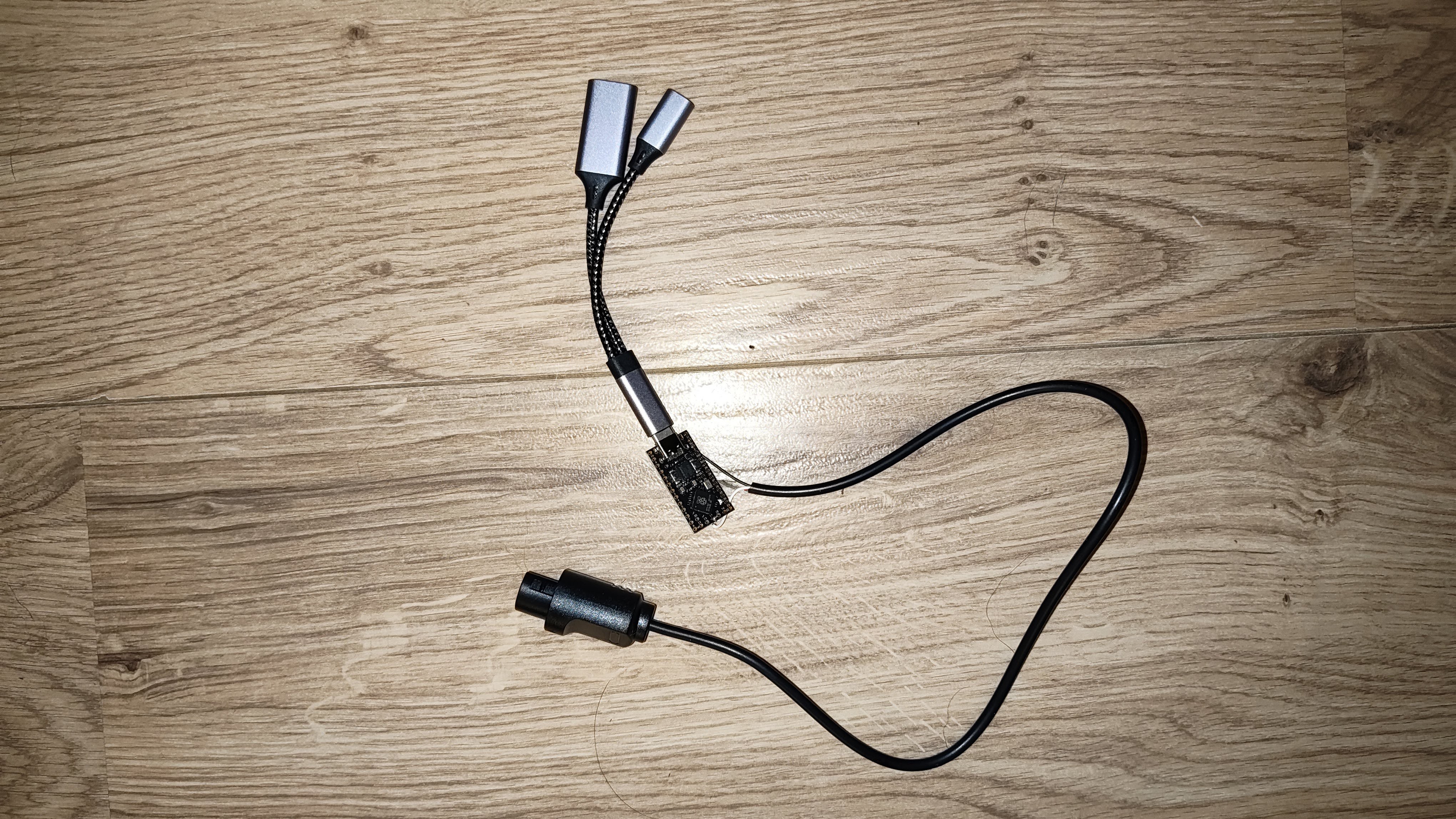

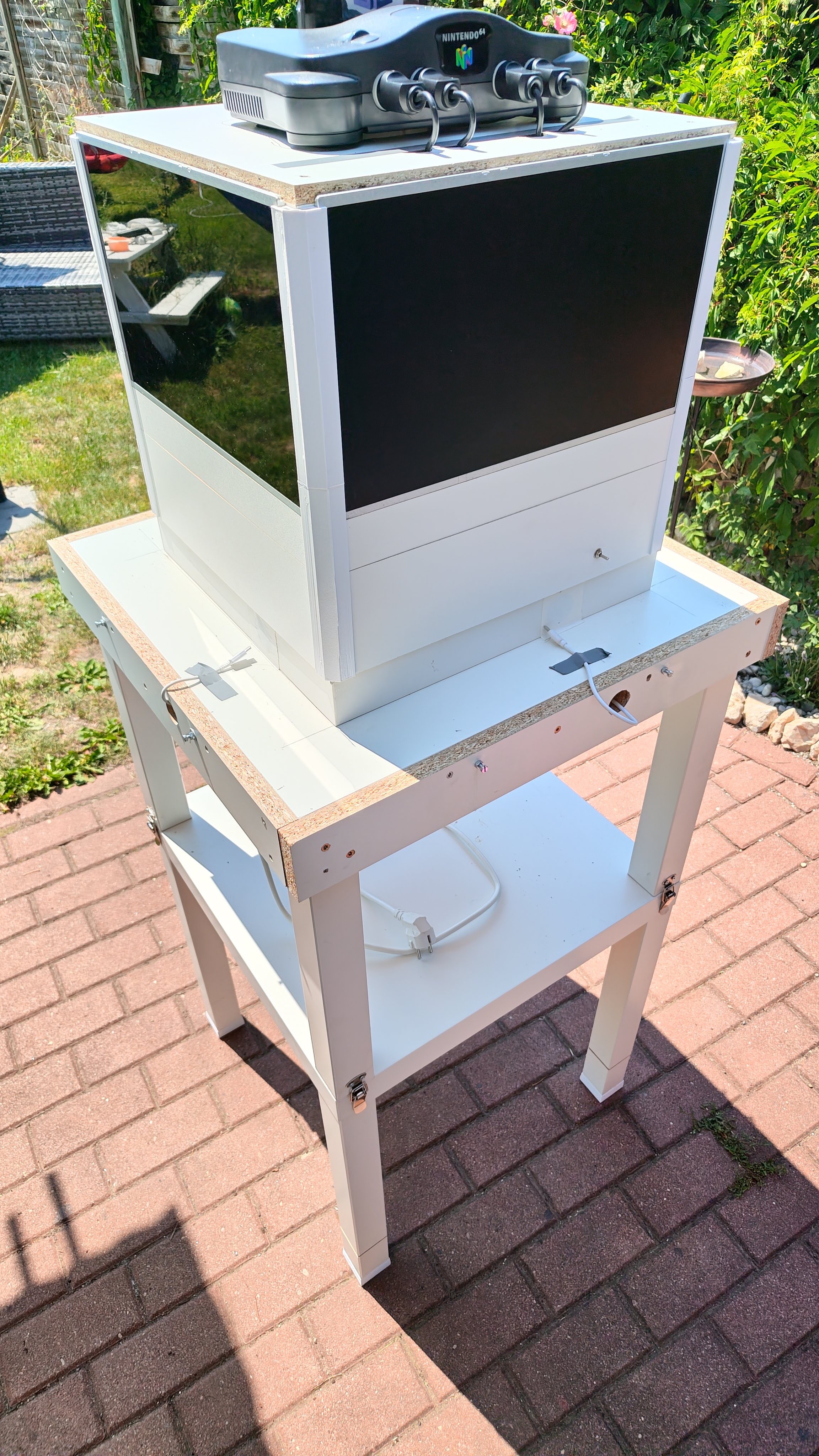

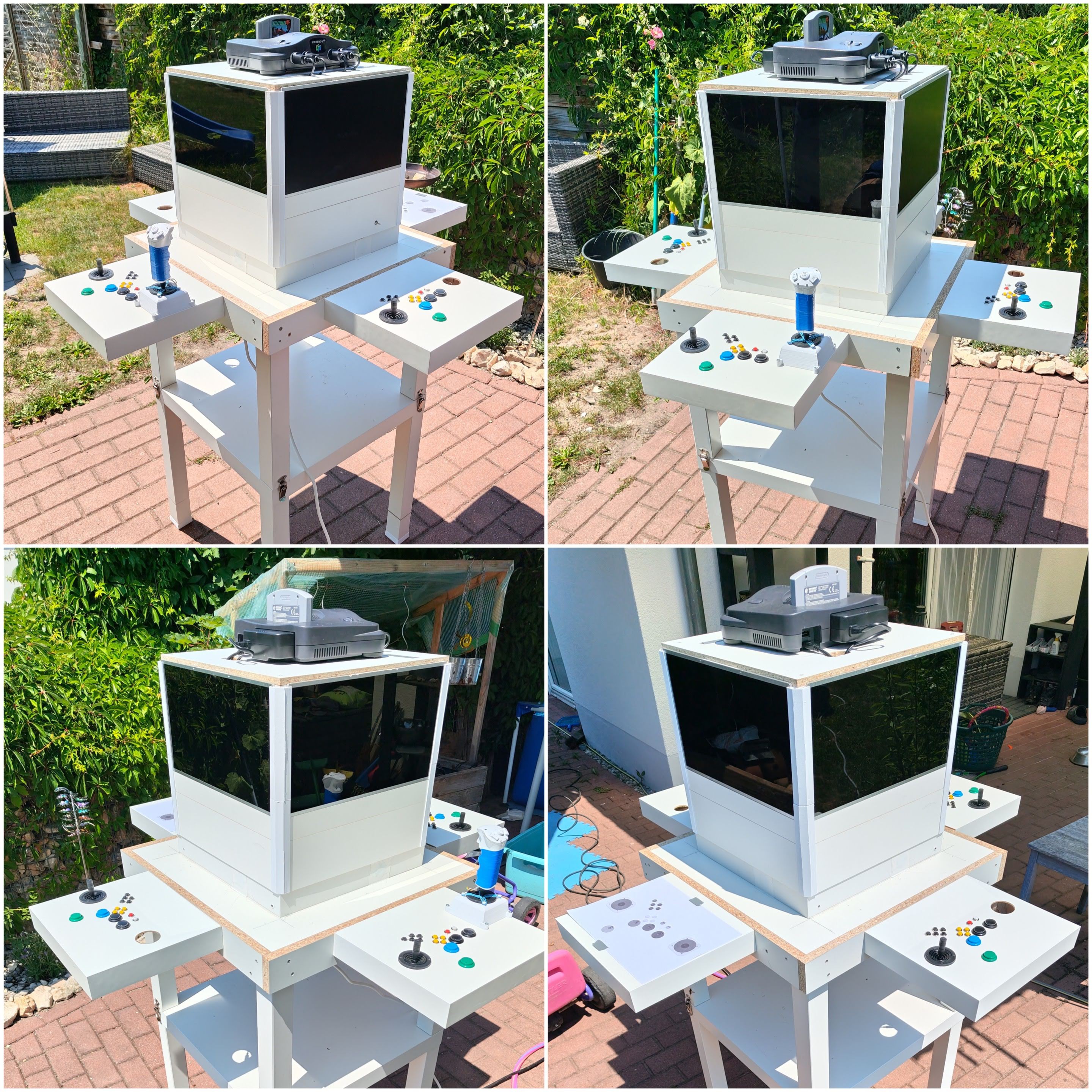

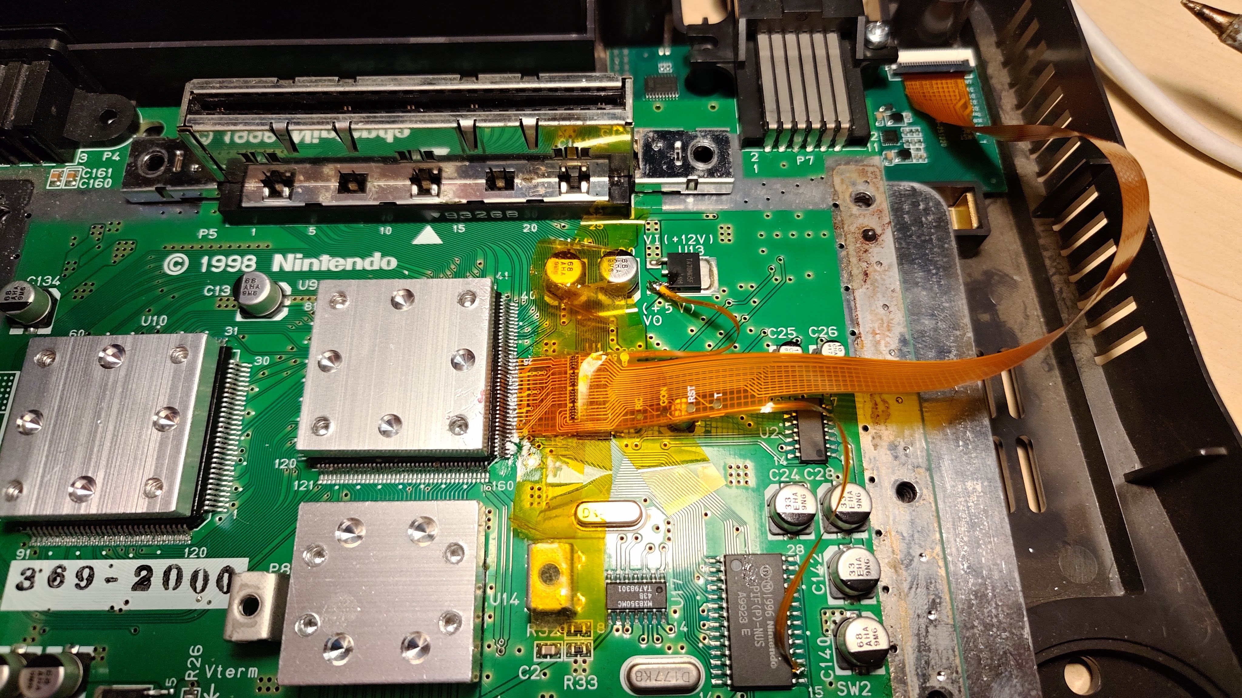

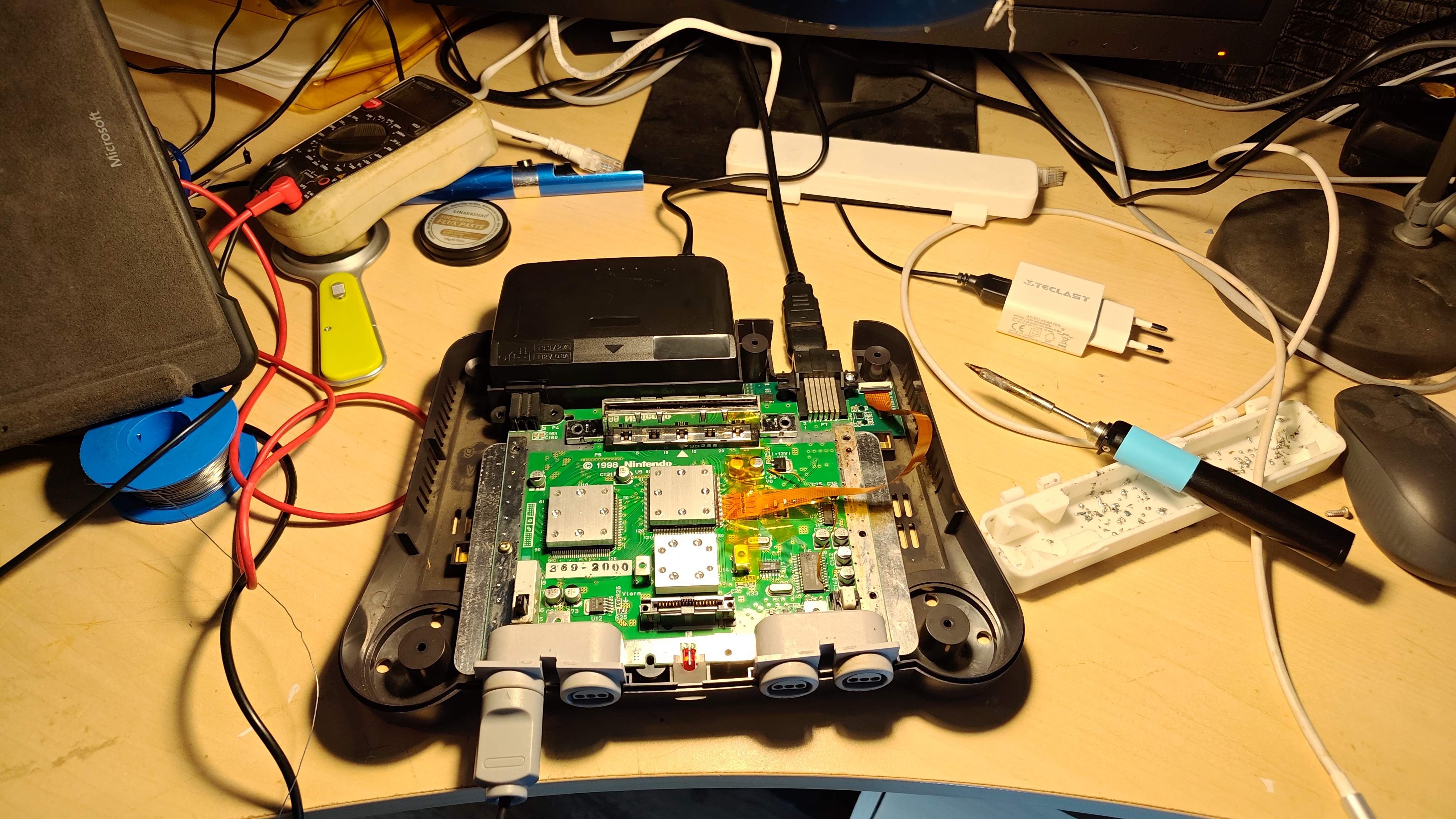

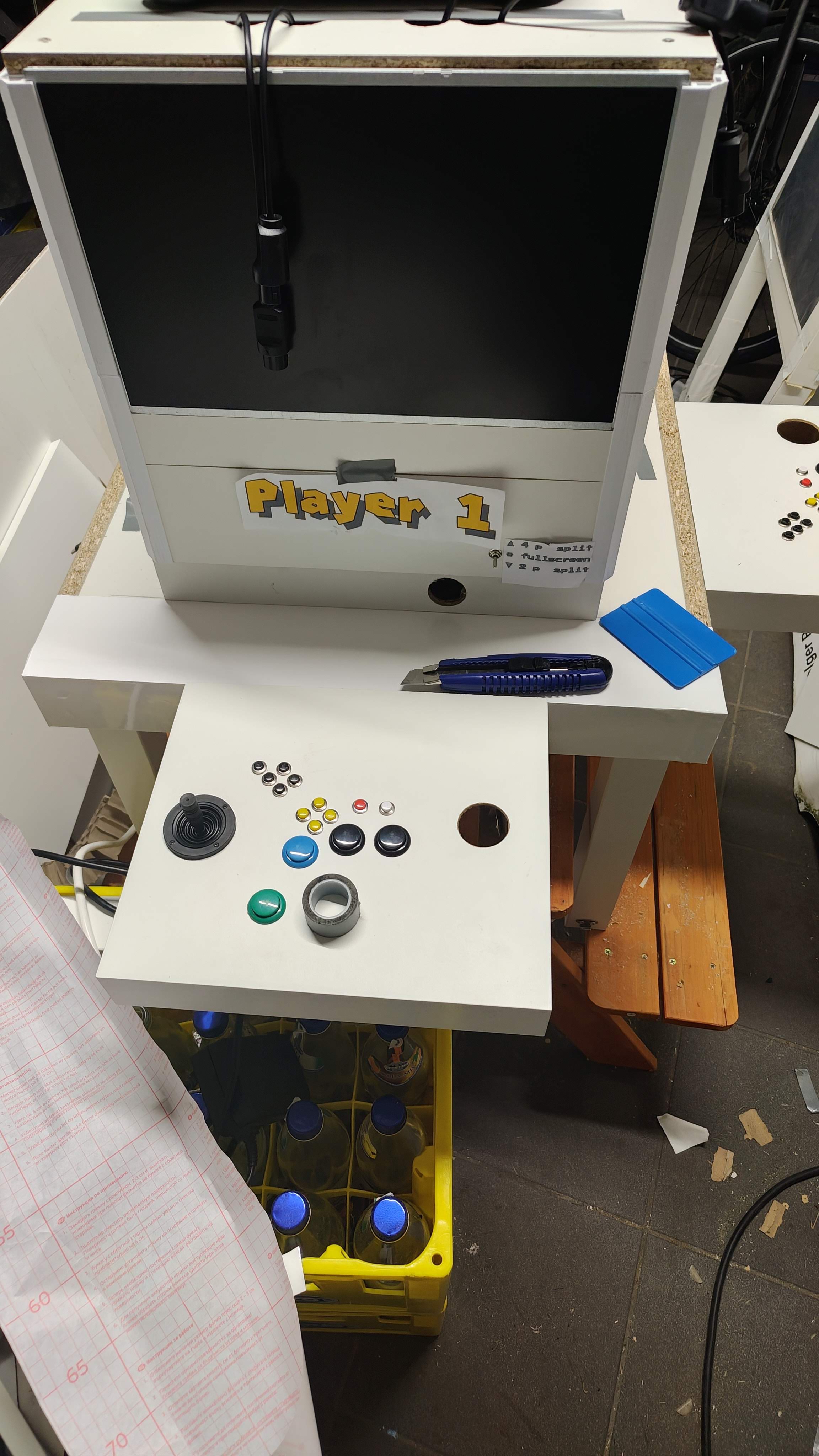

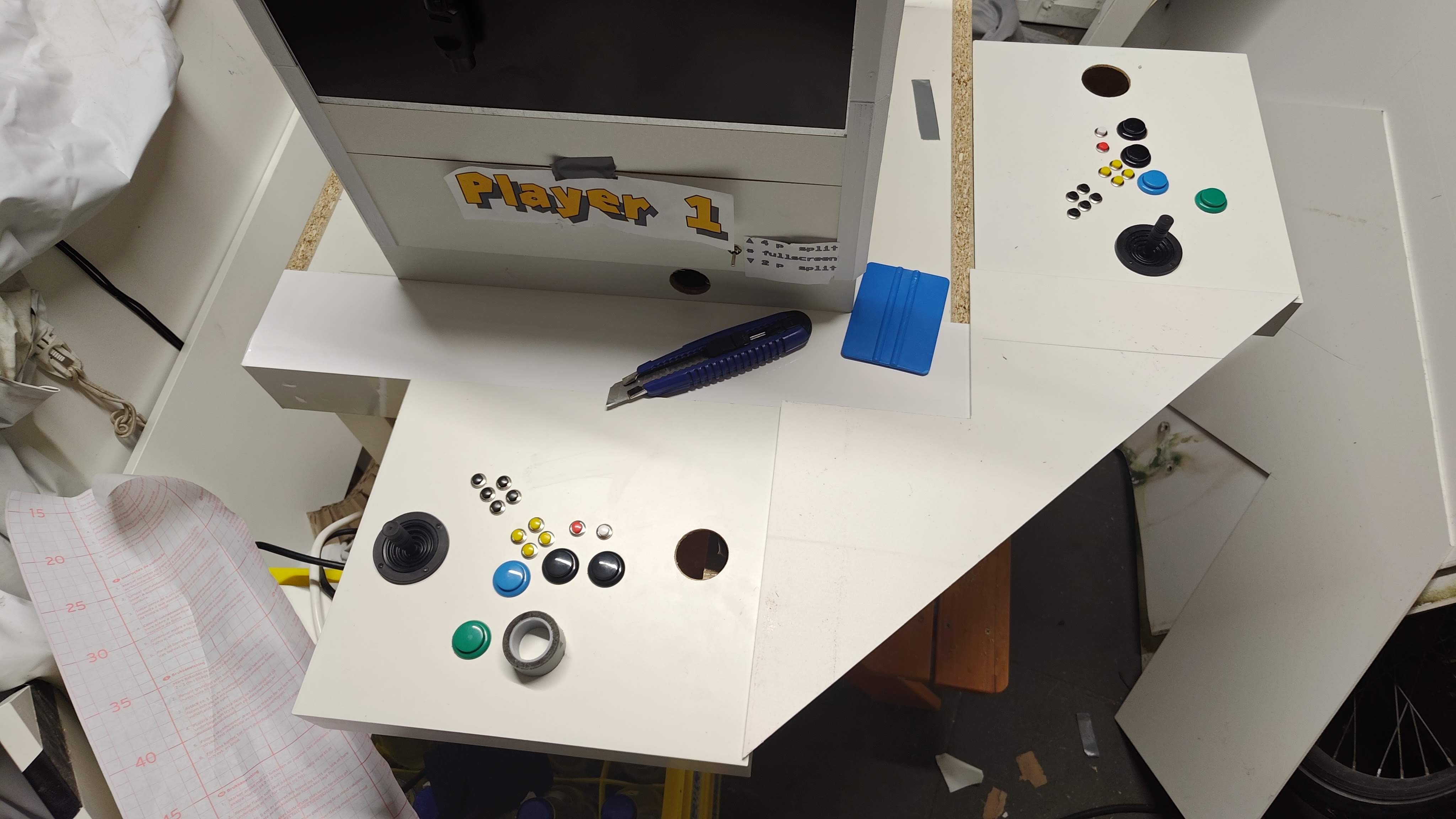

Hackaday.io Hackaday.io
Sign up Log in
N64 Splitscreen Arcade Table
N64 Arcade Table with 4 Screens and Splitscreen Multiplayer. Custom arcade Controller with different control options.
florianbednarzflorian.bednarz
Following Follow project
Liked Like project
Become a Hackaday.io member
Sign up with Github
Sign up with Twitter
OR
Forgot your password?
Just one more thing
Pick an awesome username
hackaday.io/
Pick a few interests
Choose more interests.
OK, I'm done! Skip
Join this project
702 views
3 comments
3 followers
3 likes
  • Description
  • Details
  • Files 1
    • View all
  • Components 9
    • View all
  • Logs 2
    • View all
  • Instructions 0
  • Discussion 3
View Gallery
702
3
3
3
Team (1)
  • florianbednarzflorian.bednarz
Join this project's team
  • Blog (in German)
MISC
ongoing project
arcade n64 RETRO Arcade table
Related lists
Important Video Game Projects
Whether arcade or computer or console, here is a collection of nostalgic interactive media endeavors reflecting the recent past.
This project was created on 09/15/2025 and last updated 8 months ago.
Description
I'm trying to build a Custom N64 Arcade table with 4 screens and the option to switch between fullscreen an 4 player splitscreen (each of the 4 screens shows only the coresponding part of the Splitscreen)
The Controller is also custom design:
Two sticks, the left one for normal play, the right one (with better handle, and 4 buttons, ABZR) for games like starfox64.
I will post updates on design an Hardware choices and links to used githubs and Thingiverse files in further updates in case someone wants to rebuild this...
For further information see my blog (german) linked below.
Work in Progress.
Files
Portable Network Graphics (PNG) - 95.60 kB - 09/16/2025 at 12:44
Preview
Components
  • 8 × JH-D202X Dual axis Joystick
  • 50 × Small 10mm Buttons For C-Buttons, D-pad, L, Start
  • 16 × 24mm Arcade Buttons Large A,B,Z,R Buttons
  • 1 × 2x2 hdmi video wall controller With rs233
  • 4 × Cheap used screens
View all 9 components
Project Logs
Collapse
  • usb2n64 test
    florian.bednarz • 09/20/2025 at 22:15 • 0 comments
    New Parts arived:
    N64 Extension Cords and 4rp2040 pro micro
    I flashed the pi picos with https://github.com/pdaxrom/usb2n64-adapter and tested everything on the real thing. Works like a charm.
    Next step will be the N64 AV to hdmi converter to use the Video output of the N64 with the 2x2 Matrix controller.
    Flow
  • Used githubs, links etc
    florian.bednarz • 09/15/2025 at 13:39 • 0 comments
    Used Githubs, Thingiverse Files and links:
    Arcade Controller:
    https://gp2040-ce.info/
    Usb2n64, for connecting the usb gamepads to the real thing:
    https://github.com/pdaxrom/usb2n64-adapter
    Starfox Controller, only Handle is used with a off the shelf Joystick:
    https://www.thingiverse.com/thing:6924817
View all 2 project logs
Log In/Sign up to comment
Become a Hackaday.io Member
Sign up with Github
Sign up with Twitter
OR
florian.bednarz wrote 09/16/2025 at 05:53 • point
Thanks for your input!
I go the easy run for the first Version:
I plan to use only 4 player and 4 player Splitscreen games. Therefore i have a 2x2 matrix Controller connected to the Output of the N64. This Controller can show the whole screen on all 4 displays, or 1/4 of the screen on each coresponding display. So you can play N64 multiplayer games in Splitscreen and each player just sees their 1/4 of the screen in fullscreen on his display.
No custom roms, FPGAs etc involved (which is to complicated for me now ;-) )
Crts was also an idea, but as you mentioned it would be very heavy an much bigger...
Flow
Joshua Felix wrote 09/16/2025 at 06:08 • point
Yeah, I never owned an N64 so i didn't cross my mind that this is for 4 player game modes. It's never too late to make something like this though. Shared memory busses for each game instance would be difficult to implement but it can still be done no doubt. It's only within a matter of how much you can fabricate yourself and how possible it is to find the right ICs for the task.
Joshua Felix wrote 09/16/2025 at 05:28 • point
You'll probably need a custom board to make this work properly. You can make a variant of an N64's motherboard using the same components along with 4 ports supporting up to 4 different ROMs. If you actually build this out, it also probably means that you may have to use an FPGA to simulate 4 different instances of the same system running a different game. Perhaps you'd have to make your own toolchain for handling ROM data as well. Maybe you can run a cluster of CRTs instead of LED screens and include speakers at the top of the screen windows for that classic feel. The cabin would also have to be a bit larger in order to do that and would need to support the weight of all four CRTs at the center while also being a bit stylish to better appeal to the players. You could also incorporate some aspect of the classic JAMMA standards too with fully functional coin slots at the bottom but that'd probably mean that you'd have to start writing some custom state control logic. Overall, it's a very cool project and I'd like to make a version 2 of this.
Official Hackaday Prize Entry
A video game controller that allows you to swap control modules (analog sticks, buttons, D-pads, knobs, etc.) and works with any console
Project Owner Contributor
Modular Gamepad: swappable controls, any console
pointyointmentPointyOintment
I find the bumpers on the Valve Steam Controller to be difficult to push, so let's replace them with touch sensors!
Project Owner Contributor
Steam Controller Capacitive Bumper Mod
goathensgoathens
Hackaday Prize 2019
An open-source Arduino compatible remote controller (transmitter) with many customization options for robots and drones.
Project Owner Contributor
Alpha V1: Open-Source Remote Controller
alireza-safdarialireza safdari
I designed this demo stand for Infinite Biomedical Technologies for conference demonstrations and for clinicians to demo to patients.
Project Owner Contributor
Demo Stand for Myoelectric Prosthetic Controller
nyeli-kratzNyeli Kratz
Going up?
© 2026 Hackaday
Yes, delete it Cancel
You are about to report the project "N64 Splitscreen Arcade Table", please tell us the reason.
Send message
Remove Member
