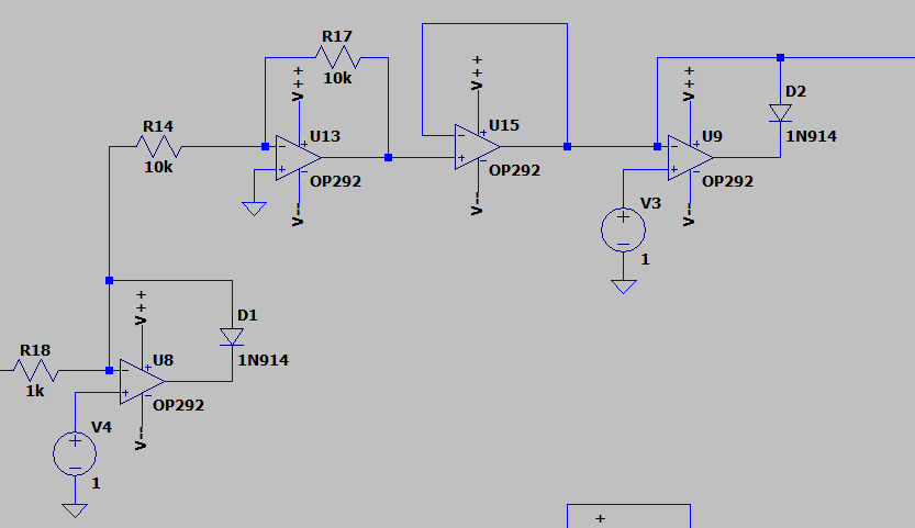

  • Preshaper stage
    Phil Weasel07/11/2025 at 06:31 0 comments
    Ok so a triangle is nice and all but we want a sine wave.
    Just integrating and filtering the triangle gives us a pretty nasty distorted sine, so i added a preshaper stage whith makes the triangle trapezoidal.
    So i cut off the top (here 1V limit, in real its controlled with a poti), flip it, cut off the other half, and done.
    The result:
    The original triangle in blue, the resulting trapezoid in yellow.
    The 180° phaseshift is due to the flipping to cut off the top half. I didnt flip it back because it doesnt matter and i use quad-opamp IC´s ... so this part is neatly done with one IC.

  • Upgrading the oscillator to a VCO
    Phil Weasel07/10/2025 at 11:24 0 comments
    To make it a voltage controlled oscillator (=VCO) we need the tweak it a bit.
    As mentioned before, one possibilities to change the oscillators speed is to change the incoming voltage levels.
    My idea is to split the squarewave into positive and negative, clip the maximum of both, and add them together at the end.
    The negative part gets inverted after and before clipping. This way i can clip both halfs with just one control voltage.
    I built it up with some opamps and .....
    It actually works!
