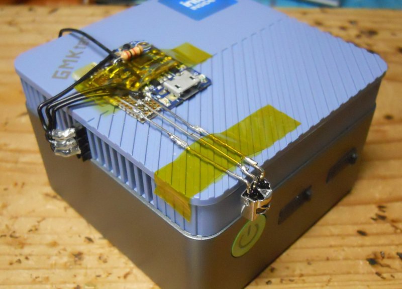

Anyway, to attach a cable to power switch pins, I created a custom connector and forcibly insert it into the gap between PCB and fan platform. See project log "Created connector" for the detail.
It finally looks like below photo. At first I was thinking to place everything inside top cover, but I took easy route.

  • Changed to USB
    teru • 04/06/2026 at 11:04 • 0 comments
    After changing power source to USB, it worked.
    I used junk USB plug which sit in parts box for years.

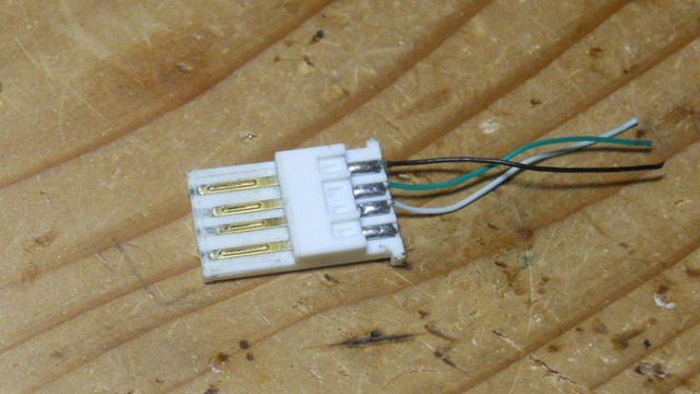

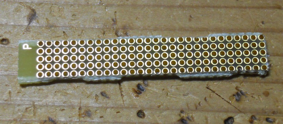

  • Created connector
    teru • 03/21/2026 at 09:16 • 0 comments
    I made a connector using a universal prototype board with a 1.27mm pitch. I checked quickly and confirmed it is making contact with the switch pins.
    Connector connected to the switch
    The front side of the connector
    The back side of the connector, where it makes contact with the switch pins.
    1.27mm pitch Universal prototype board

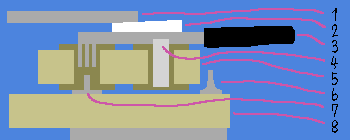

    The following cross-sectional diagram shows how I attempted to connect the wires to the switch.
    I wrapped the connector in polyimide tape to prevent it from short-circuiting with the switch case's feet.
    1. Platform of the cpu fan
    2. Wedge to secure the connector
    3. Cable
    4. Solder to attach wire to universal prototype board
    5. Universal prototype board
    6. Leg of the power switch's case
    7. Pin of the power switch
    8. Mother board of the PC
