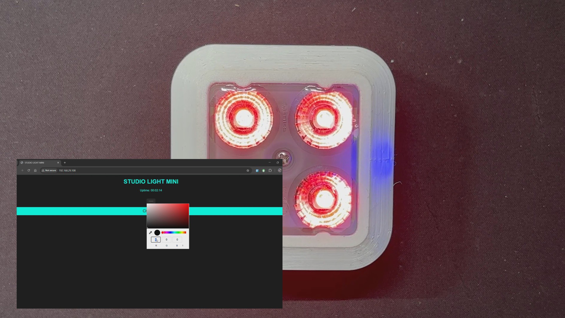

The Portable Studio Light is an ultra-compact RGB lighting solution intended to improve video production and visual aesthetics. With a sleek 3D-printed housing and a custom-engineered lens, it diffuses brilliant light from just four WS2812B LEDs.
The Studio light, powered by an ESP8266 microcontroller, links smoothly to a browser-based web app, allowing for exact color choices and dynamic control directly from your phone or laptop.
The Portable Studio Light was created to address an actual problem: I just relocated and found myself frequently hopping between two workplaces. I needed a lighting setup that was portable, easy to mount anyplace, and strong enough to enhance my video output.
Our Setup is powered by an ESP8266, with a custom 3D-printed lens and enclosure to make the most of only four WS2812B LEDs. The web app is where the magic happens: it's simple, responsive, and works on any device. I've used my phone, laptop, and ROG Ally to control it. Simply select a hue and it refreshes instantaneously, allowing us complete creative freedom no matter where I am working.

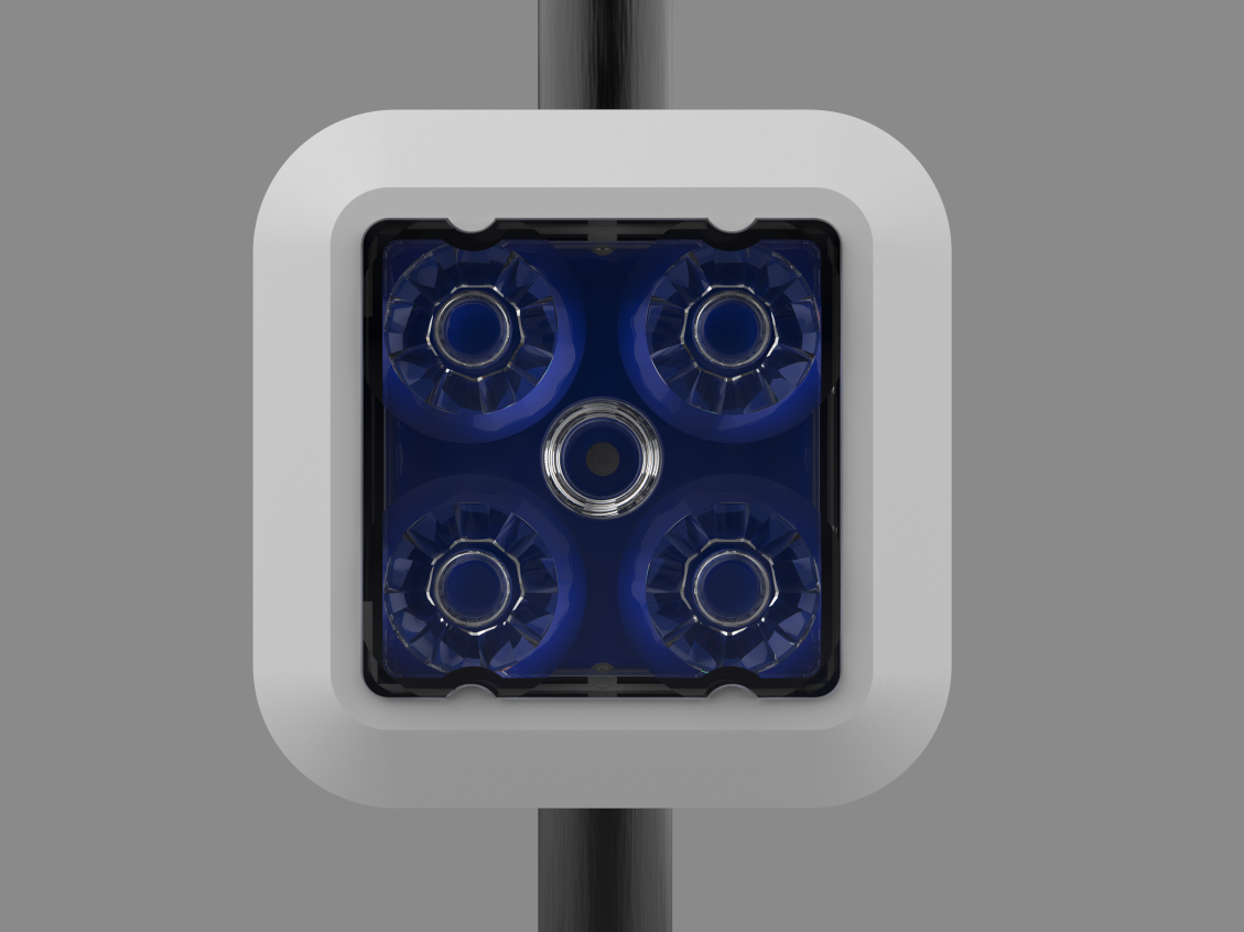

The 3D design of this project began with creating a proper-sized model of the lens that will be used in this build. The idea here was to place a PCB on the backside of the lens and then create an enclosure around it to house the batteries and electronics. The entire device will have a Stand Holder component that will be used to attach the device to any tripod or pipe.
The enclosure was designed in two halves: the front body and the lid section.
The front body has a huge opening in its center where the lens will be secured. The circuit was then modeled and connected to the lens, which is kept in place by a hole in the middle into which we will insert an M2.5 nut and bolt.

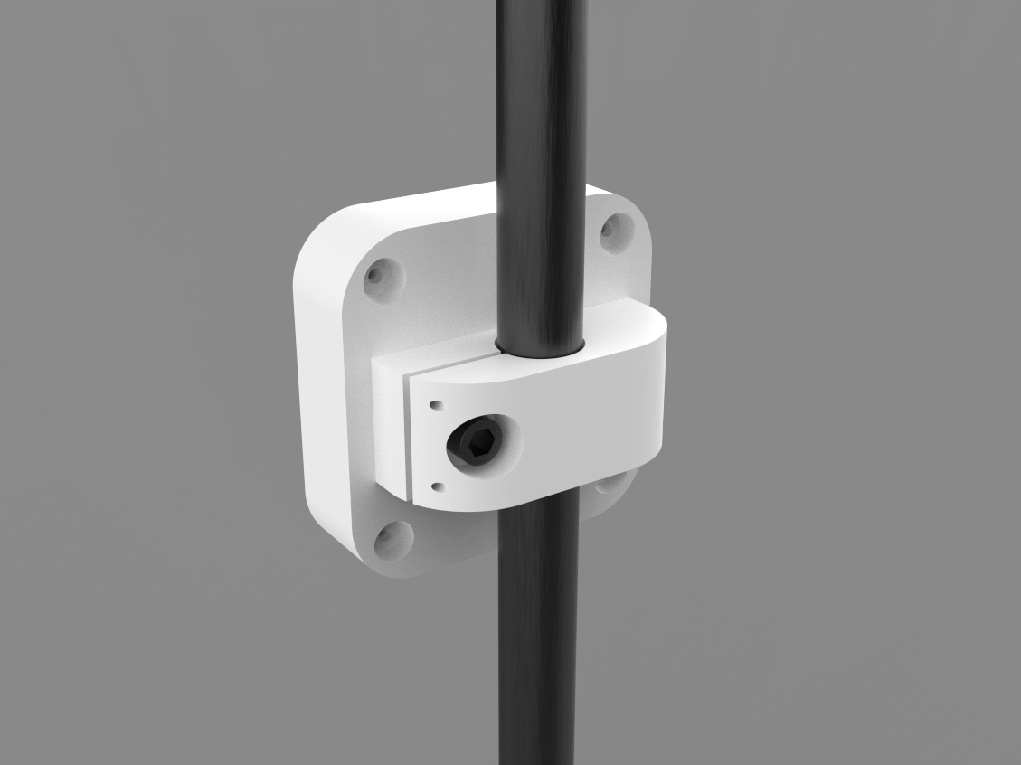

The lid is attached to the front body from the back and held in place with four M2 screws. The Lid Part also houses the Stand Holder Part.
We have created a 20mm DIA hole on the Stand Holder for attaching a tripod with this arrangement. We also constructed a slit and provided a hole and slot for installing an M6 nut and bolt; by tightening these nuts and bolts, the 20mm dia. hole size drops to 19.5 or less, allowing our device to be fastened securely with a tripod.
After preparing the 3D model, we exported the mesh files for all of the parts and 3D printed them on our K10 Max 3D printer with white Hyper PLA.

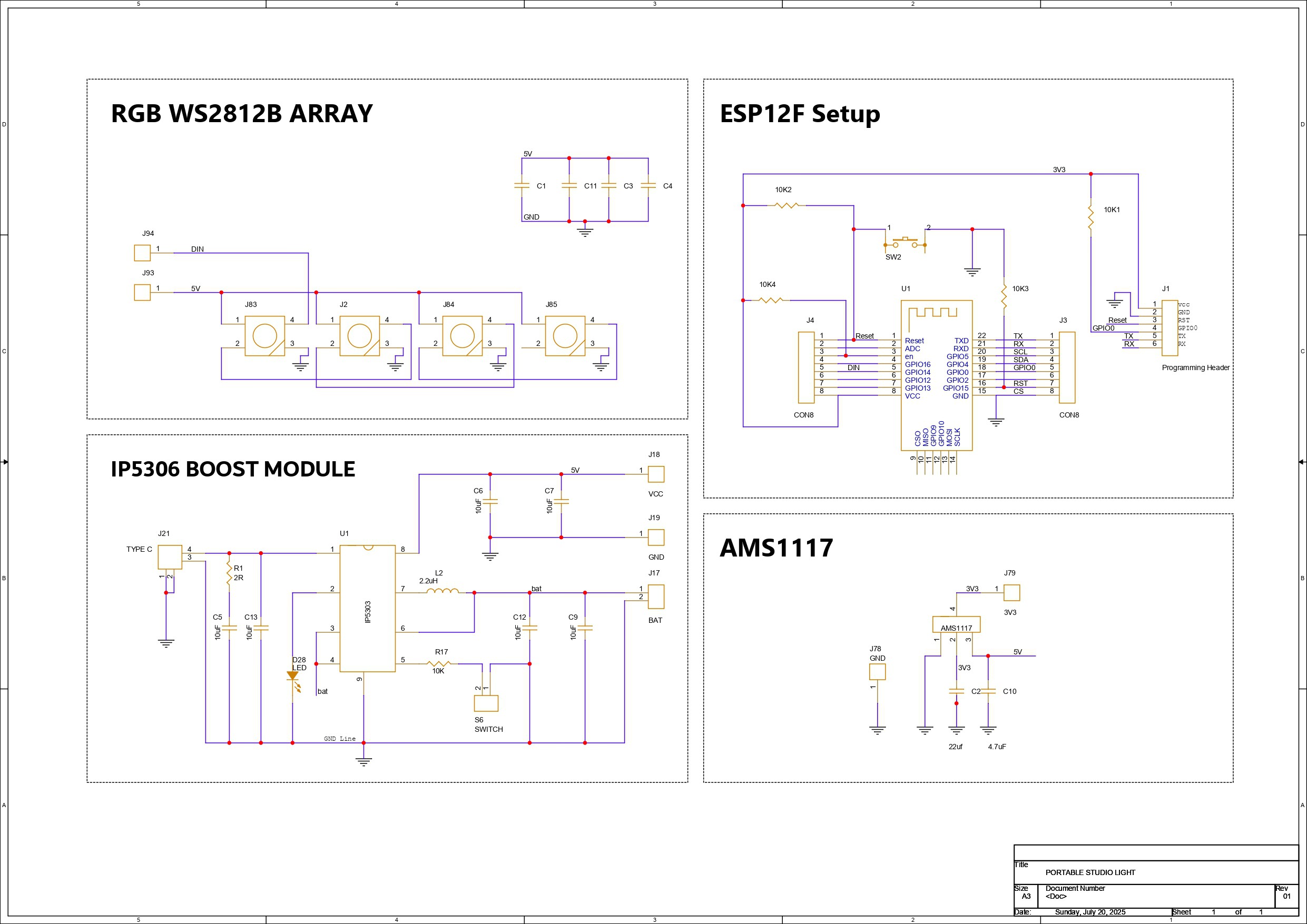

PCB Design
Let's have a look at the schematic for this project, which is divided into four primary parts, one of which is the microcontroller section, which in our case is the ESP12F setup. Here, we've connected the ESP12F module to a few 10K resistors in the minimal configuration required for the ESP12F to work. We also included a CON6 Header pin connector that connects to the TX, RX, GPIO 0, RESET, VCC, and GND pins of the ESP12F Module; this connector will be used to flash the ESP chip using a UART adapter.
Next, we have the Power source section, which is the IP5306 Power management IC Setup, which we have previously used in...

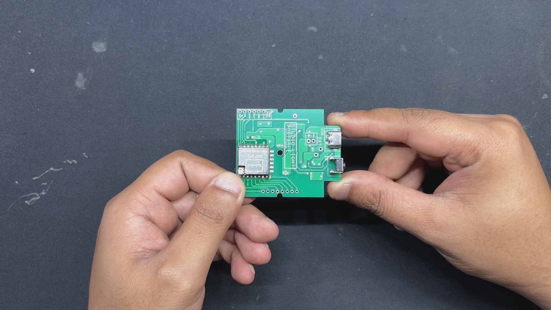

    PCB ASSEMBLY
    • The PCB assembly process begins by applying solder paste to each SMD component pad one at a time with a solder paste dispensing needle; we are using 63/37 Sn/Pb solder paste here.
    • Next, we use an ESD tweezer to choose and arrange all SMD components on the top side of the board.
    • We pick the circuit and place it on the Reflow hotplate, which heats the PCB to the solder paste melting temperature, causing all SMD components to permanently solder to their pads.
    • Next, we begin assembly on the bottom side of the board, beginning with the placement of the ESP12F Module.
    • Because we are soldering on the other side of the board, we must use a soldering iron. We begin by soldering the first pad of the ESP model, which secures it in place and allows us to begin soldering the pins.
    • Now come the through-hole components; we begin by installing the Push Switch, followed by the type C Port.

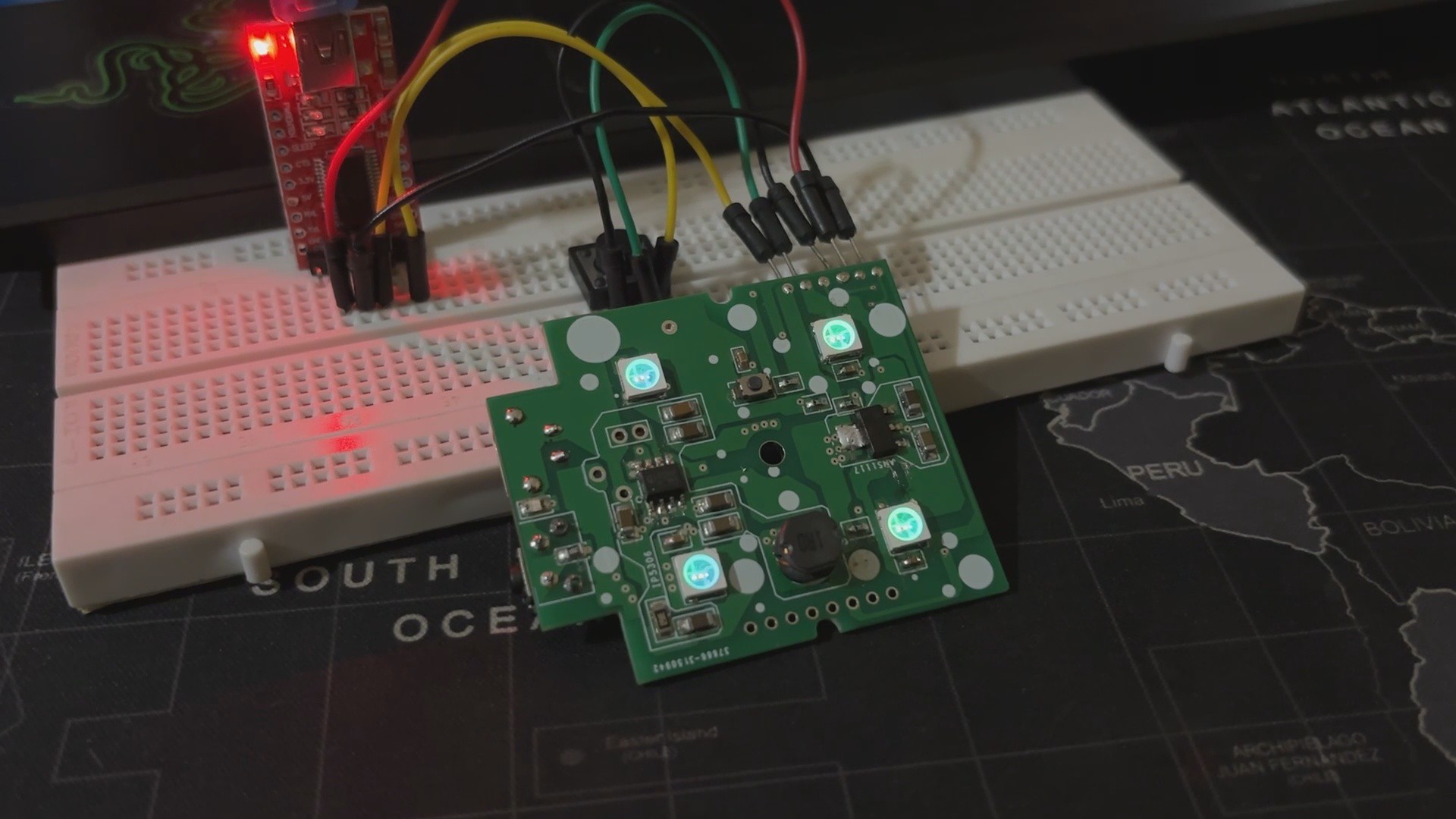

    Flashing the ESP12F
    Next is the Flashing process of the main circuit's ESP12F Module.
    The usual FTDI board method, which requires connecting a flashing button between GPIO 0 and the GND Port, is being used to program the ESP12F Module. During uploading, the ESP12F enters programming mode by long pressing the Flash button first, followed by the reset button.
    Here's an article about programming ESP12F with FTDI Board for more details:
    https://www.hackster.io/Arnov_Sharma_makes/esp12f-standalone-circuit-1de4a7
    Here's the code that was used in this project and it's a simple one.

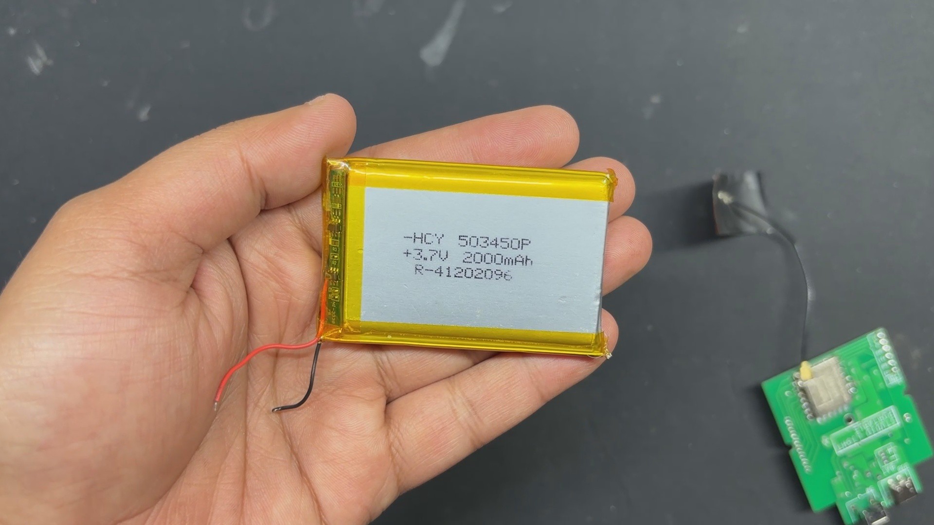

    Power Source
    This project's power source is a 3.7V 2000mAh LiPo cell. We begin the power source assembly process by connecting the Lipo cell's positive and negative terminals to the Battery CON2 port of the IP5306 IC.
    We plug a type C charger into our circuit, and the blue lights begin to flash, indicating that this setup is functional. When the blinking becomes stable, the battery has been fully charged.
