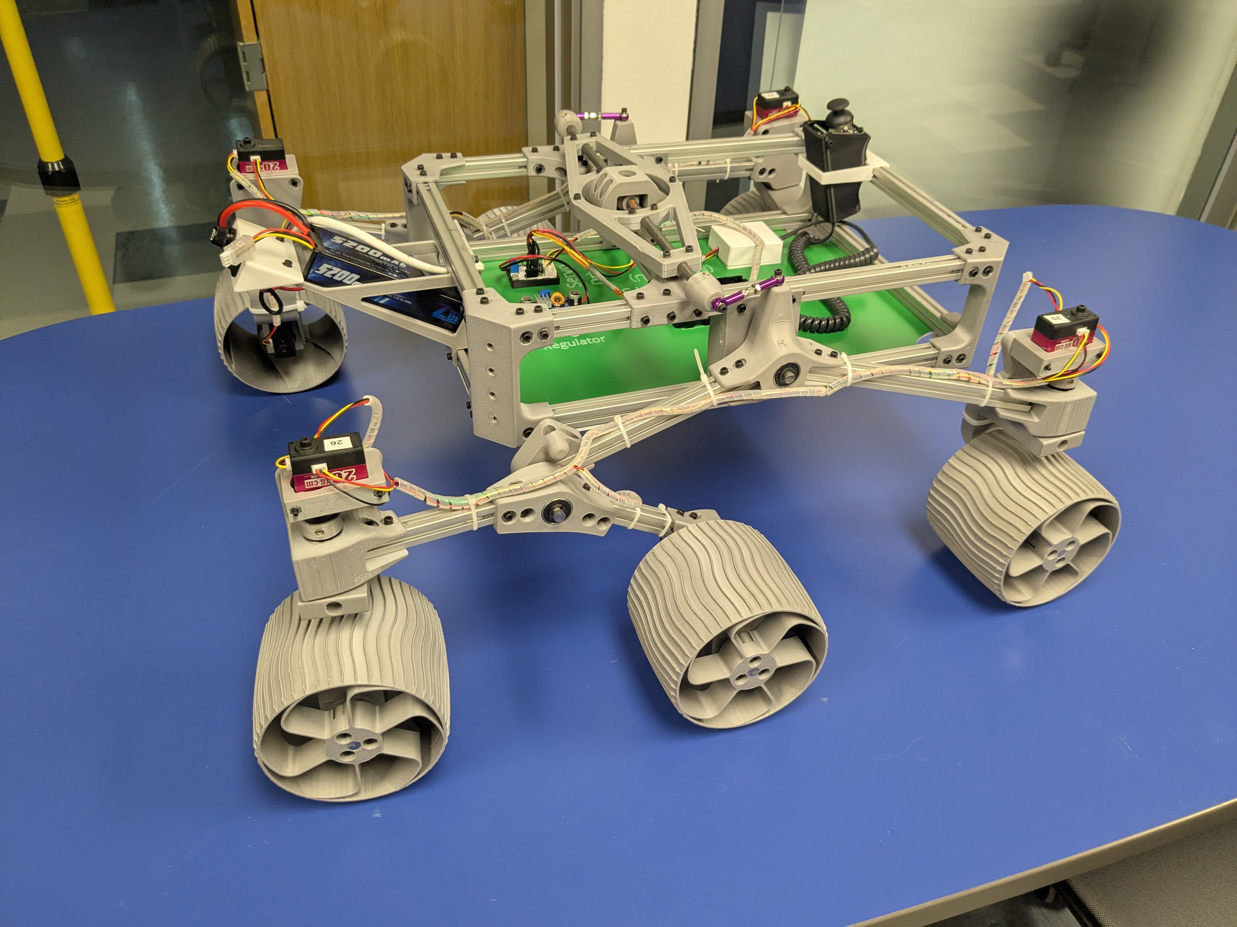

I decided to build this rover to give Engineering students at Trinity University in San Antonio a robust platform to develop on top of, and to learn about the world of open source hardware. It's a pretty straightforward remix of Roger Chen's SAWPPY rover, which he's documented here on Hackaday at https://hackaday.io/project/158208-sawppy-the-rover, with a couple of minor changes that I'll cover below.
The name TRIPPY evolved from SAWPPY, and could stand for "Trinity Robotics Instructional Planetary Platform" :)
I made several changes to the original Sawppy.  I use Versions in OnShape, so just navigate to the "Versions and History" tab to see the different varients.

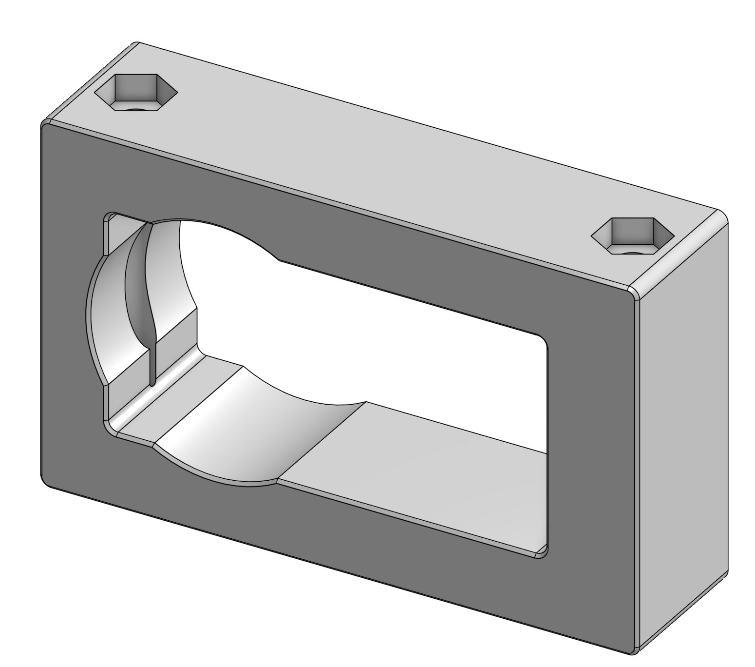

  • Bracket/Coupler for LX-224 servos
    When I ordered parts, the LX-16A wasn't available, so I grabbed the LX-224.  As shown in this CAD, the dimensions are slightly different.

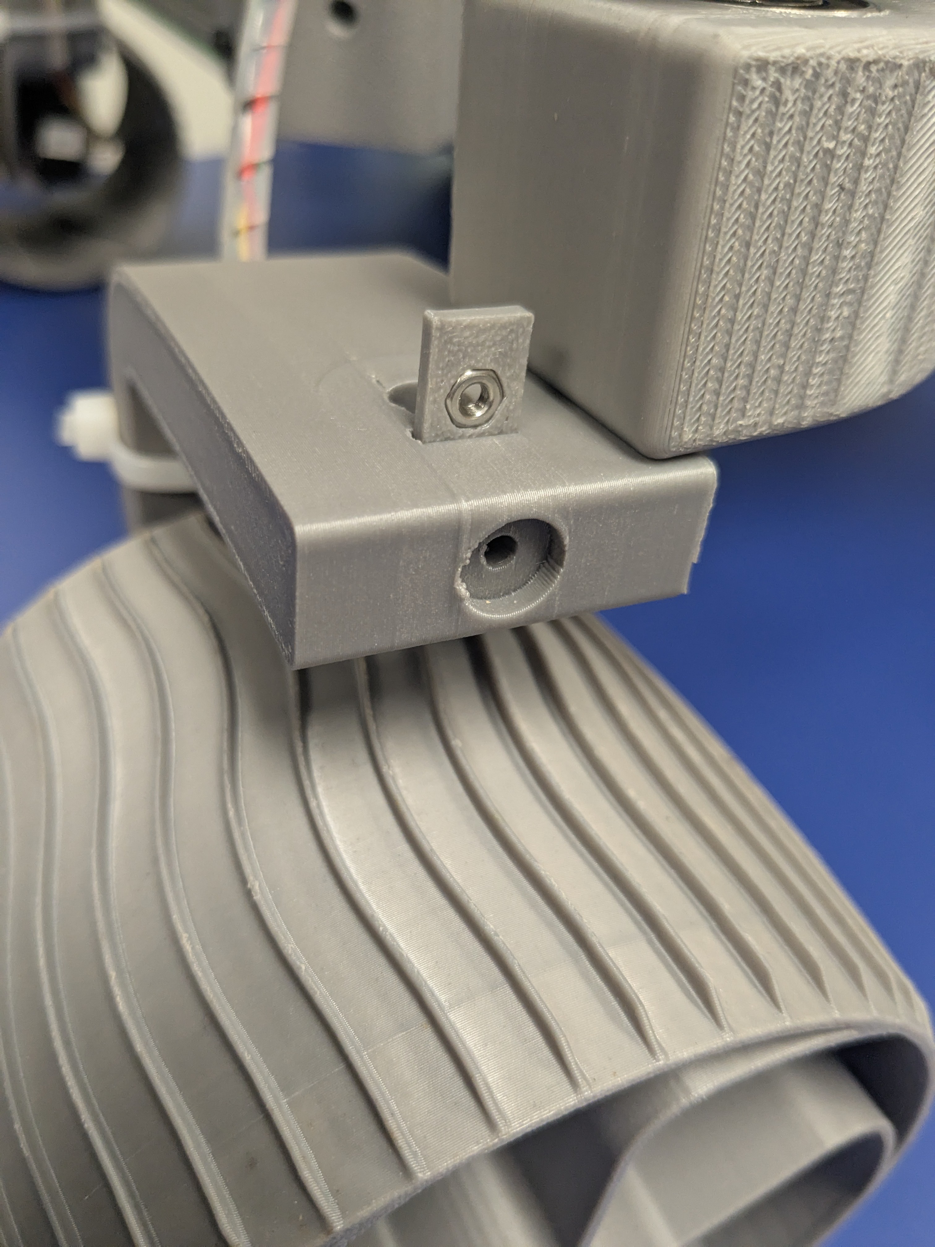

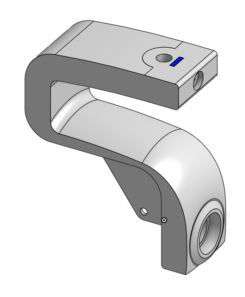

  • Modification of steering knuckle to accept M3 nuts and M3x16 screws for setscrews instead of threading into heatset inserts
    As was mentioned in the Discussion section of CJ - a sawppy variant right here on Hackaday, some of us have had issues with heat-set inserts pulling out.  As shown in this CAD and the pictures below, I ended up printing a Nut Carriage to get good strength and print resolution in the XY direction, then printing the knuckle in the standard orientation, so that the M3 nut won't spin when tightened against the flat in the 8mm shaft.  Then, I used an M3x16 screw as a setscrew instead of the tiny ones called out in the original.  We'll see how this holds up over time!

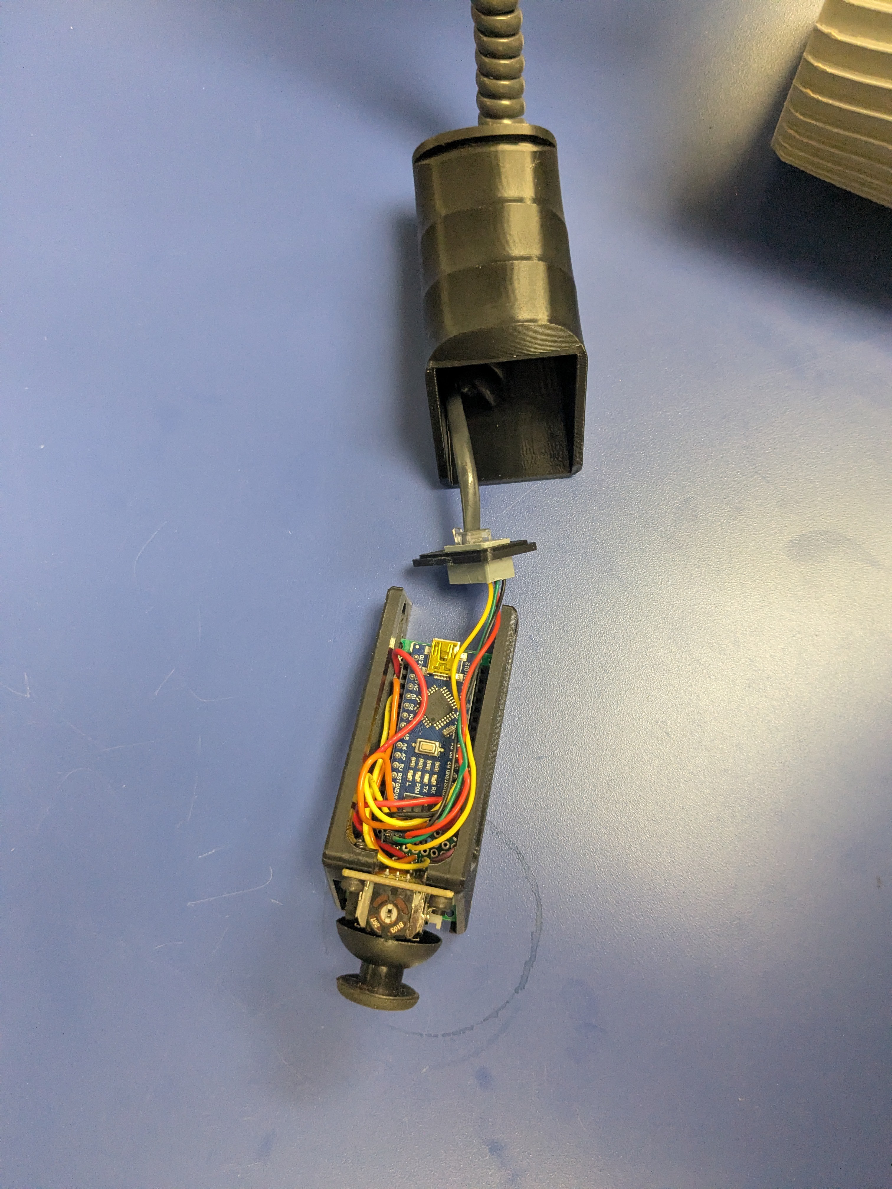

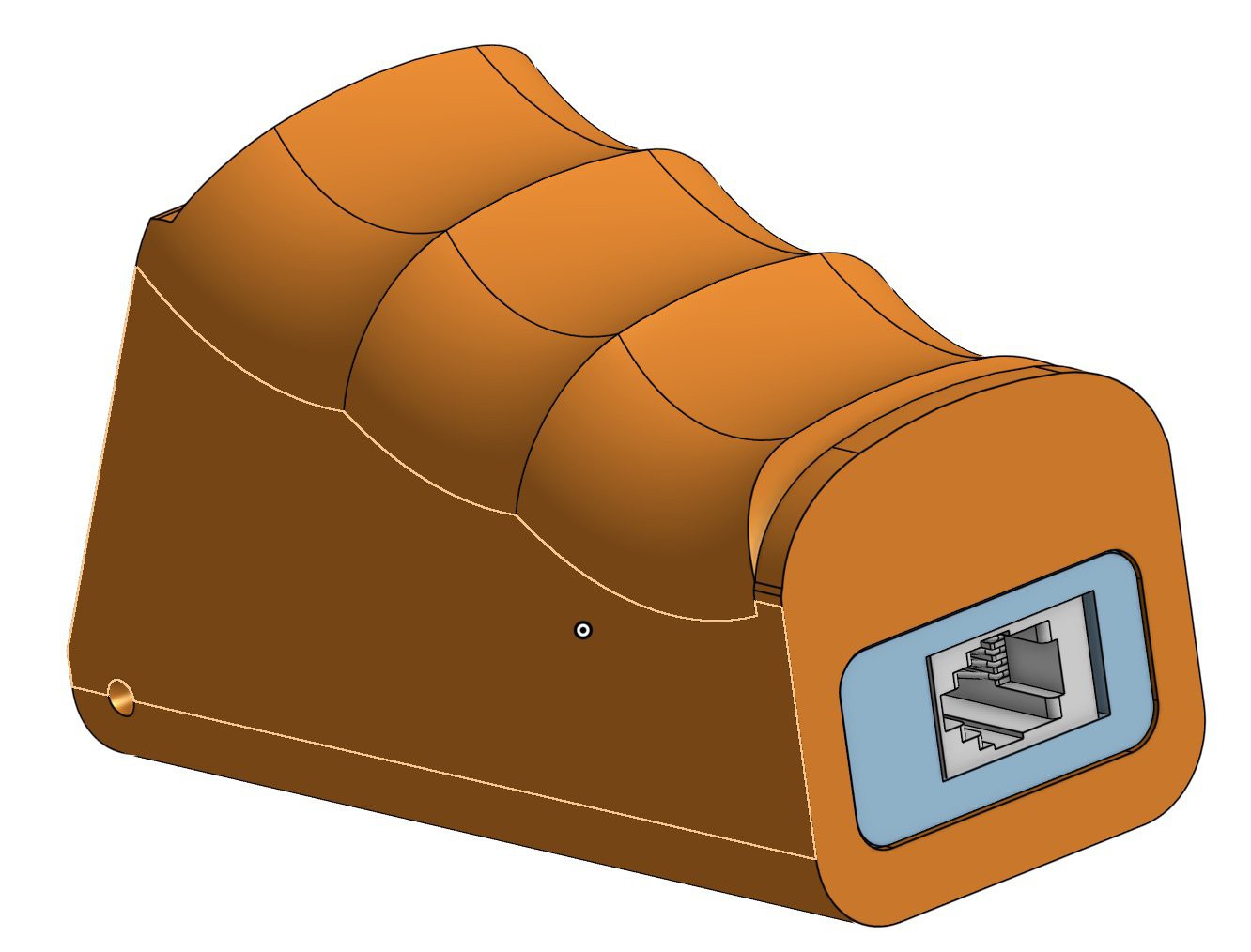

And for the backup controller (as documented here) (CAD - Handheld Arduino Joystick - Copy)

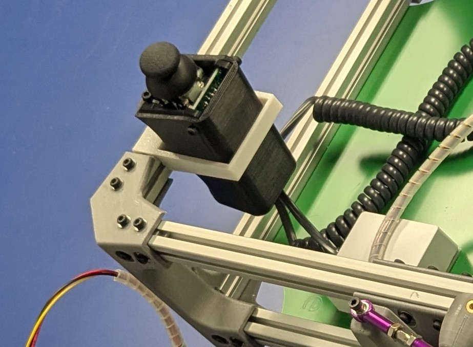

  • Modified the Handheld Arduino Joystick controller to accept an RJ9 so that I can connect my controller to my rover with a standard coiled phone cord.
  • Added a "holster" to place the Handheld Arduino Joystick controller in the box when not in use.

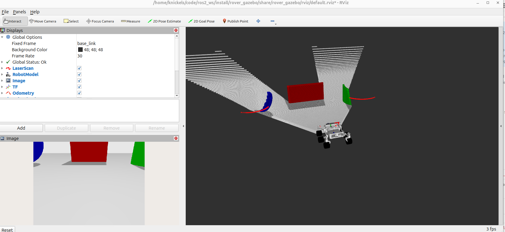

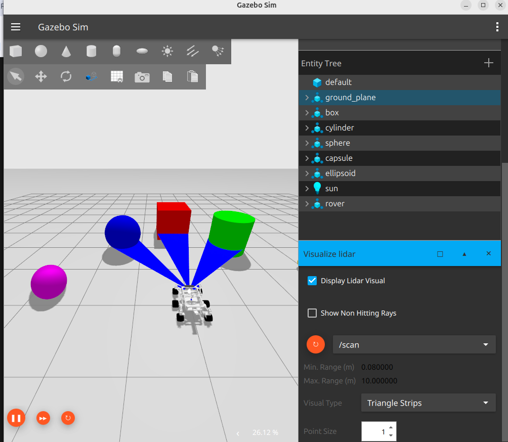

    Before trying to get autonomous navigation working on my rover, I decide to simulate it.  Turns out that the recommended version of ros2 for ubuntu 24.04 is ros2 jazzy.  And the recommended version of gazebo for jazzy is called harmonic.  Unfortunately, the gazebo folks are in the middle of a huge API-breaking change (from gazebo classic to ignition, now just back to gazebo - it's a long story https://gazebosim.org/docs/harmonic/migration_from_ignition/.
    Anyway, I went off on a rabbit-trail upgrading the simulation part of Miguel Ángel González Santamarta's ros2_rover from gazebo classic to gazebo harmonic.  So at this point that's the focus of this update.
    I got the robot description to drop into harmonic ok.  Then I added sensors one by one (and almost all of them changed from gazebo classic).  Then I updated the ros2_control control interface.
    So now I have teleop, with sensors, working in Harmonic!  My next rabbit-hole is to update the Nav2 stack, it's got some more significant changes for jazzy.  So I'm off to read about behavior trees and Quality of Service settings. I'll leave you with a really boring simulated teleop loop.
    First, in gazebo harmonic:
    Then, the part of the world piped back to the rover and displayed in rviz2:

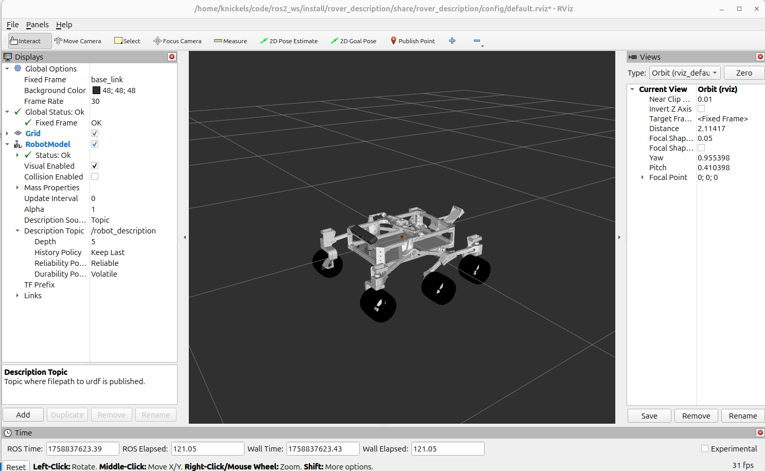

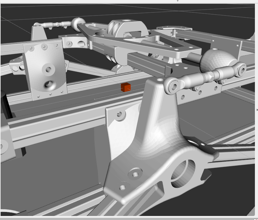

    I was excited to find that you can install ubuntu on raspberry pis now, so I put Ubuntu 24.04 and ROS2 Jazzy on my Pi5.  The rover_bringup, rover_sgs, rover_motor_controller, and rover_service work with only a few changes (which reminds me I need to submit a PR for those....).
    So I have a working robot_description, and I can move all the joints around.
    You may notice if you zoom in on the turnbuckle that it's not attached.  Turns out that closed kinematic loops give Gazebo heartburn, so I left that link out.  For the simulation, I'll fix all the passive joints (the rocker joints and the bogie joints).
    So now I can teleop my rover from another computer using a gamepad.  Not too different from the on-board joystick using an arduino, to the casual observer.  But since it's ROS, that means that as soon as I can get the kinect stream ingested as a costmap, I'll have autonomous navigation!

    I've got the hardware and servos done.  I'm currently documenting the small changes that I made on, here on Hackaday and also on github.  I've implemented the basic rover with the Arduino-nano based Joystick controller.
    Next up: adding the pi-based controller and ROS2, so that I can drive this thing around within my preferred ecosystem.
