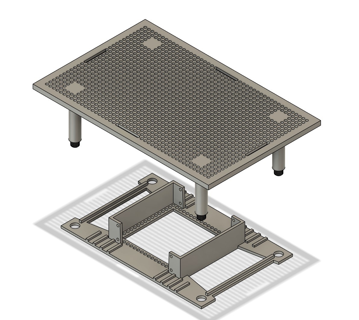

    When I got my now old 3d printer I started printing a similar frame - with predefined points to add the new parts - which was ok but really as unflexible as before.
    After some tinkering around with the printer and learning some CAD I came up with the idea to build myself a prototype carrier that should be modular and reusable.
    Behold - the first design version of my modular carrier frame:
    The idea is pretty straight forward. Have a predefined grid of holes (5 mm center point distance) and build little carriers to house the electronic components with some spacers on it and screw them to the grid with M3 bolts.
    As an example a Grove I2C Hub on its carrier.

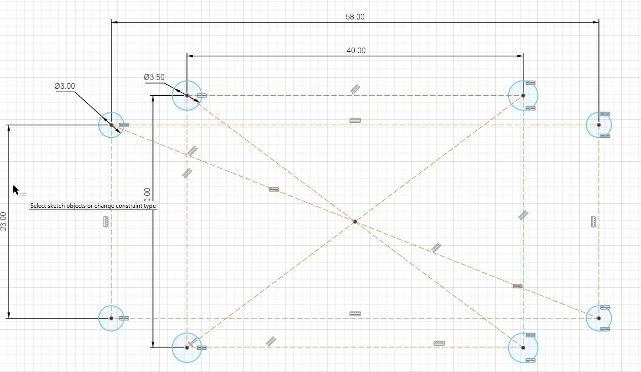

    How to create your own carrier

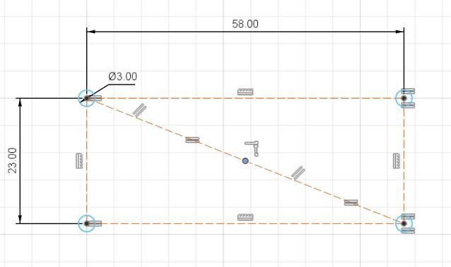

    In this instruction I will show you how to construct a simple carrier for any part you want to add on the grid. I will show case it in Fusion 360 but you can use any CAD you fancy. The approach should be the same.
    The board I want to add is a Raspi Zero 2 W. The easiest way to start is to find a drawing with the dimensions on it. For the Zero 2 this is pretty easy:
    Zero 2 Mechanical drawing

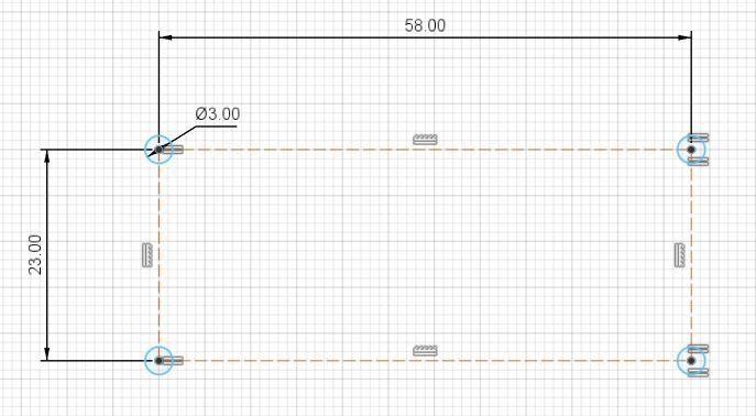

    We are interested in the bores for mounting e.g. on spacers
    The 4 centers of the bore are on a rectangle with the dimension 23 mm x 58 mm.
    Note: The dimension for on of the straight is measured over the symmetry line  so it is 2 times 29 mill
    So we can start with this rectangle as a construction line helper in a new sketch.
    The diameter of the spacer is usually 2,5 mm so I will go with 3 mm to add some tolerance. Add all 4 of them on the corners of the construction rectangle. I like to constraint only one circle and add an equal constraint to the other 3 in case I want to change the bore diameter

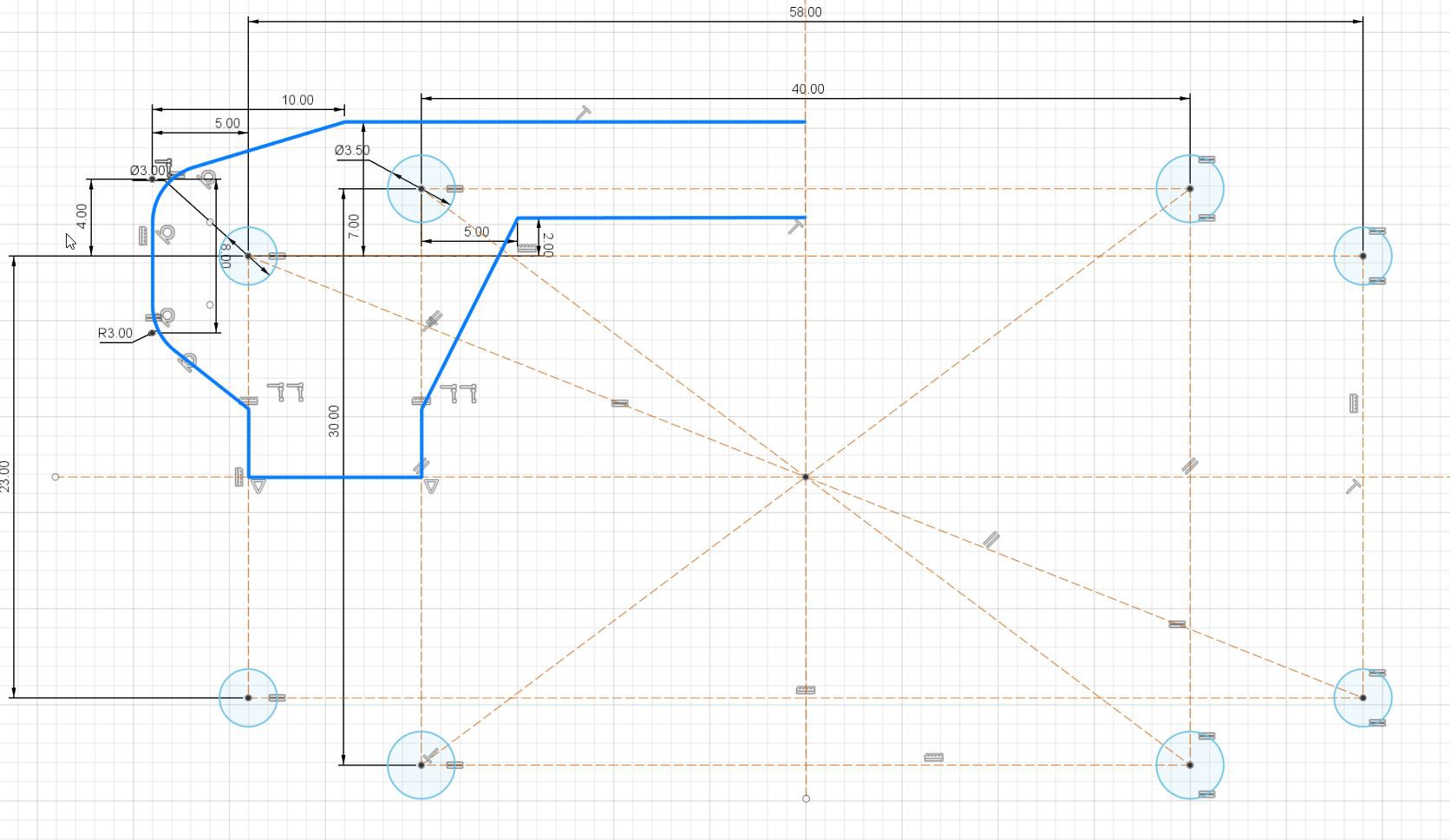

    The next step is to prepare the bores for the grid. I use M3 bolts for it so I go with 3,5mm diameter circles to add some tolerance again. The carrier grid is 5 mm between the center points of every hole. So any distance that divides by 5 evenly is good. Where you put the carrier mounts is up to your preference. I will go with a 30 mm x 40 mm for now. Using a center point rectangle for symmetry. Since I did not do a center point for the previous rectangle. It can be added pretty quickly by adding to line from one corner to the opposite one. Add parallel and equal constraint on the straight and you end up with the center point. Like this
    The next step is to shape the carrier itself -I will add a horizontal symmetry construction line where I will mirror the half later one. Here as well shape it however you like
    I ended up with something like this - maybe not the most efficient way to do it - but hey if it is stupid but it works - it is not stupid ;)
    and after mirroring

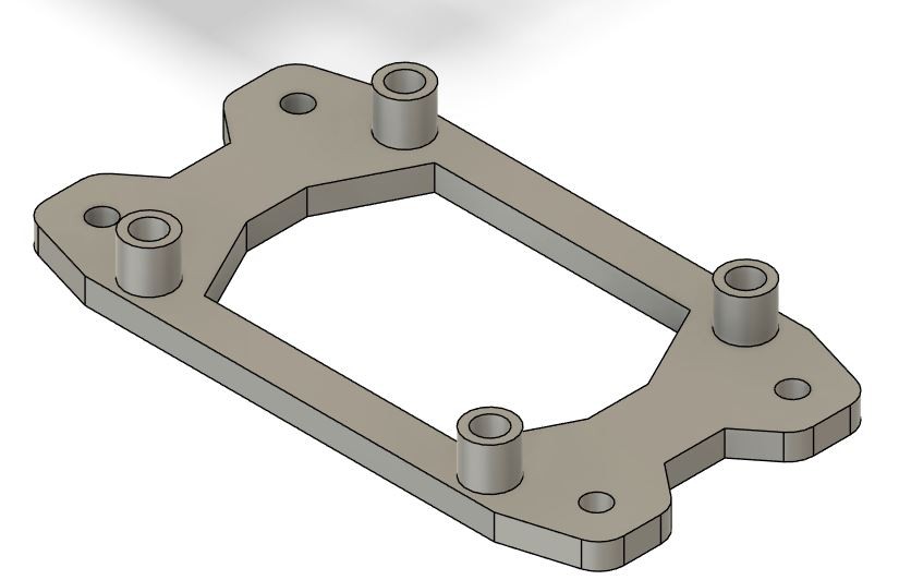

    Next is to extrude. I usually go with 3 mill
    Last step is to add some spacers so the carrier will be above the gird. This is required so you can fix e.g. the nuts of the brass spacers - like this
    So you already know the drill - add some more circles in a new sketch - I go with 5.5 mm and of course concentric to the bore
    Extrude it 5 mm
    Ready to export it to your slicer of choice and 3d print it
    Happy tinkering!

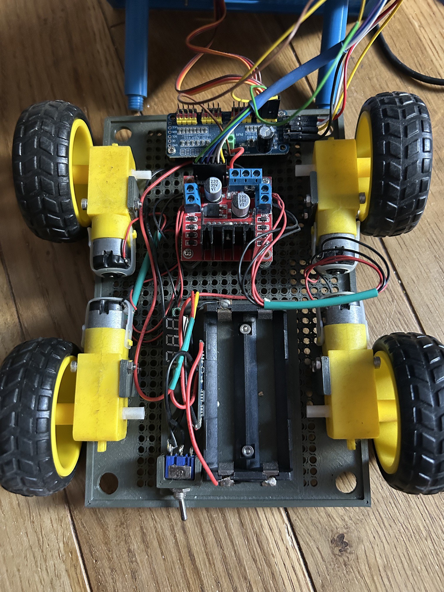

    Drive setup - wire up the motors
    The current car I run has a dedicated motor for each of the wheels. Driving works like with a tracked vehicle - turning just means that the motors on the one side will slow down or stop.
    The components I used are documented pretty well on the net - so there is no need here to go into the details. If you are interested in the details just search the net for the component. I will stick with the basics for understanding here only
    • L298N Motor driver
      The motors are driven by a L298N motor driver.
      Important for the setup to understand:
      • Power supply (Input)
        The power input can range between 5 - 12 Volts ( some sources state up to 45 Volts).
      • Power supply (Output)
        The board has a 5 Volt output that can handle up to 2 AMPs
      • Direction control
        The 2 motor outputs/directions are controlled by 4 digital PINs
      • Motor speed
        Simply said DC motor speed is depending on the voltage the motors are running on. The L298N uses Pulse Wide Modulation (PWM) to control the output
        voltage for the motors.
    • PCA9685 servo controller
      The PCA9658 is a 16 bit 12 channel PWM Servo driver that is accessed over I2C bus.
      While a lot of boards like the Raspberry PI Zero 2 W have PWM pins on board some sources state the PWM output quality is better on the PCA9658. Having it on the car anyways to control the servos for the cam holder -  I use it to control the speed of the motors.
      • Power supply
        The PCA9685 has 2 power inputs. One to supply the logic circuit and another one to supply the attached servo motors. Both are 5 Volts for the boards I use.
      • Controller access
        The board is managed over I2C
      • PWM
        Since the motor driver has its own power supply only the PWM pins on the output channels are used.
    • DC Motors
      In my setup the DC motors are in tandem but they are in different directions on one side. Since the direction of the motor depends on where the positive and negative input is - cross wiring the motors on every side is a simple solution to this.
    • Power Supply
      I decided to go with a separate power supply for the Controller (Raspberry PI) and the Motors
      • Raspberry PI Zero 2 requires a 5.1 Volt power input over USB connector
        I used the custom 18650 power pack explained earlier for this
      • The motors have its one 18650 power pack. Since the L298N has an onboard voltage converter there is no need for the step down converter on the power pack for the motors, But I would strongly recommend a battery management system  for the motors as well
      • IMPORTANT: To avoid signal interferences  you have to have a common ground for the setup
        In my setup I bridge the motor power supply ground with a ground pin of the Raspi
    Considering all the info's above I ended up with this wiring:
    and in real life:
    As you can see there are mount points for the motors on the bottom carrier you can find over at pintables as well
    Happy tinkering
