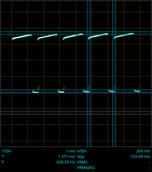

    Here's a picture of the clock signal I made today:
    The upper trace is the 3909 power pin /7473 clock input.
    The lower horizontal cursor marks the zero volt level.  That puts the lower part of the clock signal at a smidge under 0.7V and the upper part at  about 1.4V.

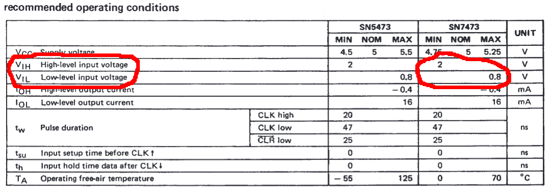

    According to the 7473 datasheet (https://www.ti.com/lit/ds/symlink/sn54ls73a.pdf?ts=1768011311799) it takes a signal below 0.8V to register as a low and a voltage of 2V to register as a high.
    It's getting the low OK, but is still out of specification on the high.
    I had expected to find the clock signal waffling around higher than 0V, but I expected it to at least cross the official high and low voltage levels.  It is waffling around at neither properly low nor properly high as expected, but it isn't even crossing both levels.
    I mean, I know this thing is abusing the ICs all over the place, but I had hoped that it would al least meet some of the specifications.

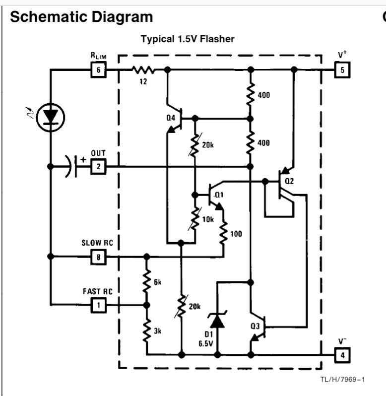

    The LM3909 datasheet (https://cdn.hackaday.io/files/291791248394336/LM3909%20Datasheet%202.pdf) shows the internal circuit of the IC.
    The LED plays no part in the oscillator. It runs just fine without the LED.

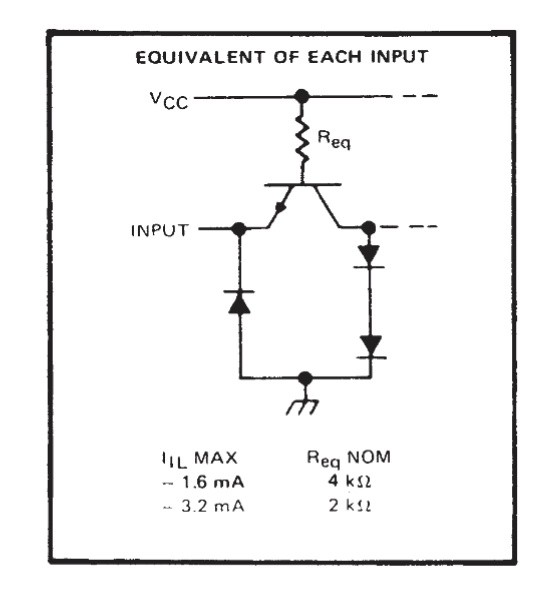

    3. The LM3909 is powered by the leakage current from the 7473 clock input. The datasheet says it needs a minimum of 1.15V to operate. It is operating here on something less than 1V.
    This is down to design specifications.  The 3909 is guaranteed to operate down to 1.15V.  What is does below that is not specified.  If it works, cool.  If not, the manufacturer just says "Oh, well. Tough.  The 3909 isn't specified for that."  Practically, the LM3909 blinkers were used with a single 1.5V cell, and ran to exhaustion. If it ran with a battery discharged below 1.15V, fine.  So much the better.  It just wasn't guaranteed.
    As for just where the power comes from, that is given by the design on the inputs on the 7473:
    The clock input is the emitter of an NPN transistor.  Current flows from VCC, through Req, through the base of the transistor, and out of the clock input.  Depending on the exact value of Req, you get anywhere from 1.6mA to 3.2mA out of the input.  The LM3909 datasheet says it draws a maximum of 0.75mA.  That load pulls the voltage down considerably, but still leaves enough voltage for the 3909 to operate (though far outside of its specifications.)
    4. The clock signal to the 7473 is a 0.7V peak to peak signal. By the datasheet, a low is maximum 0.8V and a high is minimum 2V.  Somehow, 0.7V is enough to trigger the clock.
    I strongly suspect that the 0.7V does not oscillate between 0 and 0.7V, but rather that it bounces between something just over 0.8V and something somewhat below 0.8V.  I needed to check the offset on the clock signal, but didn't do it.  I won't be able to get to my workbench to check this before the contest deadline, so this will have to remain speculation for now.

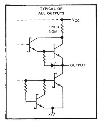

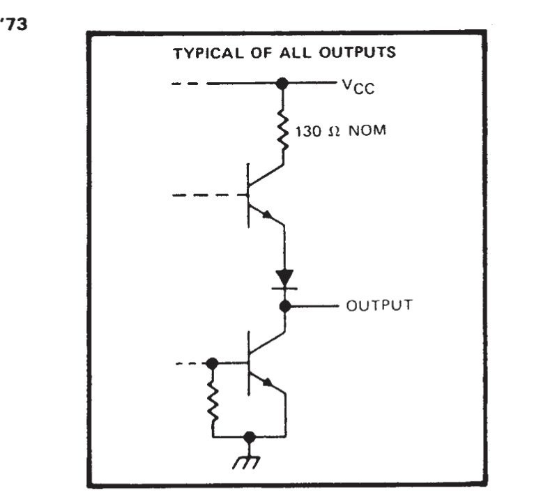

    6. The 7473 is driving the LEDs directly, with no current limiting resistor.  This exceeds the output current limit for the 7473.
    7. The LEDs are driven directly from the 7473 with no current limiting.  This exceeds the LED current limits.
    These two have a common cause: The output circuit of the 7473:
    That resistor...

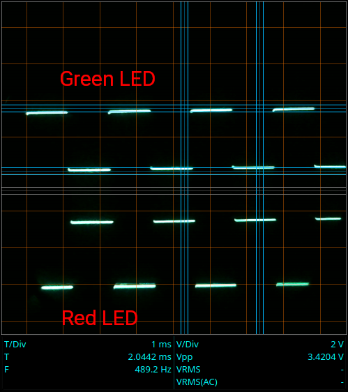

  • LED waveforms
    Joseph Eoff • 11/05/2025 at 21:44 • 0 comments
    Since I had the prototype and the oscilloscope both at hand to check the oscillator signal, I went ahead and checked the LED signals.
    The 7473 does a pretty decent job of squaring up the funky edges of the LM3909 signal.  The outputs are nice, neat square waves.
    Each alone wouldn't do you much good.  The trick is when you connect the LEDs anti-parallel with the diode under test in series with them.
    There is effectively an AC signal across the LEDs.  Putting a diode in series cuts off one half of the AC cycle, leaving only one half to drive the LEDs pair.  Which ever LED "points" in the same direction as the diode under test lights up.
    As the 7473 datasheet shows,  the Q and /Q outputs of the 7473 are each effectively half an H-bridge, with the /Q driven by the inverse of the Q output:
    Two half H-bridges and an inverter make a full H-bridge.  If there were a (very) low powered motor in there, it would reverse direction on each pulse of the clock.  Instead, there are two diodes in anti-parallel in there.  They light up alternately as the clock pulses.
    If you slow down the clock, you can see the LEDs light up one at a time.  With the fast clock I've used, they alternate faster than the eye can see - they appear to be both on all the time when the diode under test is shorted.

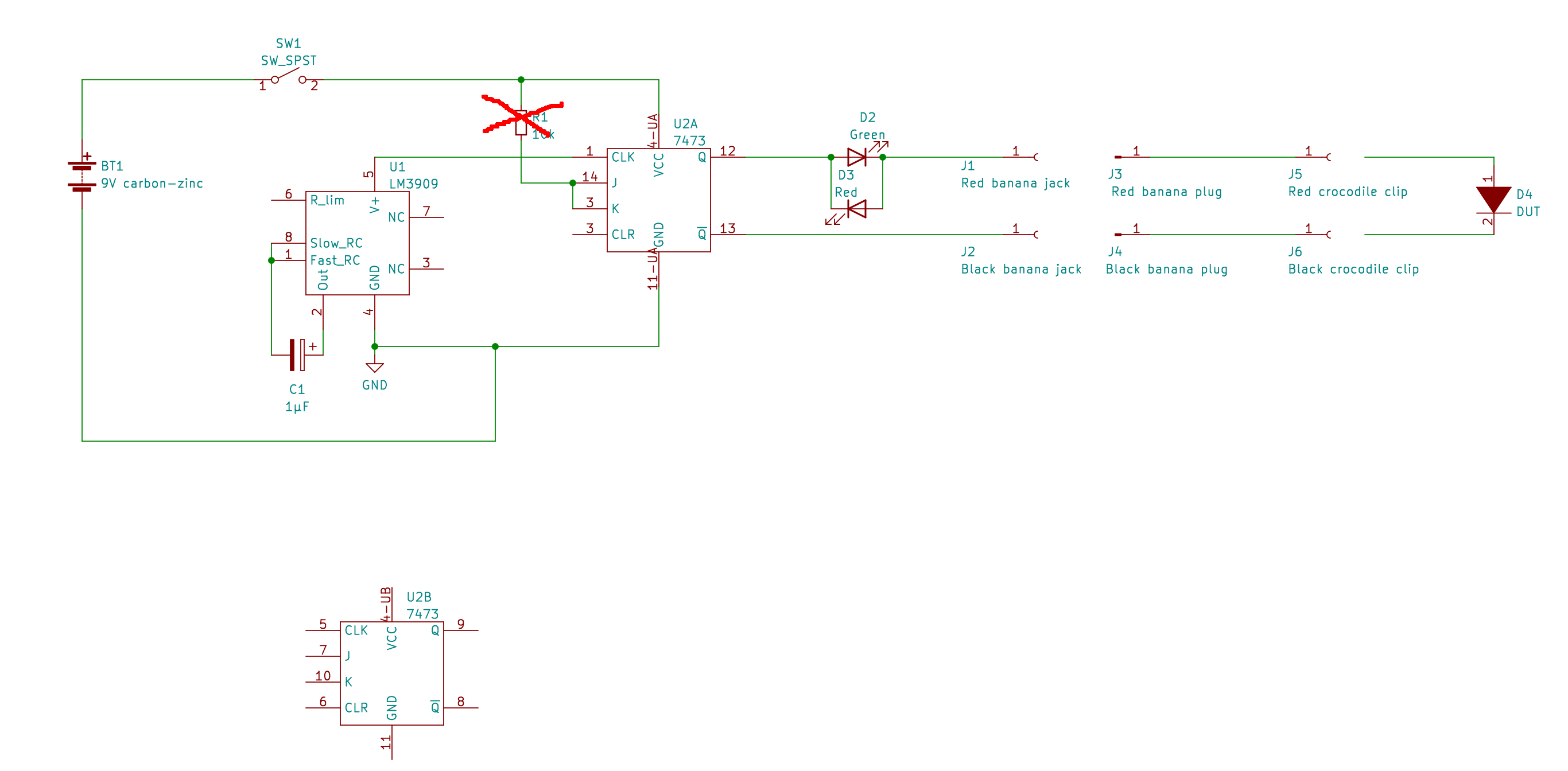

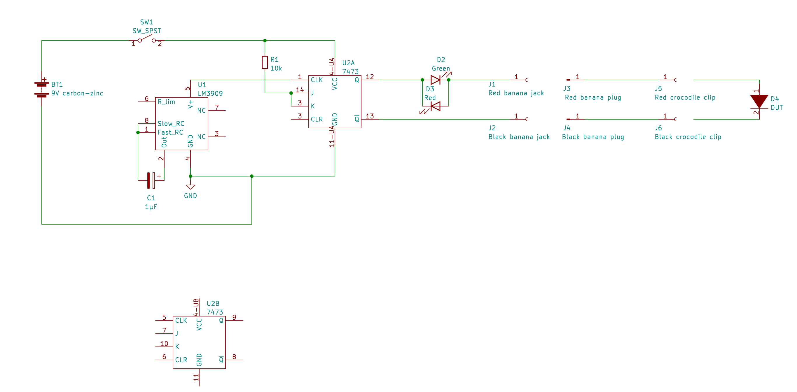

  • Corrections to the schematic
    Joseph Eoff • 11/05/2025 at 21:16 • 0 comments
    While trying to figure out why my new diode tester wasn't running, I found a decades old sketch of the circuit.  It was stuck in between some other drawings that I had stuck in my copy of the "Engineers Notebook."
    It turns out that you don't need the LED on the 3909, but you do need a pull up on the JK inputs.
    I updated my prototype and the schematic accordingly:
    It is still a very simple circuit, very well suited to building on a perfboard.

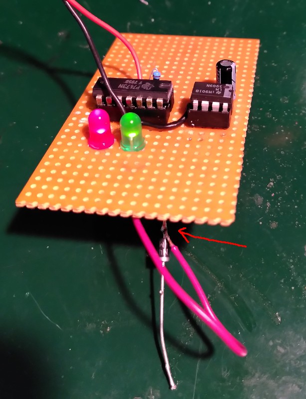

    I built a prototype a few weeks ago, but couldn't get it to work.
    There were two things wrong:
    1. An incorrect wire
    2. An incorrect IC.
    I managed to short circuit the indicator LEDs when I put them in.  Had a simple brain fart, and wired two pins together that shouldn't be connected.
    For the incorrect IC, I used a 74LS73 instead of the original 7473 - no LS or other designators in the middle.  I happened to have a single 74LS73 in a junk box in the attic.  When it didn't work, I ordered some real 7473s from eBay - I guess I got lucky, because they do work.

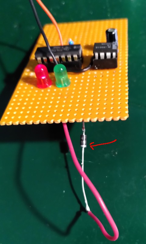

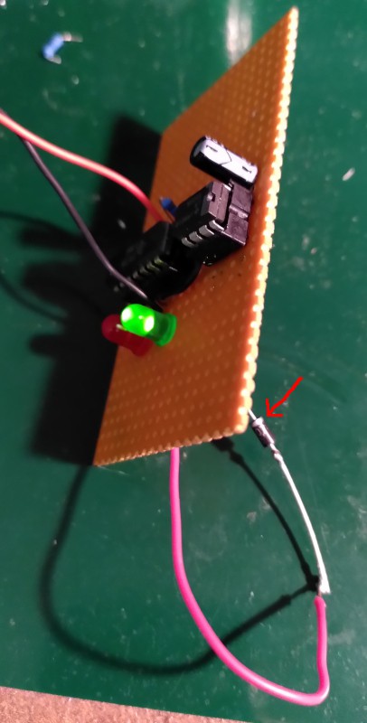

    Here's the prototype showing a good diode connected the right way around:
    Only the green LED is lit.
    Here it is with the diode under test connected backwards:
    Only the red LED is lit.
    Here's a short circuit:
    Both LEDs are lit.
    The prototype works as it should.

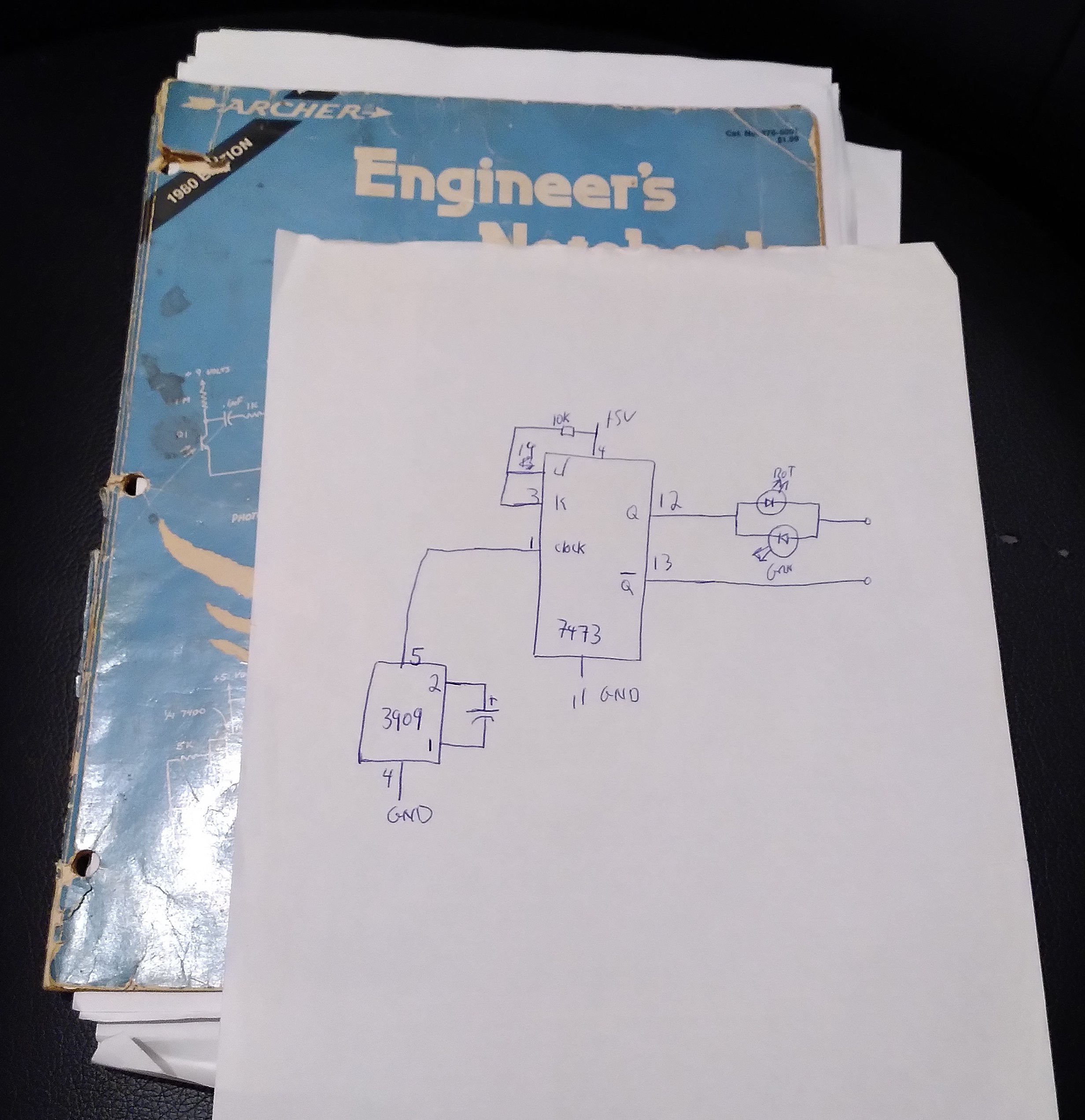

    Way back in 1980, my dad didn't have a program for drawing circuit diagrams.  Heck, we didn't get a home computer (a used TRS-80 Model 1, level II) until a few years later - and it couldn't have been used to draw a schematic diagram.
    My dad's hand drawn diagrams disappeared decades ago.
    I've recreated them from what I remember and by referring to the "Engineer's Notebook" from Forrest M. Mims.  That's the book my dad used when making the diode tester, since we didn't have datasheets or any other kind of documentation.
    My copy of the "Engineer's Notebook" is the later one with the blue cover from 1980 rather than the first printing from 1979 with the yellow cover.

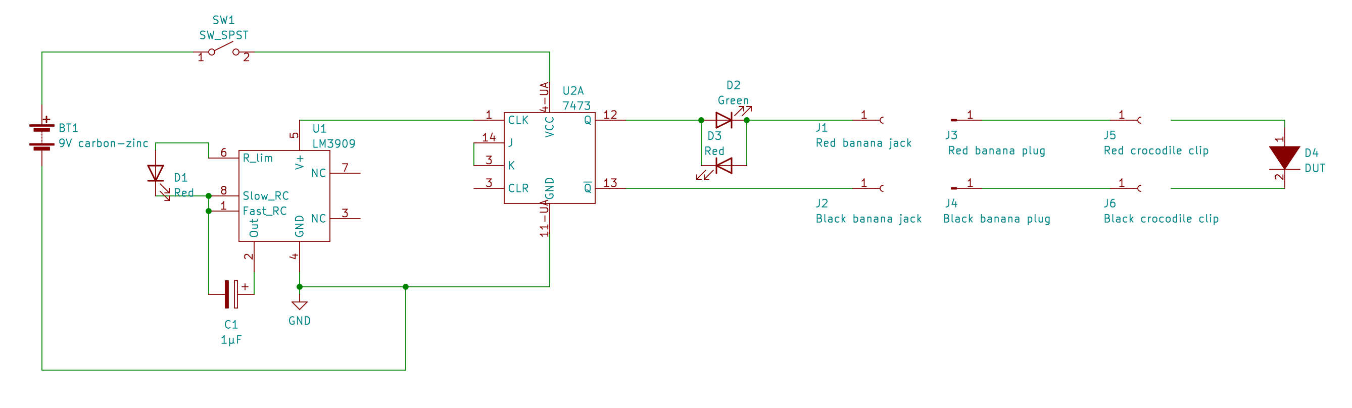

    I used KiCAD to draw the circuit as best I can remember it.
    Here's the schematic:
    The idea is simple:
    1. On the left is a battery that powers the circuit.
    2. There's an LM3909 as an oscillator driving the clock of a JK flip-flop.
    3. The JK flip-flop is set to toggle its outputs by connecting the JK inputs together.
    4. The Q and /Q outputs swap state on every clock pulse.
    5. Viewed between Q and /Q, you have an AC square wave.
    6. There are two LEDs (D2 and D3) in anti-parallel in series with the device under test.
    7. The DUT will remove one half of the AC cycle.  If it is connected in the same direction as the green LED, then only the green LED will light.  Same with the red LED.  If the DUT is open, then neither LED lights.  If the DUT is shorted then both LEDs will light
    8. LED D1 is part of the oscillator circuit, but also indicates power on so that you can tell the difference between open DUT and dead battery.
    So far, so good.
    It really does work.  My dad built several of them for work.  I built a couple of them myself for an electronics course in highschool and later for other projects.
    It is how it does it that is really messed up.
    Look it over and see how many ways the ICs and LEDs are being abused.
    I'll put a list of all of the abuses in a later log.  See if you can find them all.
