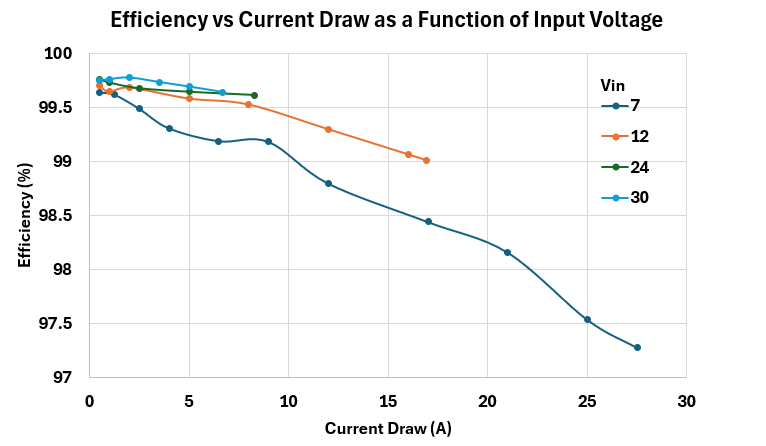

    PN Labs02/25/2026 at 20:38 0 comments
    The results are in and are better than expected!
    The overall efficiency is about 98% typical, owing to the use of the stand-alone ASIC with low Rds-ON FETs.
    Efficiency vs Current Draw
    The final efficiency is still going to be good but will be slightly less, as we are re-designing the front-end analog voltage sensing system to have an adjustable, fixed band hysteresis. This involves adding external comparators, but is absolutely necessary because of the auto-retry nature of our system.

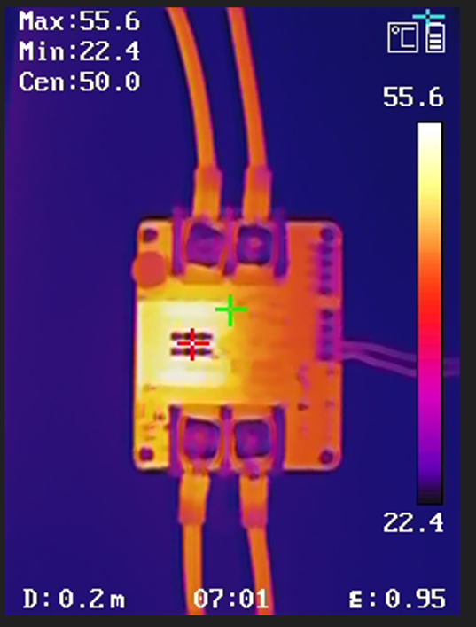

  • Updated Thermal Testing
    PN Labs02/04/2026 at 17:55 0 comments
    The results are in and the final temperature was around 102 C after 5 minutes of continuous testing at 29.5 A!
    One thing the previous calculations neglected was the heat generated from the 1m shunt resistor, which is now placed closer to the FETs than was before.
    Next we are going to evaluate the efficiency, which should be around 95% typical, compared to about 98% for the Protect, owing to the higher series resistance of the FETs and shunt resistor.

  • Steady-State Thermal Power Testing on the IT6015C
    PN Labs12/01/2025 at 19:04 0 comments
    The most important features of the Protect+ is the ability to carry a high amount of current, ideally in the range of 30 to 40 A continuously.
    To do this, I used 3 MOSFETs in parallel for the high-side blocking and reverse blocking FETs, each with about 2.1-2.5 mOhm of on-resistance.
    The PCB used is 4-layers, with 2 Oz outer and 1 Oz inner.
    Shown below is a snapshot of the results obtained testing at 30 V, 29.5 A after about 5 minutes of continuous operation.

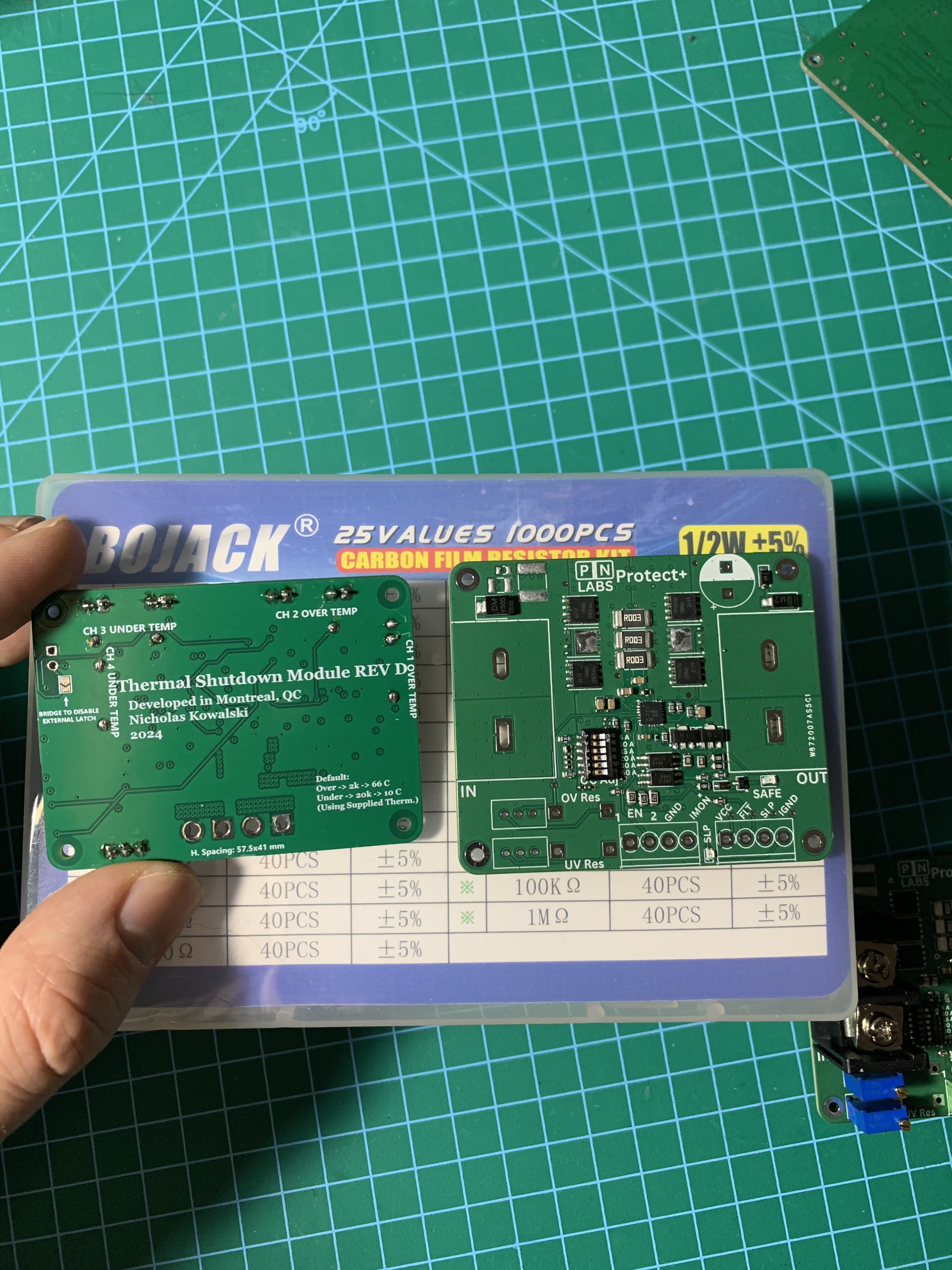

  • First Functional Prototype In - Sponsored by PCBWay!
    PN Labs11/25/2025 at 07:31 0 comments
    Its been a while since I updated this feed, so here it is with progress:
    - Changed from DIP switches back to potentiometers for voltage adjustment - continuous adjustment is better for something as sensitive as voltage cutoffs
    - Started designing a calibration jig that can measure the voltage cutoffs of each board. This is because when doing something as critical as undervoltage protection of lithium cells, having a typical 1-3% error in the voltage cutoff equation (as seen from internal testing of Protect modules) makes a difference in protecting the battery and the amount of energy that can be drawn before shutdown.
    - First functional prototype has been received by PCBWay and hand assembled! A few differences I noticed when ordering compared to other board houses:
    • PCBWay supports higher copper weights like 3 Oz, 4 Oz, and much higher, whereas other board houses like JLCPCB can only do 2 Oz currently. This is very important for high current designs (like the Protect+) where large copper pours (and stitching together different pours on different layers) are necessary to draw heat away from components on the board.
    • I found the green solder mask on the PCBway boards to be much more visually appealing and higher quality than what I am used to. The dark olive color makes the board look very premium, and it reminds me of the PCBs you sometimes find in precision equipment with an ENIG finish. I've put a comparison between the Protect+ prototype and another board below.
    • One mistake I made when ordering is not understanding the difference between the framework and non-framework stencil option. I think that the website pictures on the ordering page explaining the differences could be made more clear to show that Non-framework is the one most people hand prototyping would want (they should delete the confusing holes on the sides). I ordered the one with framework and it came separately, glued to a big aluminum frame which was great but somewhat unnecessary for my hand assembly.
    The prototypes cutoff at the right voltages and everything seems to be in order, so the next step is to do some preliminary power testing to see how the board copes with in-rush current, plus its steady state thermal profile at different power levels (2 FETs or 3 in parallel?).
