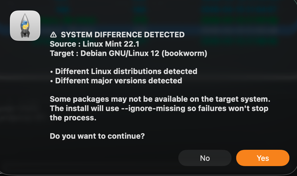

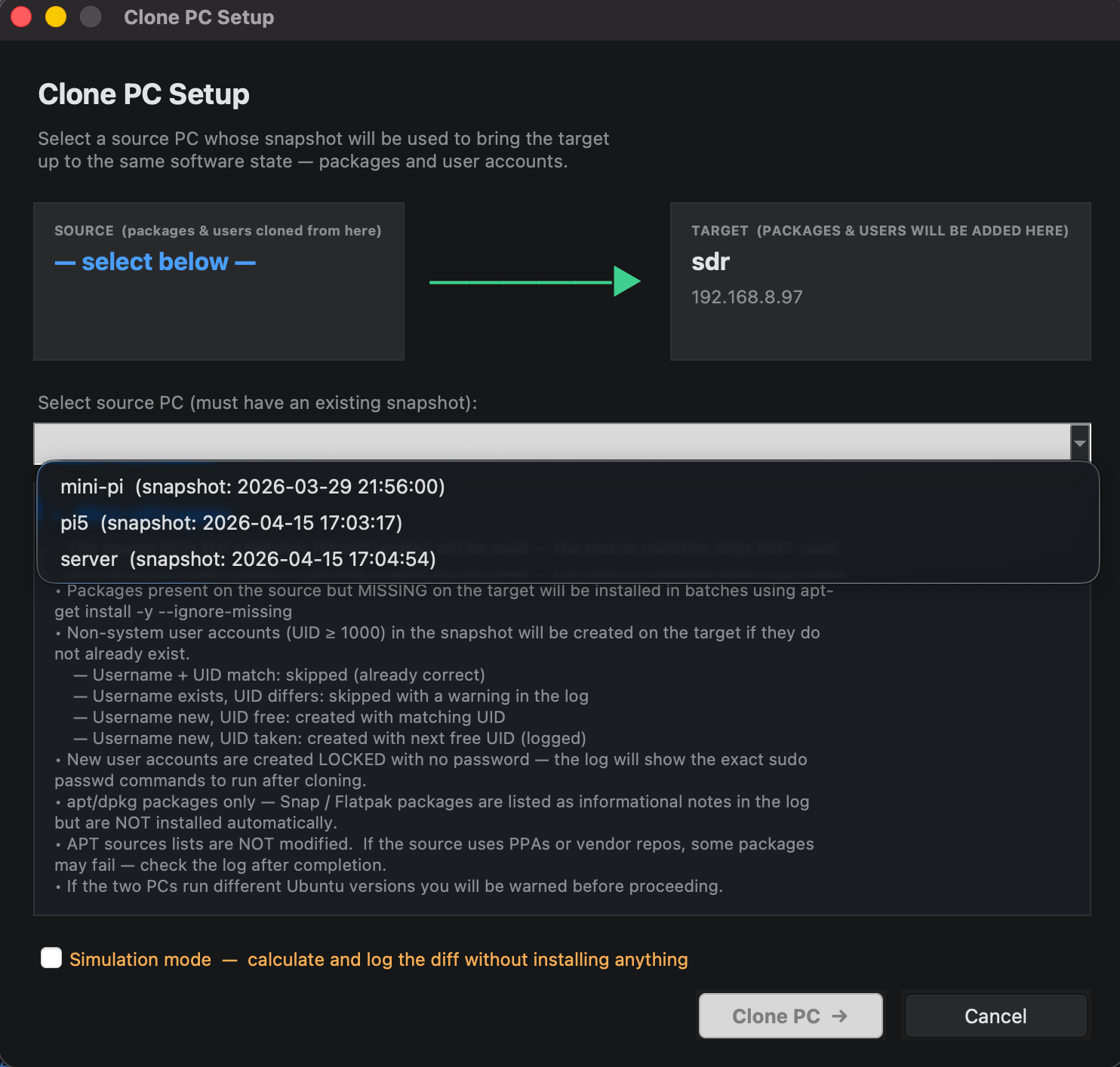

      New version adds a powerful clone pc option (rapid deploy).
      uses a snapshot from a pc in the list view (that a user can select) and will clone the same software onto a selected pc, No disk level copying or hard drive partition cloning. just users, groups and software lists.
      Can clone from :-
    • Pi → x86
    • x86 → Pi
    • Ubuntu → Debian
    • Old Debian → new Debian
    • will also create users and groups also but new users will not have a password set until a user logs in on the target pc.
      Attempts to match the UID as well, if the UID is taken, will map to the next UID.
      very easy way to take a new pc just added to the network up to a configured pc (with a snapshot).
      Extensively tested in simulation but should work for real.
      A weeks serious coding and adding in guarding to get woking.
      I even had to re-write the snapshot generation code, so existing users of this tool may want to re snapshot your managed pcs before moving onto cloning a pc.
      What it does not do is copy config files or different configurations from the default installed software, there are too many variables to cater for with this approach. this tool is a get a new pc to 95% of the way there and then its up to the administrator to configure afterwards.
      This tool will NOT clone users Home directories as it could take hours to copy multiple GB of data across.

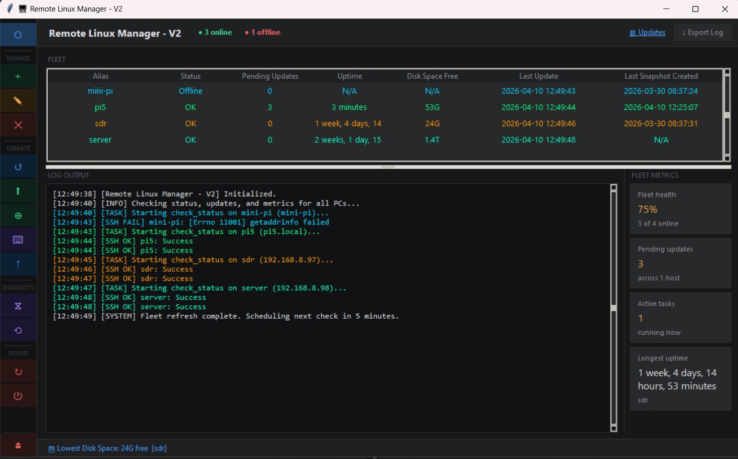

  • Updated to version 2 with fresh UI
    diddy • 04/10/2026 at 12:00 • 0 comments
    Cosmetic update.
    All functionality still exists but because of the previous update had status updates added, we could afford to tweak the UI to a new look.
    All toy town Windows XP look buttons are gone and are replaced with icons down the left hand side.
    now there is more room to view windows and the stats can be presented to the administrator in a more friendly way
    The pc list and Log file can be dragged vertically for the user to tailor

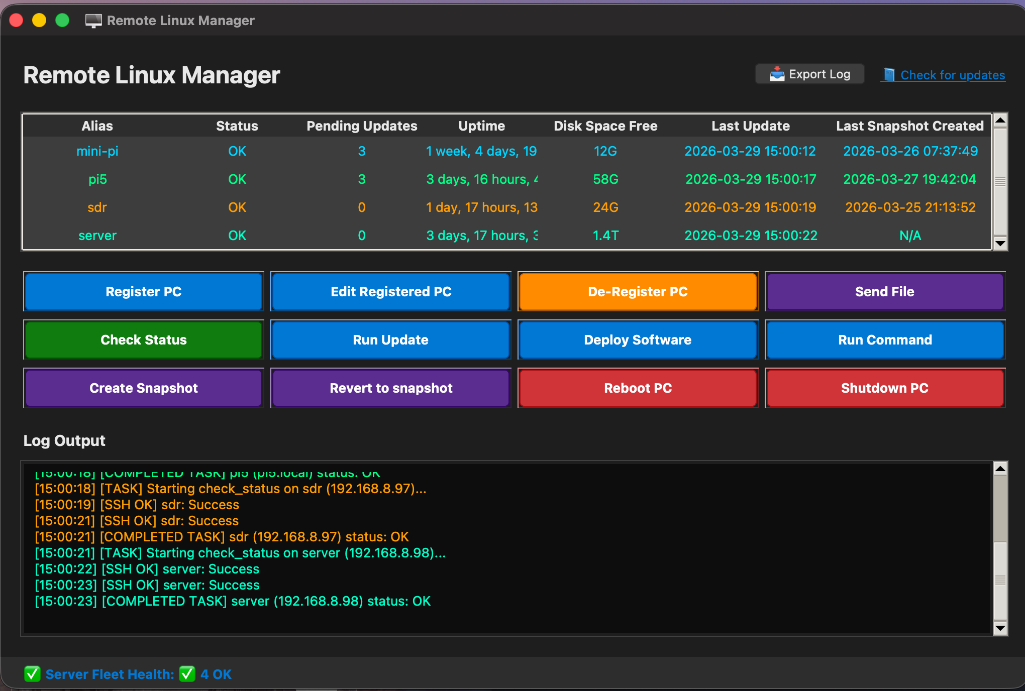

  • New version adds status bar
    diddy • 03/29/2026 at 14:39 • 0 comments
    New version adds :-
    Added a status display in the bottom bar that will show info like :-
    Offline pc's
    Longest Uptime of any pc
    Server fleet health
    Last action performed
    PC with lowest disk space free
    PC with most updates pending
    Last update
    Oldest snapshot
    when syncing number of PC's synchronized
    also added an auto check every 5 minutes for all registered pc's in the list which also updates the status bar.
    Now users can auto monitor their server fleet
    Also added detection and refresh every 30 seconds if a PC goes offline and when the pc comes online again.
    Can be downloaded from :-

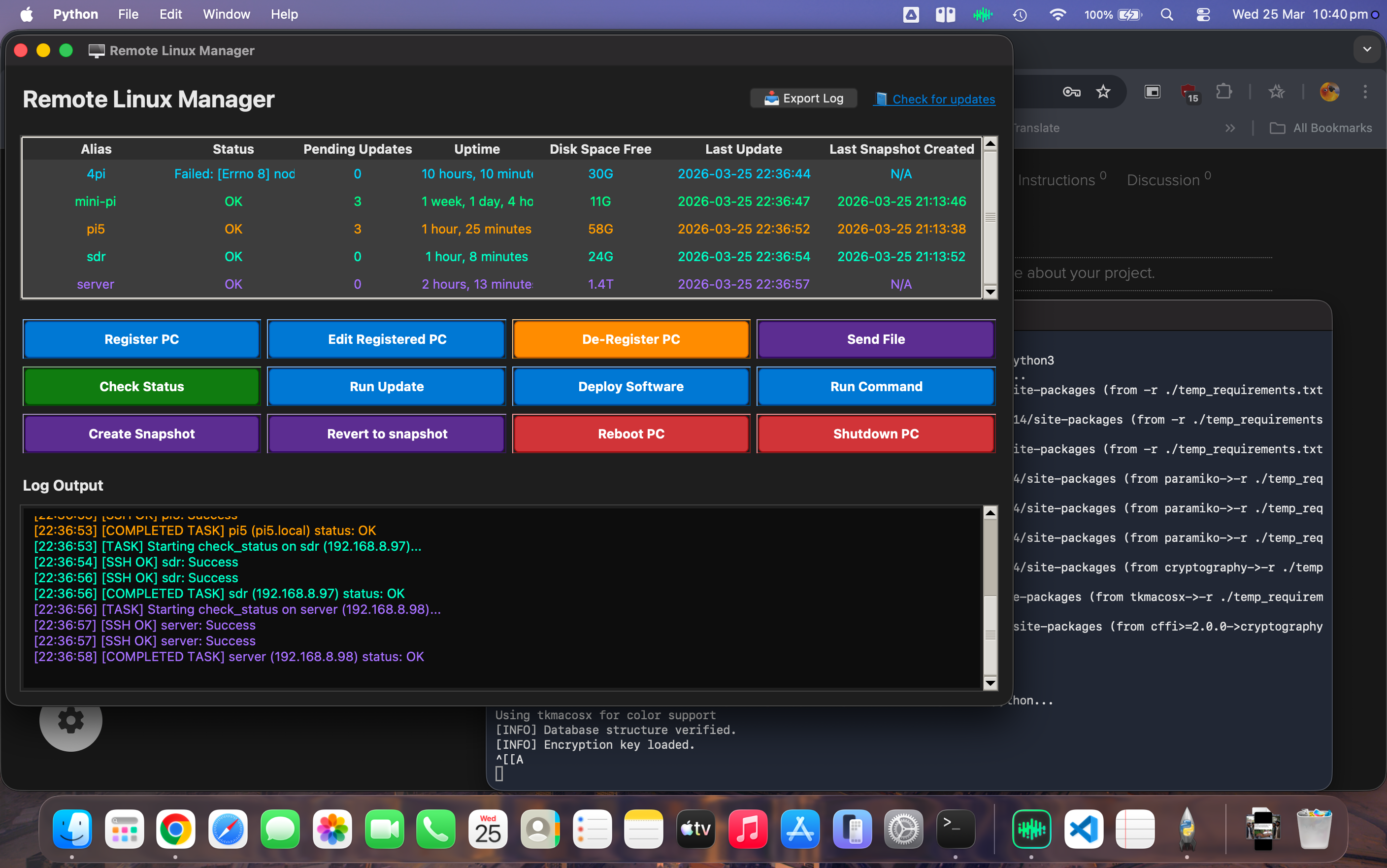

  • New version adds export log
    diddy • 03/25/2026 at 22:43 • 0 comments
    New version adds export to a log file for all of the activity window (bottom view).
    great for checking at a later date.
    Also refactored code and removed ghost code, duplicates and optimised for speed.
    general usage is a lot faster now.

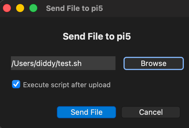

  • added ability to execute script on upload
    diddy • 03/16/2026 at 17:36 • 0 comments
    Users can now execute a script after uploading to a remote linux machine.
    Just select 'Send File' button, browse to the script.
    tick the 'execute script after upload' and select 'Send File'.
    the scripts output will be shown in the log window.
    the Manager will inject a sudo password if asked but I wouldn't recommend interactive scripts

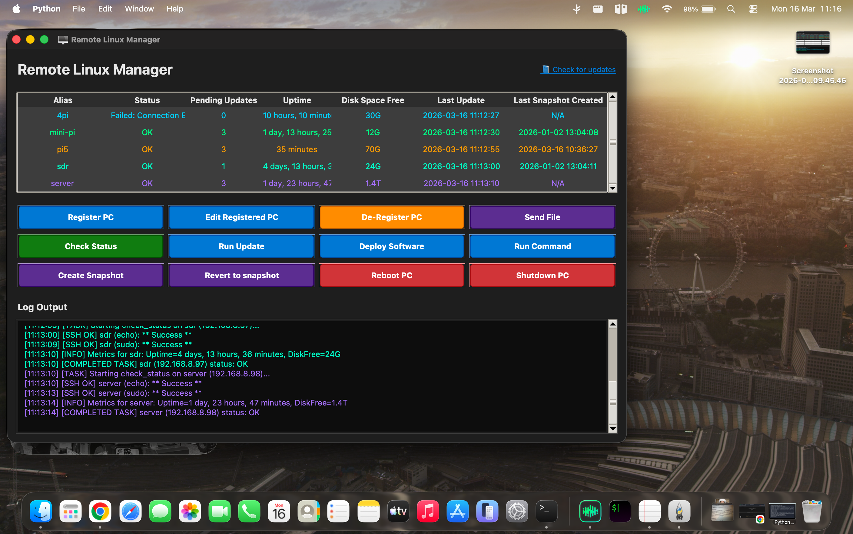

    Screenshot under Mac OS Tahoe
