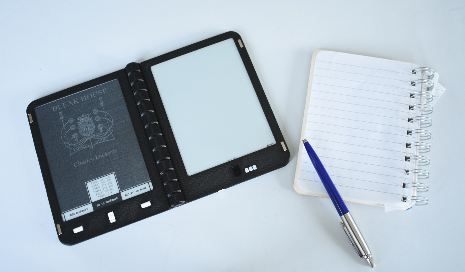

Diptyx E-reader
A dual-screen, ESP32 powered ereader: Own your device, own your books
The Diptyx ereader is a dual-screen ereader that runs on an ESP32. It runs custom software capable of displaying EPUB files and uses two e-ink screens for a book-like reading experience. Through the built-in UI, you can scroll through chapters, add bookmarks, change the font type and size, and much more. When not in use, the ESP32 enters deep sleep, which minimizes power usage and allows for weeks of normal use. Currently the project is in the pre-campaign stage on crowdsupply, where you can subscribe to get notified for updates.
Now available for pre-order on Crowd Supply!
Diptyx E-reader is the ultimate ereader for readers that want to own their device and everything on it.

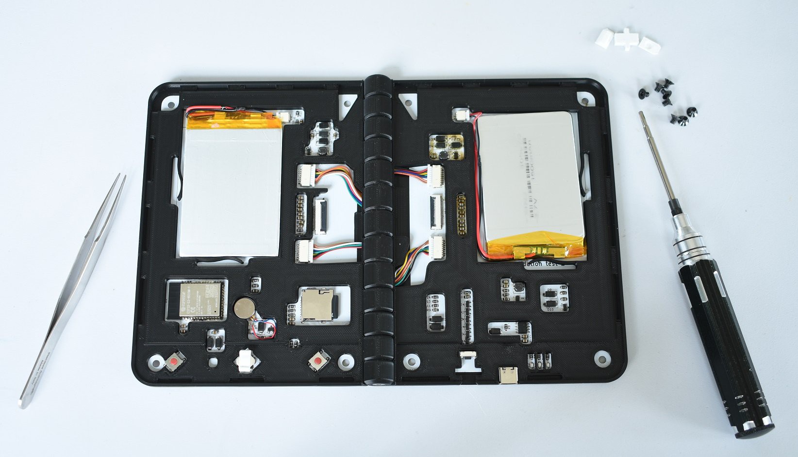

It utilizes the powerful ESP32S3 chip with 16MB of flash and 8MB of RAM, with an internal SD card for book and font storage. A usb type-C is present for charging and transferring files,  and clever circuitry ensures the device knows when a cable is plugged in, even from deep sleep.
Two 1500mAh lipo batteries and an efficient tps6284 buck converter ensures weeks of normal use and many months in standby. Two 648*480 E-ink are used to show two pages of a book at once, giving a book-like reading experience. Customs LUT's are used for low-latency page turning, in combination with page buffering.

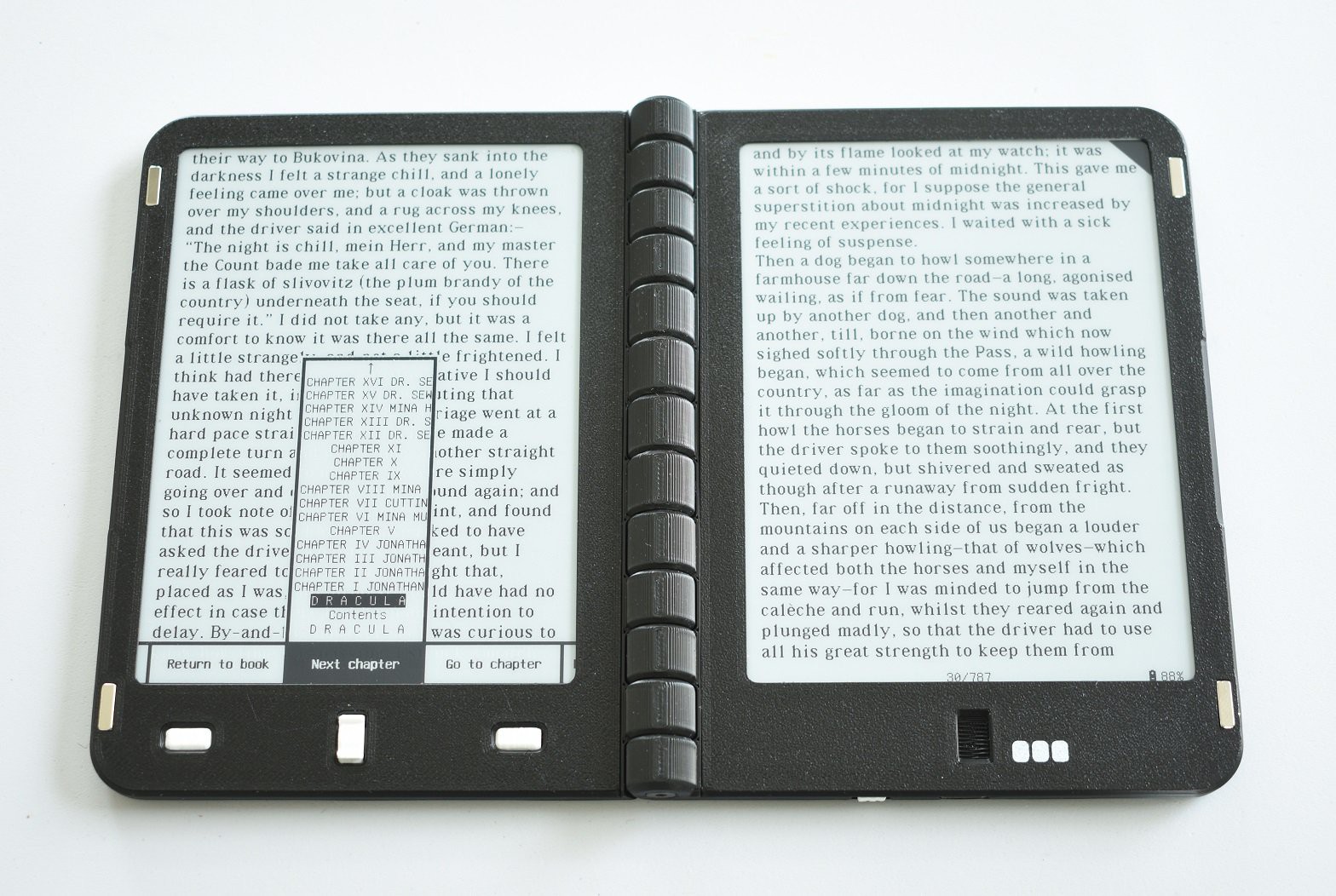

A 3 way button + 2 buttons are used for page turning and menu navigation. The built-in UI is used for editing both rendering and device settings, such as font size, standby timeout, line spacing. In addition, a quick menu is available during reading, which allows you to quickly toggle settings such as night mode, add and navigate bookmarks, and scroll through chapters. These settings are of course stored persistently in the flash memory of the ESP32.
The firmware is partially based on Atomic14's epub reader and can parse EPUB files with changeable fonts, font sizes, line spacing, and supports styles defined in css and can render images. Books are index before reading, allowing you to scroll through chapters and see how many pages a book has, this data is stored in non-volatile memory, but indexing has to be redone after changing settings such as font size or line spacing.
This project is currently in pre-launch on crowdsupply, where you can subscribe to get notified for updates: https://www.crowdsupply.com/diptyx/diptyx-e-reader

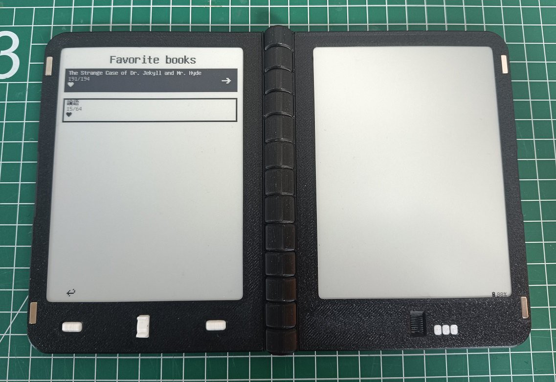

    Pinning books
    In the book library, you can now click on a book with the middle button to add it to your favorites list. This is shown as a small heart underneath the pagecount of the book,. Favorite books are listed under the favorite books tab, which is always the first element in the library menu.
    Pin your favorite books with a single click
    All your favorite books are listed in the favorite books tab

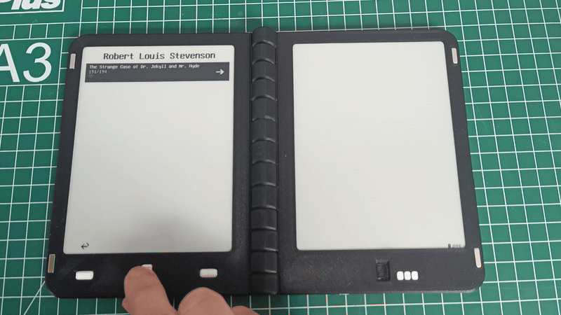

    To further customize your reading experience, I have added the functionality to choose the type of idle screen you want. By default, when the device enters stand-by or is manually shut down, the screens remain the same, except for a small notification in the lower-left corner indicating whether the device is in deep sleep or fully off.
    Now, in the settings menu there is a new setting, called standby screen, which can be set to 'none', 'current book', or 'custom'. When set to none, the previous behavior remains. When set to current book, the cover of the book that you're currently reading is displayed:
    And finally, when set to custom, two images are displayed on both screens. These images are stored on the SD card, and can be easily changed by uploading new images through the usb port:
    The type of standby screen can easily be changed in the builtin settings menu
