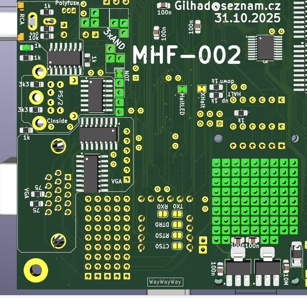

    There are unused 3 AND, 1 NOT and another 1 NOT + LED may be recovered at expense of HALT visualisation.
    Also under SD card module is 8x9 free THT soldering points accompanied by +5V, +3V3 and 2 GND.
    All MCU pins are avaiable on connectors as well as lot of internal points.
    That can be used for adding custom connections, HW and functionality, if needed.

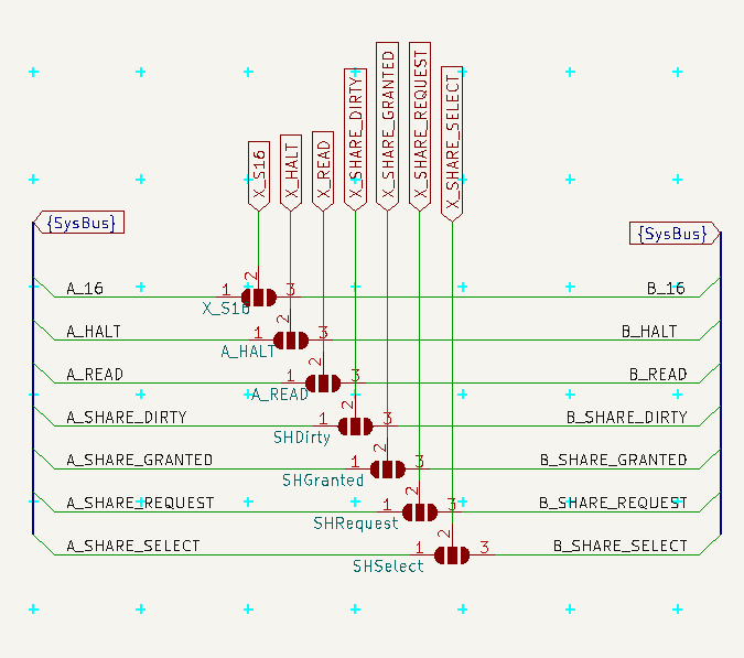

  • SystemBus
    Gilhad • 01/04/2026 at 18:14 • 0 comments
    There are two copies of SystemBus, both paralely conected. Either one, or both may be used to stack with other PCBs like retrocomputer or another cards together. I will use female/male connectors (socket with long legs) in the inner position, but it is also possible to use pins downwards and socket upwards, alternation positions, if the F/M connectors are ont available or practical.
    The SystemBus contains the usual common power, 8bits Data and 16bits Address, then communication with GLUE divided to A and B parts and rest of pins is reserved for signals (like MasterReset).
    MasterReset is used for reseting all connected PCBs, while normal Reset resets only this PCB without affecting others.
    |SystemBus-schema.png|
    |SystemBus-side.png| view from side with sockets in outer and pins in inner holes

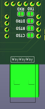

    Serial connection
     RX/TX are on pins PE0/PE1, CTS/RTS are on pins PB4/PB5, all 4 are at their respective ports pins. DTR is connected to Reset block directly.
    Together they are on Serial connector on top edge for connecting any external Serial source (default).
    |USB-Serial_pinhead.png|
    Solder-jumpers there enable connection to CH340G USB-Serial convertor.
    |USB-Serial_CH340G_top.png|
    Another set of Solder-jumpers is under CP2102 module and allowe use of that module.
    |USB-Serial_CP2102_bottom.png|
    CH340G and CP2102 cannot be used together, or with external Serial (signals will conflict).

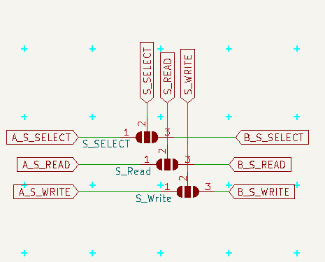

    AxB SystemBus connection - Graphic Card
    Graphic Card configuration is the final goal - this PCB would serve as Input/output for retrocomputer - SystemBus is connected to other PCB, where is retrocomputer and its GLUE is managing Shared RAM and some more signals.
    There may be 2 such cards in system (one for VGA/RCA where screen takes 90% of time, other for SD card, PS/2 and Serial, where some transmission needs be uninterrupted by screen). One card will be named A and other will be named B and GLUE will talk to each separately. To became Card A solder left part of each of 10 jumpers, to became card B solder right part. (And in both cases unsolder SBC configuration.)
    |config_GLUE_top.png|
    |config_GLUE_top_A.png|
    |config_GLUE_top_B.png|
    |config_GLUE.png| This is communication from MCU to GLUE.
    |config_gates.png| Here is communication from GLUE to gates
    |config_shared.png| and here communication from GLUE to Shared RAM
    Notice, that in order to read/write shared RAM the MCU need ask GLUE to set related signals (and GLUE will do it only if the Shared RAM is owned by MCU)
    HALT + LED
    For proper boot of retrocomputer may be needed to fill its RAM with the "ROM" part before it is started. To do so the HALT should be pulled DOWN (it is active low) and hold there until is all ready.
     If this PCB is supposed to do that, it would be good to solder pulldown resistor (and not pullup), after boot actively hold down the line and after setting the RAM (open gates via GLUE, manipulate A0..A16 and D0..D7 and set write signal via GLUE) hold it UP.
    If this PCB is suppose to do that, but does not want to doo it, solder pullup resistor (and not pulldown), cut the XHalt jumper and use HALT LED for anything else (like SYSTEM_LED, but beware, it is also active low)
    If this PCB is not suppose to do that (the other (AxB) card should do it), do not solder any pull* resistor, cut the XHalt and use LED as you want.
    On SBC configuration this line is used to to write to Shared RAM, so do not solder pull* resistors, do not cut XHalt, but you may cut out the HaltLed or leave it to indicate writes to Shared RAM.
    Also you may cut the HaltLed and solder any output to this inverted LED or use the invertor for anything else.
    |config_HALT.png|
    |config_HALT_bottom.png|

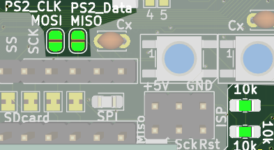

    PS/2 Direct access + Inside
    If you want read the PS/2 direct and process it, solder the 2 jumpers near SPI/SD card (and change the two marked resistors to 1 kOhm ) Also you may want to cut the Inside jumper, as it is probabelly of no use in such scenario. It also interfere with SPI, which needs address in SW.
    |PS2_direct_top.png|
    SD Card
    SD Card may be cut off SPI and managed separatelly via its header, but it is probabelly of no use

    Default Serial uses USART0 (RX0/TX0 - PE0/PE1 pins) and RTS/CTS (PB5/PB4 pins) and DTR connected to Reset.
    There are 3 possible sources for Serial Communication
    • Serial pinhead - always conected to MCU, need all signals to be attached
    • CH340G with micro USB from Arduino Mega Pro - need to solder connect (RTS/CTS does not work with usual drivers)
    • CP2102 module with USB A - need to solder connect
    There can be two modes of communication
    • full with RTS/CTS flow controll - recomended - protect agains buffer overflow, when PC transmits more data (like a file, or Copy-Paste larger block)
    • simply RX/TX like on Arduino, buffer may overflow, cannot paste longer lines

    Errata
    • all 10 kΩ resistors in PS/2 (8+2) should be rather 1 kΩ (otherwise it take too long for reading values, like 10 clock cycles)
    PS/2
    PS/2 have 2 lines - Clock and Data. See https://wiki.osdev.org/PS/2_Keyboard
    Clock runs at 10-17 kHz, 11 pulses (normal High, active LOW), data came as
    • 1 start bit (always 0)
    • 8 data bits (least significant bit first)
    • 1 parity bit (odd parity)
    • 1 stop bit (always 1)
    The clock/data can be connected directly to PB2/PB3 MOSI/MISO via solder jumpers (default OPEN, solder to USE) and decoded as serial communication, but I will use two shift registers and R-C to detect, if we are Inside the packet or not, so I could read the data as one byte on port PF, when I do not use it as VGA data output.
    Inside signal (connected via closed solder jumper, cut if not wanted) is HIGH when clock is changing, LOW, when clock stops and PSDat is valid.
    PS-OE is active LOW and let the captured PS data go to port PF
