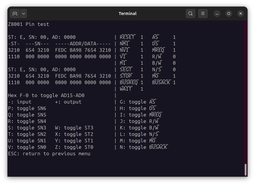

This board series include a STM32F405 microcontroler connected to a computer via a CH340G serial to USB chip. The probe is connected in place of the target CPU with a special connector.
The project is flagged as completed, as the hardware is now working. However, support for other CPUs may be added in the future, and firmware is still work in progress.
The MCU that I use for this series of boards is a STM32F405VGT6. It has ample room for controlling bits, and it can also run a software emulator for most of the 8-bit CPUs out there. The STM can support DMA and interrupts.
Supported CPUs so far:
Z80, Z8001, 8088, PC-XT, Generic, 6502, 6510, 6809
All these provide test features:
1) Bit control and probe to test for short, continuity, and other basic malfunction
2) Bus transaction to test peripheral (helps tame periferals to peripherals!)
3) Memory editing, IO manipulations
4) (Z80 for now) Emulation, stepping and register manipulation
