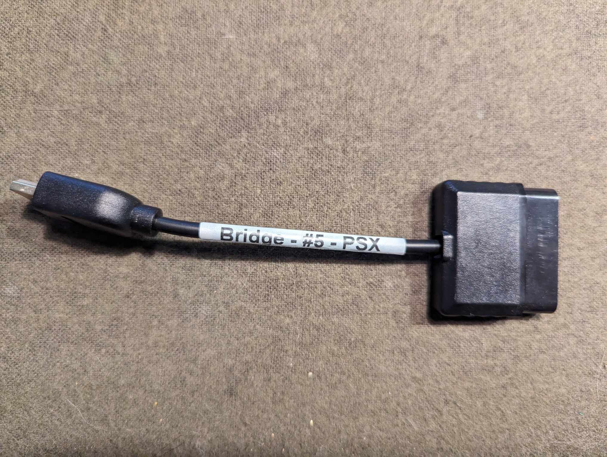

1) Use the Bridge and the correct cable to connect to your console. If you are like me, you can buy all the cables( I think I got 10 of them). A Bridge cable looks like this
there is one for each console, some reusable. This image is for ps 1 and 2.

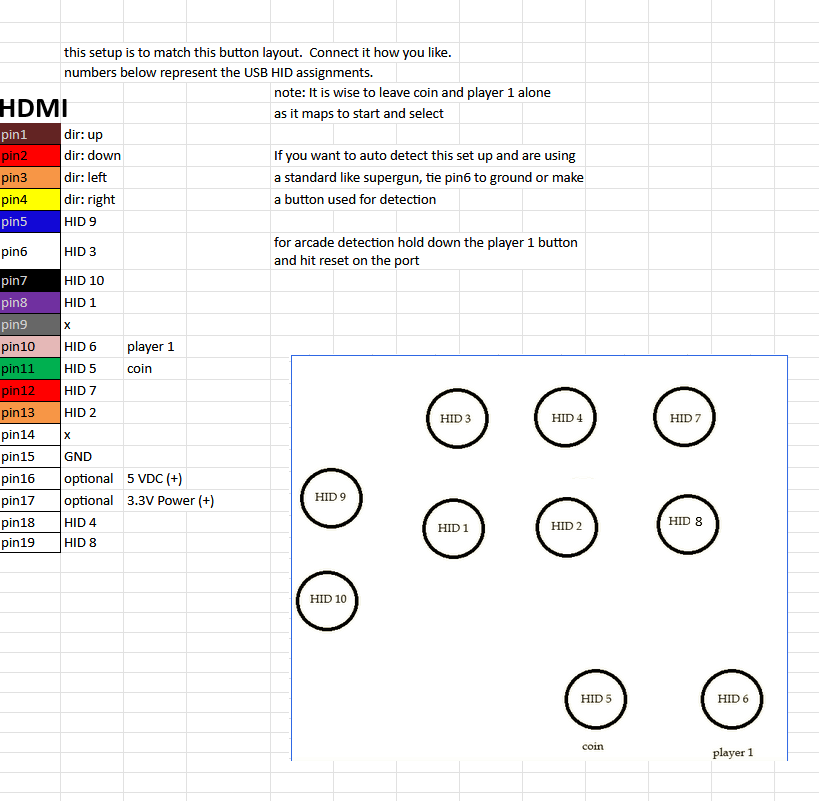

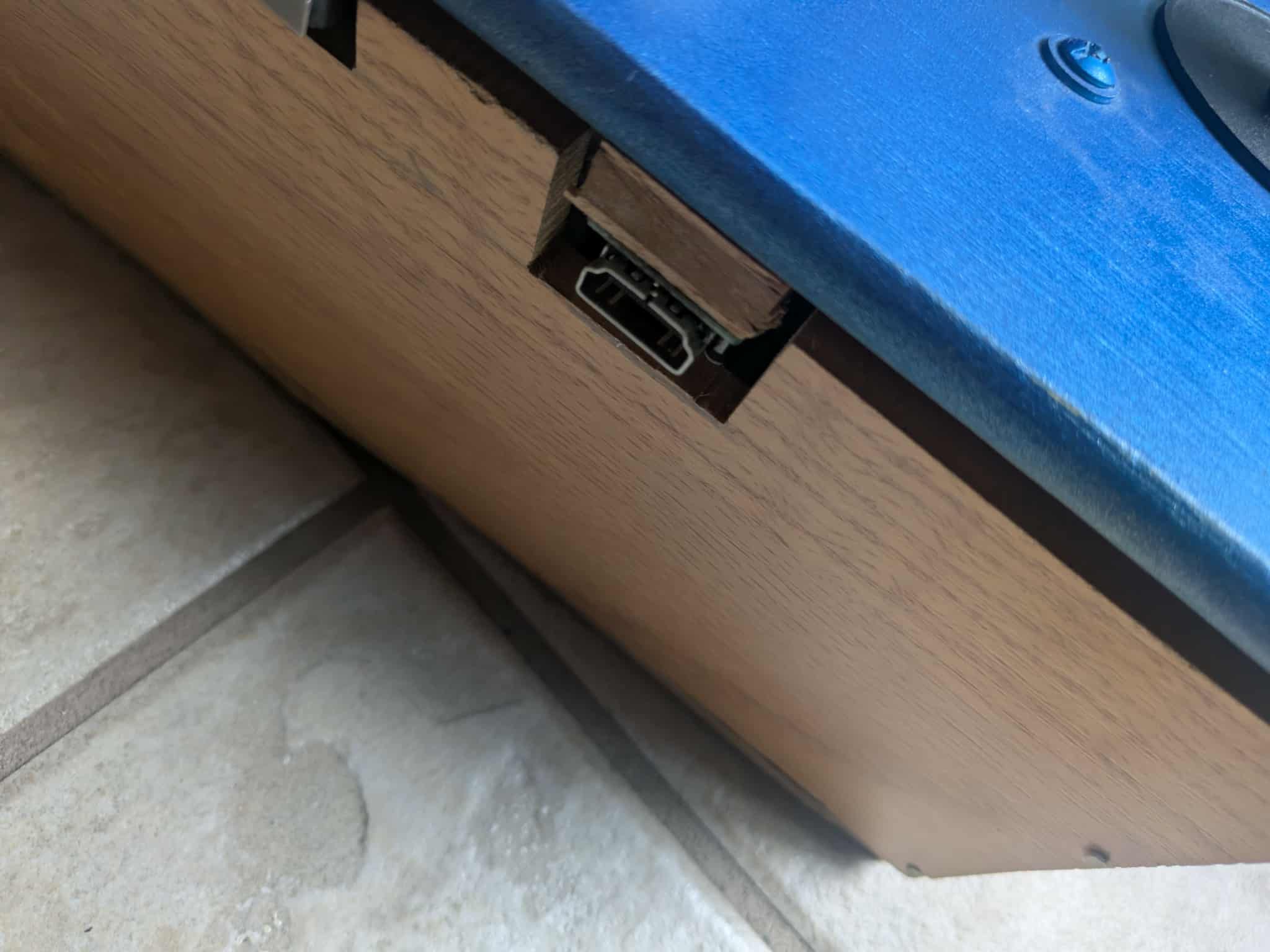

Here is what the Bridge looks like. The dongle is for setup and programming it. One end goes to the input USB and the other is output to console. 2) Use a Gamer-Pro to get the arcade stick inputs. You just need to follow this pinout. The Gamer-Pro uses an HDMI style connector and I used a common break out in my arcade setup.

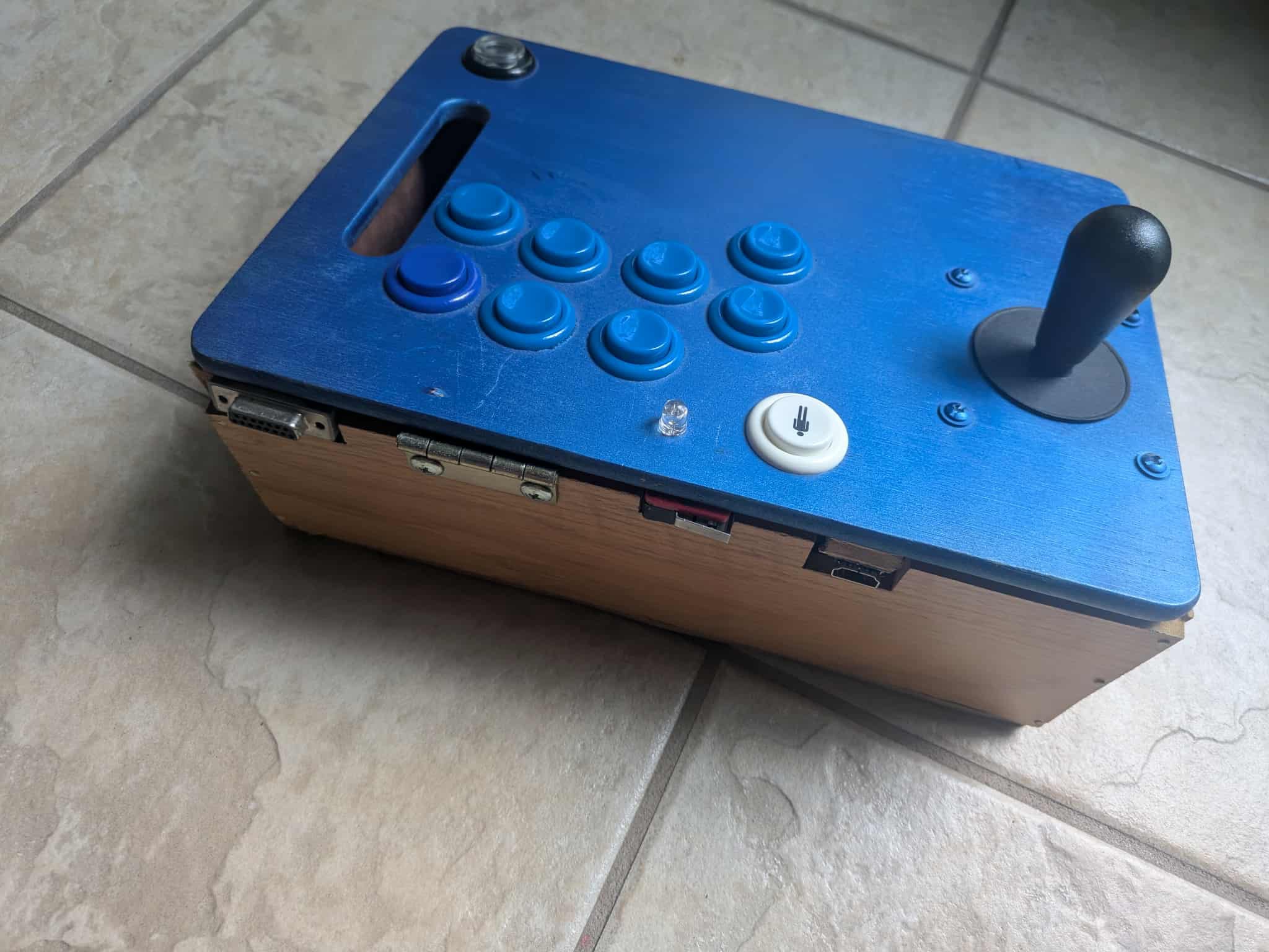

Here is the back of the arcade

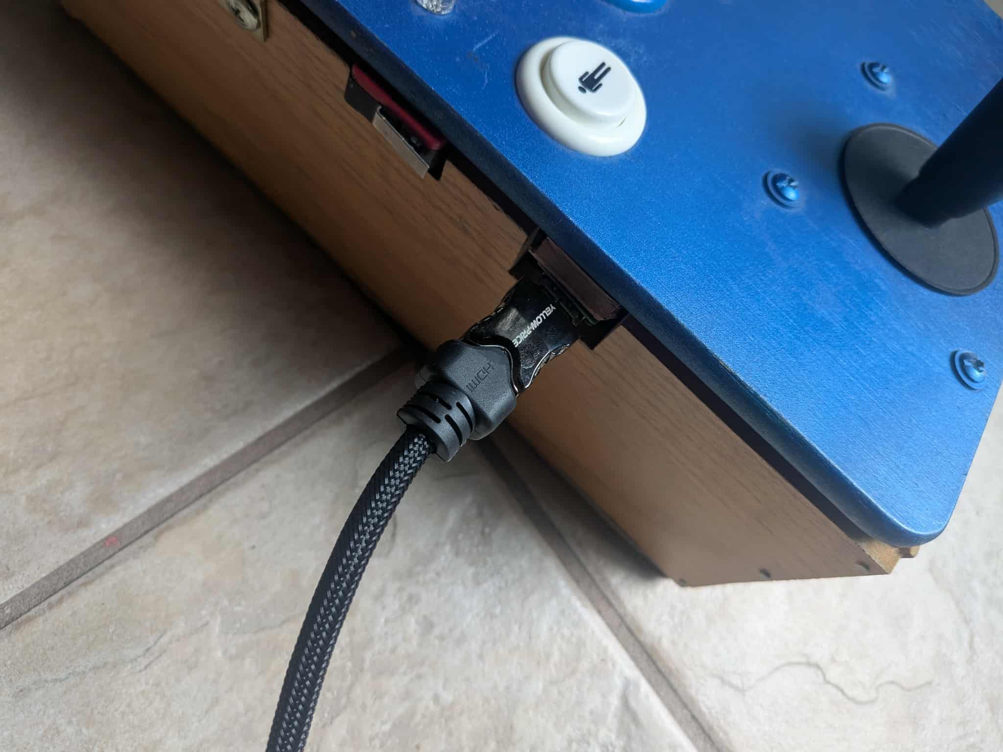

Once I wired that all up I could connect my HDMI cable from the Arcade to my Gamer-Pro. The Gamer-Pro detection controllers so to tell it this is an Arcade I hold down player 1. and hit my reset button that I put on the box. The reset button was PIN9 of the HDMI. you just short it to ground.
After this was all complete my arcade stick worked on all of my consoles.
