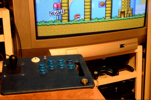

And they're CHEAP. My biggest problem now is that there are SO many ways to skin the cat here, designing a controller around a phone is going to take some time. I think the USB OTG offers the best option, sort of like a "spread" controller that clamps the phone and plugs in the end. I have used a USB hub to connect both mouse & keyboard and sent them to the VM. Also a gravis gamepad. I was thinking something along the lines of this failed kickstarter:
