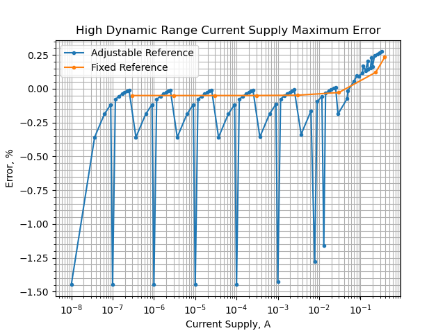

    An important factor to the usefulness of this device is the worst-case accuracy of the current supply. I performed an analysis, which is included in the Github repo and described here. To understand the calculations, let's first discuss the key components and accuracy metrics. Note: all calibration is assumed to occur in climate controlled locations, so variability over temperature is ignored here.
    ComponentAccuracy MetricNotes
    REF30300.2%Fixed reference voltage
    DAC80501TUE 0.06% FSRAdjustable reference voltage
    AD860350uV max offset voltage
    AD82760.05% gain error; 500uV max system offset voltage
    Shunt ResistorsAll 0.1% accuracy
    AO3400A26.5-48mOhm range Ron --> assume 22mOhm variabilityExtra resistance in PCB is not known, but designed to be minimal
    Analysis was done in Python here to compute the maximum percent error for each current level in the fixed reference voltage mode and for a variety of current settings for the adjustable reference voltage mode. The chart below shows the results.
    There are three interesting results here:
    1. The accuracy is quite good, typically +/- 0.25% accuracy over a lot of the operational range.
    2. The accuracy is worse at higher currents - this is due primarily to uncertainty of the on resistance of the shunt FET. At lower currents, that variability is small relative to the shunt resistance (e.g. 22mOhm vs 10MOhm), but it becomes relatively meaningful at lower shunt resistance (e.g. 22mOhm vs 7.66mOhm).
    3. The accuracy diverges to be worse than -1% at several levels. These correspond to the adjustable reference mode at small DAC output voltage. The total unadjusted error (TUE) for the DAC is 0.06% FSR worst case, which is 1.5mV. In this analysis, the lowest output DAC voltage shown is 100mV, so 1.5mV becomes a substantial error and dominates the error. Note that this is the worst case, and typical TUE is 0.025% FSR, which brings the typical error down within +/-0.6%
    Overall, this analysis shows that for fixed current mode, the worst case expected accuracy based on datasheets is +/-0.3%, while the worst case expected accuracy for the adjustable reference voltage mode ranges based on the reference output voltage. If 100mV is the minimum output voltage used, the accuracy is +/-1.5%. If 500mV is the minimum output voltage used, the accuracy is +/-0.3%.

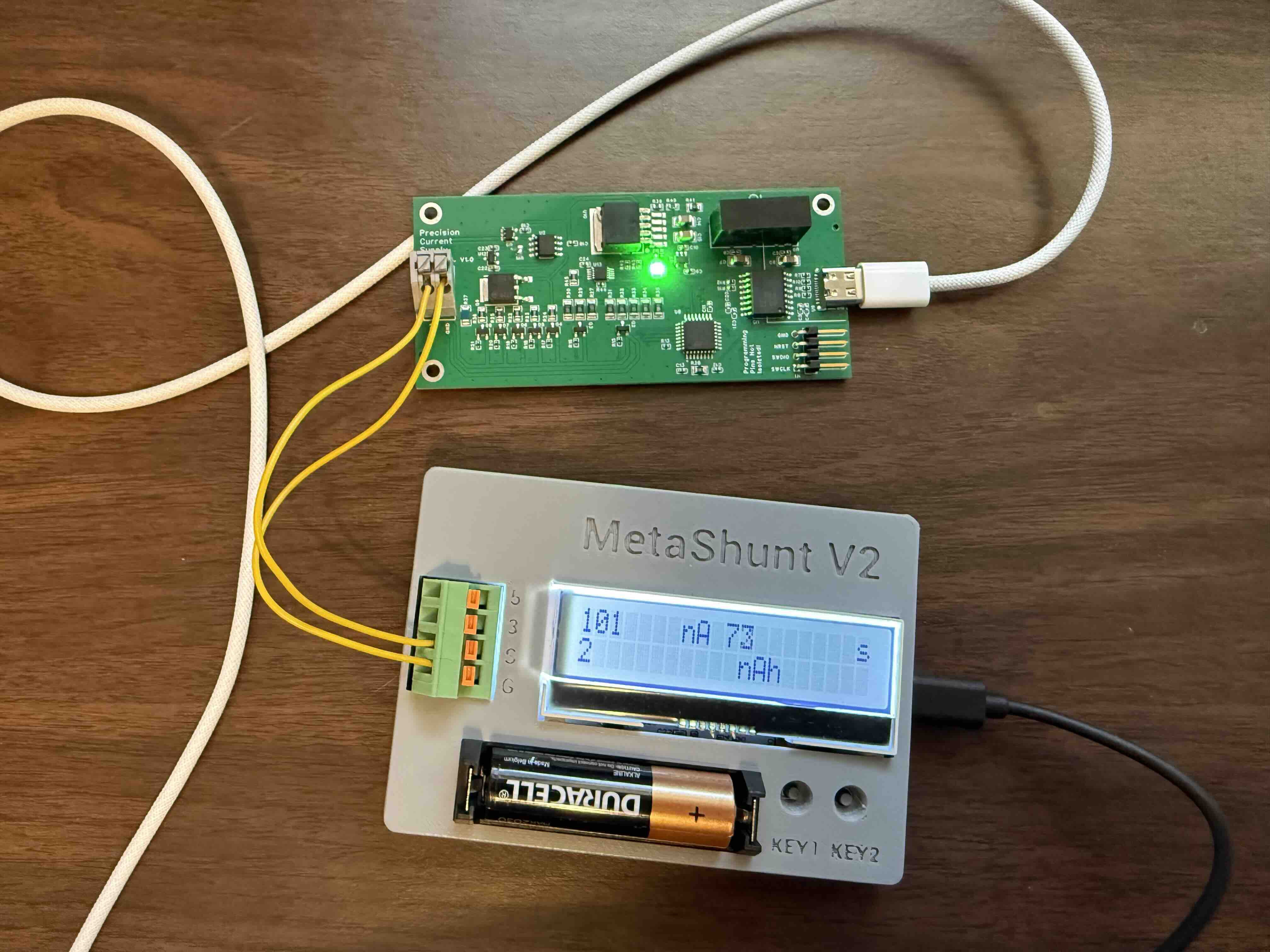

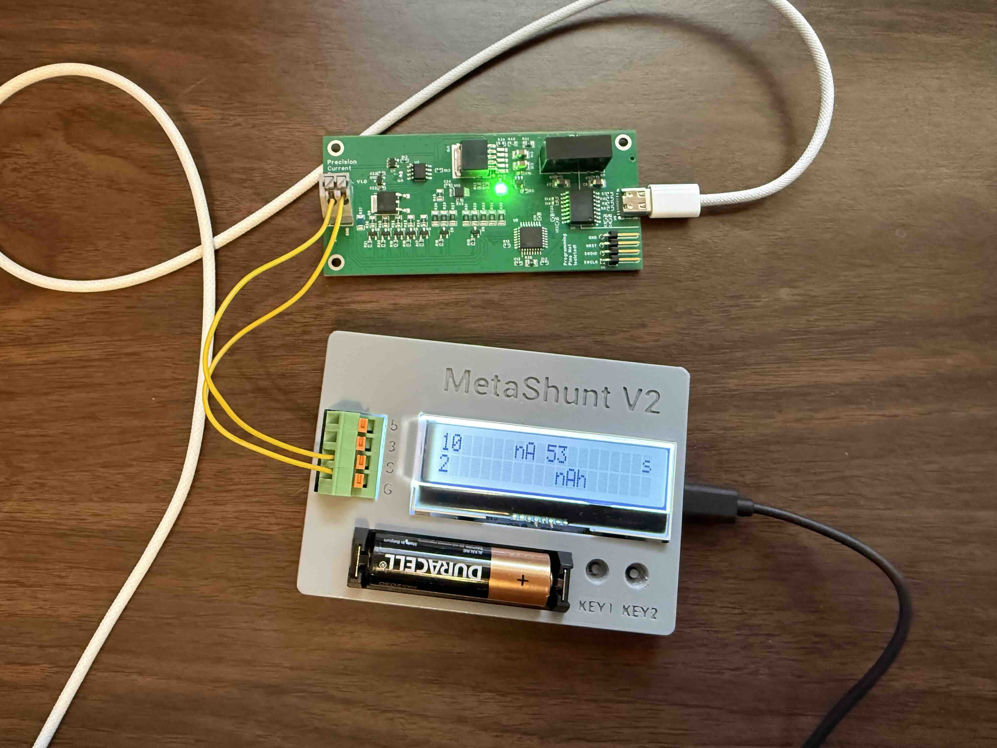

    The second mode of operation for this device uses a precision 16-bit DAC to set the reference voltage, and the MOSFETs to set the shunt resistance. This enables a highly adjustable current supply across a huge dynamic range. Firmware and interface software was developed (and is on the open source Github repo) to allow for a command of any current. The system will chose settings that are as close as possible to that command. To demonstrate this, a few tests were performed at current levels that are not possible with the constant reference voltage mode. Results are below:
    Commanded CurrentMeasured Current with MetaShunt V2Percent Error
    10nA10nA0%
    100nA101nA1%
    1.56mA1.556mA0.3%

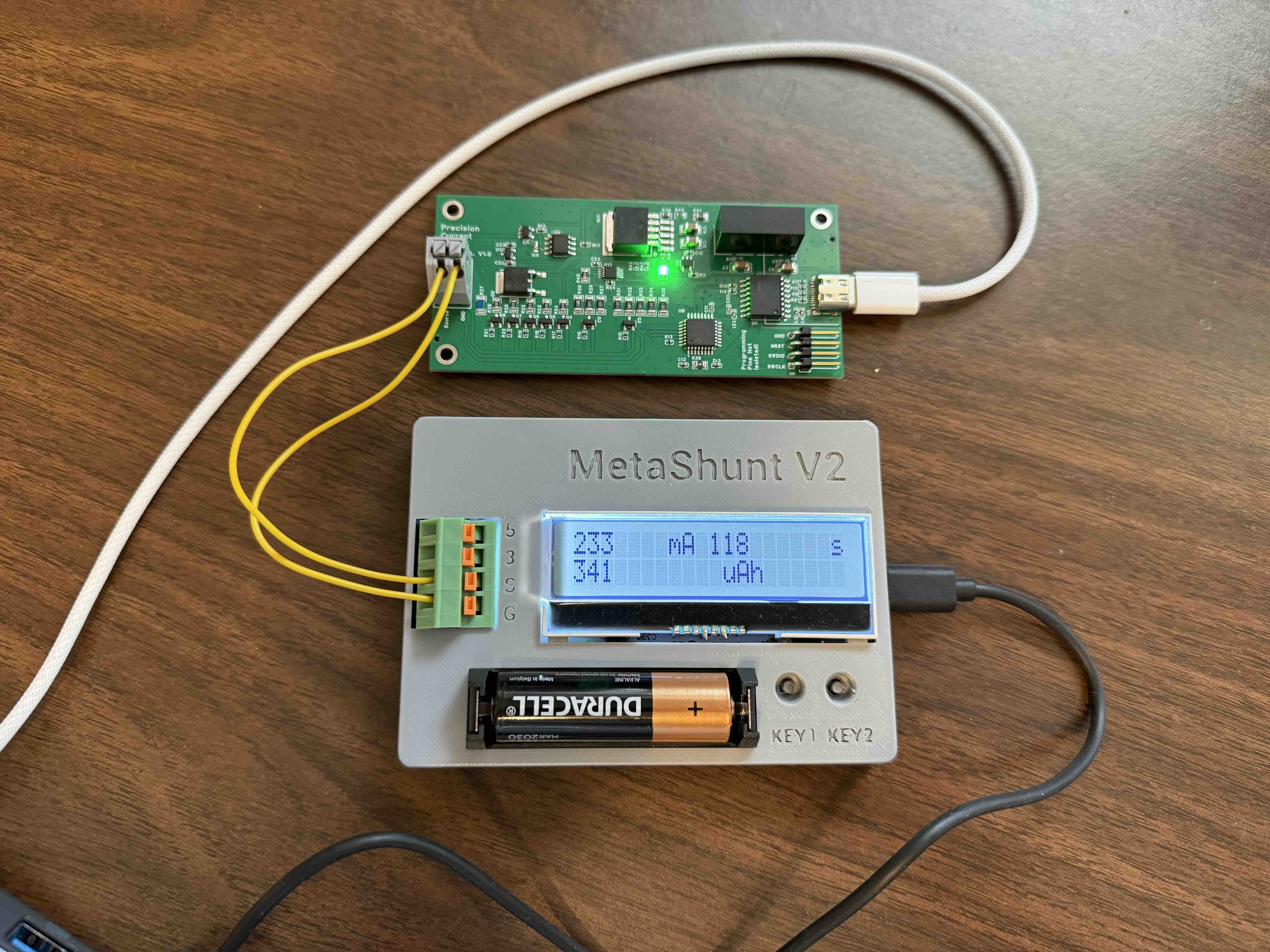

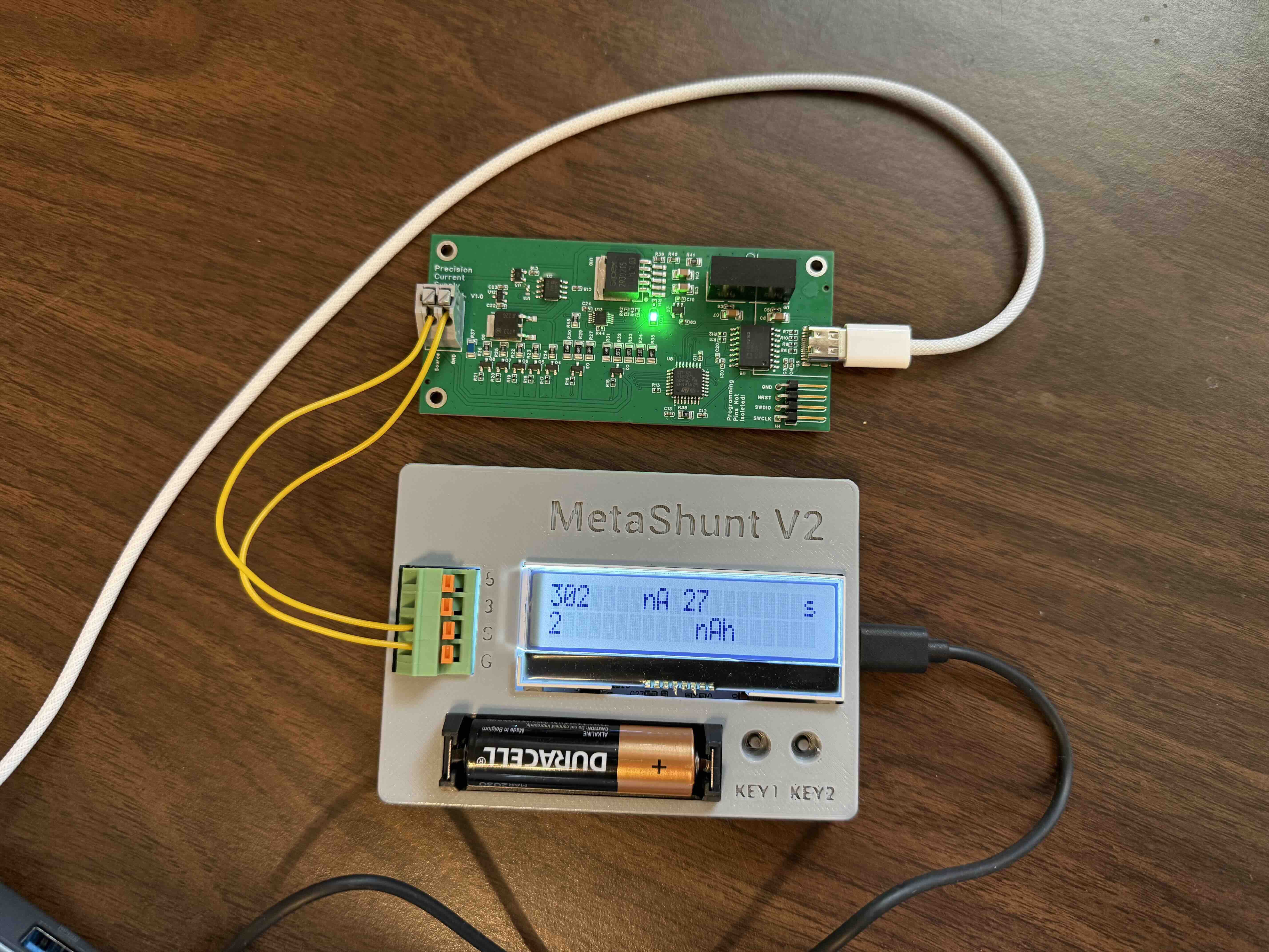

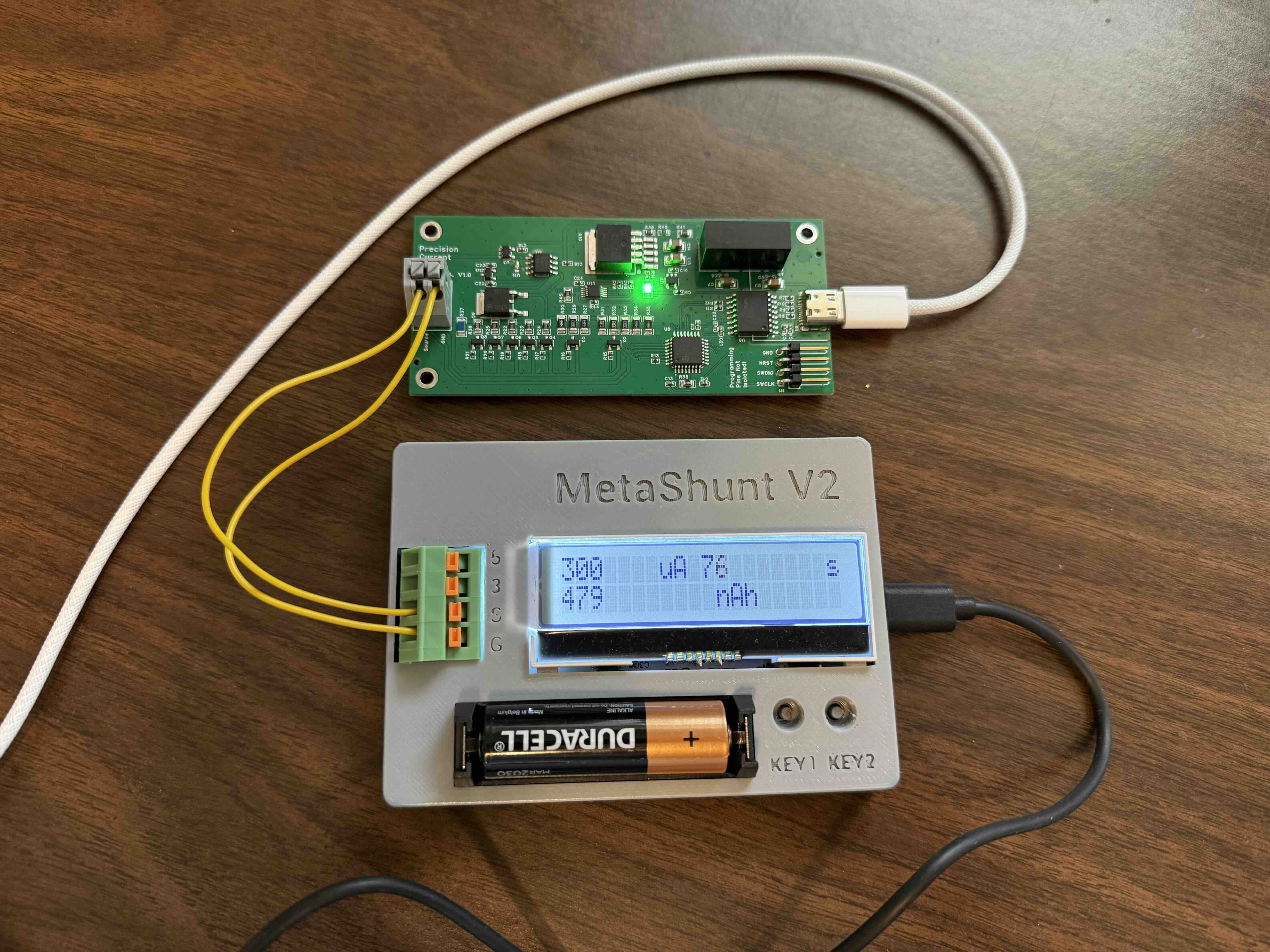

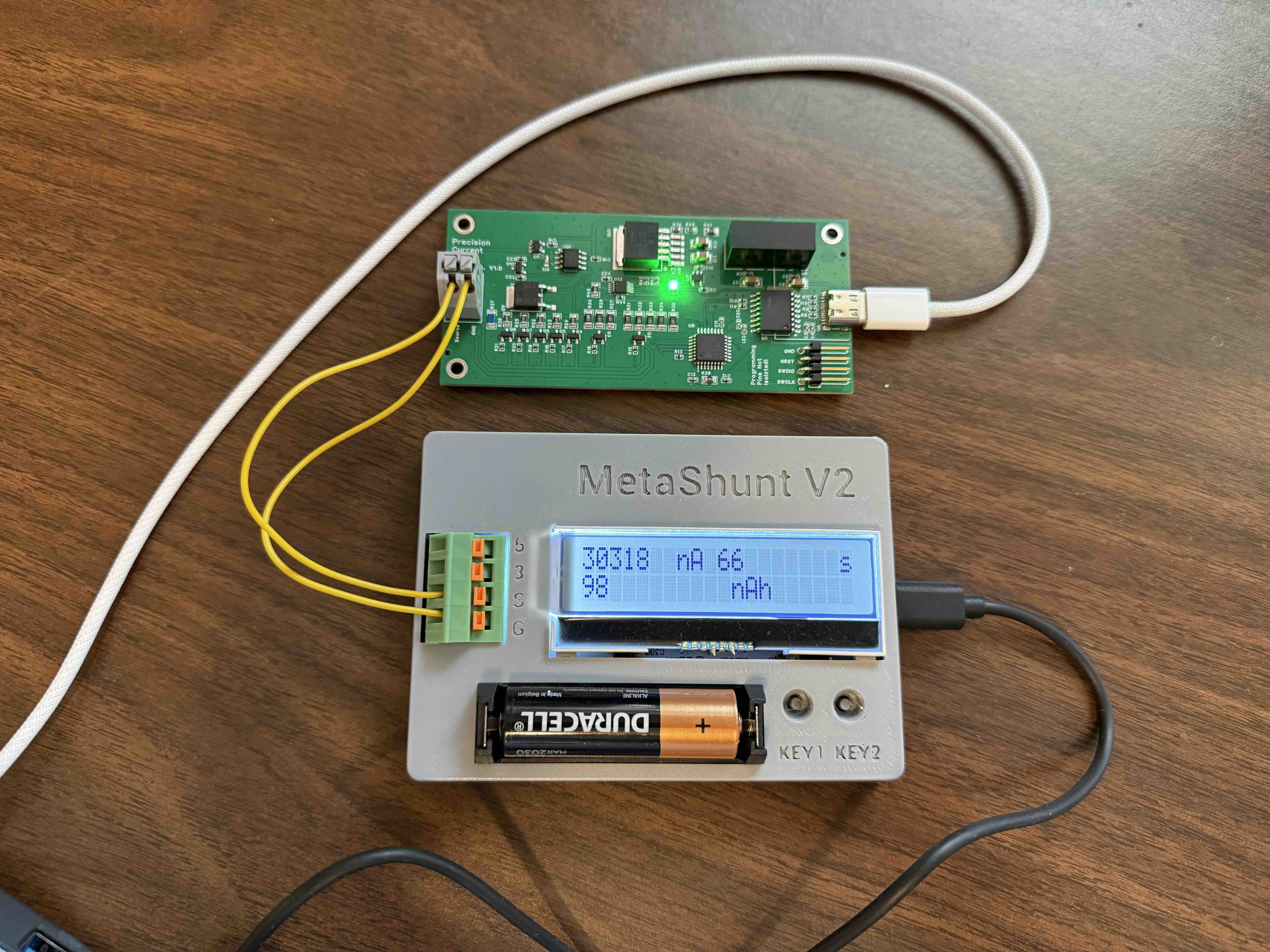

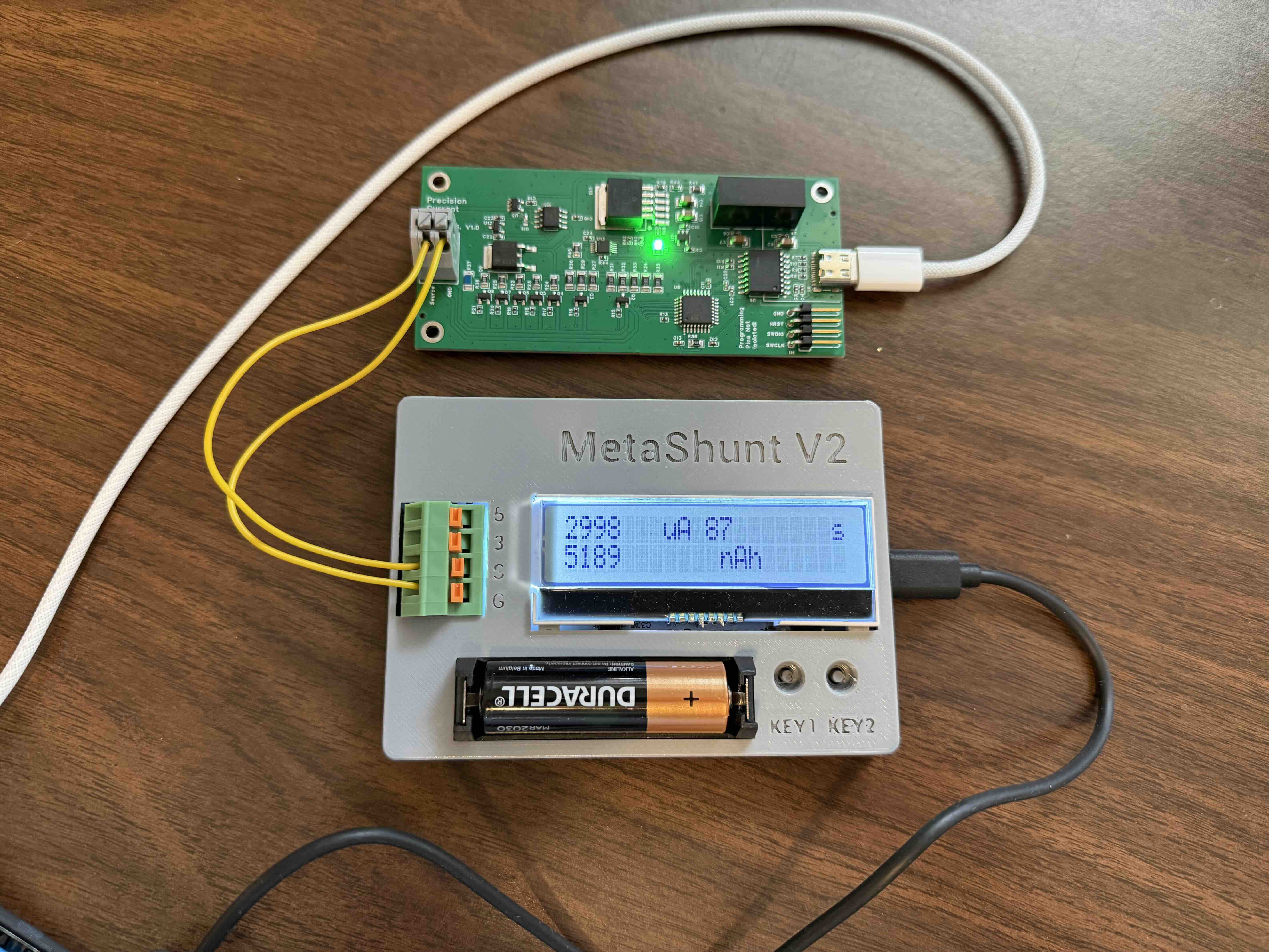

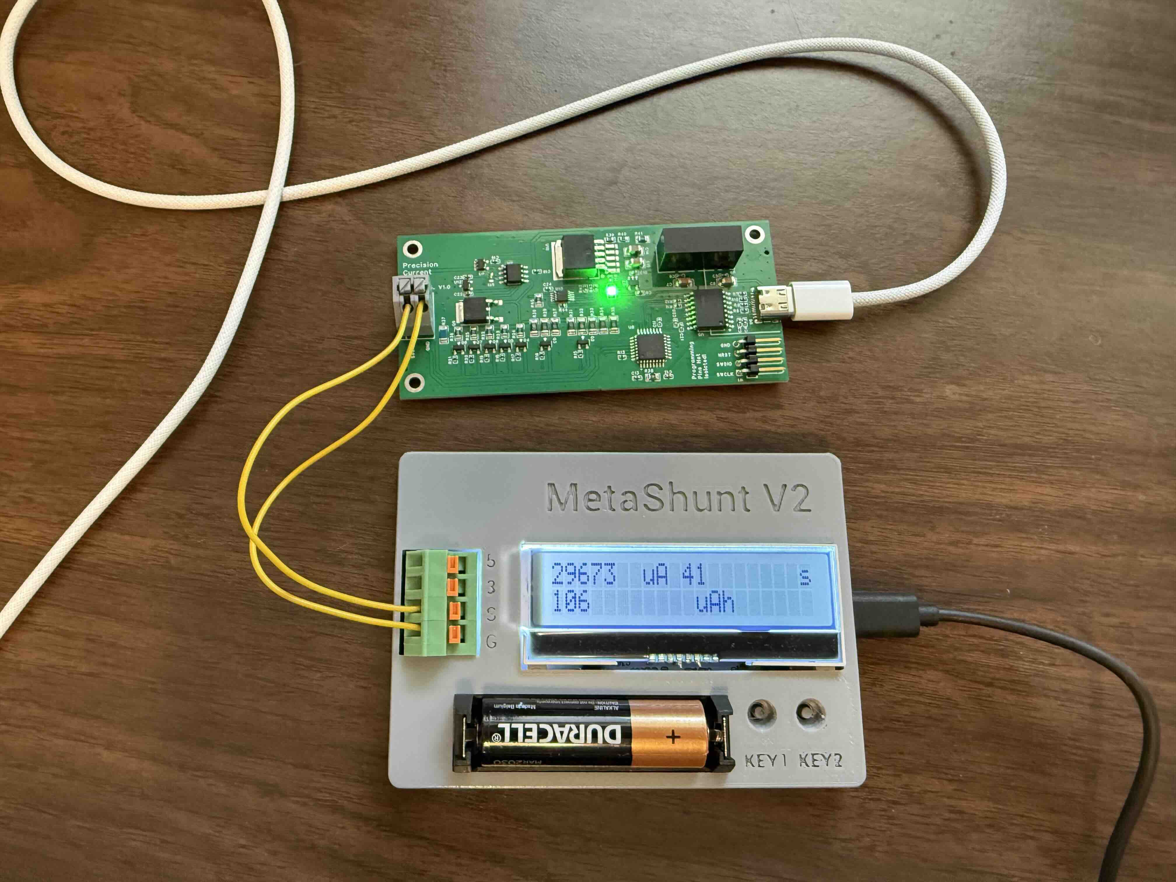

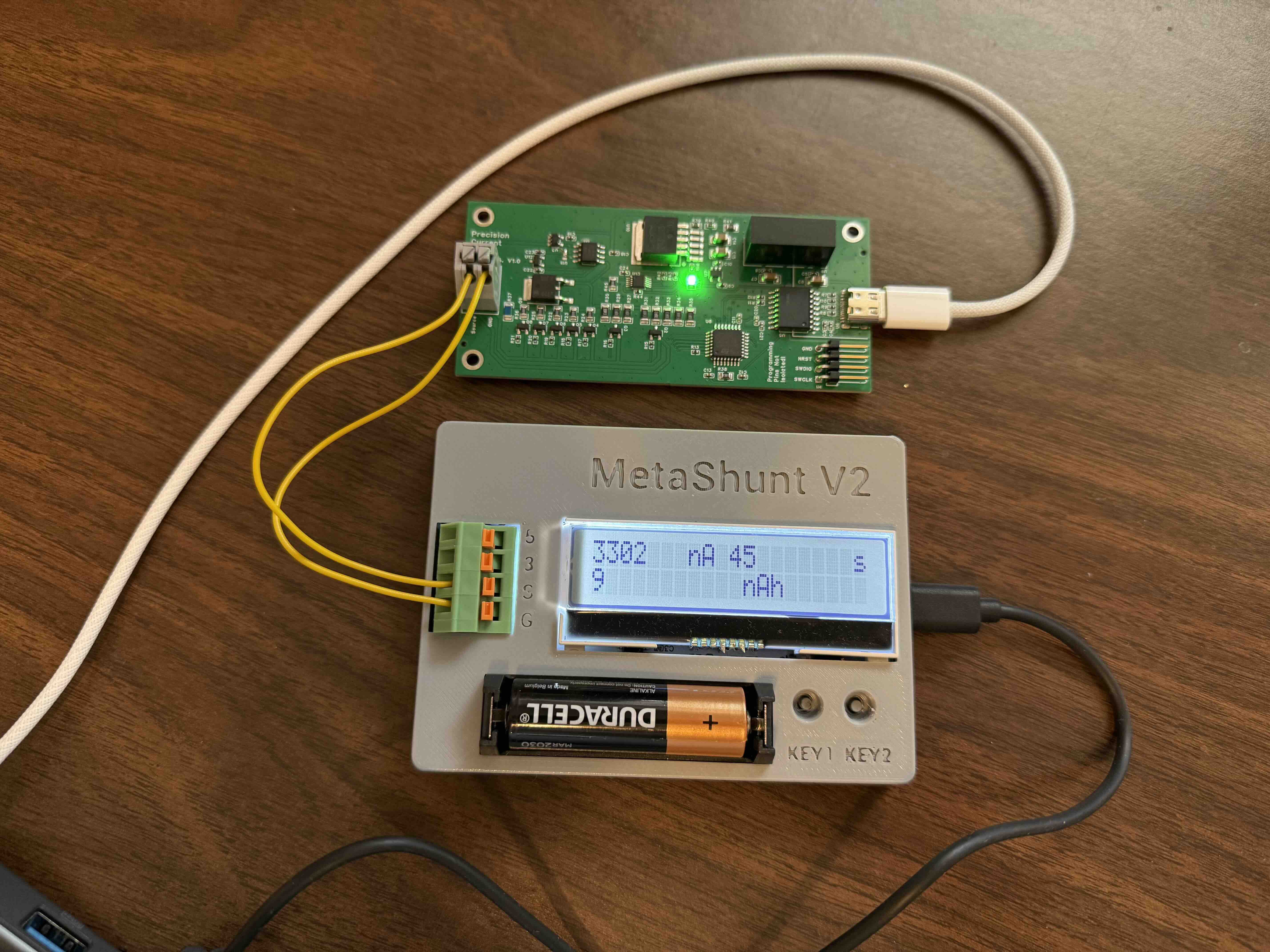

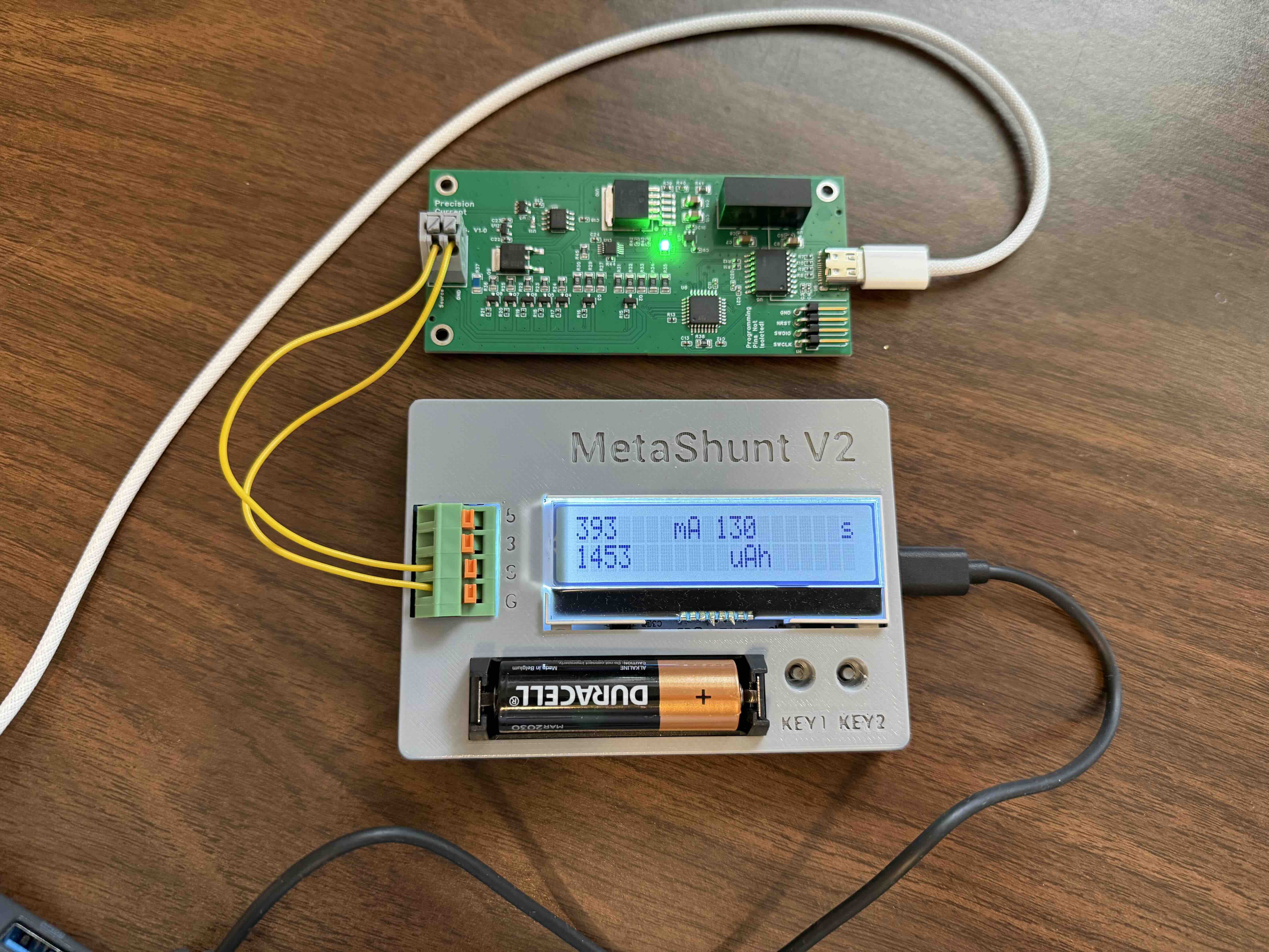

    To evaluate the performance of this device, I started with connecting it up to a MetaShunt V2, without prior calibration of anything except the highest 2 current shunts of MetaShunt V2.
    The table below compares the expected current (from the design), compared to measurements from MetaShunt V2. The images below also show these results. Overall, the expected and measured current matches very well, all within 1% or better. Future testing will show the reliability of the current supply as a reference truth.
    Expected CurrentMeasured with MetaShunt V2% Error
    300nA302nA-0.66%
    3.30uA3.30uA0%
    30.3uA30.3uA0%
    300uA300uA0%
    3.00mA3.00mA0%
    30.0mA29.7mA1.0%
    234mA233mA0.4%
    389mA393mA-1.0%
