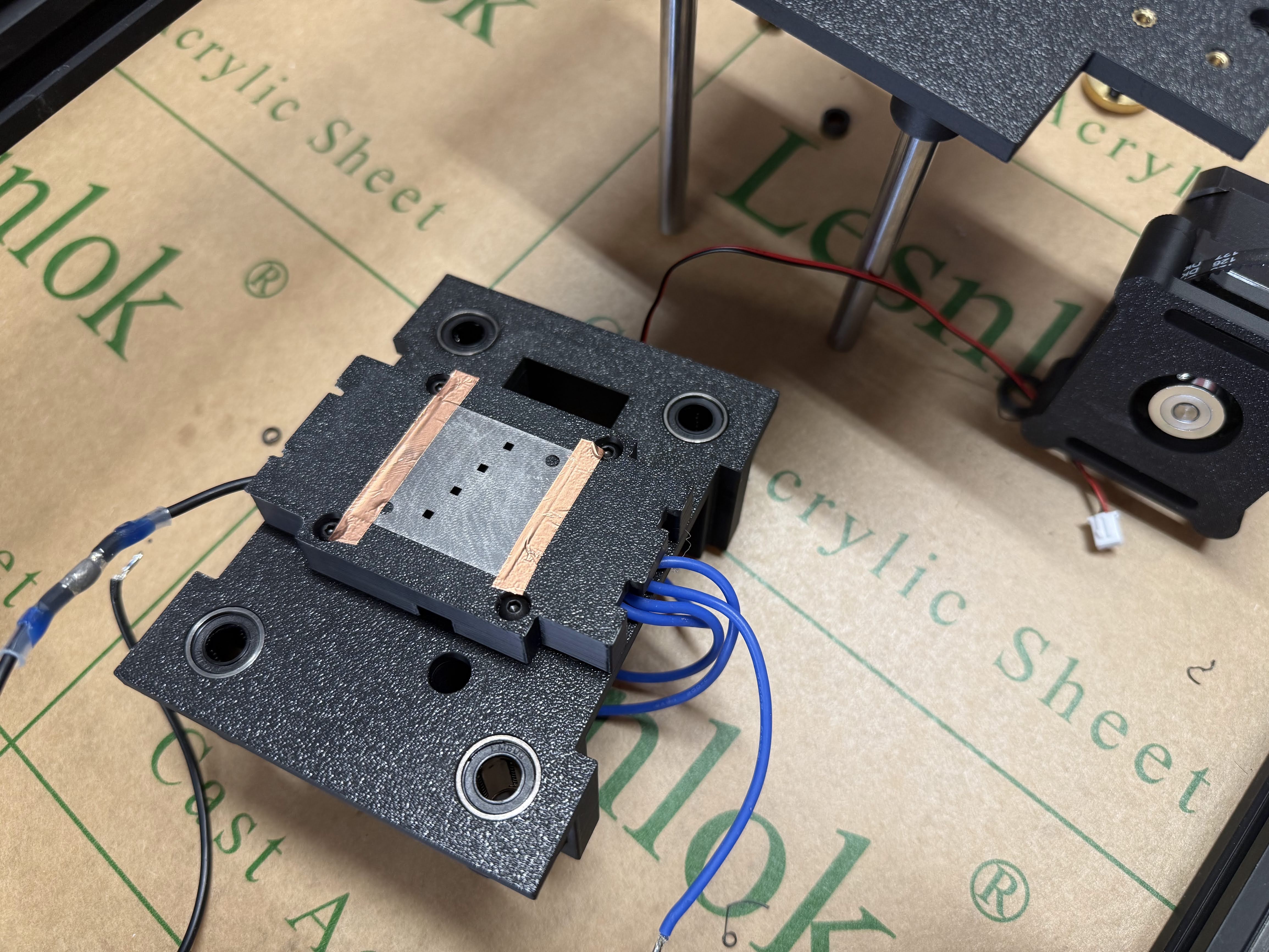

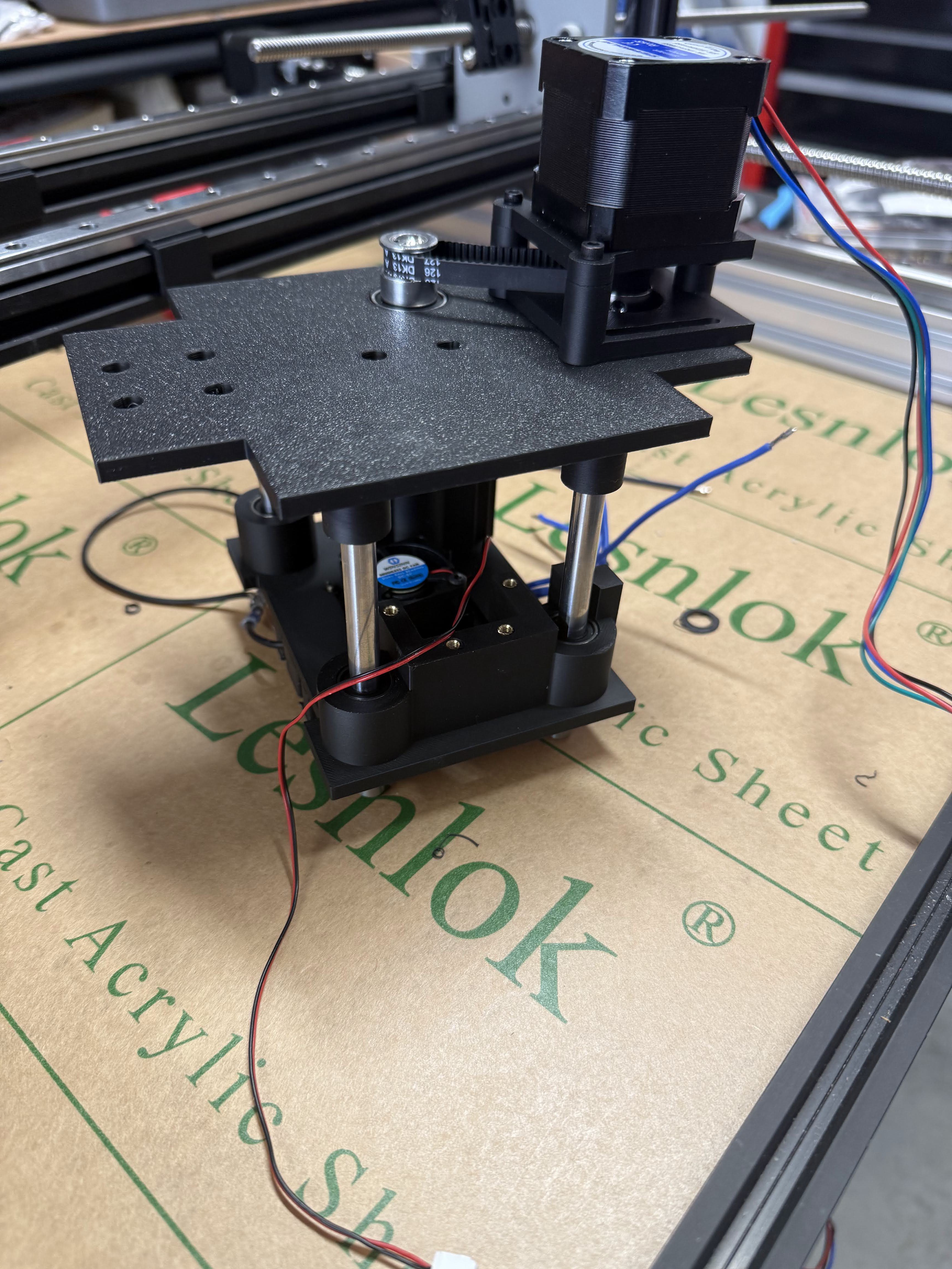

3 hours ago • 0 commentsI could have gone into OpenSauce with my old ... very hacky... printhead pictured in the main gallery. There were many issues with it that I've mentioned before. Well, I have my first completed 2.0 version ready for testing this weekend. You can see the "focus" mechanism, which is really just going to place the printhead consistently .5mm away from the paper. That and the new metal mask, should produce clean squares. Well... we'll find out tomorrow.

The new LEDs are soldered, lots of learnings, haven't made a mistake that forces me to redo any PCB I ordered. (maybe the LED board but Knock on wood). But updates to boards in next Rev.Mega:
I don't like the power connector. Either I have to buy new power clips or I need to specify the right ones on the PCB, but I can't have jumper wires onto bare SIP headers anymore if this will be reliable for showing. Probably the former.
Nano Board:- Everything works so far! Snag, I thought I'd be smart and use my own design for the limit switches to prevent the motors from moving too far, and thus only need 2 pins. But then I thought about it, its just more work and a lot of effort to find out eventually why all those extra components are on those boards (debouncing). I also am using these micro molex format plugs, but the board is big enough with the Nano on it that I could just use standard clips. And I have a bag of them. But until then, I ordered the 2 pin micro and they're coming this week, and I just need to run a separate VCC line to the switches.
- The CR Bed Leveler needs a timing signal, but when I made the PCB I just put it as another of my limit switches. So it prefers 5 pins and I gave it 2. Sigh, this will be a messy hack, maybe a bodge wire on the back of the PCB. I got tunnel vision doing all of the limit switches in Fusion and I should have stopped and thought.
LED PCB
Big learnings here
- No through holes on an aluminum PCB! Why did I do that, looking back at the emails from JLPCB they clearly were very politely saying I had no idea what I was doing. The entire PCB is conductive, so through holes will short! Anyhow, this might need a reorder for reliability, but I want to work with them a bit more to see if I need to change anything else.

Z AccuracyOne of the hackiest things I've done is I control my Z axis with two 3D printed parts. A male part attached to the LED, and a female end on the gantry the distance fixed with some M3 screws. The process has been, loosen the screws, put something thickish beneath the print head, then tighten the screws. This needs to change. I've decided to go with using a Creality bed leveling sensor to map the print area, then have a Z axis motor move the print head so its "perfectly" accurate. This will be incorporated into my next print head, I'll share results.
