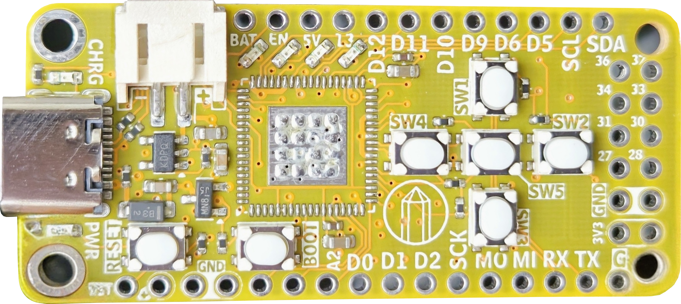

Starting generally, the PCBs look awesome. These are the first yellow PCBs that I have ever ordered and PCBWay did not disappoint with the color. I choose to go with a yellow soldermask because of the Lattice CrossLink-NX chip that I am using. Go team yellow!
I received the boards almost entirely populated. I chose to omit the FPGA from the assembly BoM. This was just for cost and logistic reasons related to the sponsorship.
Unpopulated Crystal Board
Before shipping and fees, the cost of 5 assembled boards + components (minus FPGA) was $99.55. According to the invoice, the unit price was $19.67 per board in quantity x5. However, keep in mind that the LIFCL-17-8SG72C is currently priced on Digikey at $19.75, with that dropping to around $15 at a qty. of 100.
So the BoM cost comes in around $40 dollars in single quantities. This mostly aligns with our $50 dollar price point, and I think there is some further room for cost optimization.
With the boring stuff out of the way here are some nice pretty pictures from my microscope, starting off with just a shot of the FPGA. I used hotair to stick on the QFN-72 package, and then ran the tip of my iron around the edge of the board to make sure that my joints looked alright. I didn't do a very good job cleaning the gunk off afterwards. You'll also noticed the little bit of melty-melt on the JST connector and SW4 -that's my bad. It's been a while since I have soldered something in such close quarters. Embarrassing!
Money Shot of the FPGA

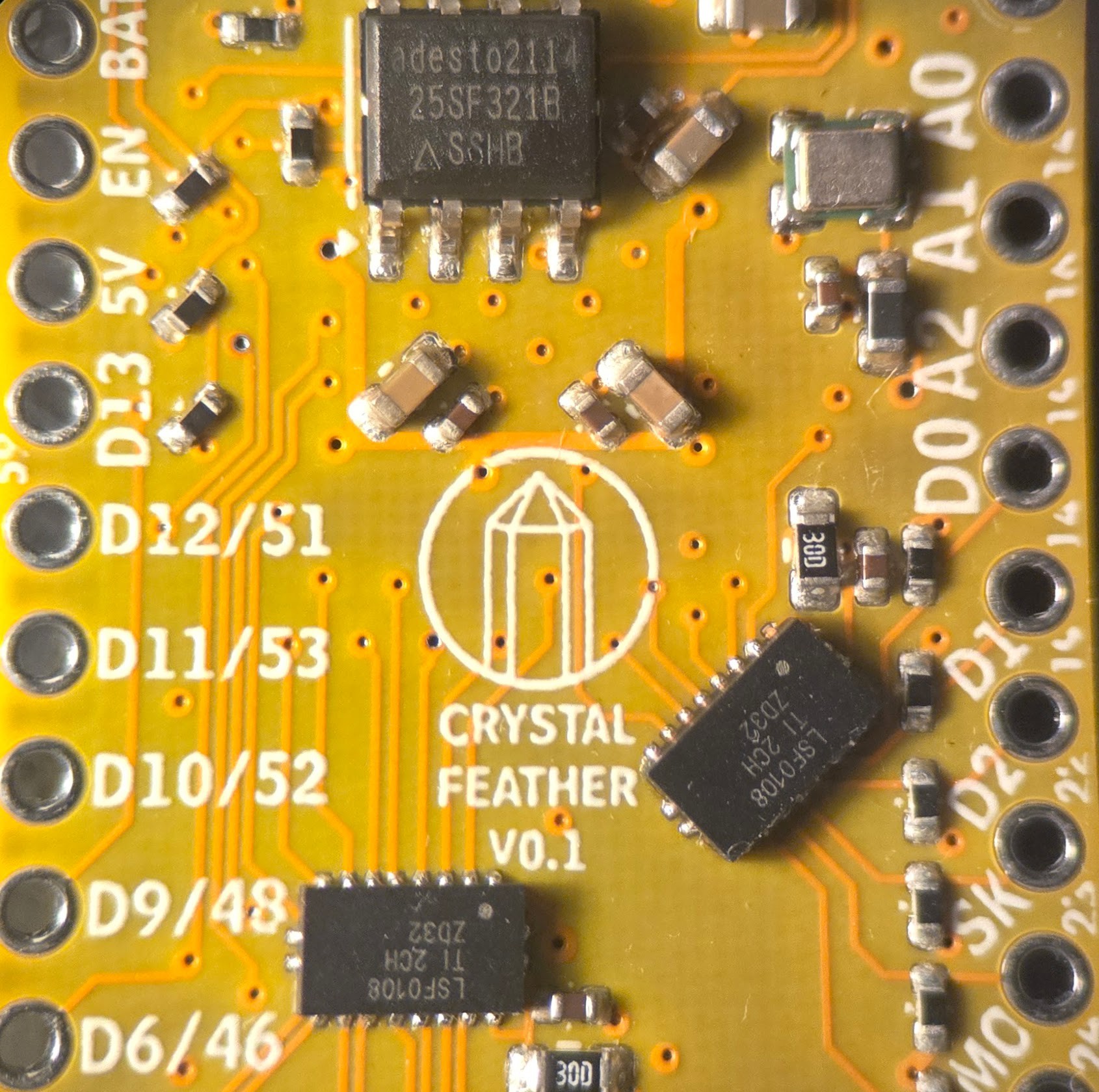

Next up I took a look at the silkscreen. In my effort for self documenting PCBs, I tend to push the limits in this area. However, this time around it looks pretty good! I believe that the go-to option for printing text on PCBs is now some sort of inkjet process (as opposed to true silkscreen).
This is a topic that I have explored in the past, but frankly the resolution here is acceptable, and everything seems pretty consistent.

First things first is the IO of the Crystal board. At least in my experience, the IO count of an FPGA is a really big deal. For the industries that use them, this makes sense. FPGAs are often used to do real time, true parallel processing by ingesting and fusing input from potentially dozens of sensors while controlling equally as many dozens of output pins. At my day job, we are looking to control about 150 IO in some of our most maximal applications. For context the Arduino Mega lists 54 digital IO. Say what you will, but the best way to get the most IO into an IC is to use a Ball Grid Array package. So considering that FPGAs are often demanded for high pin count applications its no wonder that the vast majority of FPGAs come in ball grid array package.
This is starting to get long winded again. Long story short, I wanted an FPGA that was hand-solderable. There are some very nice Gowin FPGAs that are in QFN packages, amongst a few others. I ended up picking the Lattice Crosslink-NX in the QFN package because of its Radiant support. I also think its fun that there is only one ground pin on this bad boy - the center pad.
This was almost a perfect choice for my purposes. The only major bummer is that only about half of the 40 IO on this bad boy is 3.3V compatible, while the read is "high performance" and only supports 1.8V. Most hobbyist electronics still use 3.3V logic and it doesn't seem like that trend is going anywhere soon. Not to say that it couldn't happen (see the switch from 5V logic to 3.3V over the past few years), but regardless, the Adafruit Feather specification requires 3.3V tolerant IO. Plus this is supposed to be user friendly.
Further, I wanted to have buttons, LEDs, and a PMOD connector. This means that I would far exceed the amount of 3.3V logic pins and would need to some level shifting of the 1.8V pins. Even then, I needed to do a lot of doubling up on functions. In retrospect, this isn't that big of a deal. Different MCU boards to that sort of thing all the time, I'm just used to being spoiled by the copious amounts of IO that an FPGA typically provides.
You can see the two level shifters on the right side of the board connecting to pin 4-9, as well as handling the PMOD connector. I am a really big fan of this level shifter. It's bidirectional, high speed, works for up and down translation, and is 8 bits wide. Internally it's basically just a bank of logical level FETs packaged together but that's fine.
This honestly seemed to be a pretty good solution to my lack of 3.3V tolerant IO. I really would like to be able to drive a display using TMDS and an HDMI PMOD, so I am a little concerned that these devices will limit my clock speed too much. Using them in my current configuration, speeds of up to 100MHz signaling are supported but that depends on a lot of factors.
