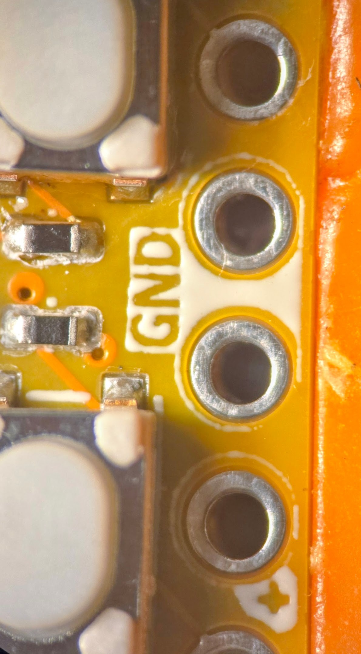

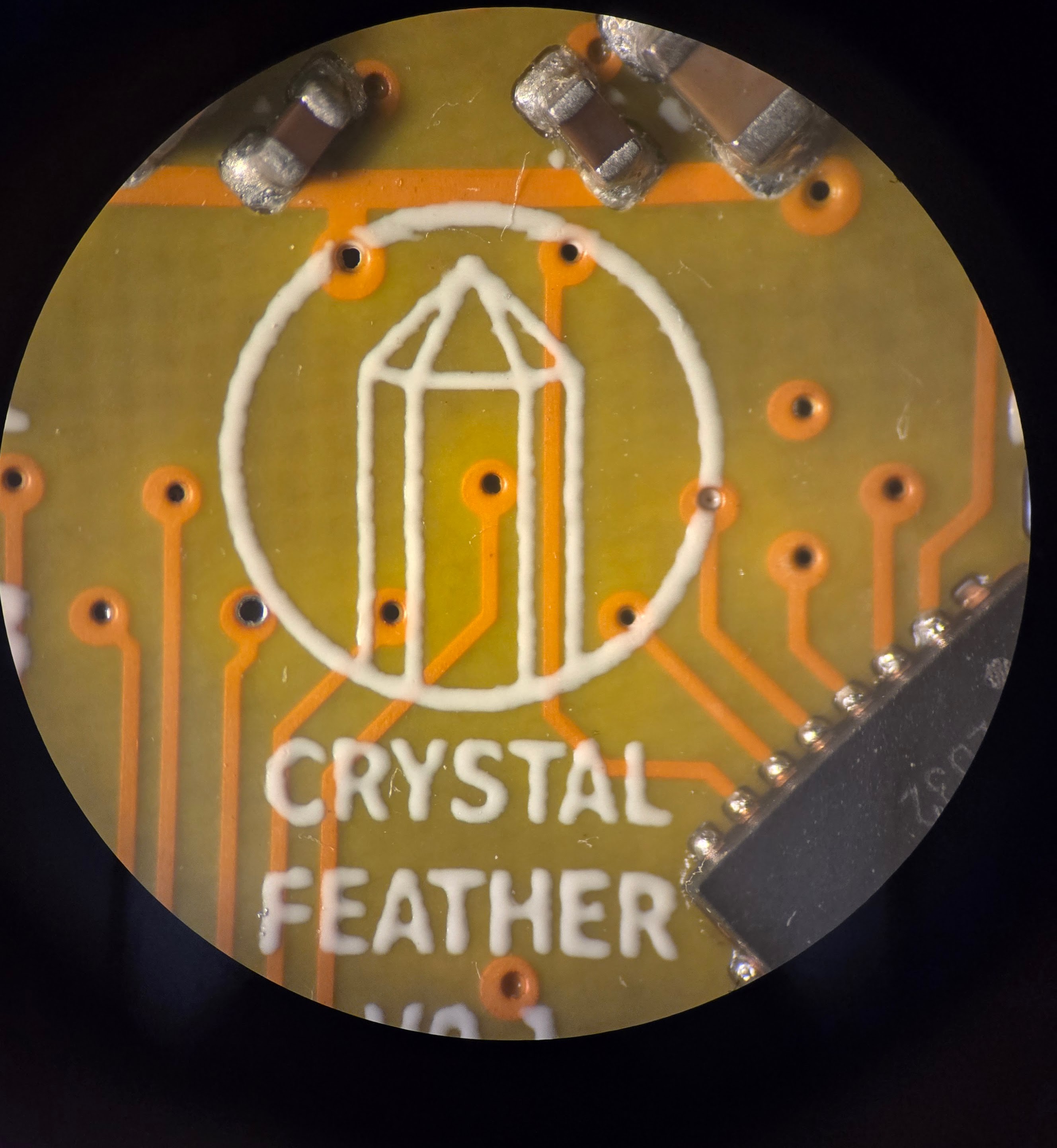

Money Shot of the FPGA Next up I took a look at the silkscreen. In my effort for self documenting PCBs, I tend to push the limits in this area. However, this time around it looks pretty good! I believe that the go-to option for printing text on PCBs is now some sort of inkjet process (as opposed to true silkscreen).
This is a topic that I have explored in the past, but frankly the resolution here is acceptable, and everything seems pretty consistent.
![Large Silkscreen Large Silkscreen]()
Large silkscreen features look good ![silkscreen logo closeup silkscreen logo closeup]()

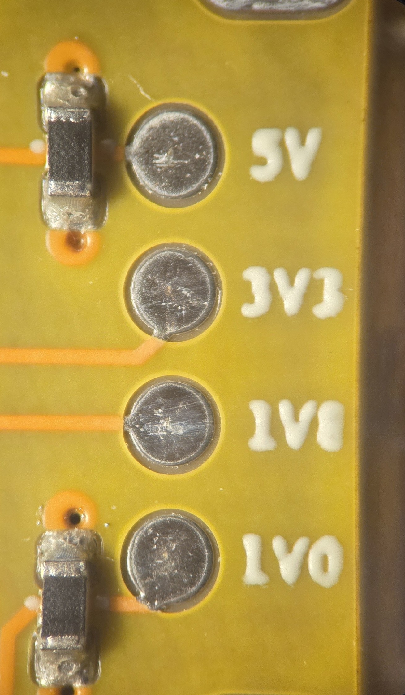

What a cool logo! The smallest text I have on this board is for the voltage regulator test points located under the USB-C connector. These measure a mere 0.5x0.5mm according to KiCAD. The physical results are hardly impressive, but the text is identifiable! There was also a little bit of an issue with particularly fine lines around through, holes but again, this is me mostly just pushing the process a bit too far.
![Test Point Text Test Point Text]()
Itty Bitty Testpoint Label ![More silkscreen More silkscreen]()
Fine lines are hard!

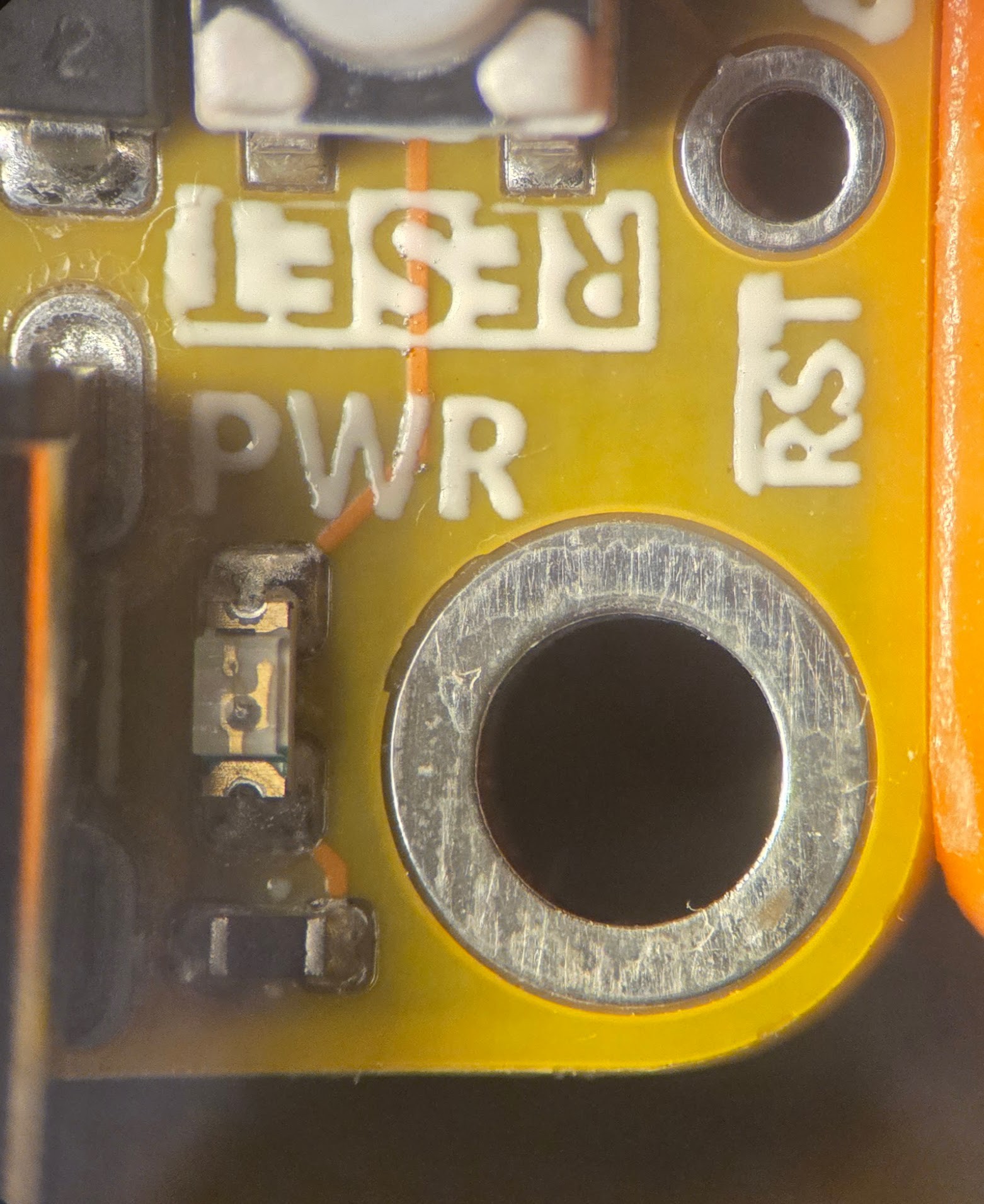

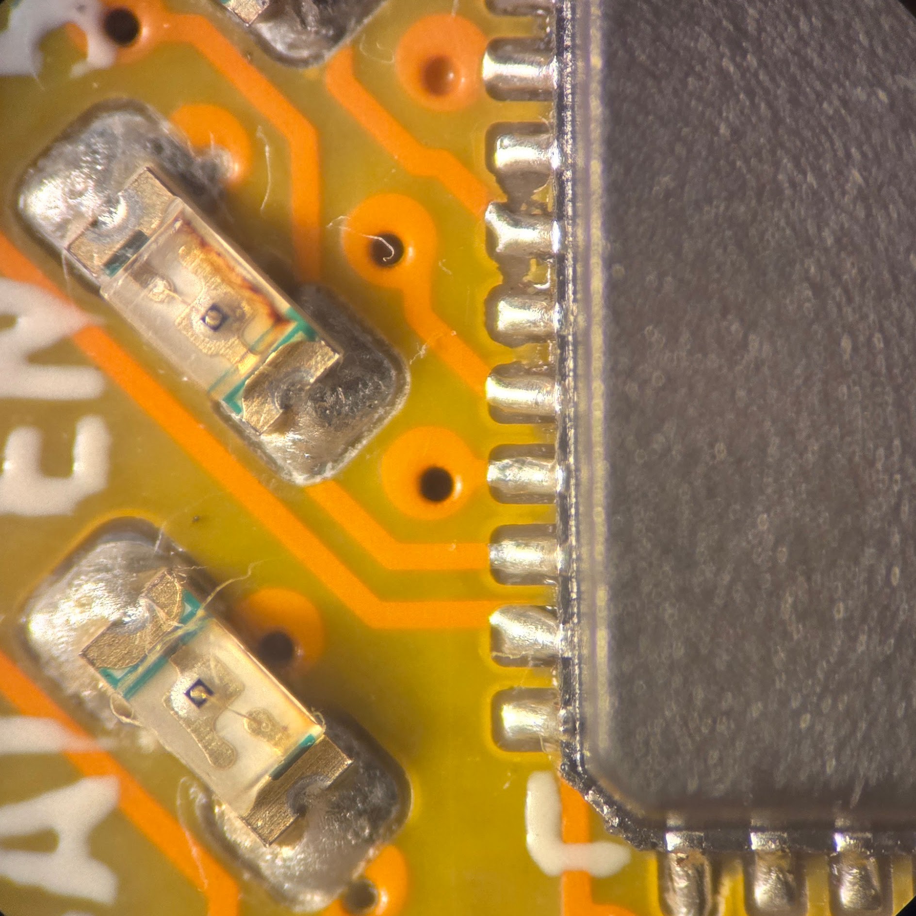

Moving away from cosmetics, I also took a look at solder joint quality and via registration. Both of which seemed to be acceptable considering the cost of these boards.There were a few examples of solder joints that didn't appear to be fully wetted, or maybe a little too much solder paste.
When it comes to the LEDs, I think that may just be how they are intended to be reflowed (as opposed to having the solder flow up and on top of the contacts).![LEDs Chillin LEDs Chillin]()
LEDs Chillin ![Another Part of the Board Another Part of the Board]()

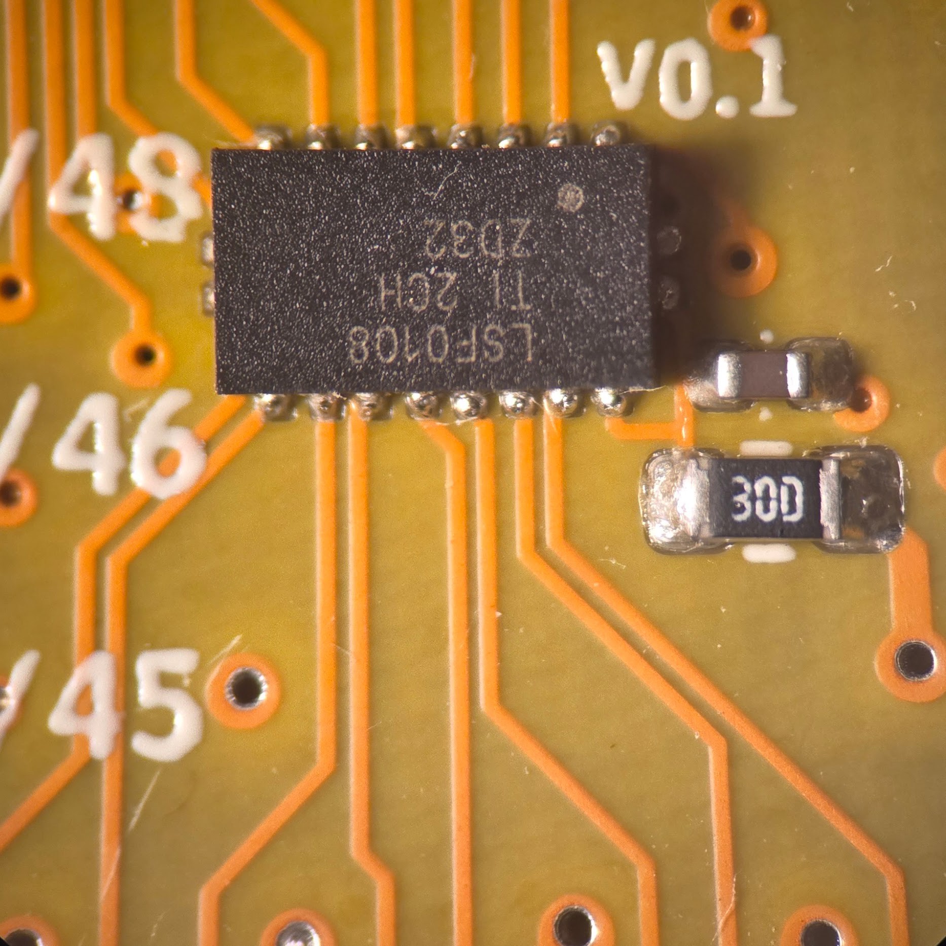

Another Part of the Board ![Via shot and too much solder Via shot and too much solder]()
Via shot and too much solder On the LSF0108 chip above, you can see the pretty clear beading of the solder on the joints. If I were to guess, this is mostly my fault, and I probably didn't pay attention to what the solder past distribution was supposed to look like when I was making the footprint in KiCAD. None of the pins are shorting, which is the important part.
You can also see from the images above the the vias are mostly in the center of their pads. Mostly. Importantly, none of the vias broke out of their annular rings, at least that I can tell.
