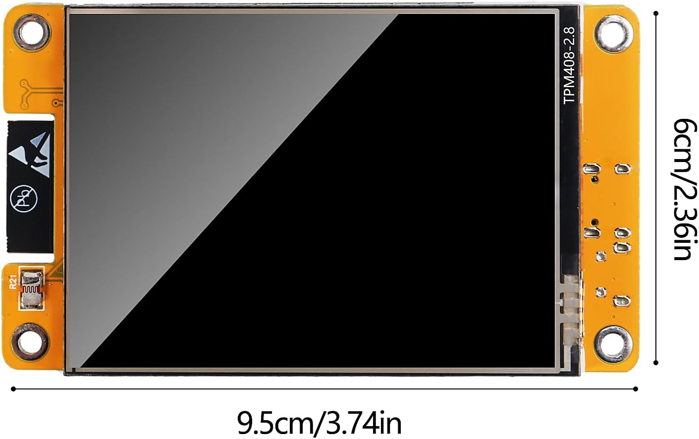

The Clock uses inexpensive components including the ESP32 based CYD (Cheap Yellow Display) with features a 320x240 backlit LCD display with a resistive touch screen.

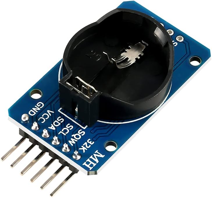

Step 1: If the RTC does not already have a pin headers (there are two) attached, do so now.

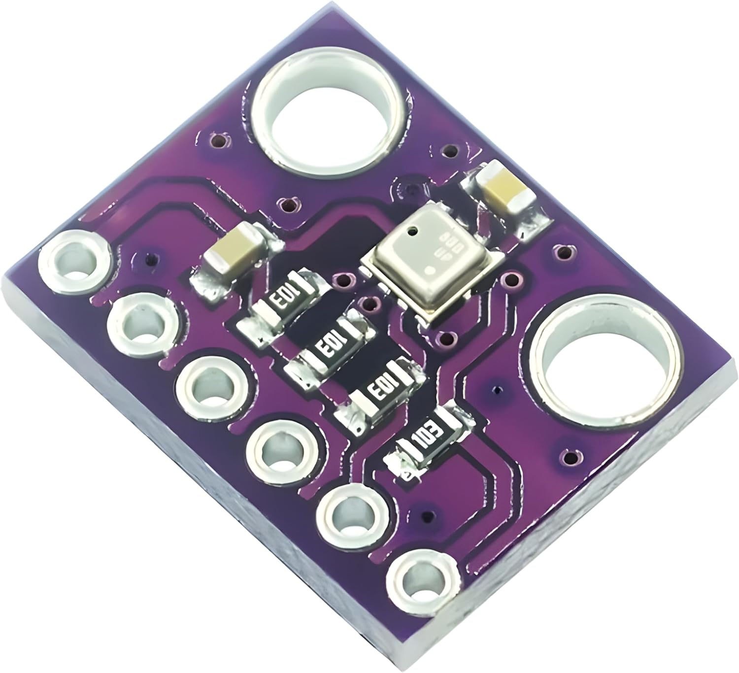

Step 2: If the BME260 does not already have a pin header attached, do so now.
Step 3: The CYD has I/O ports include “Extended IO port”. The CYD should have come with a four-pin connector for this port. Use this connector to connect to the RTC and using the second header on the RTC connect to the BME260. Reference the Github Wiki to see connections.

- CYD (Cheap Yellow Display). This component includes a 320x240 color LCD display, and a resistive touch screen.

- An I2C DS3231 Realtime clock
