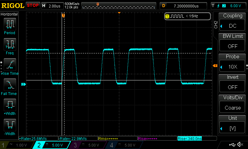

    The signaling that takes place on the CC lines of a USB-PD connection is very interesting. For starters, despite the fact that there are two CC lines, only one of them is used for USB Power Delivery communication at any given time. The other line may be used as VCONN to power electronically marked cables and certain types of accessories.
    Therefore, a traditional clock-and-data signaling scheme is not possible. Instead, the USB-PD specification uses a modulation scheme called biphase mark coding (BMC for short), which is a type of self-clocking code. In this scheme, every bit period contains a transition that helps maintain synchronization between the transmitter and receiver. A logical '1' is represented by an additional transition in the middle of the bit period, while a logical '0' is not. Because transitions themselves carry information, the receiver can recover both the data and the timing from a single wire.
    If you've never dealt with self-clocking protocols before, it can be a bit tricky to wrap your head around BMC at first, particularly because it's not trivial to decode without the help of dedicated hardware. However, once you understand the basics of how it works, it's not too hard to deal with, particularly because it operates at a relatively low data rate (up to 300 kbps, compared to the USB data lines, which can reach into the tens of Gbps).
    Proximity and crosstalk
    However, it's important to understand the environment in which the CC lines operate. In a practical implementation, power-delivery communication and USB data are happening both simultaneously and independently. This means that the controller shaping the USB data signal is not aware of when transmissions are taking place on the CC lines, and therefore cannot coordinate with them in any way.
    When you consider that the wires carrying the USB data and CC signals are in close proximity inside a cable, some degree of crosstalk between them is inevitable. While the BMC signaling rate itself is relatively low, excessively sharp transitions can generate high-frequency energy that couples into the adjacent data pairs, reducing signal integrity and noise margins. This is particularly important for USB 3.x and USB4, which operate at very high data rates and therefore require excellent signal quality to maintain reliable communication.
    It's the edges that matter
    At first glance, you might think that a 300 kbps signaling scheme would be too slow to cause any meaningful interference. However, the frequency content of a signal is determined not only by its data rate, but also by the speed of its transitions. A square wave with very sharp edges contains significant energy at frequencies far above its fundamental frequency, extending well into the hundreds of megahertz and beyond.
    As a result, even though USB-PD signaling operates at only a few hundred kilobits per second, poorly controlled edges can still generate enough high-frequency energy to interfere with nearby high-speed signals.
    To mitigate this problem, the USB-PD specification requires a technique known as edge shaping. Rather than transitioning between states as quickly as possible, the transmitter intentionally limits the slew rate of the signal so that the rise and fall times occur over a controlled period. You can see this in the oscilloscope capture below, taken during a USB-PD negotiation.
    Note how the transitions between high and low states are not perfectly vertical, but instead have a distinct slope. The specification requires a minimum rise and fall time of 300 ns and also imposes upper limits to ensure reliable communication. While 300 ns may seem like a significant amount of time—roughly 10% of a bit period—it dramatically reduces the amount of high-frequency energy generated by the signal. As a bonus, it also reduces electromagnetic interference (EMI), which helps devices meet regulatory requirements.

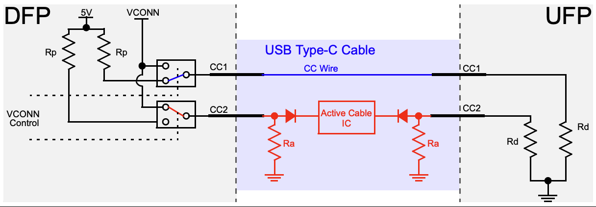

    In my previous project update, I mentioned that the CC lines in a USB-C connection are used to determine the orientation of the plug within the receptacle. Let’s explore how that works and why it poses a particular challenge for a device like Dr. PD, which needs to interpose itself between two USB-C devices.

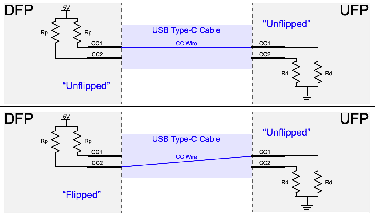

    The double life of the CC lines
    Despite the fact that there are two CC pins, only one is used for USB-PD communication between the two ports. The other may be used to supply VCONN, and in a passive cable it typically does not continue through to the far-end CC pin. Instead, VCONN is primarily used to power electronics inside the cable, such as an e-marker, or electronics in certain captive-cable devices such as docks designed to attach to laptops or tablets.
    When you plug a cable into a device, then, from the device's perspective, one of the CC lines will be floating, while the other will be able to carry a signal across to the other device.
    The problem is, which of the two CC lines do you use for transmission? Because the USB-C plug is mechanically—but not electrically—reversible, either CC pin may end up being the active one, depending on how the user inserts the cable. Thus, a device must be prepared to communicate on either pin, and the very first thing it needs to do is to figure out which one is actually connected through.
    Analog signaling
    The way the USB-PD designers have solved this challenge is to first define what a valid CC connection must look like.
    At one end, there is a downstream-facing port, or DFP. The DFP is typically a host or power supply and is responsible for sourcing current on VBUS.
    At the other end, there is an upstream-facing port, or UFP, that wants to sink current from a UFP.
    (Sometimes, a device can act as both a UFP and a DFP, in which case it is called a dual-role port. For simplicity's sake, we will ignore this for now, but we'll come back to it in a future post.)
    When they are connected, the UFP and DFP must form a complete circuit, with the DFP pulling both its CC lines to either 5V or 3.3V (the latter being much more common these days), and the UFP pulling both its CC lines down to ground, as you can see in the diagram below, borrowed from this very informative Microchip application note:
    When a connection is successfully established, one of the two CC pins will complete a circuit between the two devices; all the devices need to do is monitor both pins for a valid CC voltage and, when they detect one on either pin, select that pin as the communication channel for USB-PD data. In the diagram above, CC1 is connected at both ends, but either CC pin could end up being the connected one on each device depending on the cable’s orientation.
    Well, this complicates things…
    Having to deal with two possible cable orientations is a bit of a pain, but most devices never have to worry about this problem because someone else has already solved it for them. Even the most basic USB Type-C or USB-PD port controller can monitor both CC lines and automatically communicate over the one that is connected through to the other side, and more advanced chips may even provide a dedicated pin that changes state depending on which CC line is detected as active and can be fed directly into other controllers that reroute the signals on the high-speed lines accordingly.
    Dr. PD, on the other hand, is not a “traditional” USB-C device. In some cases, it must interpose itself between two devices while appearing electrically transparent to both, so that it can “listen” to and decode the USB-PD data being exchanged between them. In other cases, Dr. PD will be the UFP and will have to communicate with a DFP connected to one of its ports.
