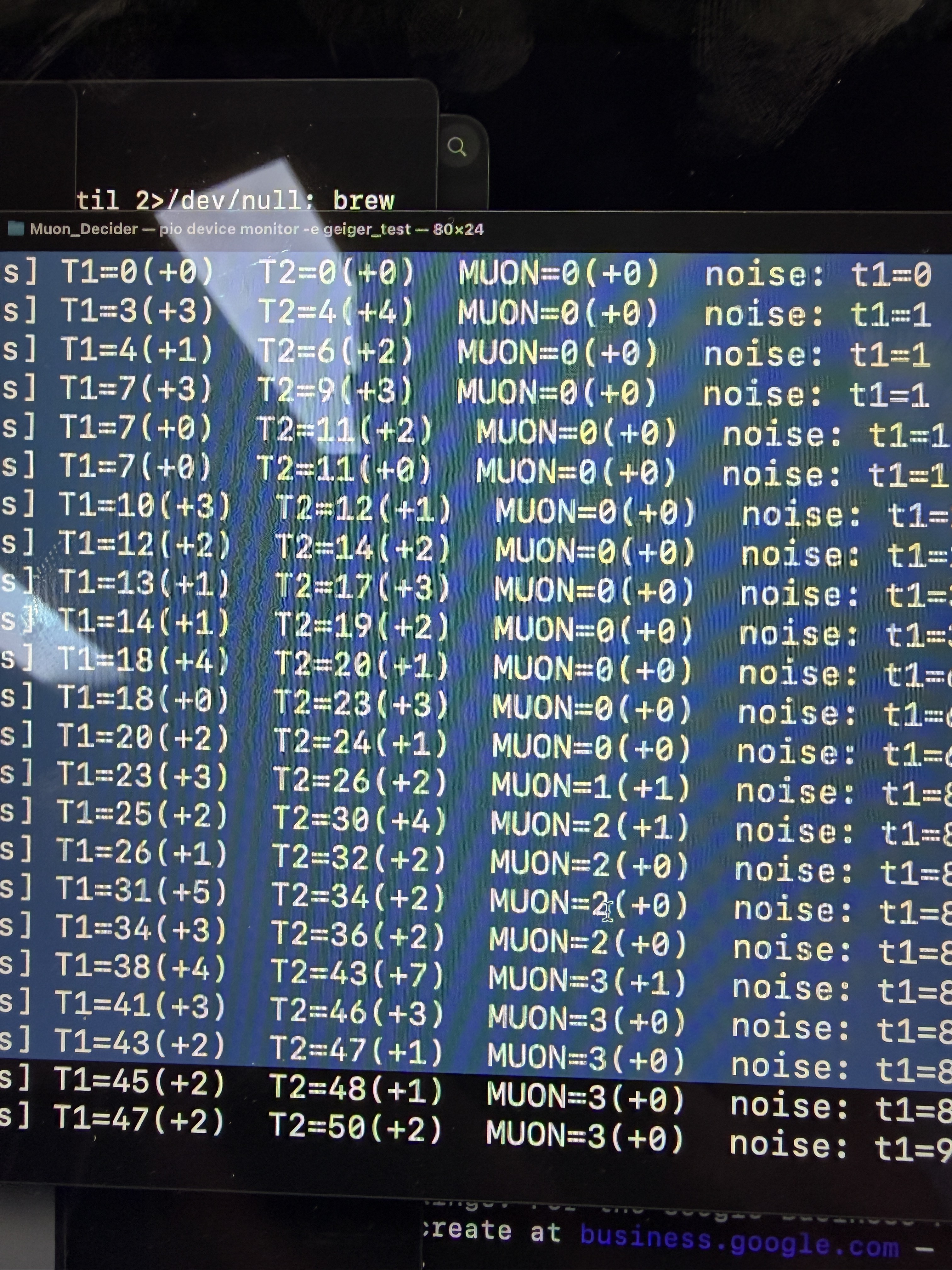

    Picking up where the last post left off; I got the two-tube coincidence detection working. After reworking the pulse stretcher timing and tuning the AND gate window, the coincidence output started firing at a rate that made sense for sea-level muons. Not zero, not 100/minute, but exactly what the documentation suggests, 3-5 for a vertical tube pair.
    That was a good day,

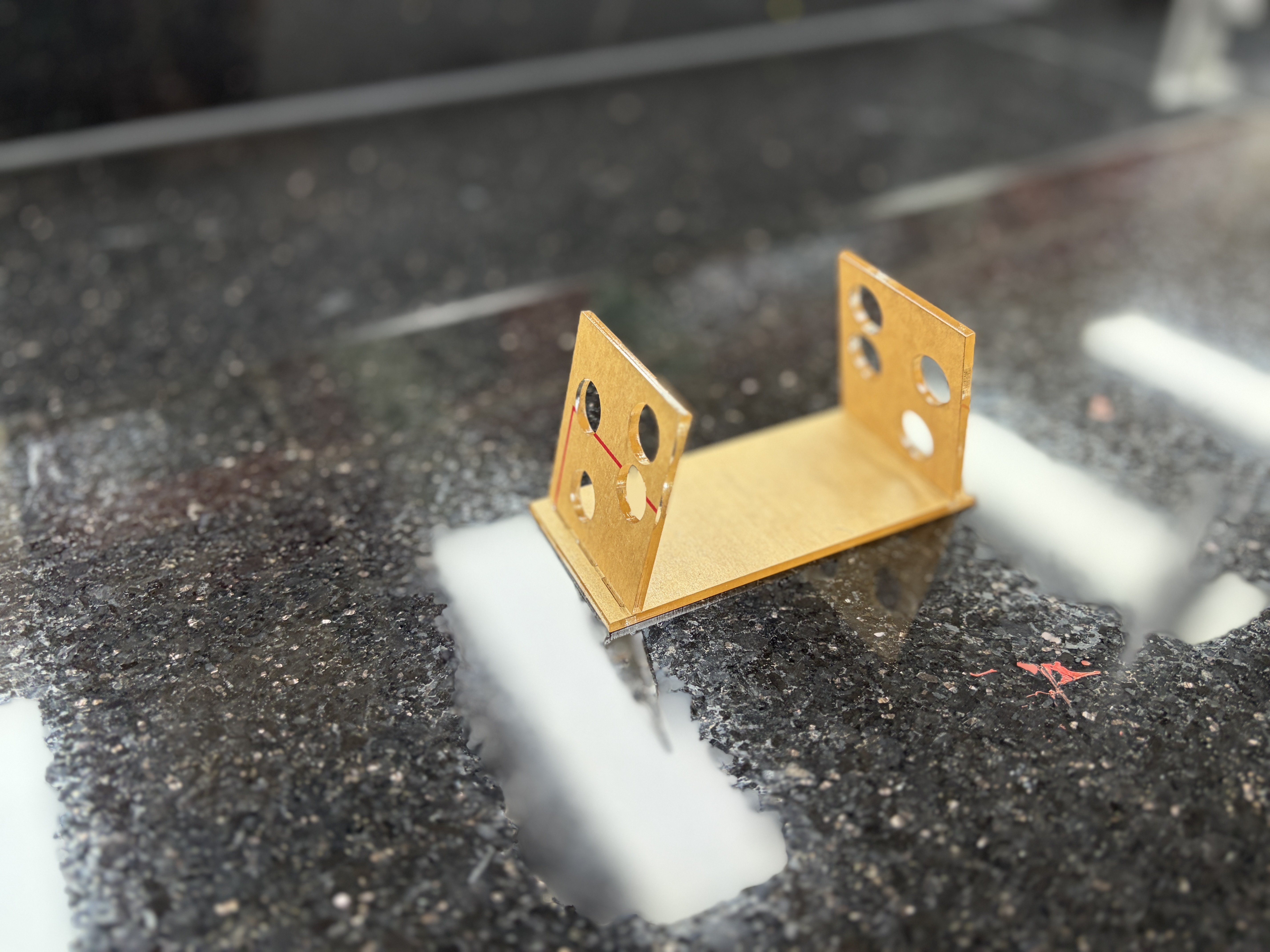

    I laser-cut an acrylic scaffold that holds all four tubes with each pair relationship fixed and repeatable. The soak test data from this rig will give me baseline coincidence rates for every angle, which feeds directly into how the rarity tiers get calibrated in firmware.

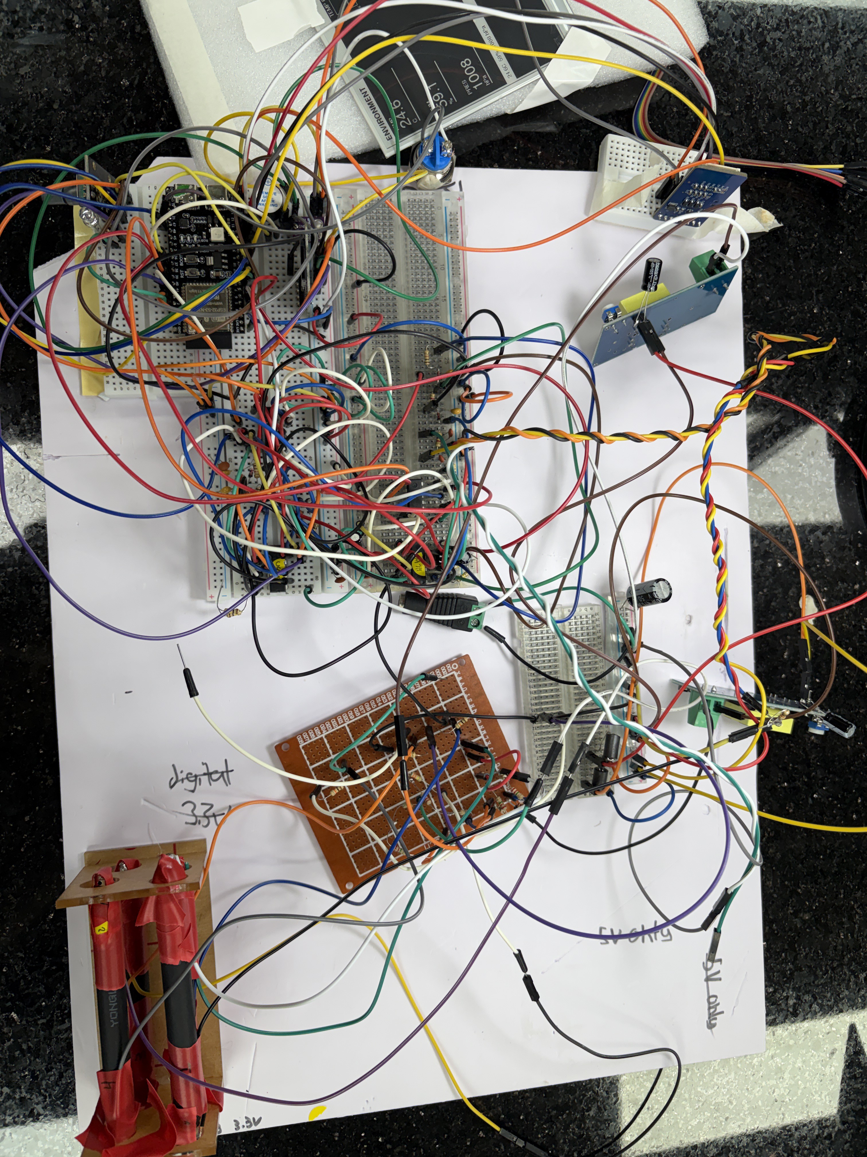

    Going from two working tubes to four meant rebuilding the entire analog front end. Two more pulse conditioning channels, two more stretcher networks, and expanding from one coincidence gate to six — one for every tube pair. That took about a week and a half and it was the hardest stretch of the project so far.
    Everything that went wrong
    My spare HV boost modules got lost in the mail, so I'm sharing one booster per two tubes instead of one per tube. This works, but it means the tubes on a shared supply interact with each other. When one tube fires, the voltage sags briefly and the other tube sees it. With uncalibrated J305s that already have different individual characteristics, this made the count rates confusing to interpret. Is tube 3 reading 40% lower because the tube is weak, because the conditioning circuit is wrong, or because it's sharing a supply with a tube that's hogging current? Hard to tell when three variables are moving at once.
    I lost a full day to my cheap USB logic analyzer. I was using it to monitor signals on the breadboard and was getting unexplainable voltage into the chip it was monitoring. Turns out it was backfeeding power through its input pins;  it wasn't just monitoring, it was supplying voltage to parts of the circuit that should have been off. Once I figured that out I had to go back and manually test every channel on both 74HC14s and the 74HC08 gates to make sure nothing had been damaged by the phantom power and that there was no signal leakage between channels.
    Then tube 4's 74HC14 channel mysteriously died. Just stopped responding. Replaced the IC, verified the new one, moved on.
    At this point tubes 1 and 2 were counting reliably and their coincidence channel looked clean. But tube 3 was still reading about 40% lower than the other three, and tube 4 would randomly get overwhelmed with noise bursts with counts shooting up to nonsense levels for a few seconds before settling back down.
    I spent days checking and rechecking. Swapped components, reflowed solder joints, traced every wire. Eventually I documented the coordinates the full breadboard layout and asked Claude Opus 4.7 and GPT 5.5 to look at it. They both identified the same problem: tubes 2 and 3 were getting...

    I had an acrylic scaffold laser-cut to hold four J305 tubes for testing. The design puts each of the six possible tube pairs at a different angle with a different geometric aperture, so I can eventually compare coincidence rates across different alignments. The tubes are wrapped in black heat shrink for light shielding (J305s are photosensitive and will false-trigger from ambient light), then taped securely into the cradles.
