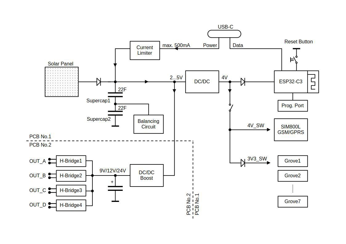

Energy is stored in two 22F supercapacitors connected in series, forming a storage stage up to 5V. The system accumulates energy over time and releases it as a controlled high-power burst when required.

Transmitter Node (core hardware)
  • solar energy harvesting and storage
  • ultra-low quiescent current (~tens of µA)
  • sensor interfacing and data acquisition
  • controlled high-power output for actuators
  • wireless communication

  • Energy storage: 2× 22F supercapacitors (series, up to 5V)
  • Ultra-low quiescent current: a few 10 µA
  • No-light operation: up to ~5 days (foggy conditions, ultra-low-power mode)
High-power burst outputs:
  • 24V @ 500 mA
  • 12V @ 1 A
  • 9V @ 1.5 A

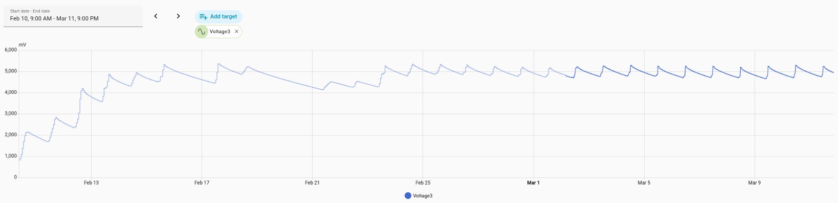

    A long-term measurement shows the typical charge and discharge behavior following day–night cycles. Even under cloudy conditions, the supercapacitors are charged close to their maximum voltage levels.
    In this example, the ESP32-C3 operates in continuous deep sleep mode. Between February 19 and February 20, snowfall occurred in Bratislava, covering the solar panel. As a result, the supercapacitors could not be recharged for three days.
    Despite this, the voltage did not drop below 4.1 V, demonstrating the system’s robustness under unfavorable environmental conditions.

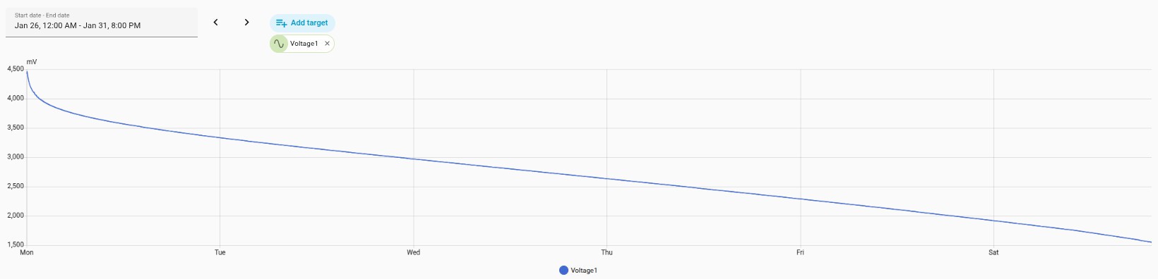

    In a continuous deep-sleep scenario, the system can operate for several days without sunlight.
    In this first experiment, a simplified firmware was used to keep the system in permanent deep sleep. The fully charged supercapacitors powered the ESP32-C3 through a DC/DC converter, operating down to an input voltage of approximately 1.5 V. Below this threshold, the converter disables output regulation and the ESP32-C3 can no longer maintain a stable supply.
    Under these conditions, total runtime reached nearly 6 days.
    This test demonstrates the feasibility of multi-day autonomous operation using only harvested solar energy stored in supercapacitors, without any battery buffer.

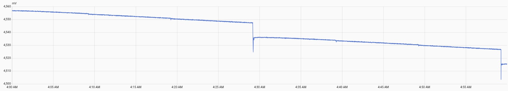

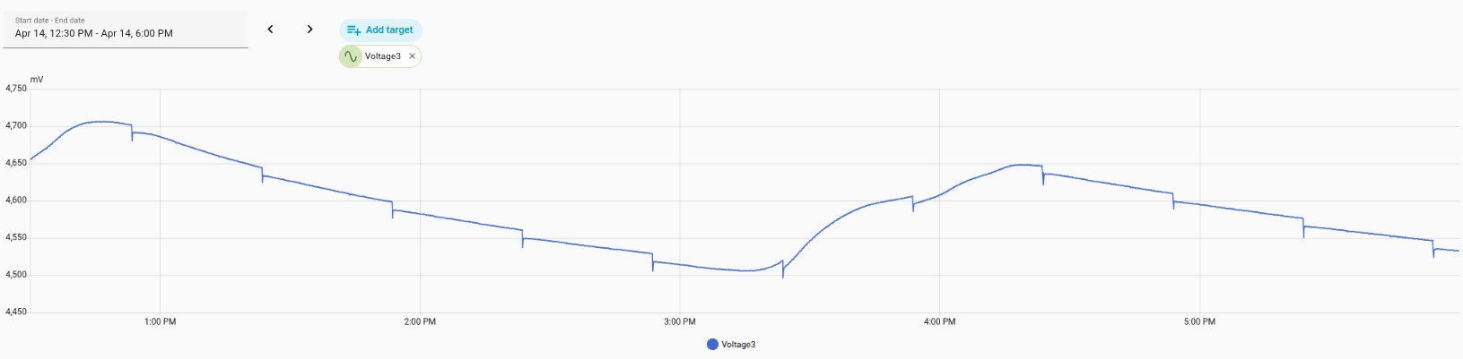

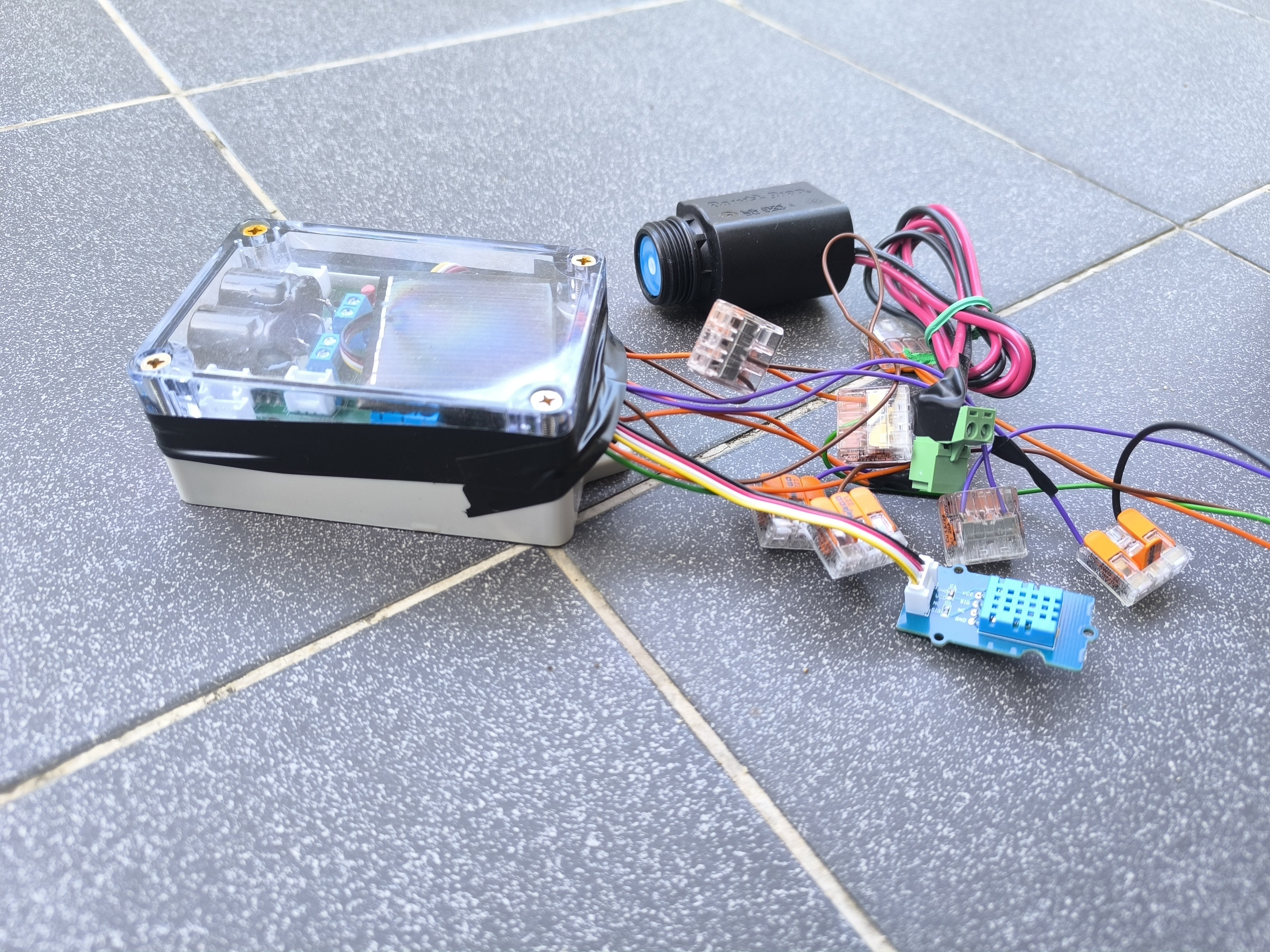

    In the first real-world test, the system was connected to a 9 V DC latching solenoid valve (Rain Bird) and a DHT11 temperature and humidity sensor.
    The node communicated with a receiver (XIAO ESP32-C3) every 10 minutes. In addition, the solenoid was actuated in both directions every 30 minutes, with each switching event lasting approximately 1 second.
    This setup was used to evaluate the energy of real actuator operation under typical outdoor IoT conditions.
    The measurements show that each solenoid actuation caused the supercapacitor voltage to drop by approximately 11 mV, corresponding to an energy consumption of about 550 mJ at ~4.5 V.
    These results confirm that even high-power mechanical switching can be supported within a supercapacitor-based, battery-free energy budget when duty cycles are properly managed.
