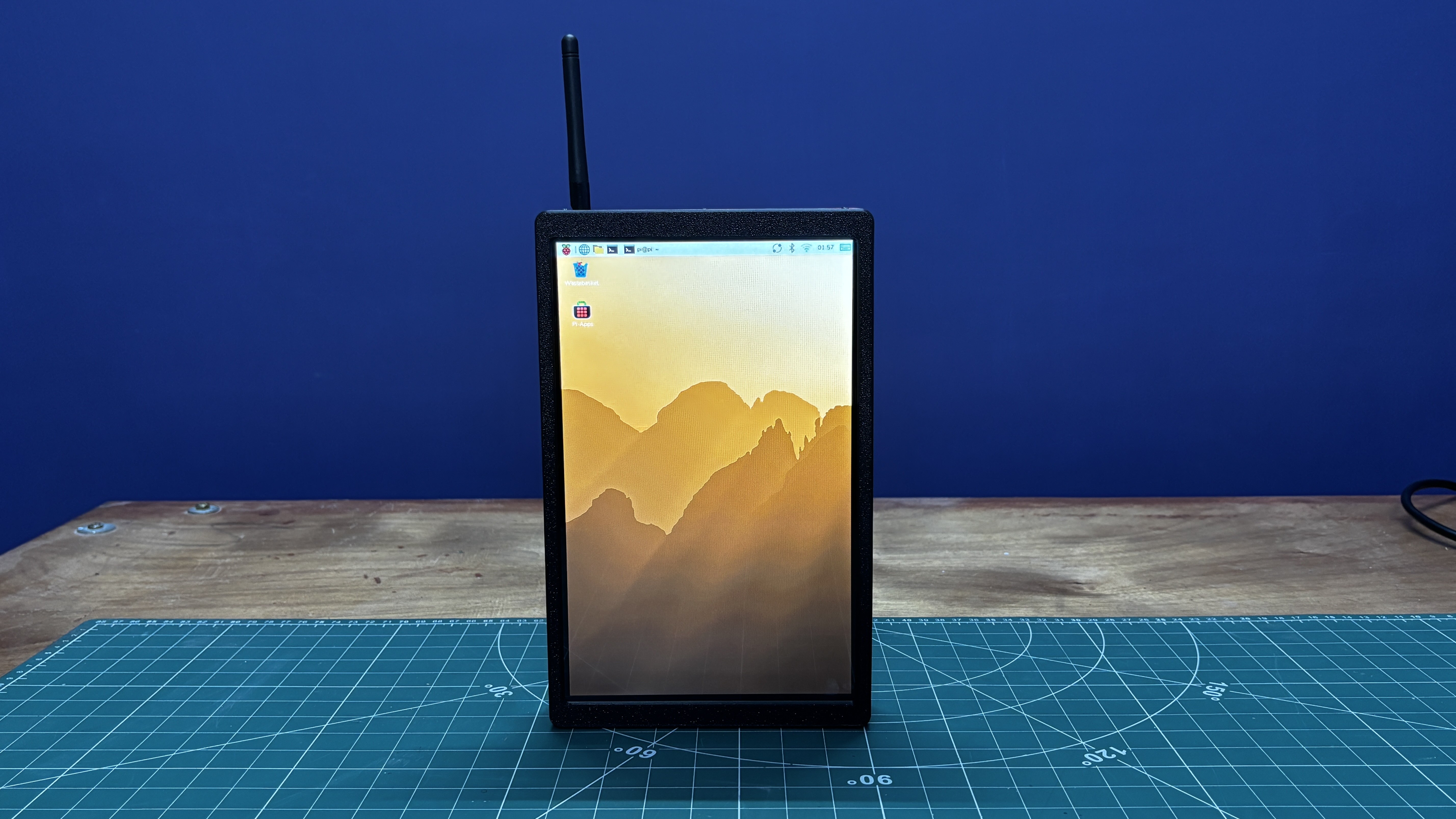

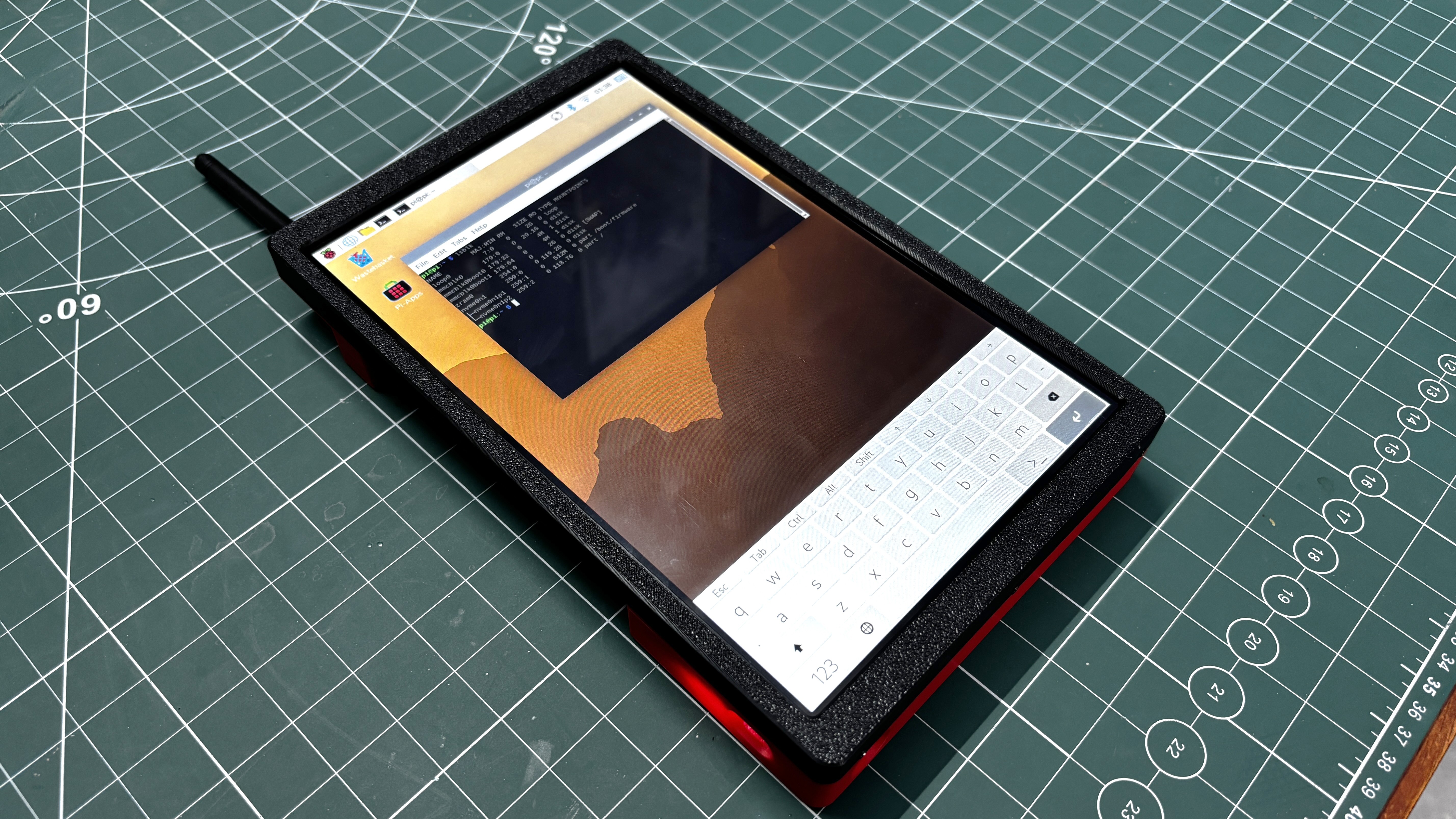

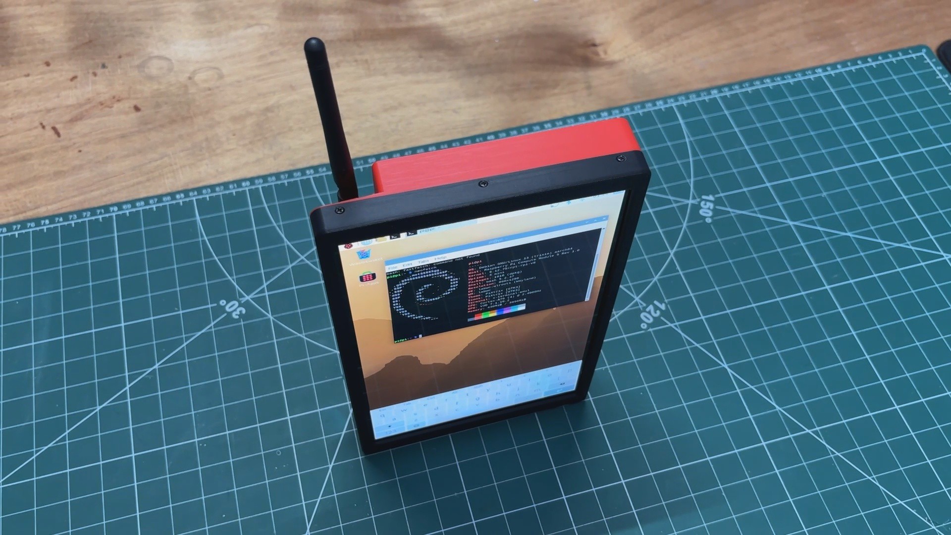

Here's something awesome: meet the ABSOLUTE LINUX TABLET, my DIY tablet built completely from scratch.
This is a DIY tablet powered by a Raspberry Pi Compute Module 5, paired with a Waveshare 10-inch DSI touch display and an onboard lithium battery, which provides up to 5 hours of continuous usage.
The goal of this project was to create a portable Linux tablet for an upcoming solar project, where I needed a device that I could easily carry from one site to another while working outdoors. A laptop could have been used instead, but I wanted something more portable and convenient to work with. Raspberry Pi OS is perfect for this task, which is why I decided to build a tablet around the CM5 and a touch display.
This Device is a fusion between a touch computer and a tablet. I have used a 4GB variant of the CM5, and for improved performance, I installed the operating system on an NVMe SSD, making the system super fast.
To enhance Wi-Fi and Bluetooth connectivity, I also added an external antenna to the device.

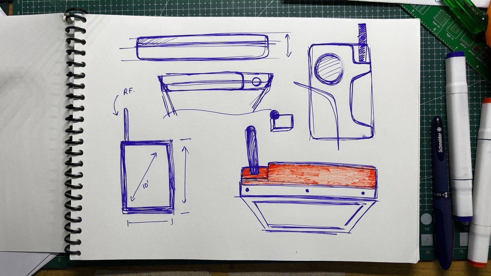

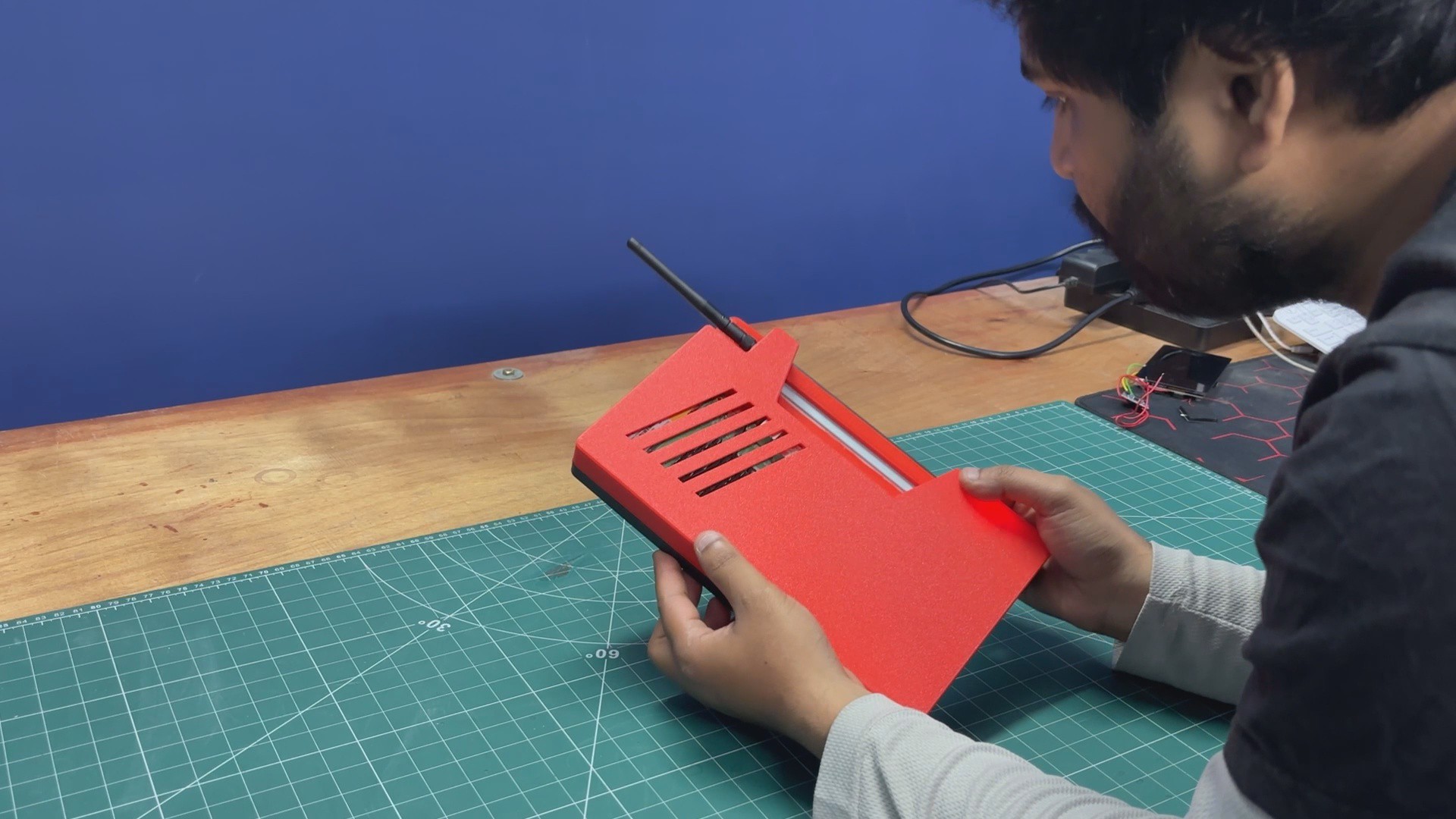

I designed the enclosure in Fusion 360 and printed the parts on my 3D printer in two colours to get a duotone aesthetic.
This article covers the complete build process of the tablet, so let's get started with the build.

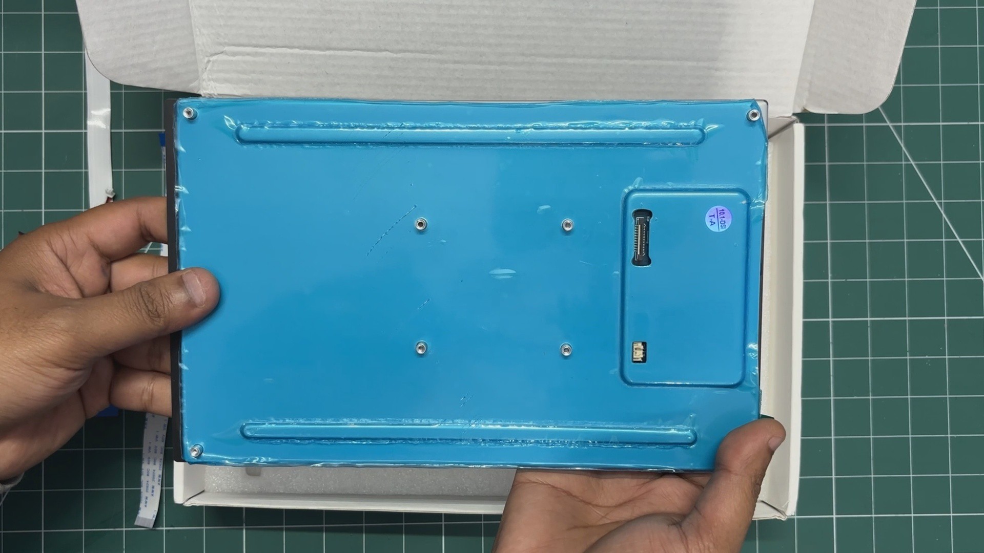

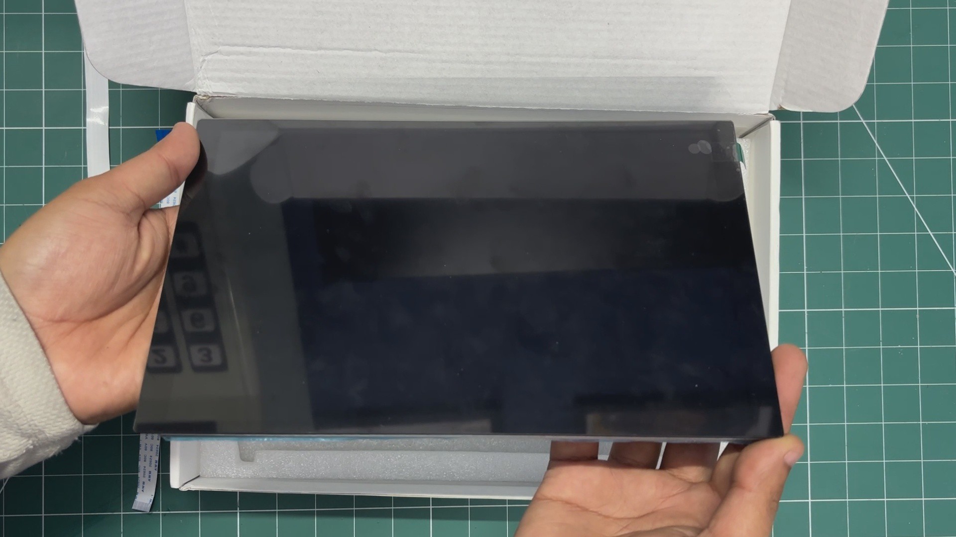

So, I selected Waveshare's 10.1-DSI-TOUCH-A display for this project. It is a portrait touchscreen LCD display with ten-point capacitive touch control. The display uses an IPS panel with a hardware resolution of 800×1280, which is perfect for our tablet application.
The LCD pairs with the Raspberry Pi through the DSI interface and supports a refresh rate of up to 60 Hz, which is more than enough for this application.
The kit comes with two FFC cables for pairing the display with a Raspberry Pi 5 or CM5, one FFC cable for pairing with a Raspberry Pi 4, a power cable, and a couple of PCB standoffs.

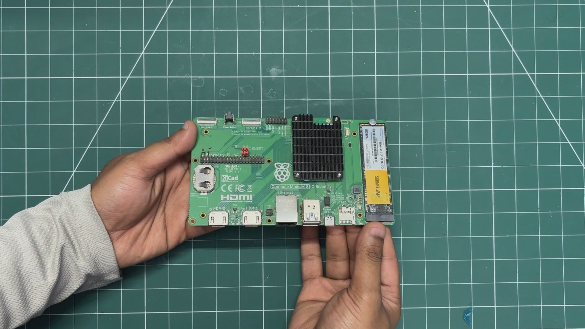

The brain of our project is the Raspberry Pi CM5, which is a more industrial-oriented version of the usual Raspberry Pi 5 in a module form factor. It uses the same Broadcom BCM2712 quad-core 64-bit Arm Cortex-A76 (Armv8)...

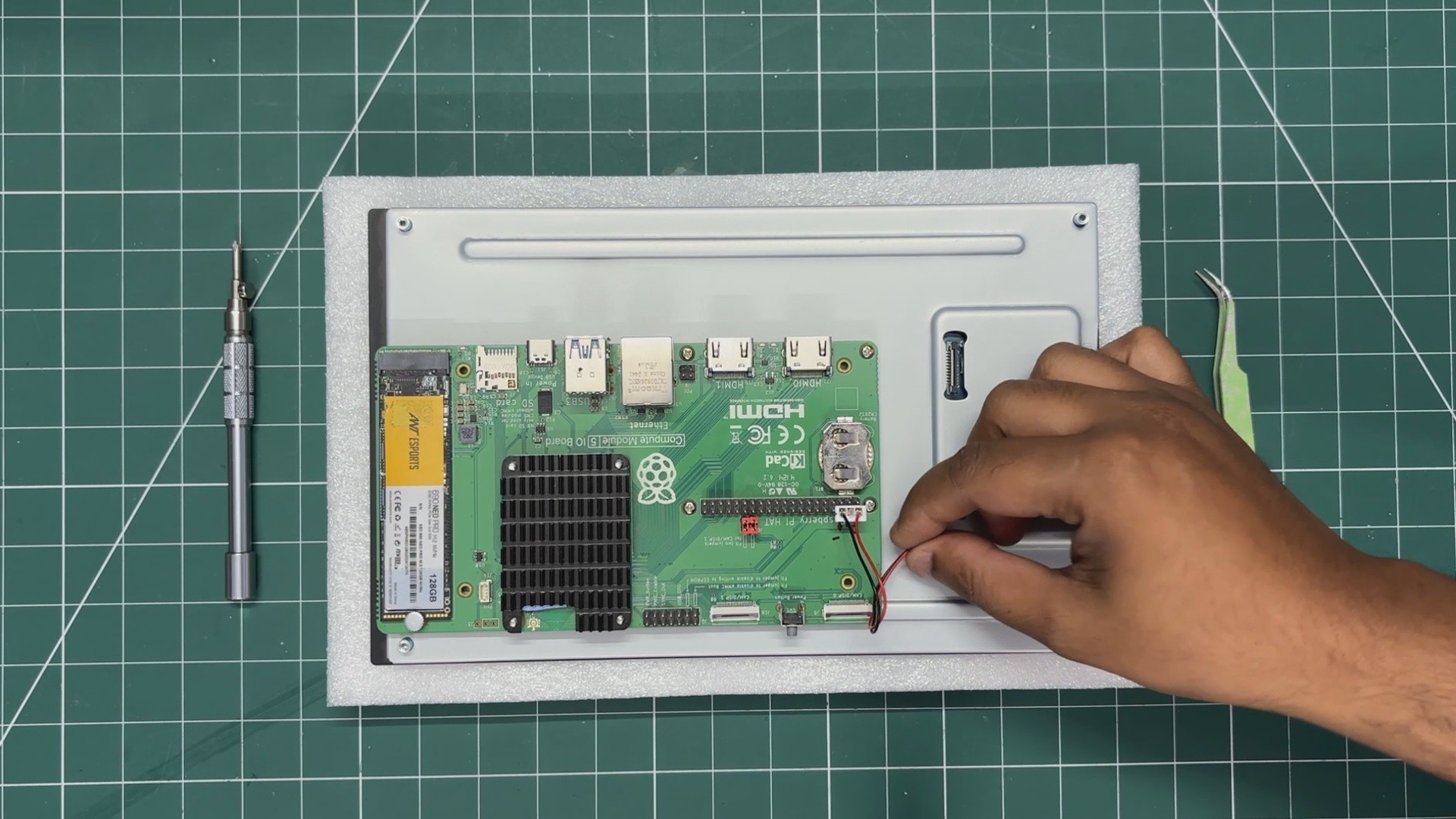

    DISPLAY & CM5 ASSEMBLY

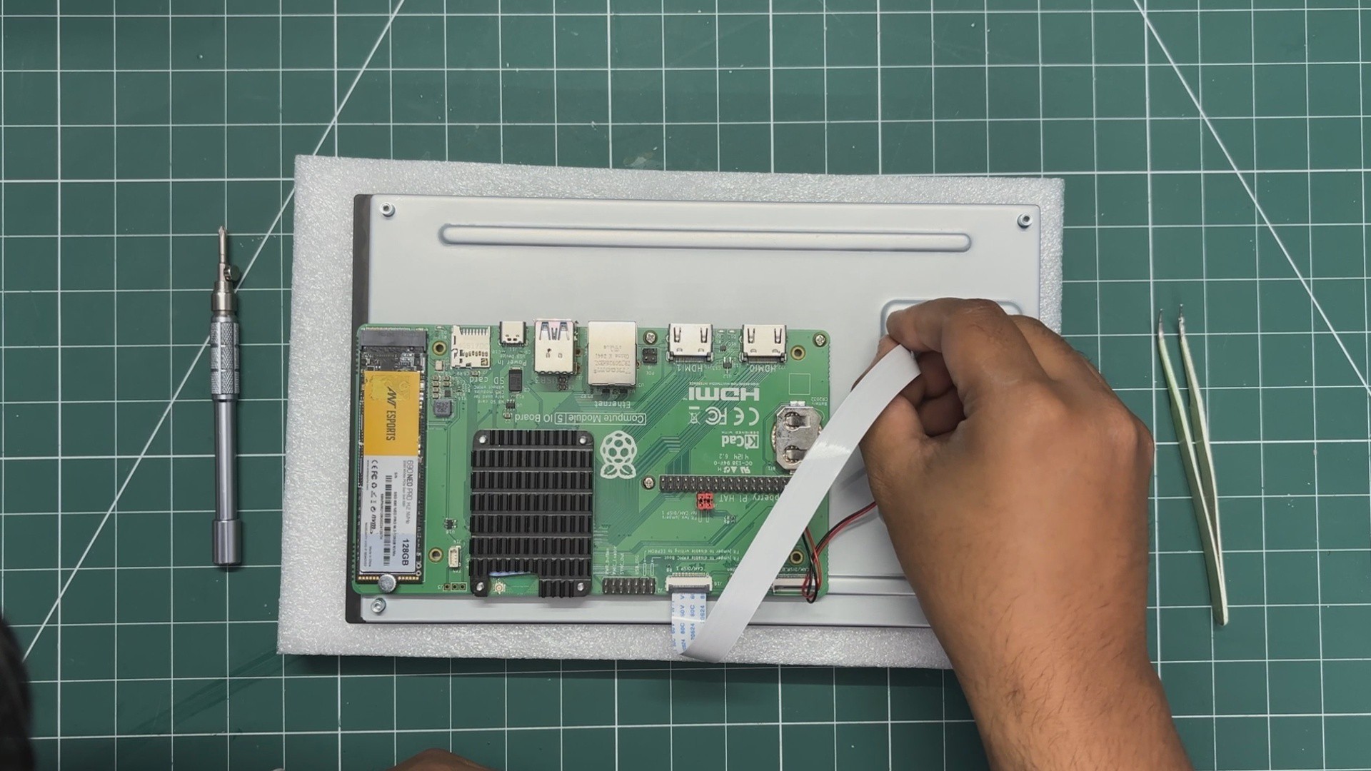

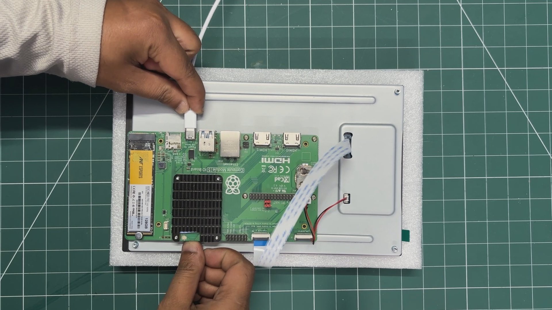

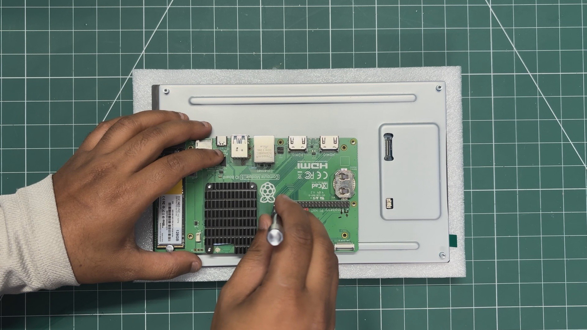

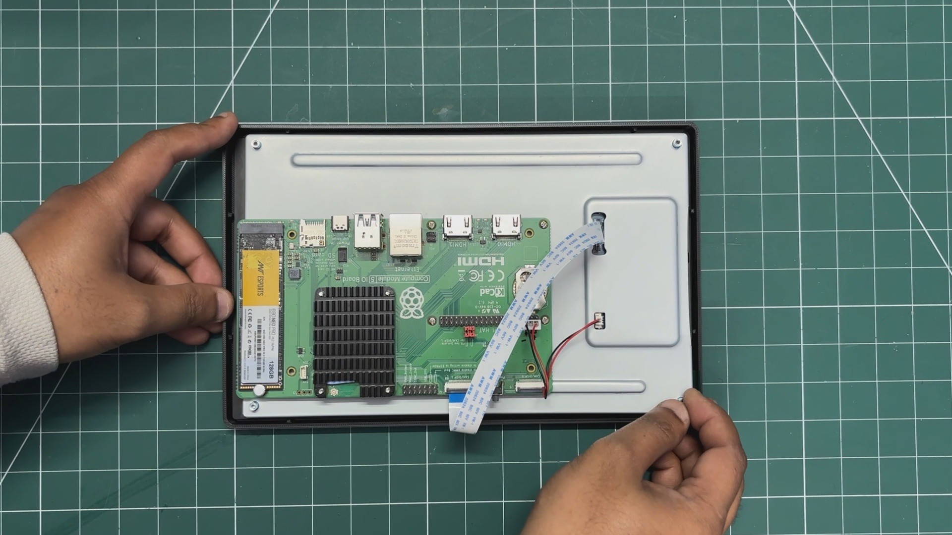

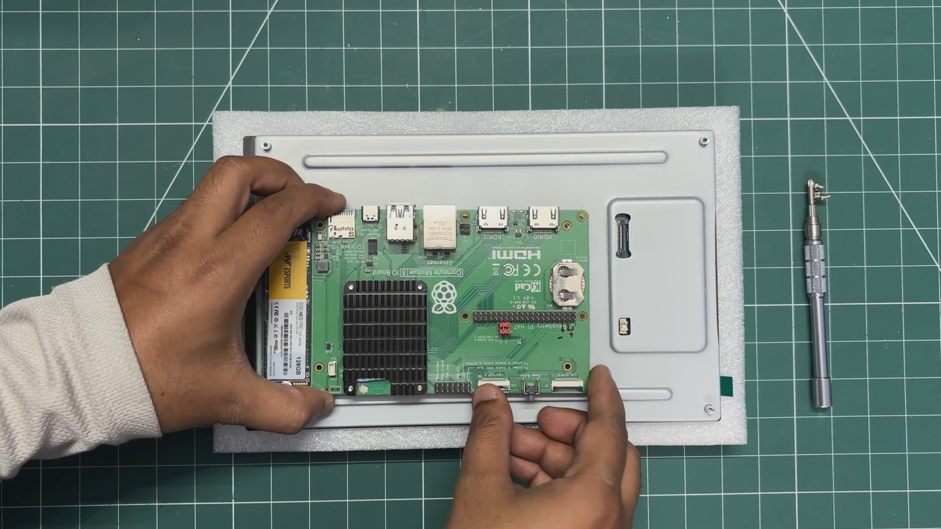

    • We begin the display and CM5 assembly process by positioning the expansion board over the back of the display.
    • We align the mounting holes of the display with the Raspberry Pi board and then use the provided four M2.5 bolts to secure both of them together.

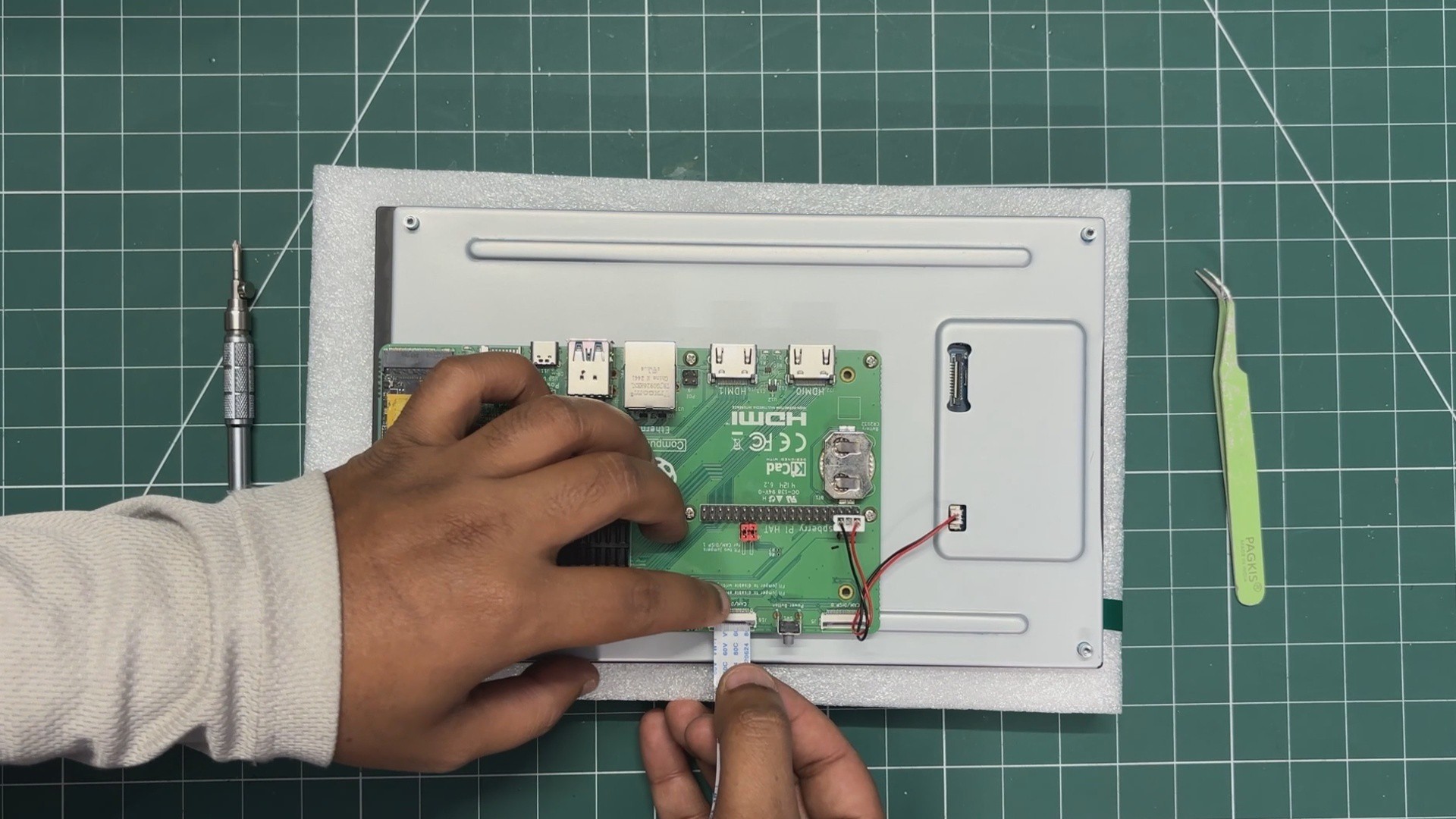

    • Next, we connect the power wire harness. One side is connected to the JST connector on the display, while the other end goes to the Raspberry Pi's GPIO header. We connected 5V to 5V and GND to GND. Basically, the display will be powered directly from the GPIO header of the Raspberry Pi.
    • Next, the FPC cable is added. We first connect it to Port 1 on the Raspberry Pi expansion board and then connect the second end to the display's FPC connector.
  • 2
    CONFIG FILE EDIT

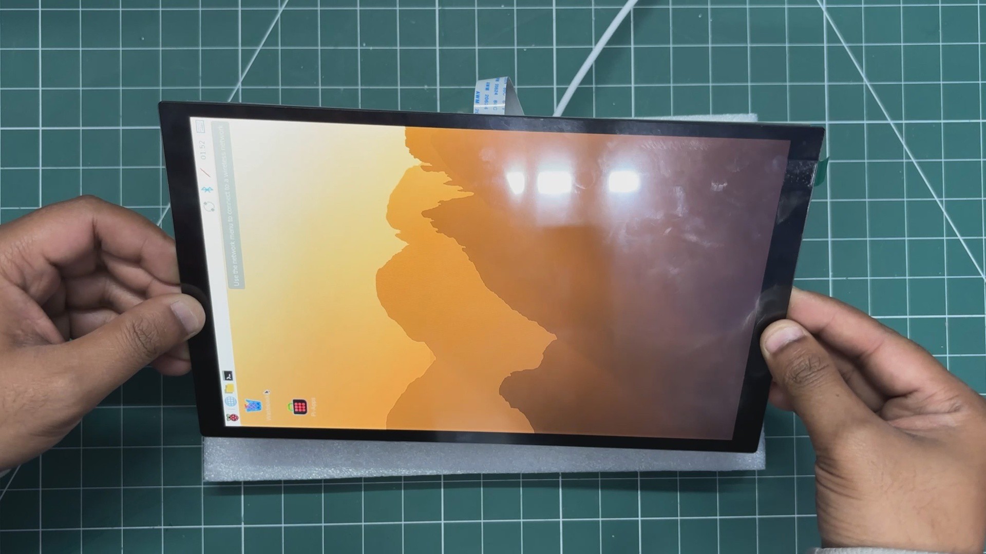

    We plugged in the power and were hoping this would be a plug-and-play job, but things are never that simple, and the display didn't work straight away.
    We needed to connect an external monitor to our CM5, open a terminal, and then edit the config.txt file.
    We added the following line at the bottom of the file.
    dtoverlay=vc4-kms-v3d#DSI1 Usedtoverlay=vc4-kms-dsi-waveshare-panel-v2,10_1_inch_a#DSI0 Use# dtoverlay=vc4-kms-dsi-waveshare-panel-v2,10_1_inch_a,dsi0
    On the wiki page for this display, to Waveshare's credit, they did include a custom pre-flashed Raspberry Pi OS Trixie image. If we use that image and flash our Raspberry Pi with it, the display boots up without requiring any manual edits to the configuration files.
