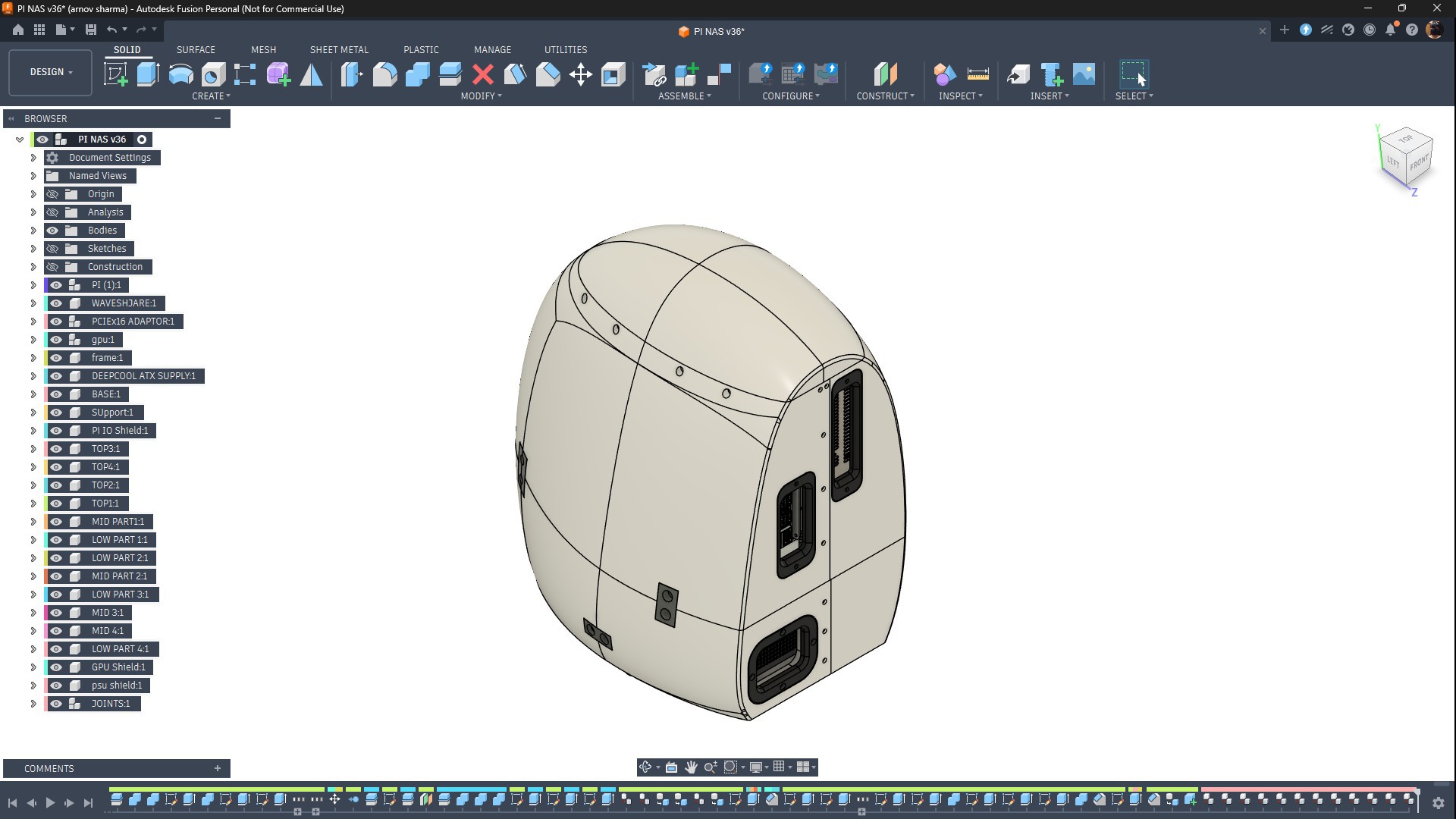

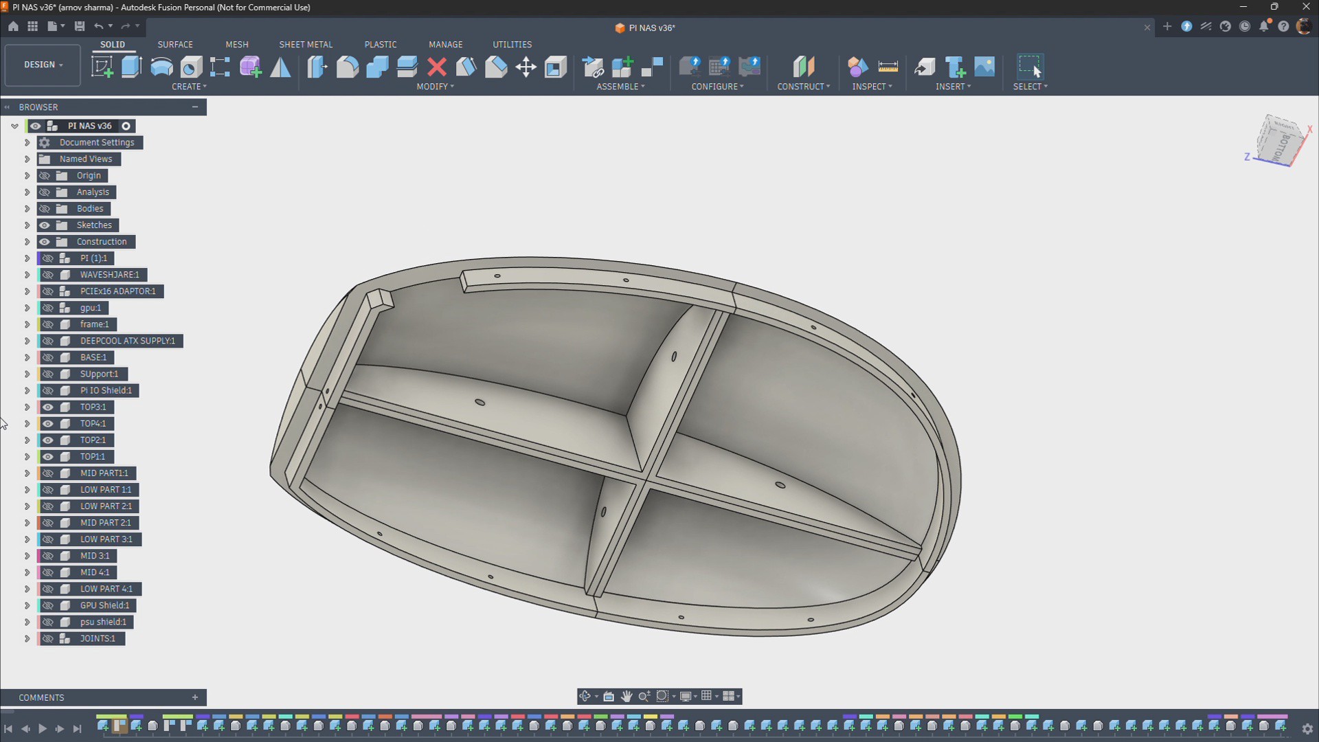

POTATO PC 3D MODEL

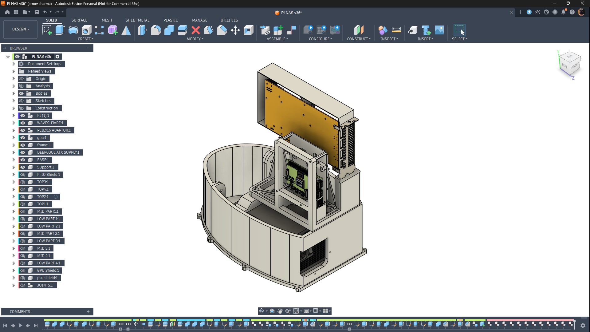

For the 3D design of our Potato PC, we began by importing the CAD models of all the electronic components used in the build. This included the Raspberry Pi 5 and NVMe expansion board assembly, the Sapphire Pulse Radeon RX 6500 XT, the PCIe adapter, and the power supply.
We first arranged all of these models in their desired positions and then designed a minimal frame to hold the Raspberry Pi and NVMe board assembly, along with the graphics card and PCIe adapter.
This frame assembly served as the central structural component of the design. We positioned it above the power supply and created a base that securely holds the PSU while also supporting the frame assembly.
Finally, we modeled a potato-shaped enclosure around the base using the surface modeling tools in Autodesk Fusion. Our goal was to create an asymmetrical outer shell that closely resembles a real potato.
5

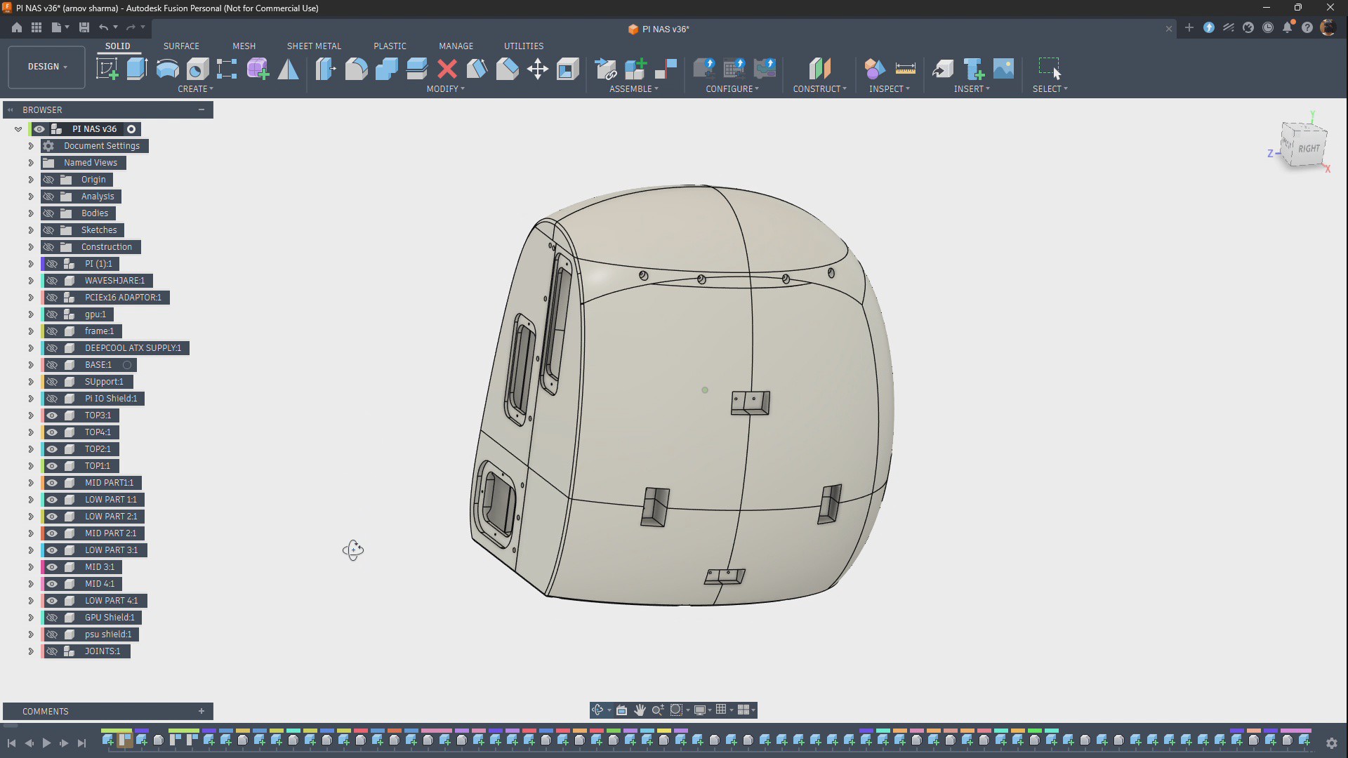

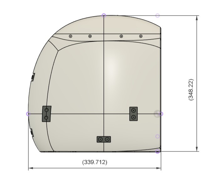

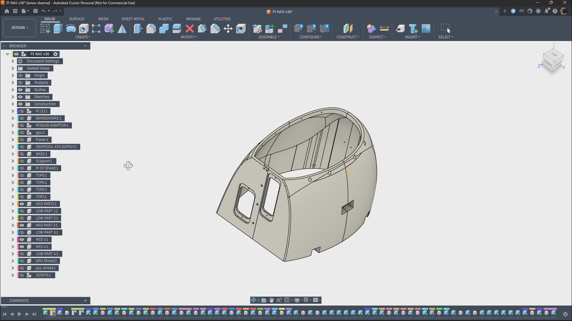

POTATO ENCLOSURE

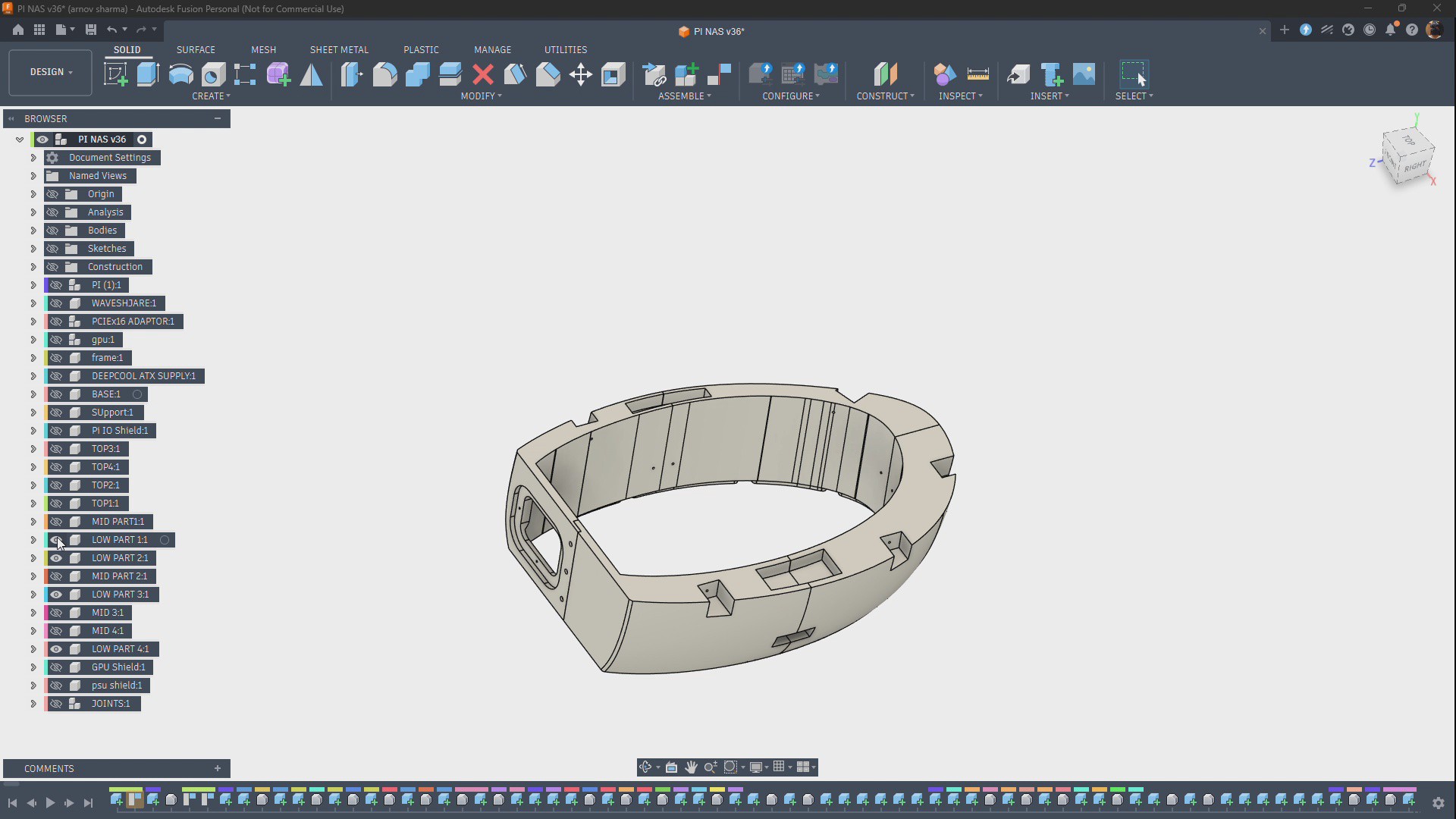

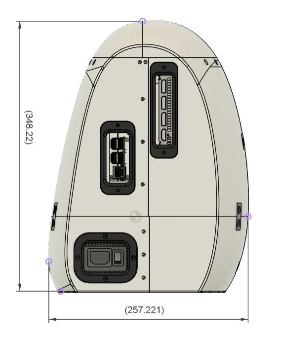

The enclosure itself was quite easy to model, but there was one major challenge: its overall dimensions are 350 mm × 257 mm × 340 mm.
The 3D printer I'm using has a build volume of only 255 mm × 255 mm × 255 mm, which meant the enclosure was too large to print as a single piece.
To solve this, we divided the enclosure into multiple parts, printed each part separately, and then assembled them to create a single enclosure body.
6

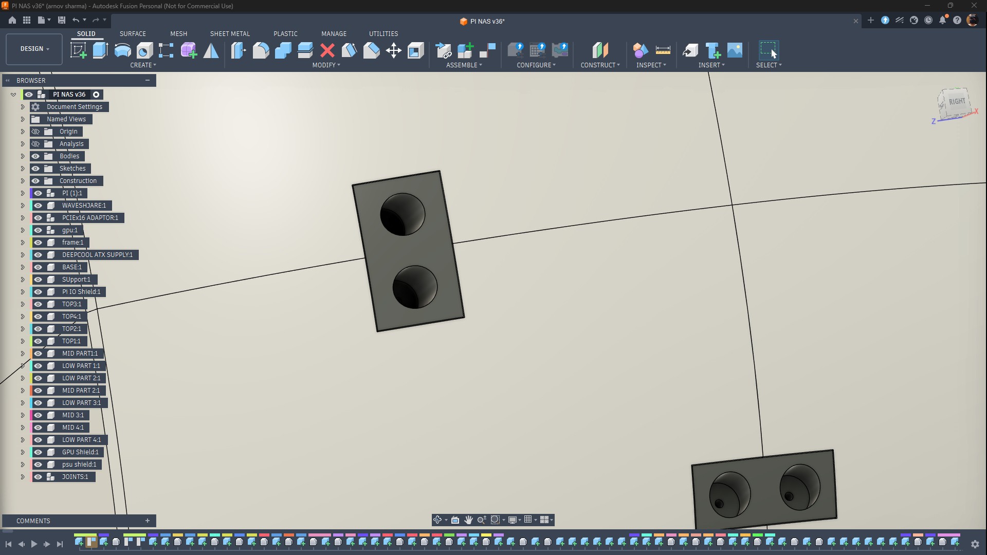

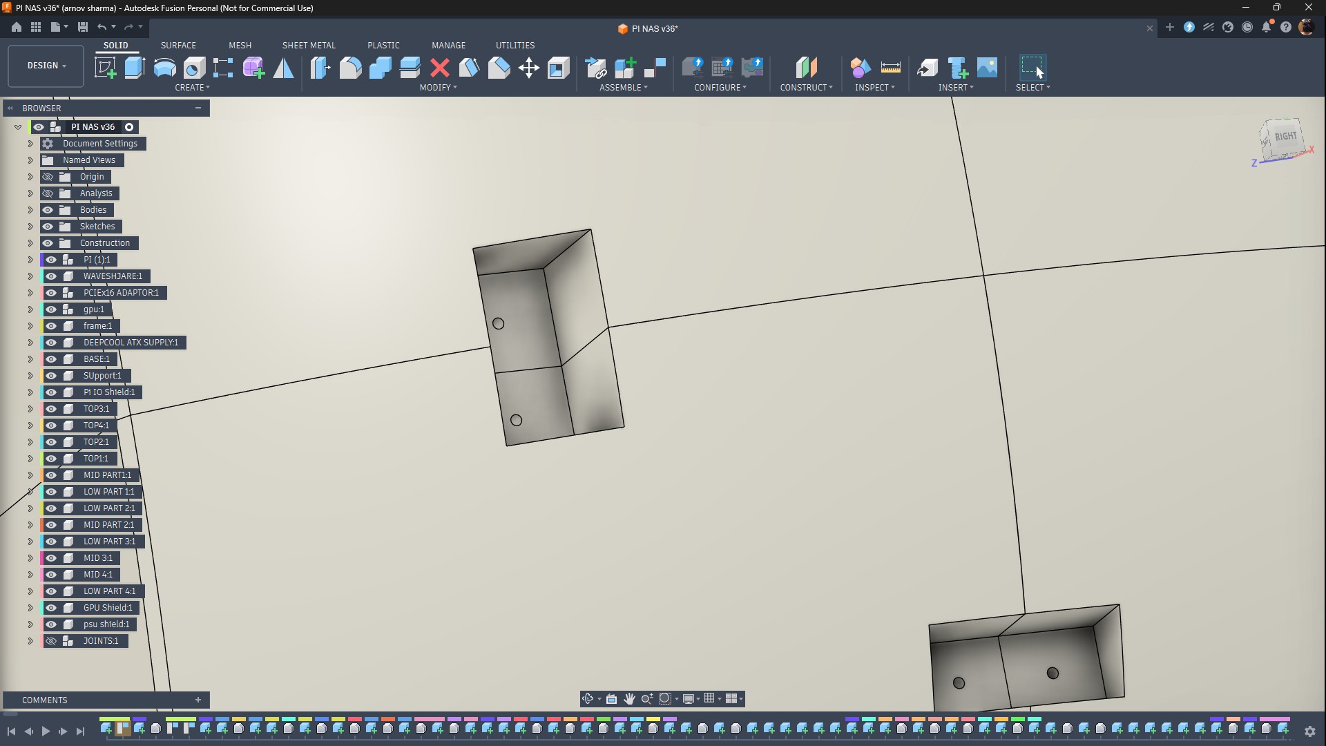

JOINTS
To join the enclosure parts together, we added several rectangular slots along the dividing lines between adjacent parts. A rectangular joint fits into these slots and connects the two pieces together.
This joining method was inspired by woodworking, where two parts are connected by cutting matching slots and inserting a third piece between them.
To secure each joint to the two enclosure halves, the joint includes two screw holes. We use M3 screws to fasten all three parts together.
All of the enclosure parts are connected using this same joint design.

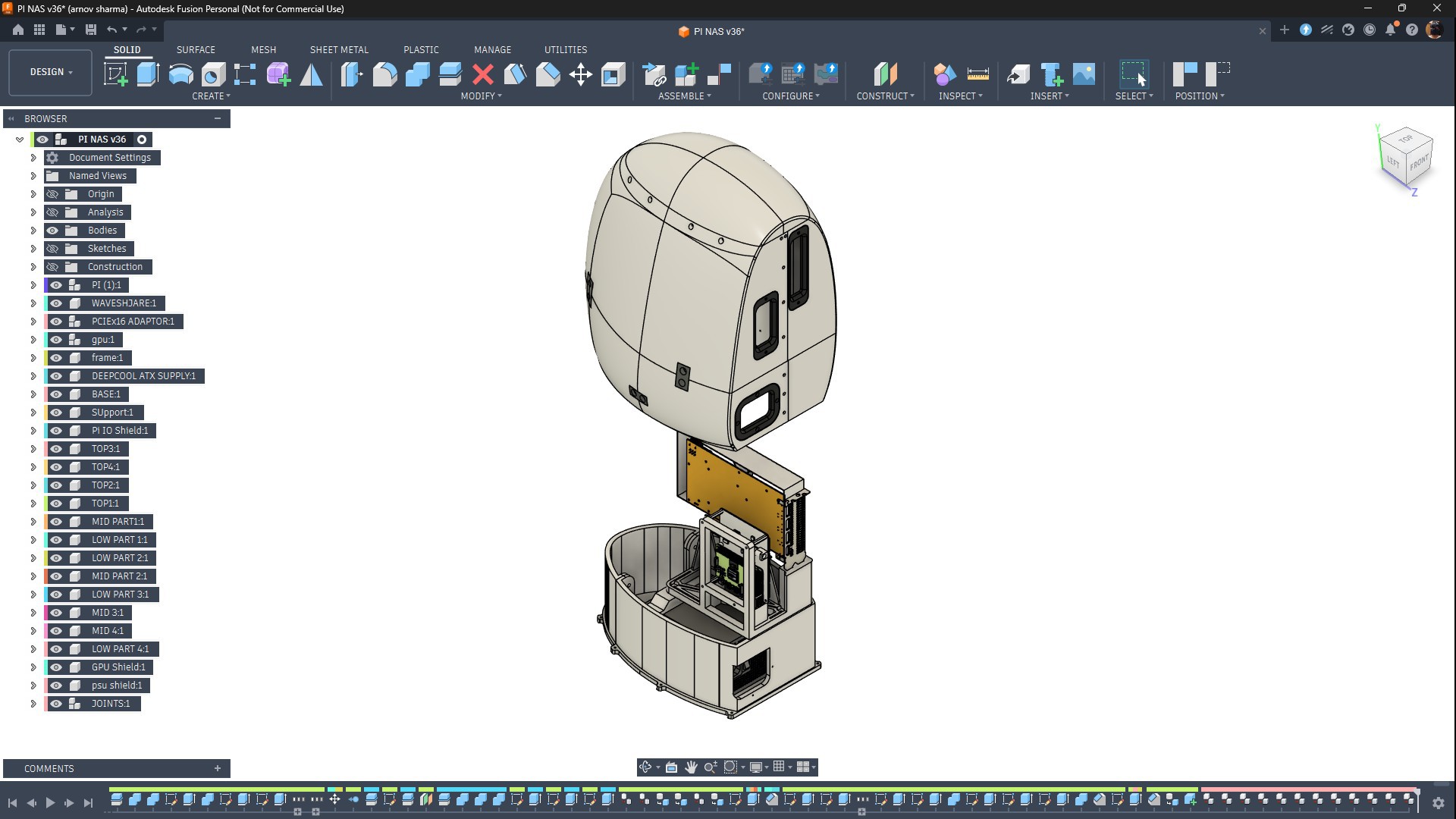

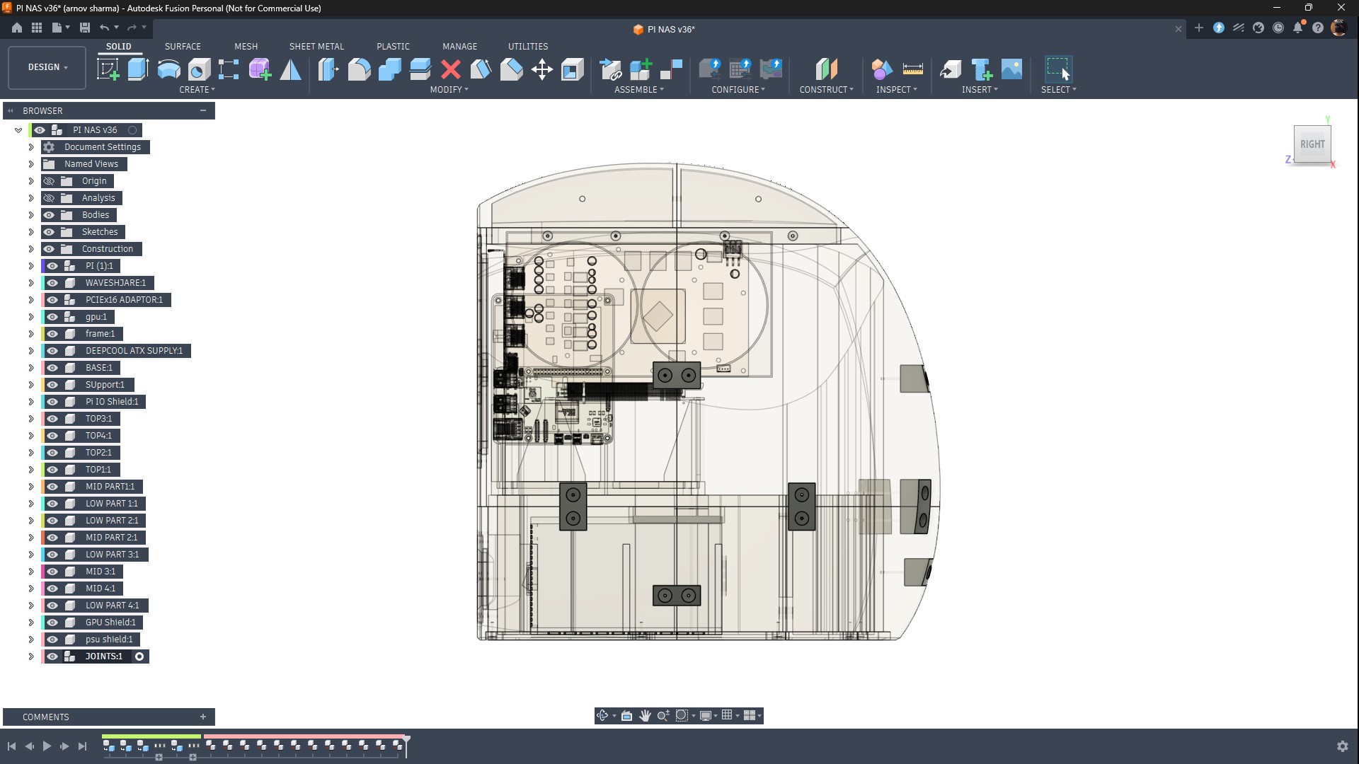

FRAME ASSEMBLY

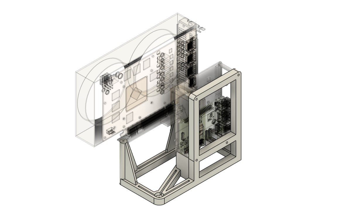

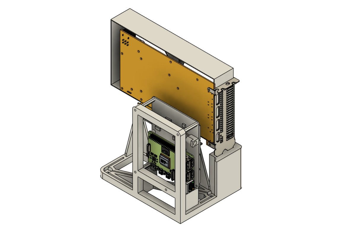

I modeled a custom frame that holds the Raspberry Pi 5, GPU, Waveshare expansion board, and PCIe adapter all together as a single assembly.
This frame serves as the primary structural component of the project. It keeps the Raspberry Pi and GPU securely mounted together, making it essential for both the initial testing phase and the final assembly of the Potato PC.
8
BASE
The base is designed so that the potato enclosure can slide over it and fit securely into place.
To accommodate the build volume of our 3D printer, the base was divided into two separate parts. Both parts were printed individually and then joined together to create a single base unit.
The frame assembly is mounted onto the base, and the entire structure is enclosed by the potato-shaped shell.

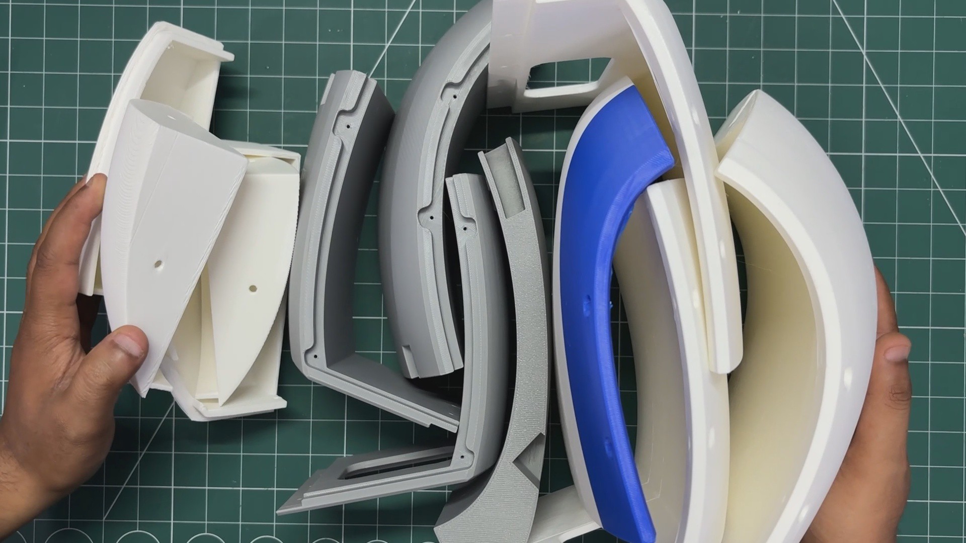

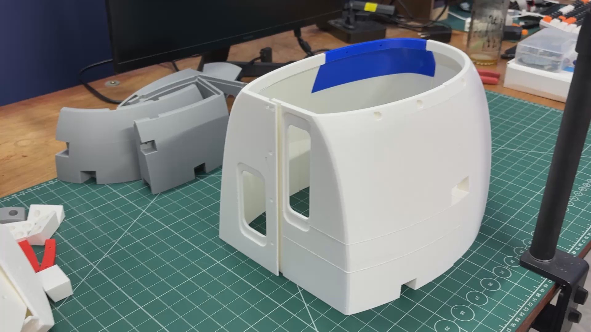

3D PARTS- POTATO ENCLOSURE
For the Potato PC enclosure, I printed a total of 12 parts. The model is divided into three sections: the top section contains four parts, the middle section contains four parts, and the bottom section also contains four parts.
My goal was to assemble these parts like LEGO pieces to create a single PC enclosure. Since my 3D printer has a build volume of 255 × 255 × 255 mm, which is smaller than the overall size of the enclosure, I had to divide the model into multiple parts before printing.
For each part, I used Creality Hyper PLA with a 0.28 mm layer height. For infill, I used 10% gyroid infill for extra strength. Each part took roughly 4 to 5 hours to print.
Some parts were printed in colors other than white for two reasons. First, I ran out of white filament—this project used around seven rolls of PLA. Second, I planned to do a full surface-finishing process on the enclosure, so the original filament color didn’t matter whether the parts were printed in red, blue, black, or any other color.

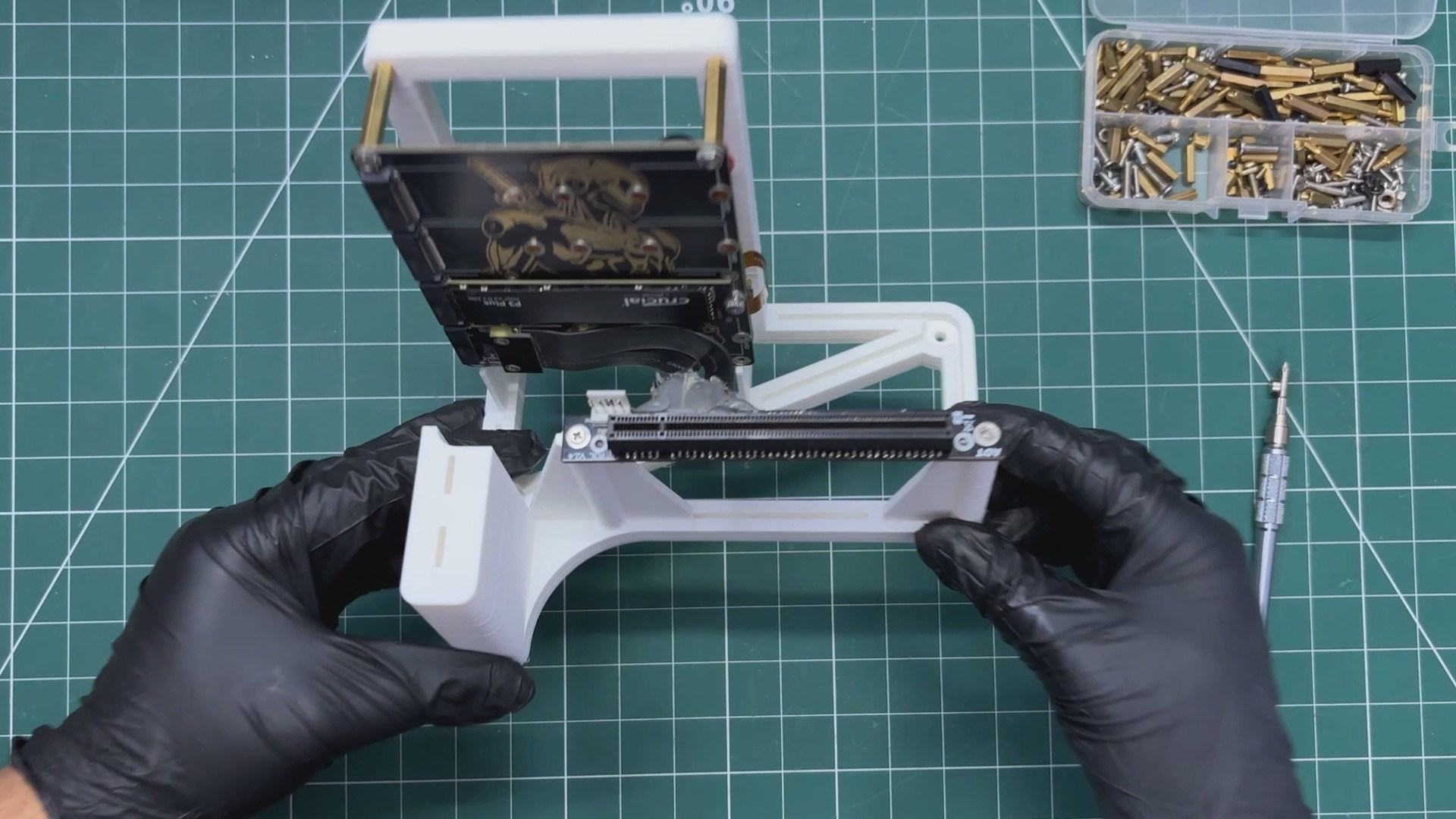

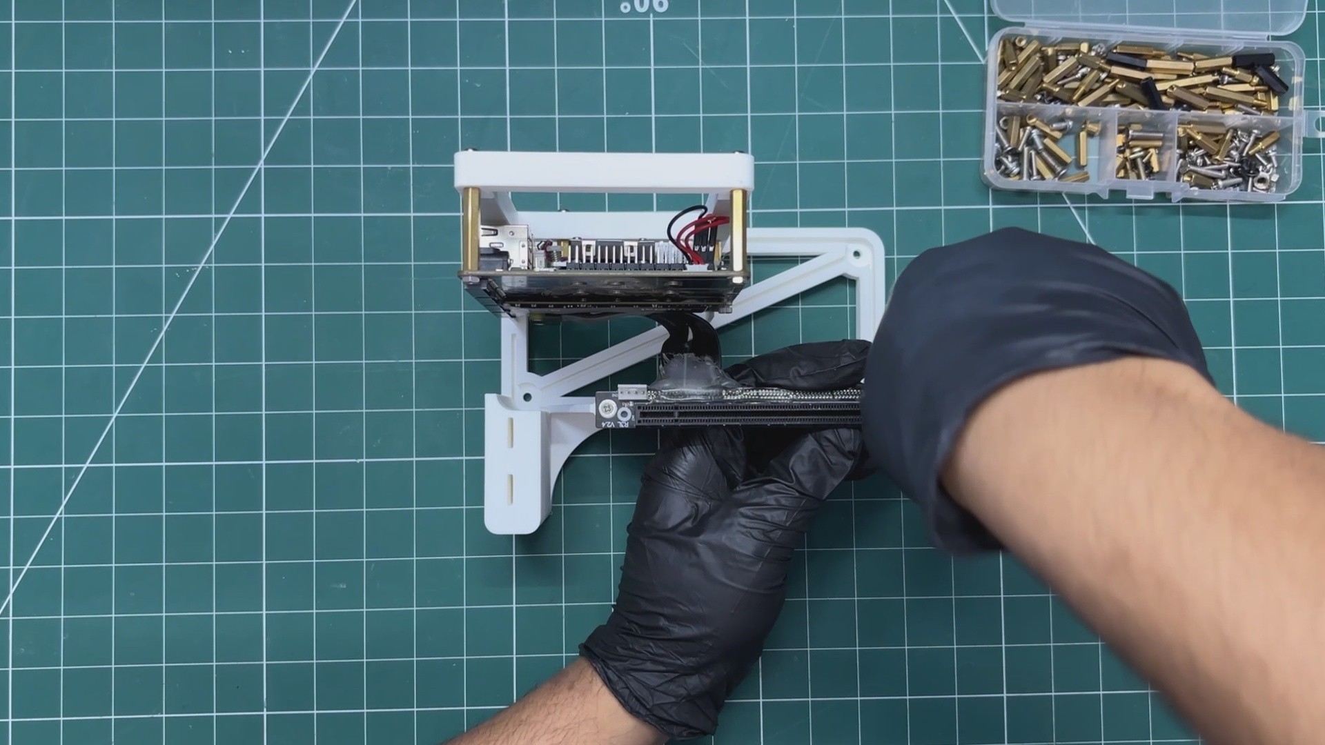

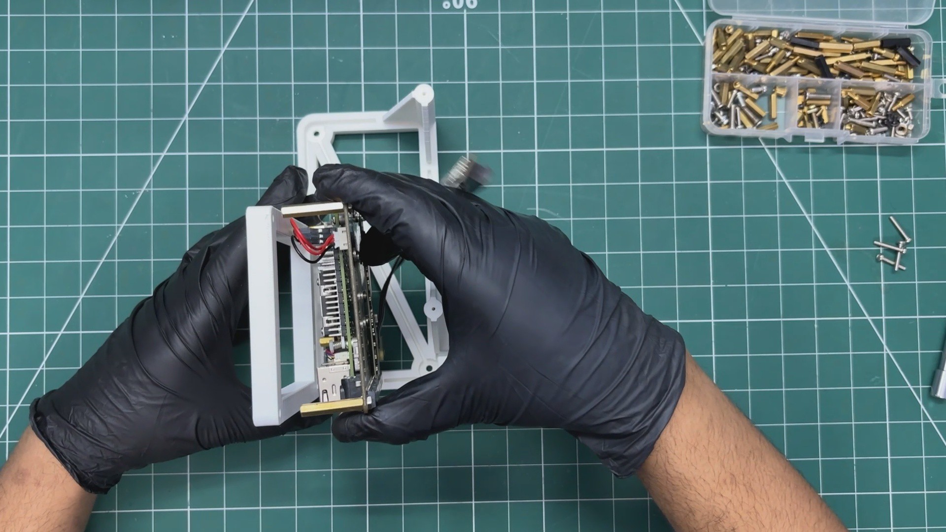

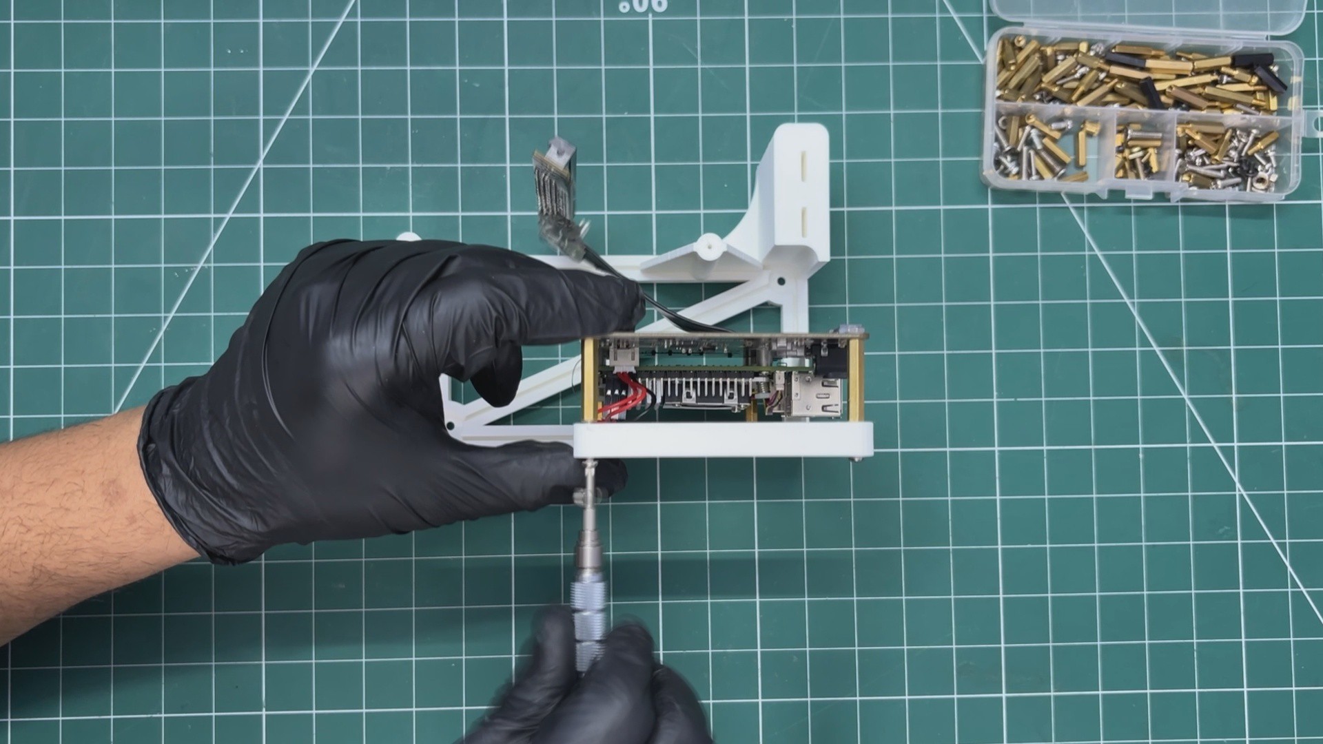

Pi FRAME ASSEMBLY
The Pi frame assembly begins by placing the Raspberry Pi 5 and Waveshare board setup onto its mounting position on the frame. We align the PCB standoff holes with the mounting holes on the frame, then use four M2.5 bolts to secure the assembly in place.
Next, we position the PCIe x16 to M.2 adapter in its designated location. We align it with the mounting holes and use two M2 screws to fasten it securely.

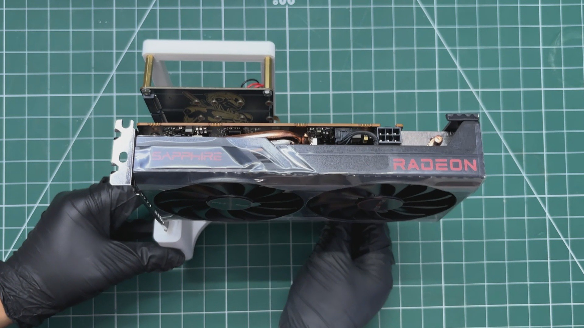

Finally, we place the GPU into position, insert it into the PCIe x16 slot, and secure it in place, completing the setup.
