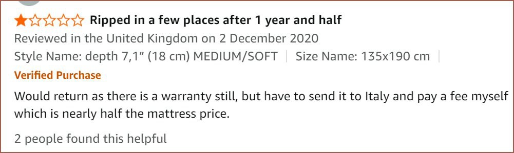

    Staring at the price of the Sevenlife 18 latex mattress in the checkout window, I decided to hone in my Google-Fu to further uncover any additional information and options. The first thing I found was an Amazon listing, and while the vast majority of reviews were positive, there was one 1-star review (from almost 6 years ago) that stood out:
    My whole justification for such a £600 mattress was that it would outlast other options. A 10-year warranty is meaningless if it's financially infeasible to make a claim.

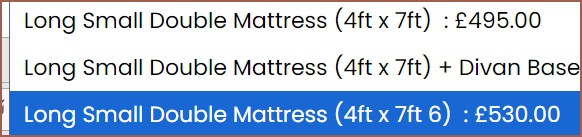

    I continued to look for "7 ft" and longer mattresses and found Bed Cloud, a company that makes mattresses in 1/4 ft increments up to 7 feet at prices much closer to those found on Amazon:
    I believe that for discoverability, they list all their mattresses in centimeters and feet. They also have free shipping.

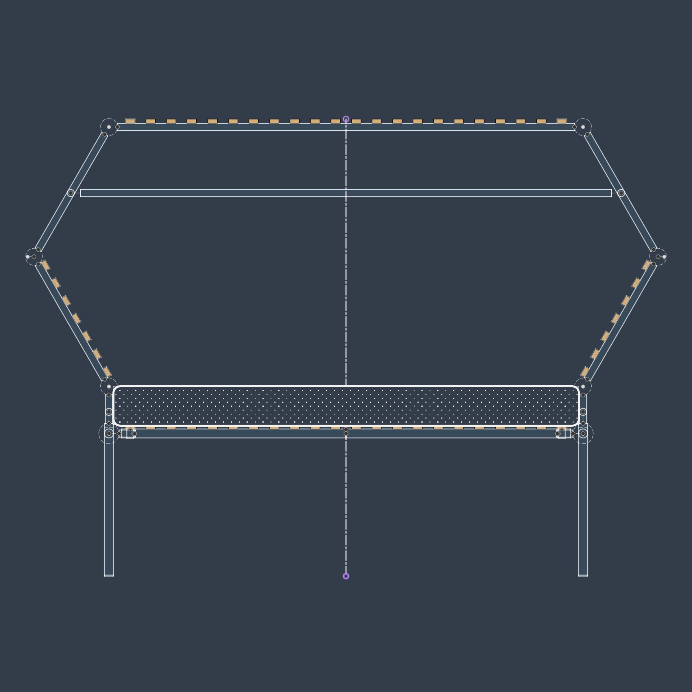

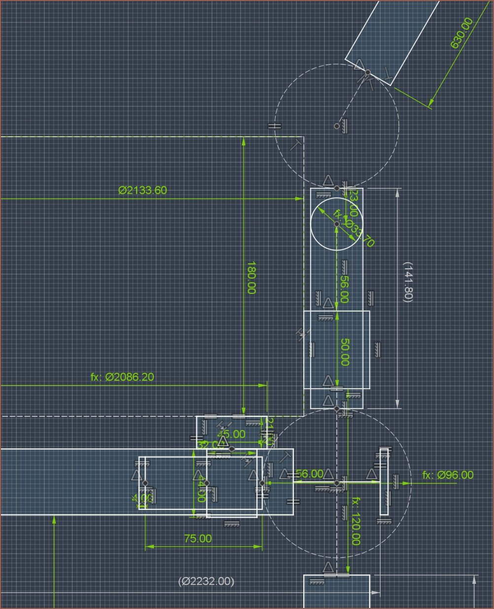

    It took a bit of effort to rework the frame to use a Three Way Outlet instead of a Three Way Through to be able to shave off the 7 cm I needed, in part due to Fusion sketch solving issues I had to track down and resolve. There is a minimum 100mm tube cutting length, so that's why there's a vertical 75mm and horizontal 50mm tube instead of them being shorter.

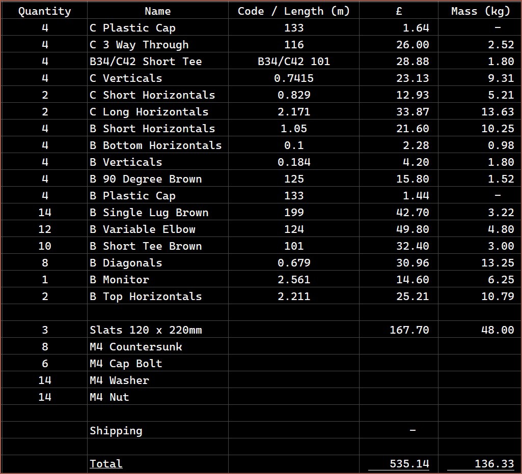

    The price of the frame increases by around £12, now £549, but the mattress savings can entirely pay for a new monitor and still have hundreds of pounds left over.

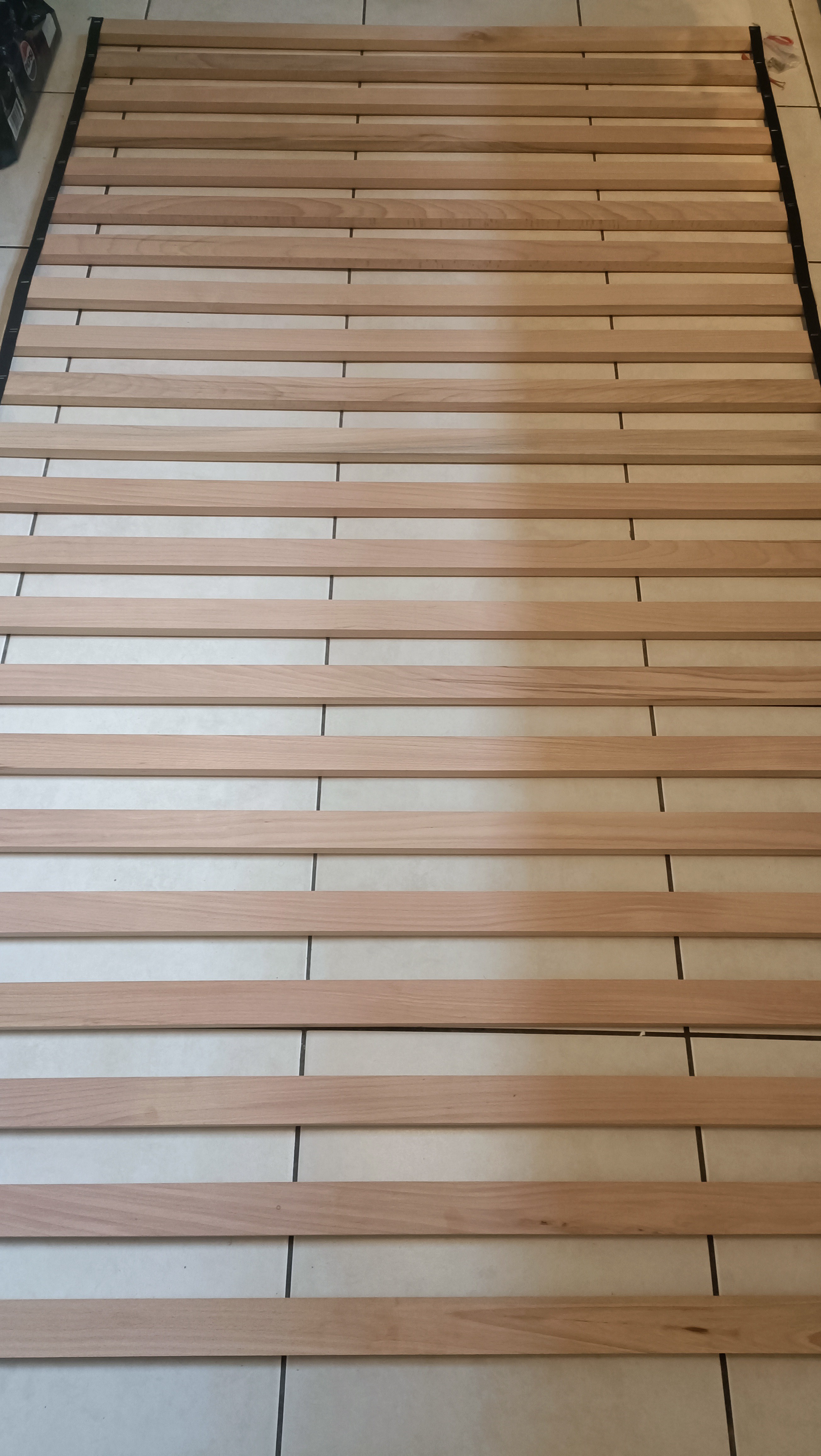

    The main reason why I bought this ahead of time was because of the discrepancies I saw between the listing and my CAD model. For example, the listing title said there are 22 slats but the image has 23.

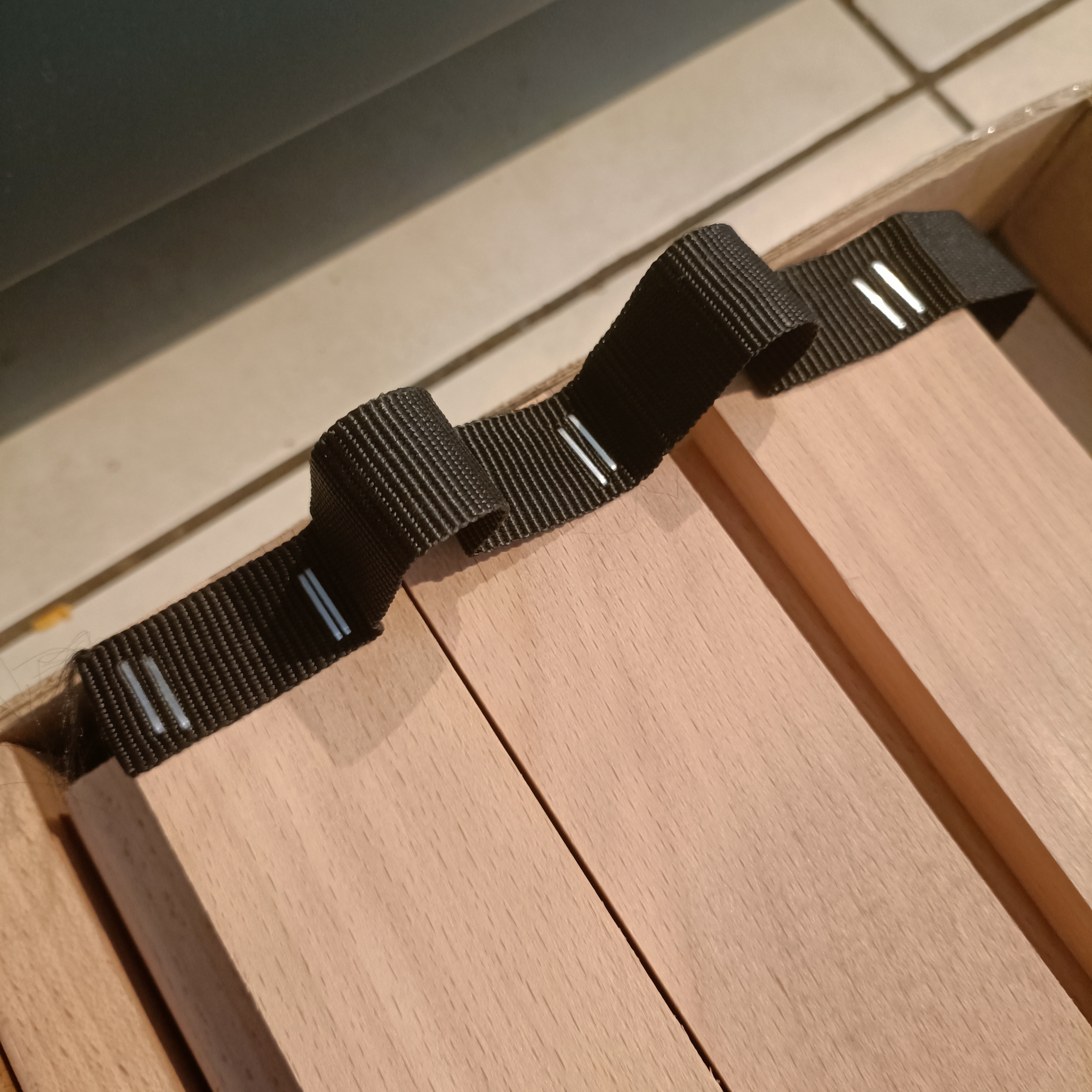

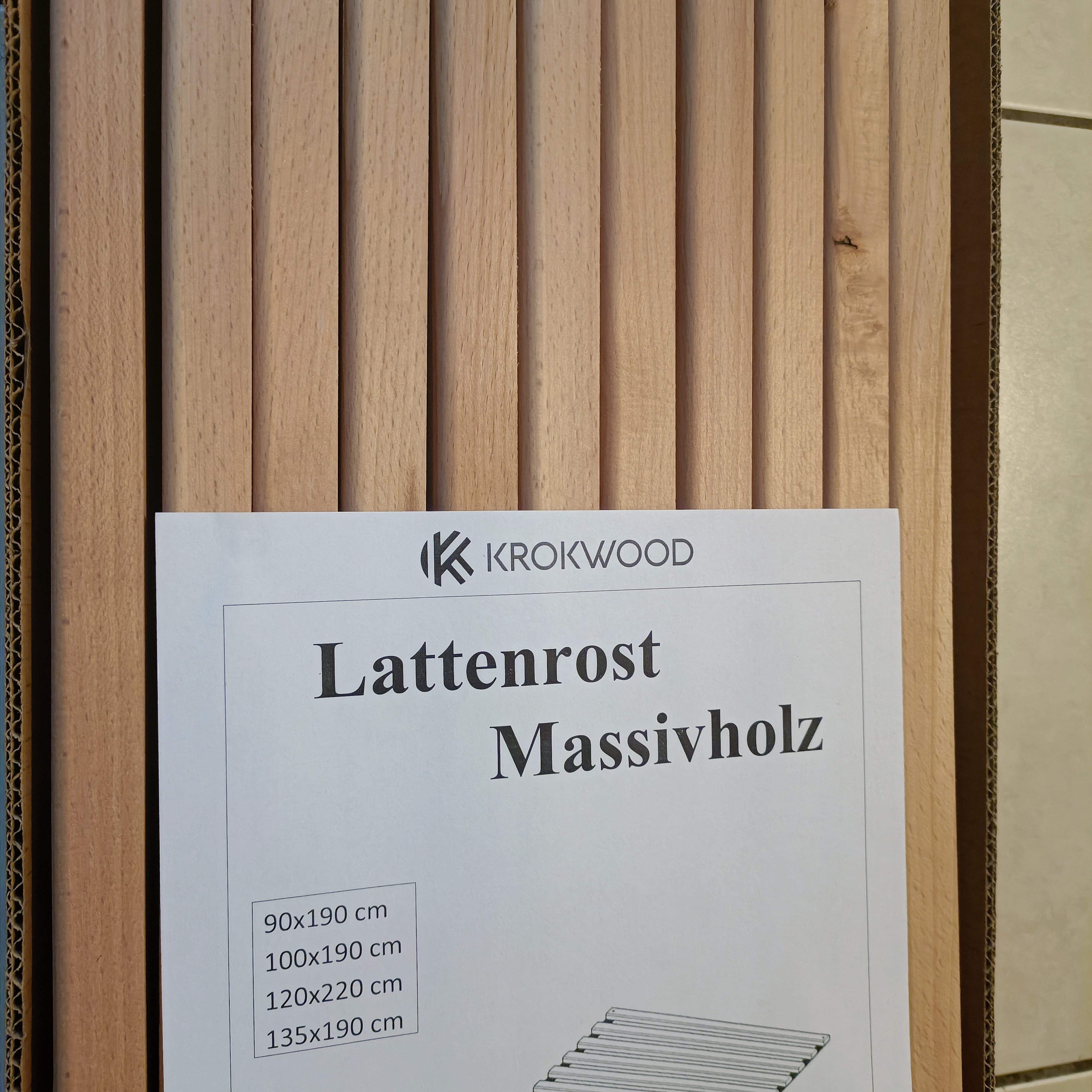

    I opened the box -- which stated it was 19kg by the way -- and as I expected, they have used some rather nice looking wood for bed slats. They've even filleted the faces that come in contact with the bed. I feel it's a little bit of a shame that, for most buyers, wood this good is literally stuffed under their mattress.
    The first slat is the only one that's stapled 4 times on each side. The remaining are only stapled twice and I believe the reason is so that it can be packed in the box.

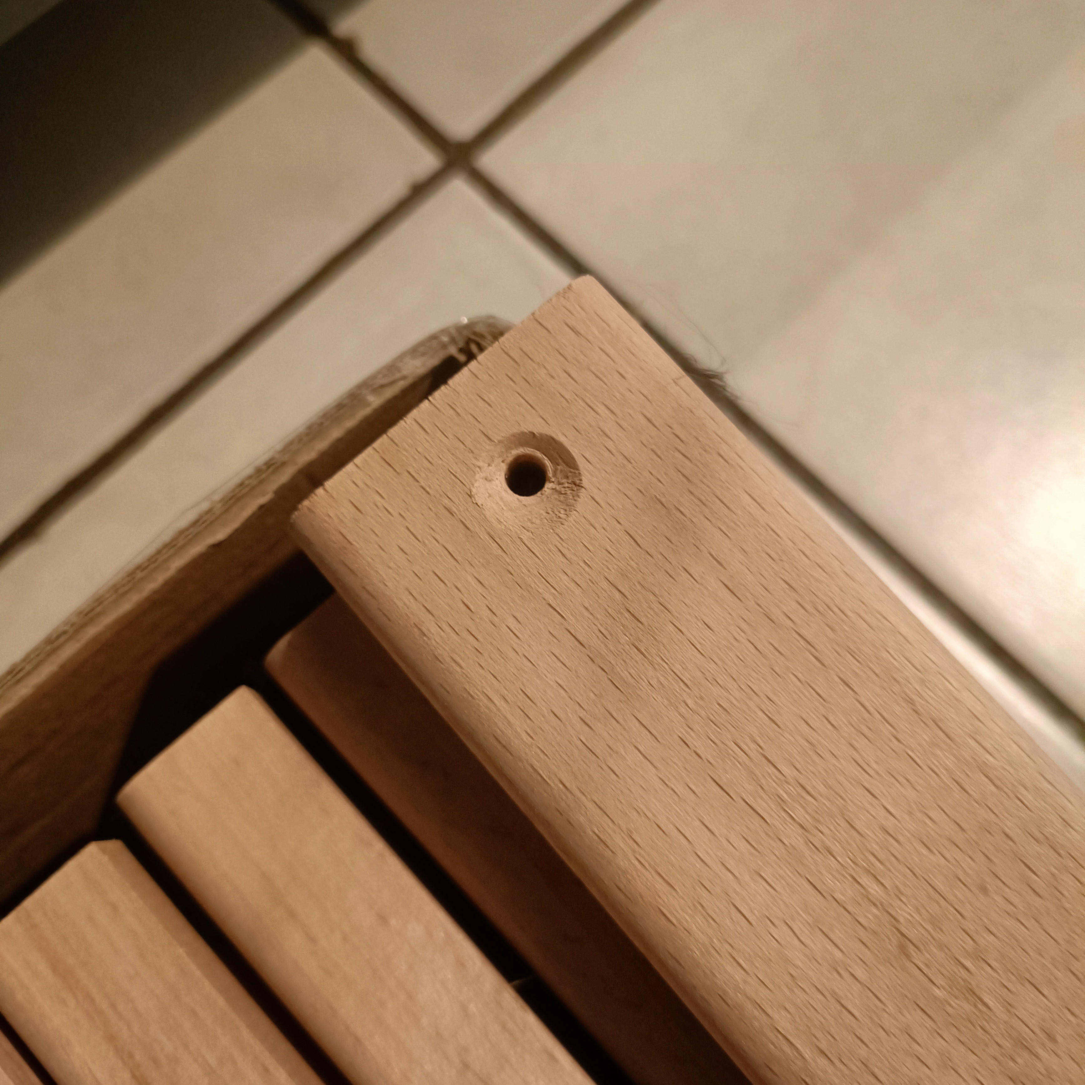

    The hole is 4.2mm and I measured 12mm from this edge to the centre. It was 13mm on the other side and the slat was 1199mm, so I'm going to assume the holes are 1175mm +/- 1mm.
    I unpacked them all and measured 2086 - 2087mm from front to back. I counted 22 slats. Assuming a nominal 45mm slat, I've used 52.2mm as the spacing distance in Autodesk Fusion.
    Due to such measurements, I've been able to streamline the design and make a BOM list:
    I'm going to use 6 mounting points for the wooden roof since the tubing is closer to the edge and they're not weighed down by a mattress. I'm also going to try and see if plastic end-caps can be used as feet. For the weight, I have used 16kg as claimed on the listing.

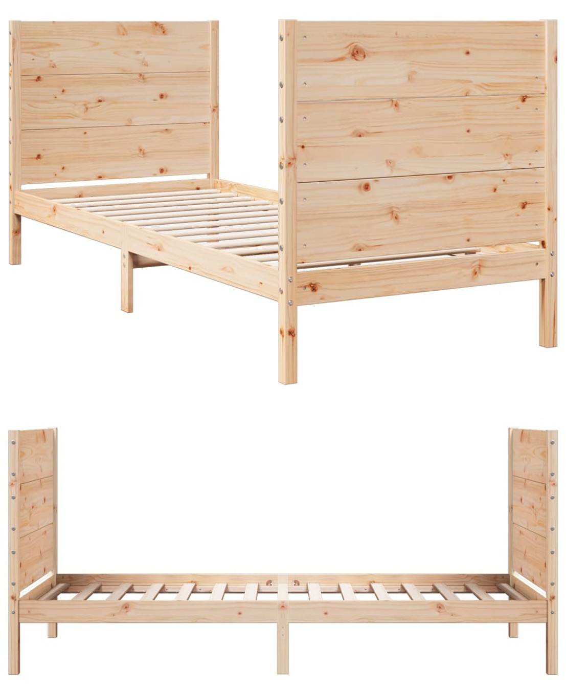

    Sitting on the bed means that there needs to be a backrest, thus I searched with that in mind. I soon found that vidaXL sells a variety of 220cm wooden frames, and I liked the one below:
    What would be even more ideal, however, is a bed frame that has a headboard on both sides so that I have the flexibility to change seating positions. The frame looked otherwise symmetrical, so an idea I had was to buy 2 frames and combine them to form:
    Coincidentally, vidaXL provides the right kinds of images to produce this by cropping. No AI needed here.

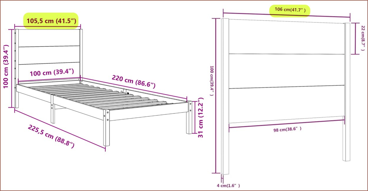

    As they sell a frame without the headboard, I could compare prices. The bare frame is £45 and a single headboard is £97, meaning the headboard alone doubles the price. This strategy further doubles the price. I found that they seem to sell the headboard separately, but with the unusual discrepancy that it's 106cm wide instead of 105.5cm:
