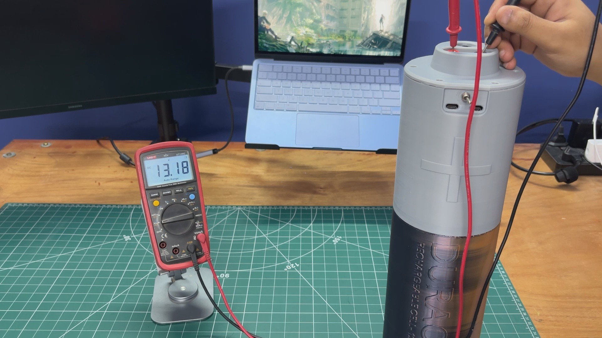

To verify that everything was assembled correctly, I measured the output voltage of the completed parallel cell holder using a multimeter. The measured voltage was approximately 3.27V, confirming that all six cells were properly connected in parallel and the assembly was functioning as expected.

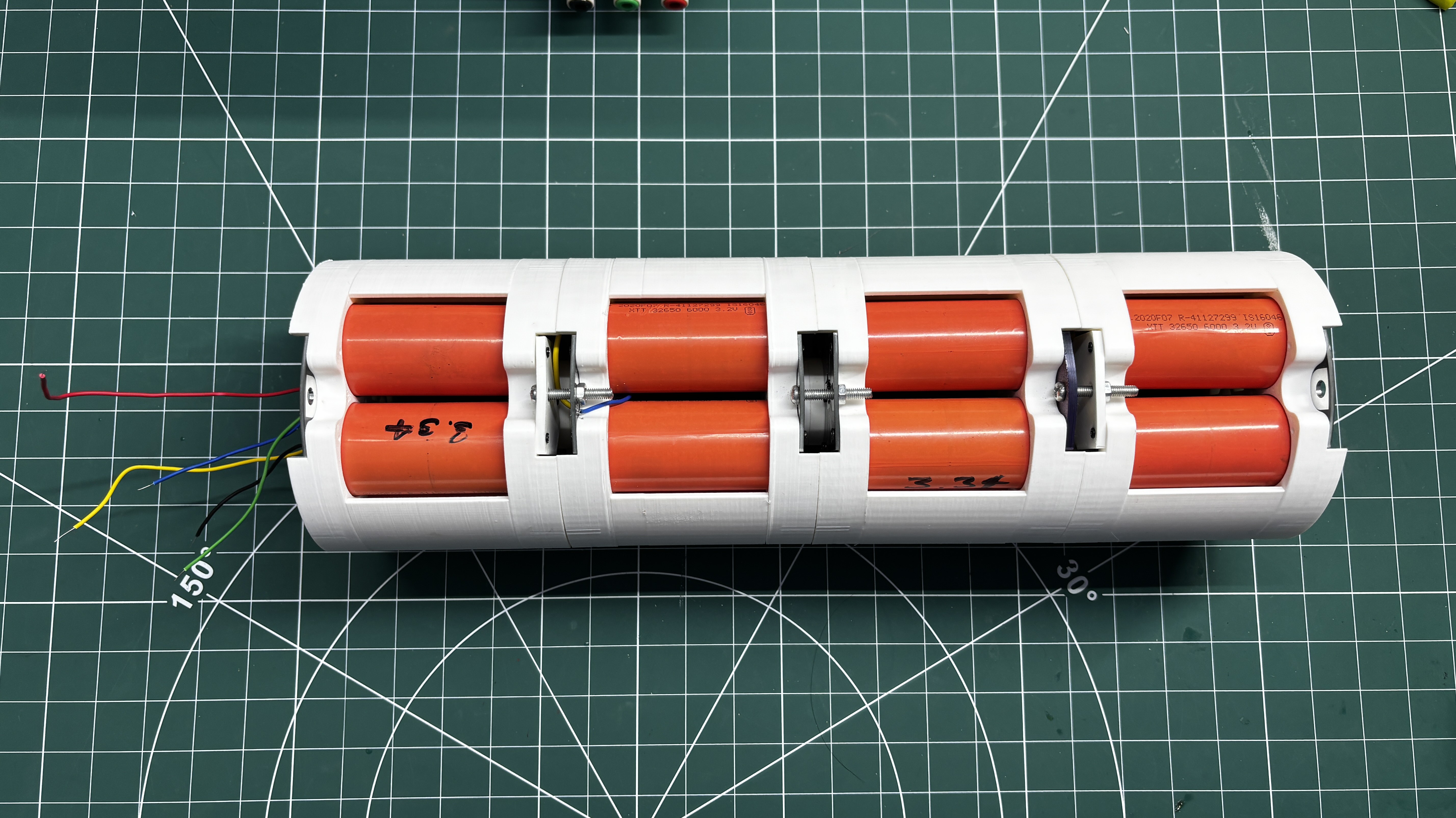

Since the final battery pack requires four identical parallel cell holders, I repeated the entire assembly process three more times until all four modules were complete and ready to be connected in series.

COMBINED PACK ASSEMBLY

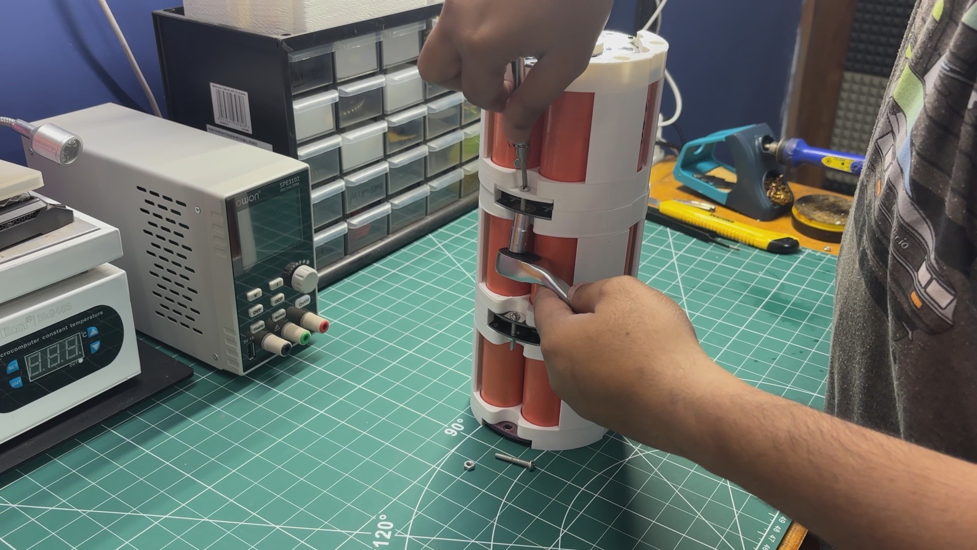

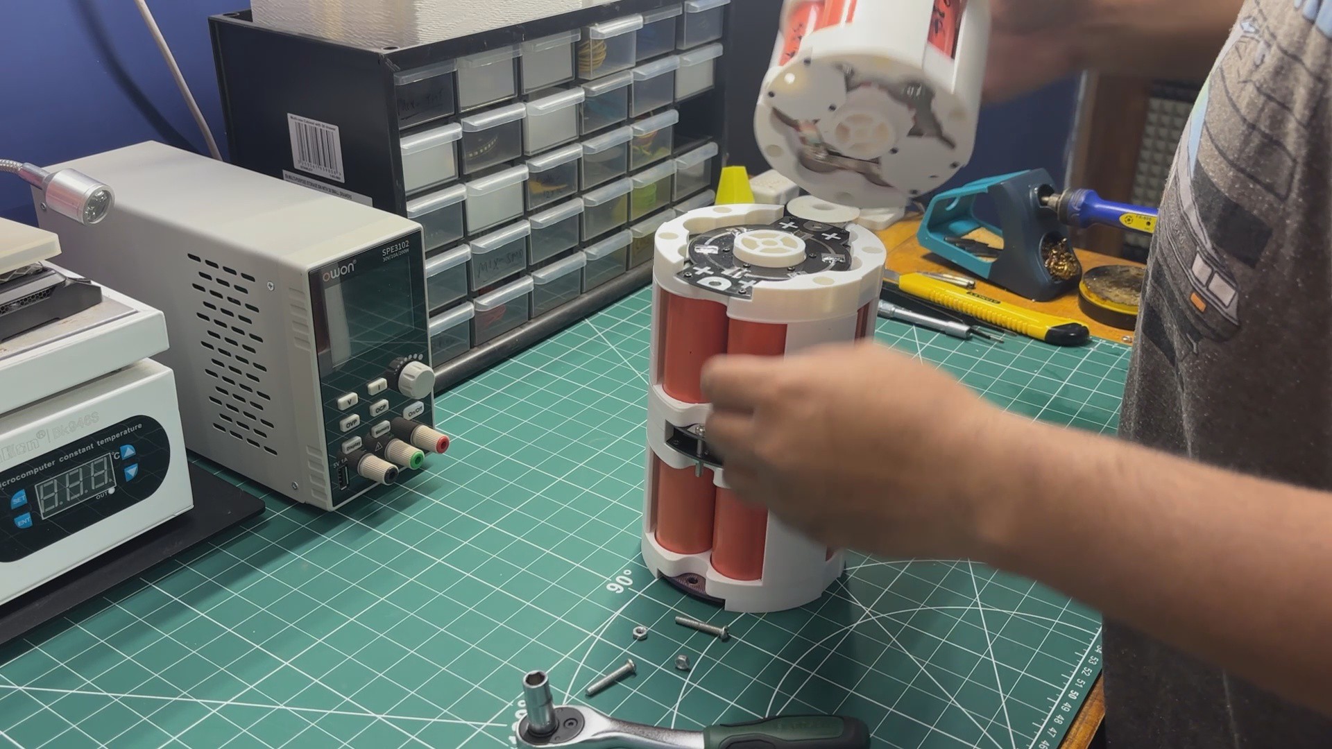

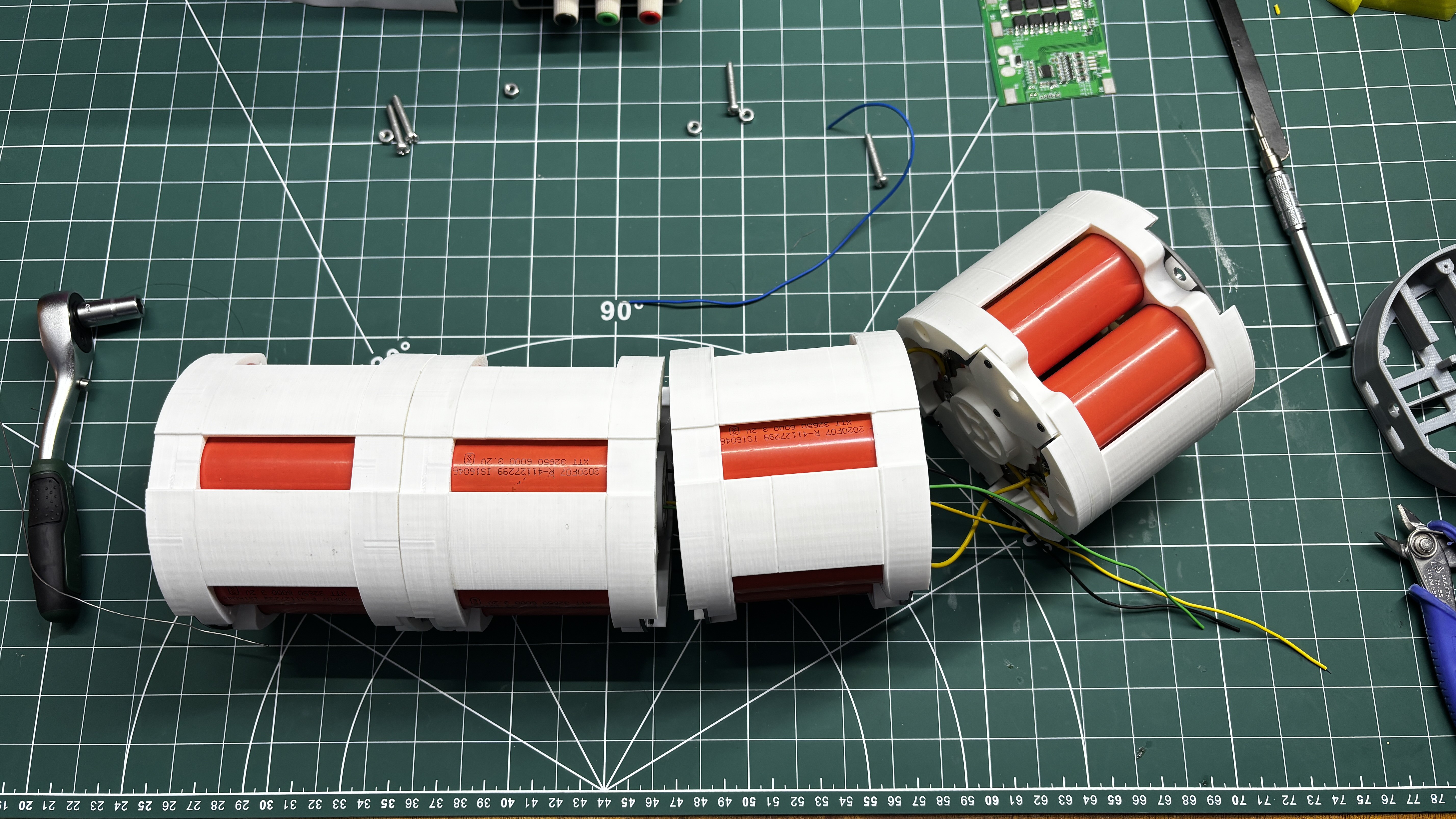

Now comes the main assembly of the battery pack.

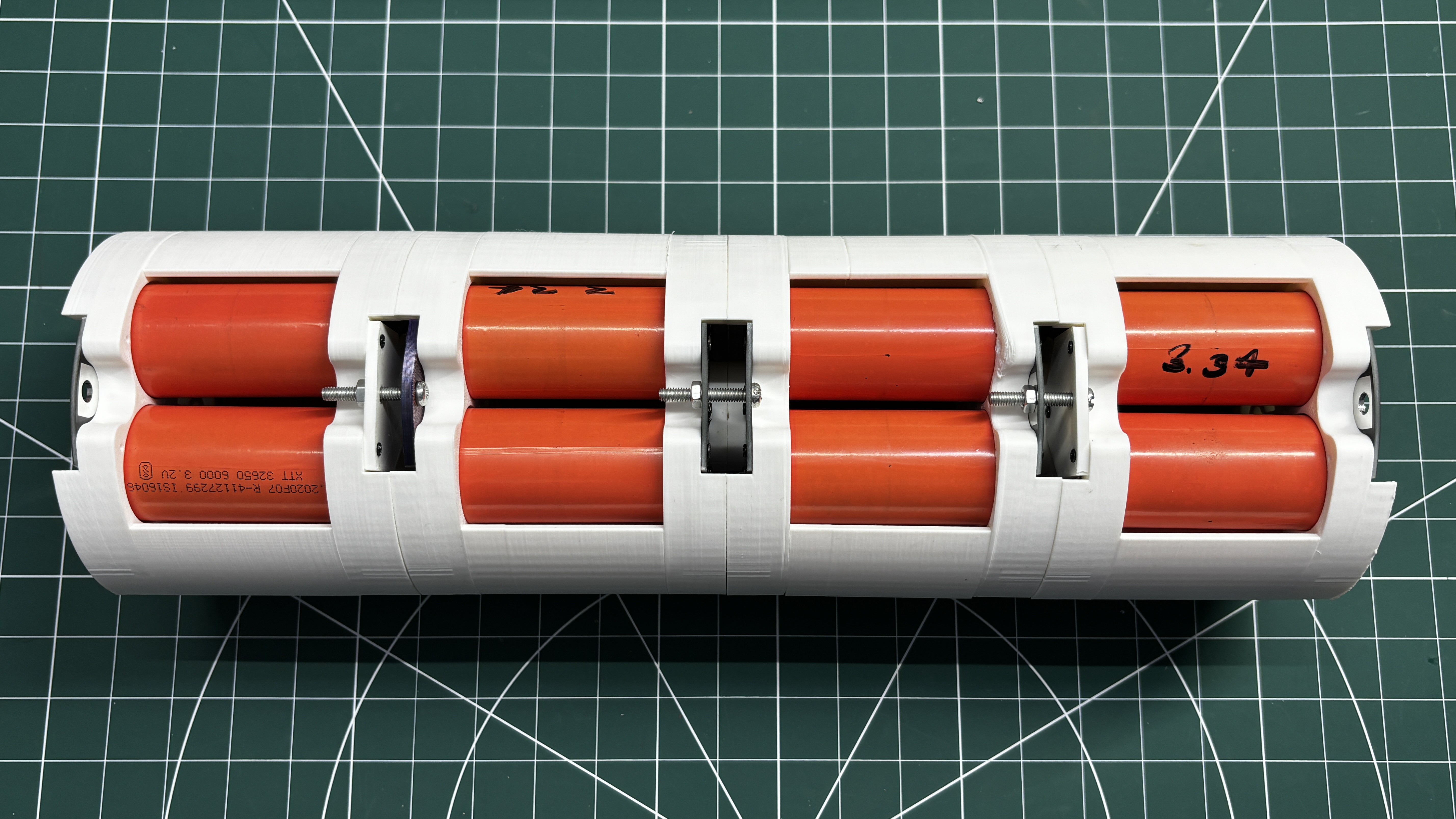

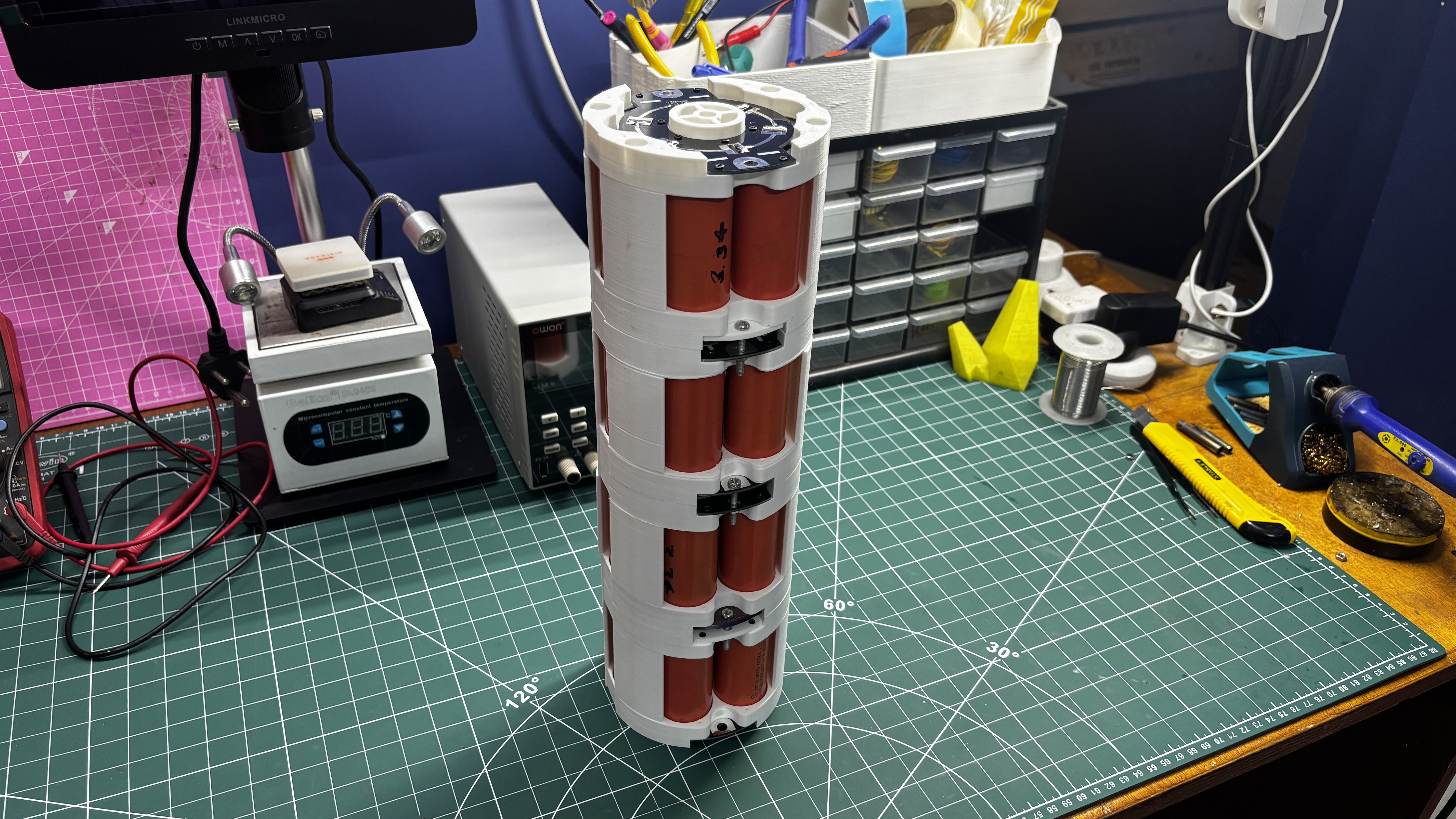

The process begins by stacking all four parallel cell holders on top of one another in the correct orientation, as shown in the assembly diagram.
To electrically connect the four modules in series, M4 nuts and bolts are used to fasten the connection PCBs together. These connections link the positive terminal of one parallel pack to the negative terminal of the next, completing the 4-series (4S) configuration.
Once all four modules are connected, the battery pack has a nominal output voltage of approximately 13.3V. The positive output terminal is located at the topmost cell holder, while the negative output terminal is located at the bottommost cell holder, making these the main output terminals of the completed battery pack.

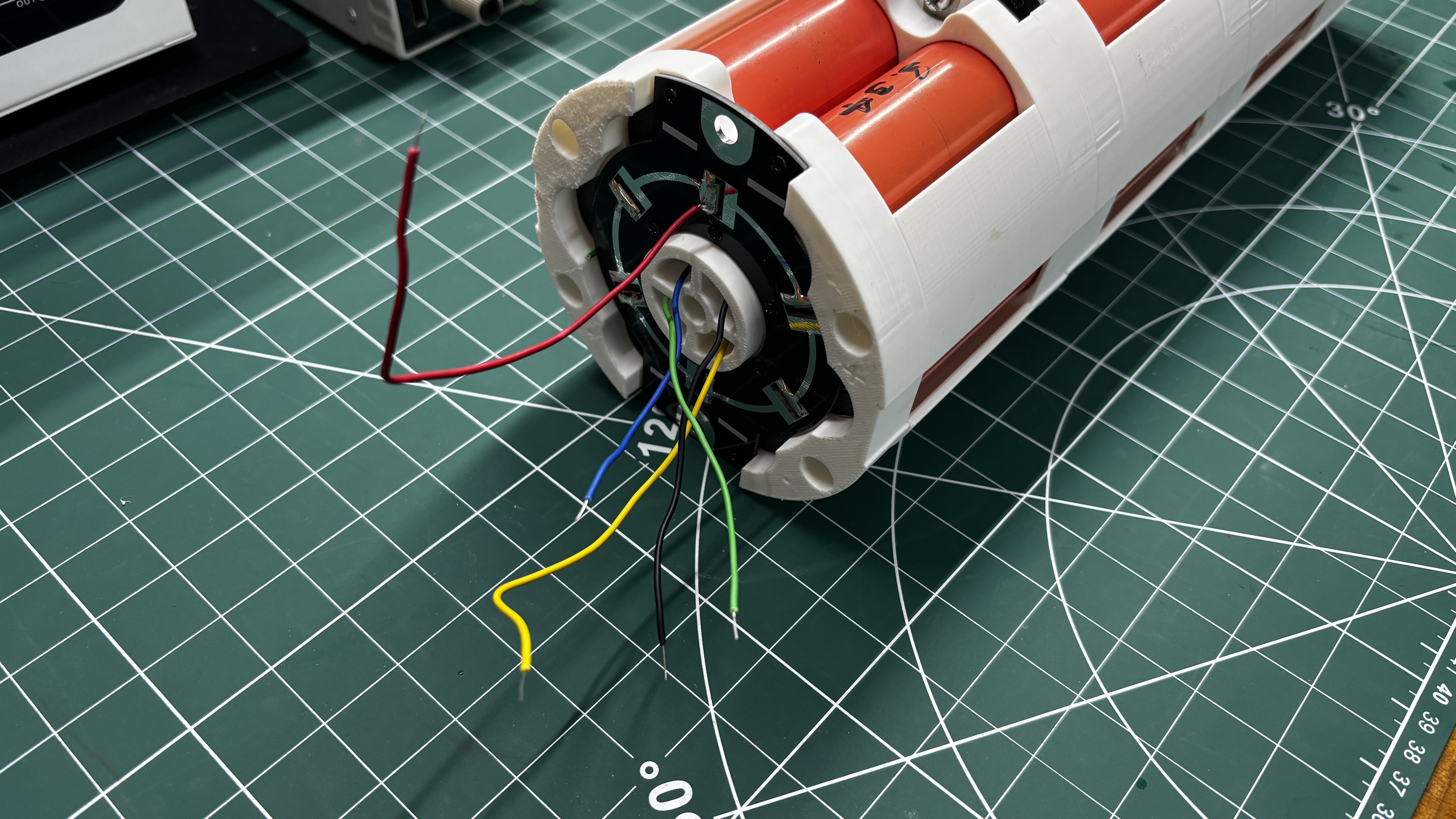

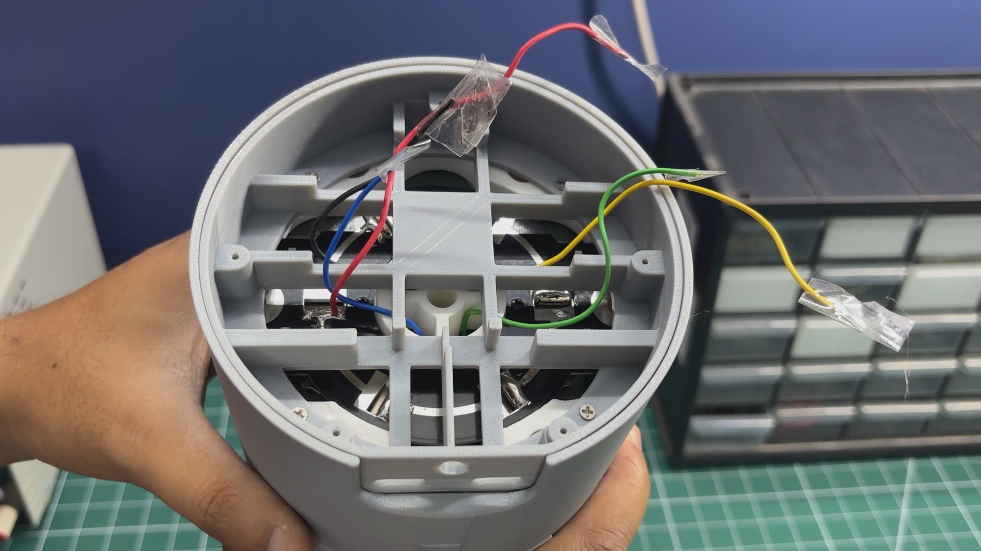

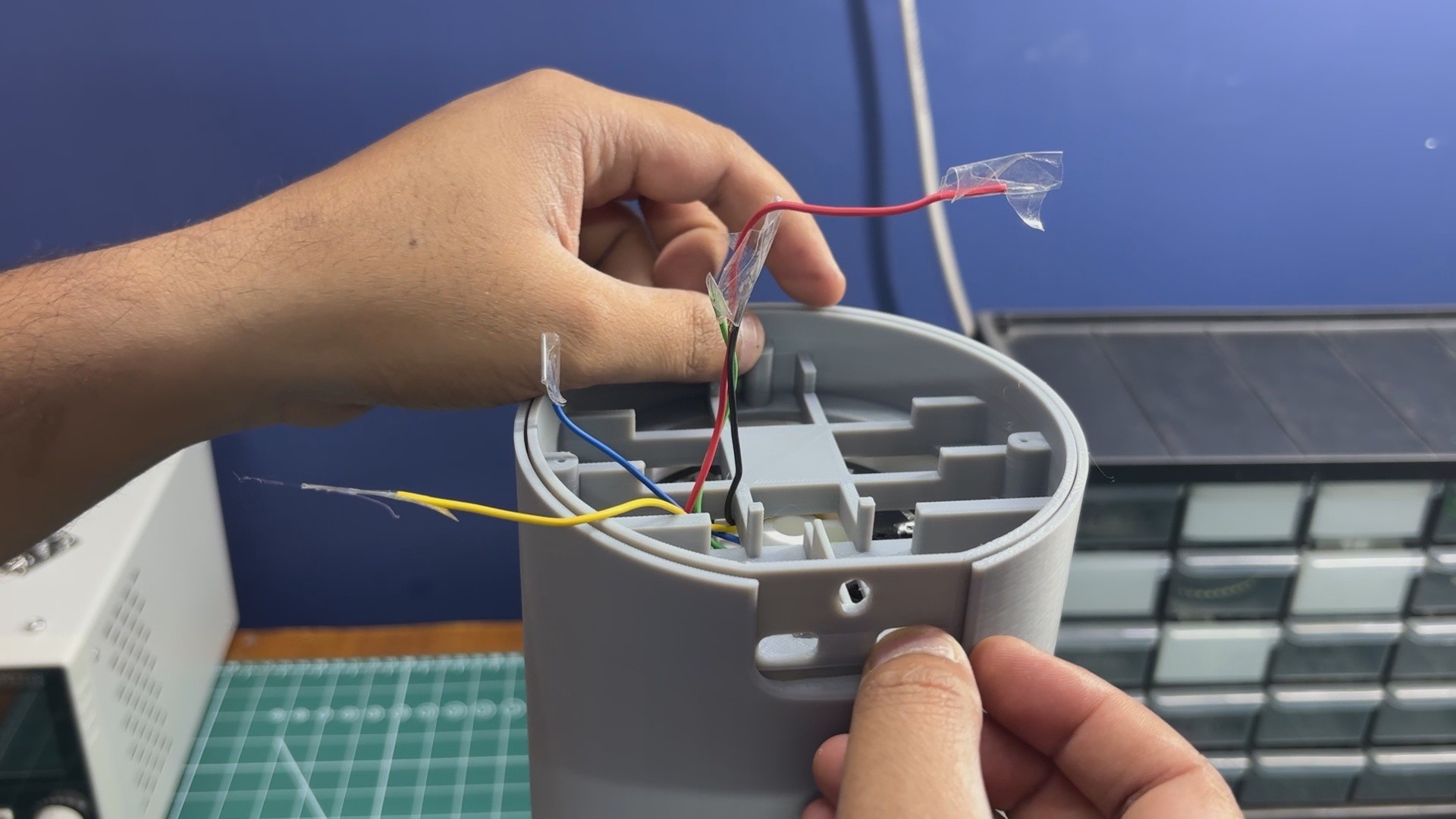

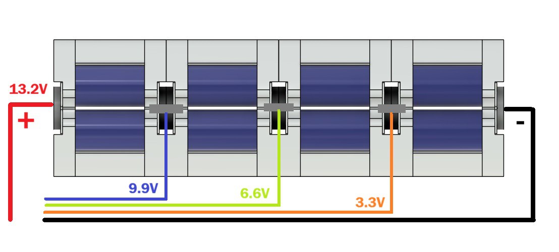

We begin the wiring process by connecting wires to each parallel cell holder according to the provided wiring diagram.
The wires are soldered to the connection PCB of each parallel pack and then routed through the opening in the center of the cell holder. All of the wires are passed through this central opening, where they will later be connected to the BMS.
For the power connections, I am using 16 AWG single-core copper wire, which is capable of handling currents well above the requirements of this project while keeping voltage drop and heat generation to a minimum. Using thicker wire also makes the battery pack more reliable when powering higher-current loads.

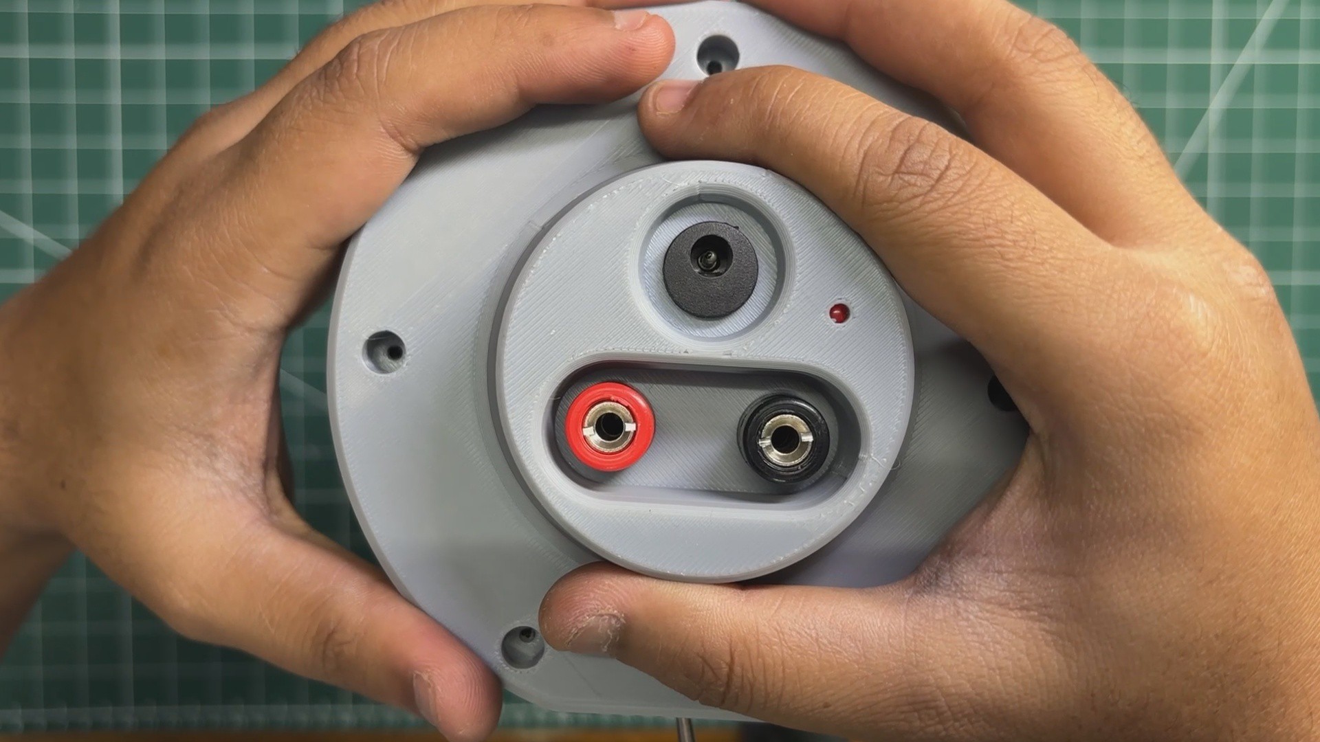

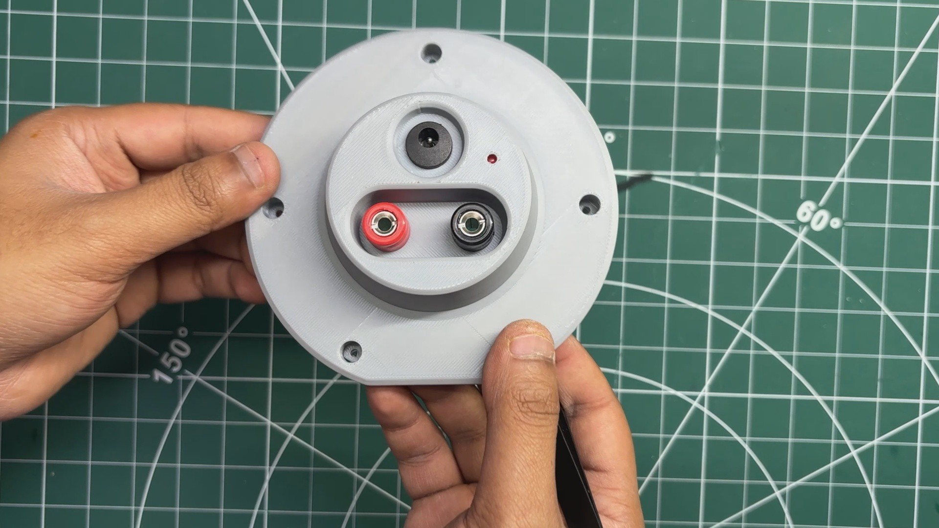

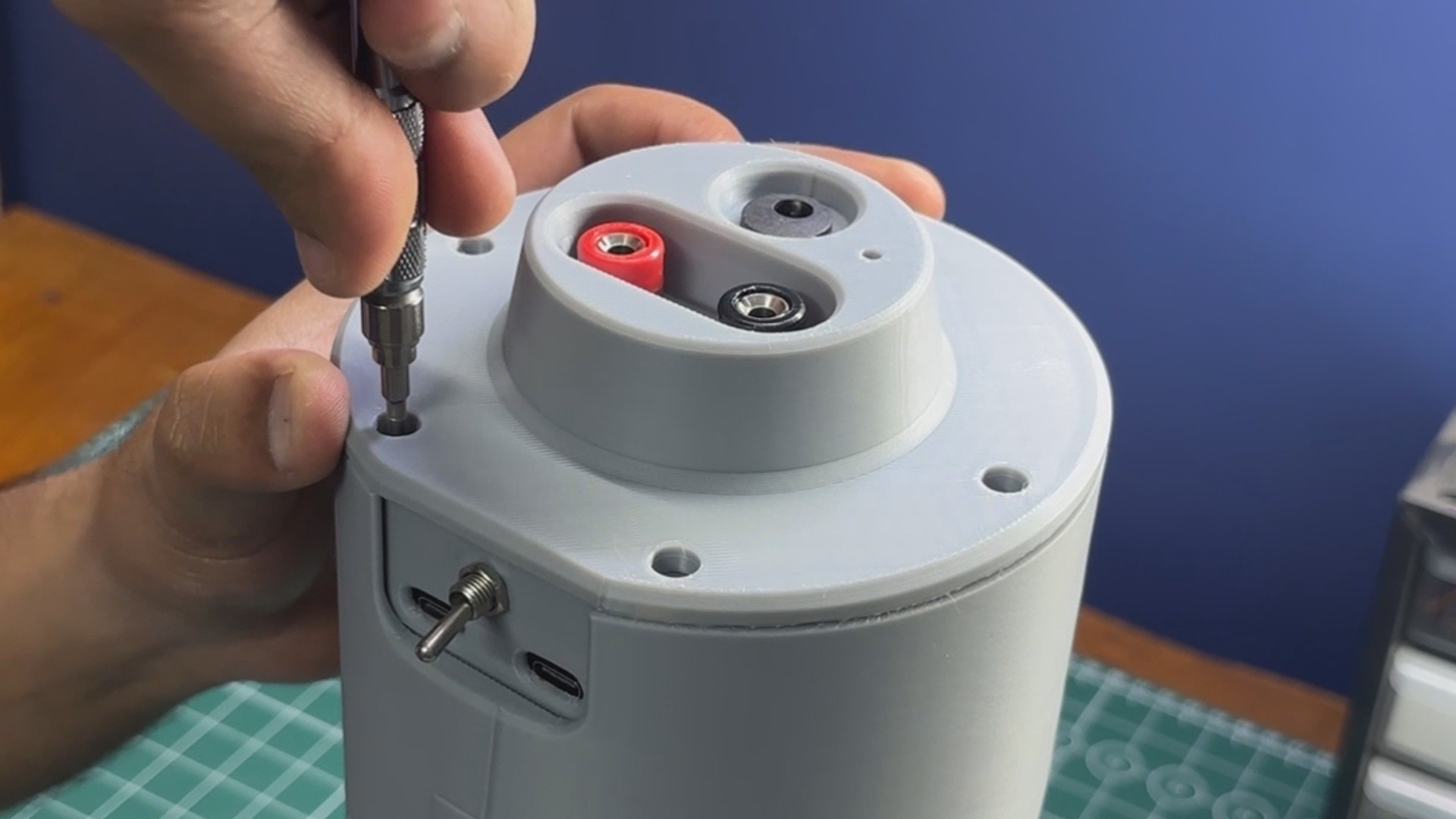

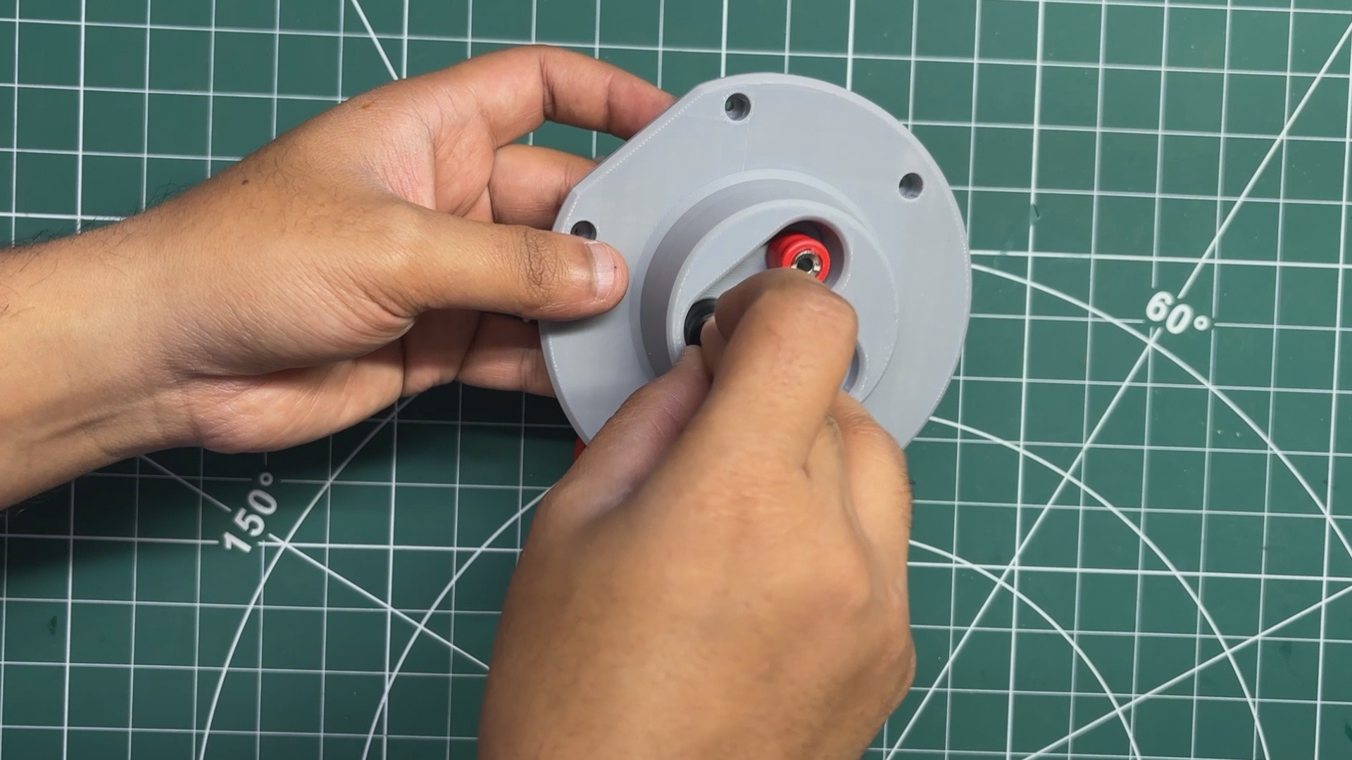

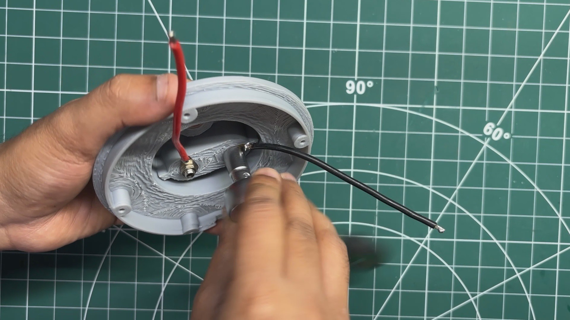

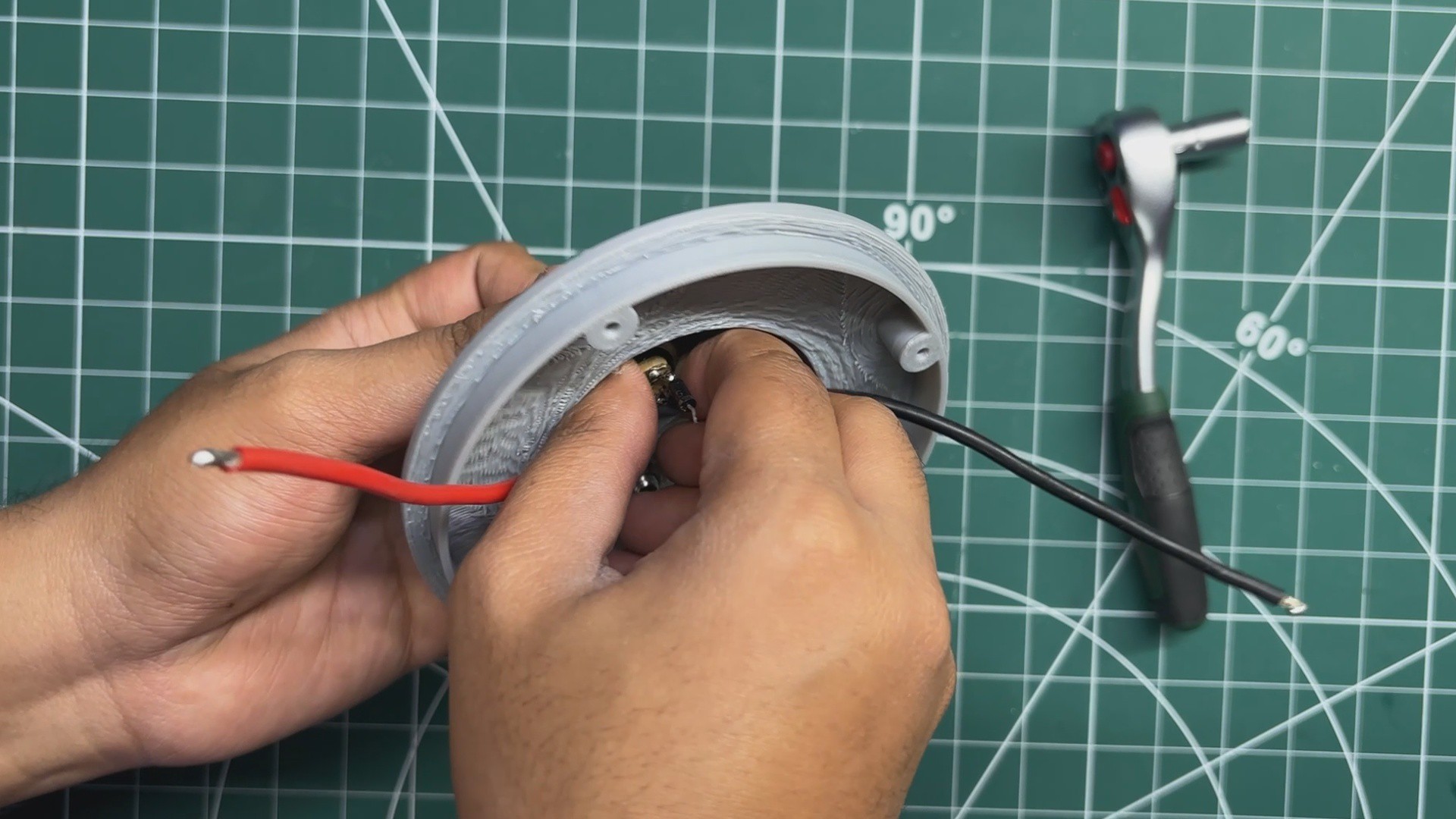

The assembly of the top cover begins by installing the red and black banana connectors into their respective mounting holes. Both connectors are inserted from the outside of the top cover and positioned correctly.
Next, a red and a black wire are soldered to the solder lugs of the banana connectors. The wires are then routed through the openings inside the top cover, and the supplied mounting nuts are tightened to securely lock both banana connectors in place.
The DC barrel jack is installed next and secured using its supplied mounting nut.
For the wiring, the VCC terminal of the DC barrel jack is connected to the cathode of an SR206 Schottky diode, while the anode of the diode is connected to the red banana connector. The GND terminal of the DC barrel jack is connected directly to the black banana connector.
Next, a 3mm LED is installed in its mounting hole. The anode of the LED is connected to the VCC terminal of the DC barrel jack before the diode. This ensures that the LED only illuminates when a charger is plugged into the DC jack.
Finally, a 10kΩ resistor is soldered between the cathode of the LED and the GND terminal of the DC barrel jack, completing the charging indicator circuit.

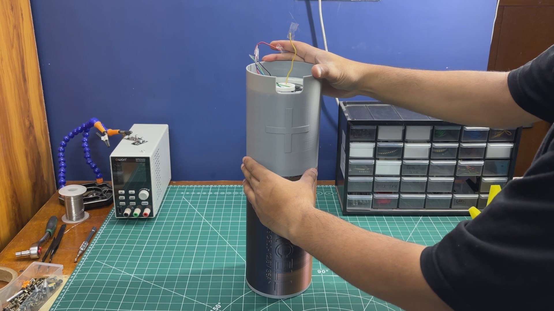

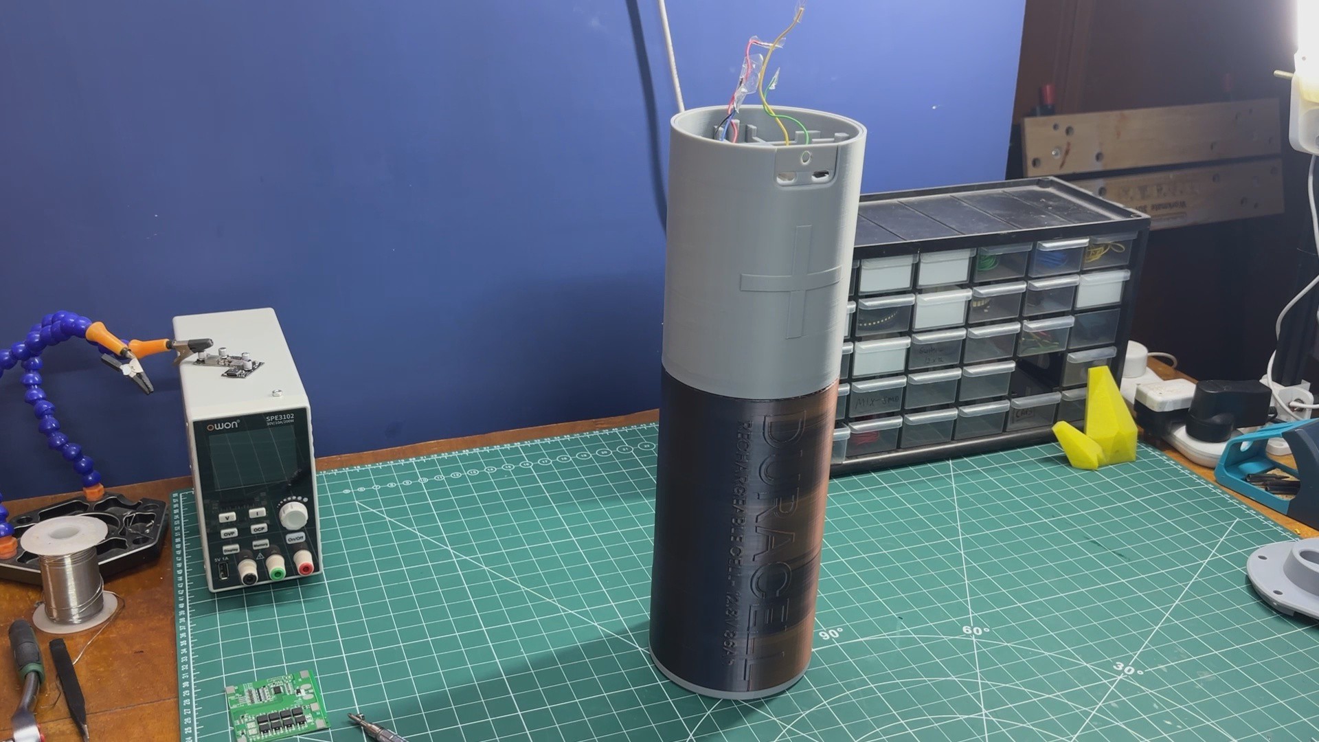

We begin the outer shell assembly by placing the base onto the bottom of the battery pack and securing it using four M2 screws.

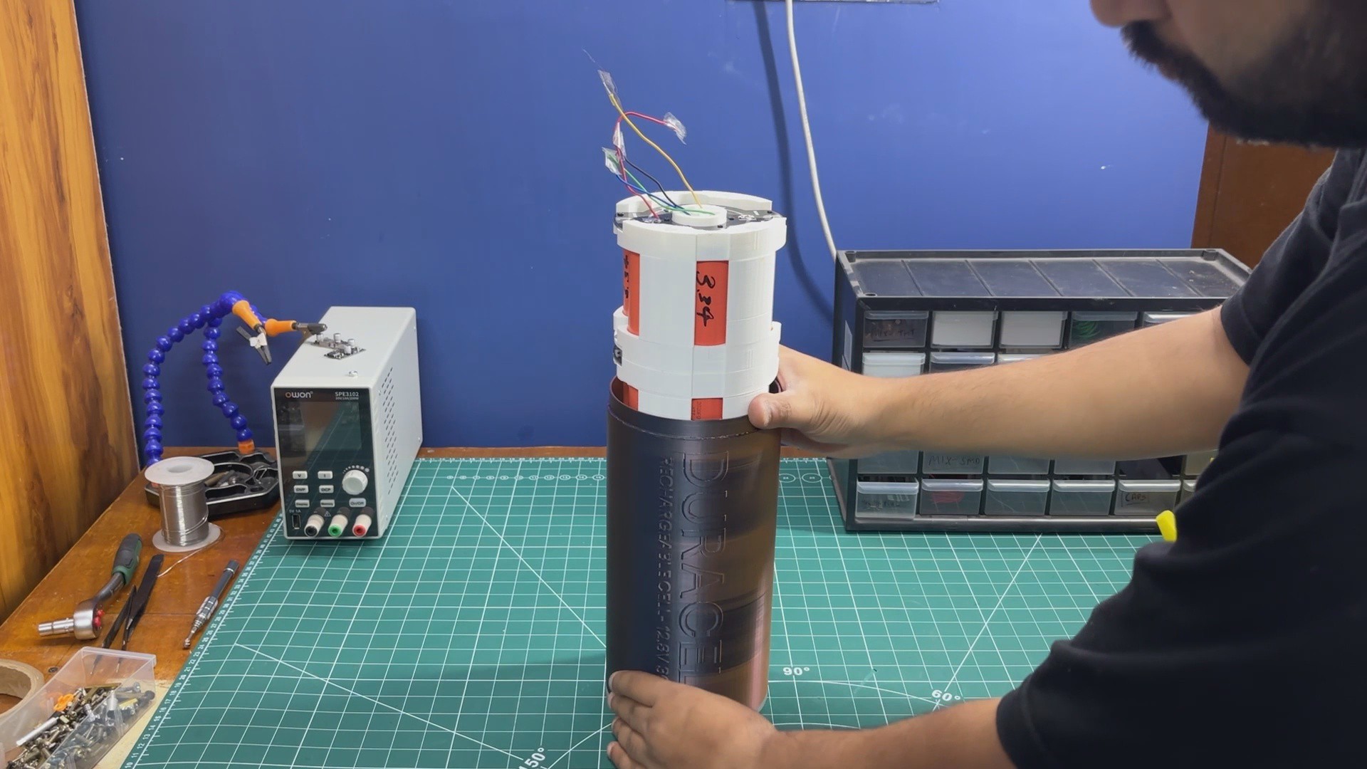

The battery pack is then turned over, and the Duracell shell is slid into position over the cylindrical battery pack. Once the Duracell shell is in place, the upper shell is also slid into its designated position.

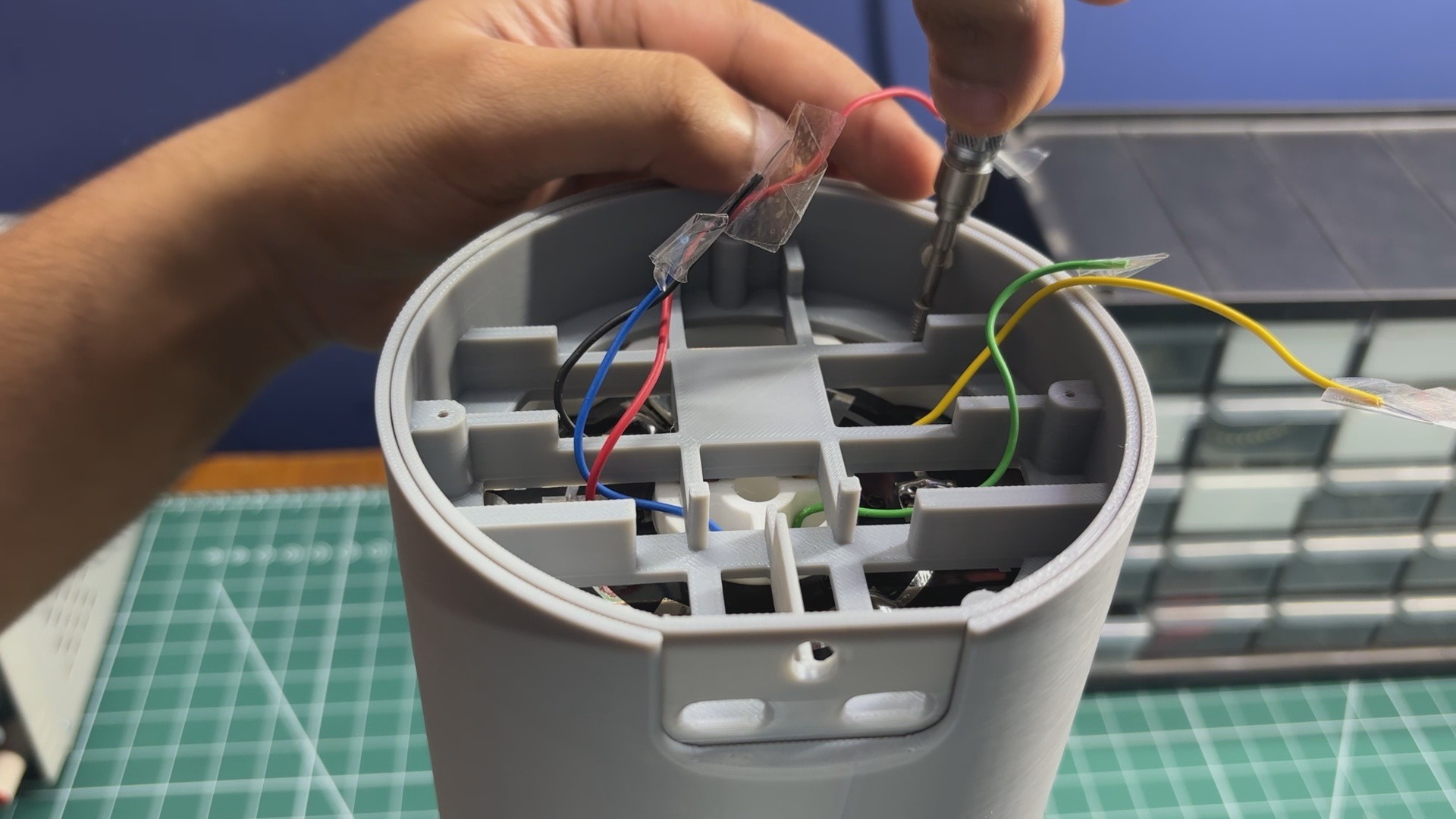

Next, the inner support is installed at the top of the battery pack and secured using M2 screws. This inner support not only provides a mounting point for the electronics but also locks the upper shell and Duracell shell in place, keeping the entire outer enclosure securely assembled.
8
FINAL ASSEMBLY

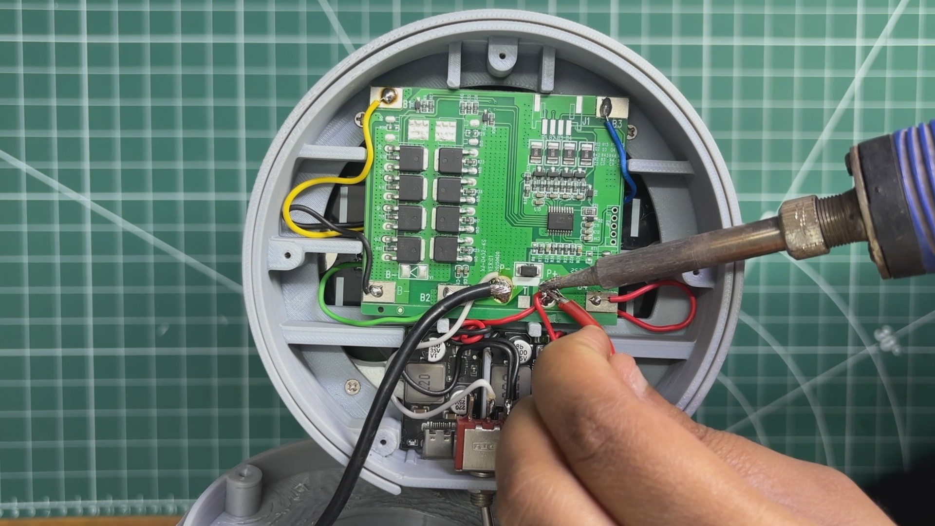

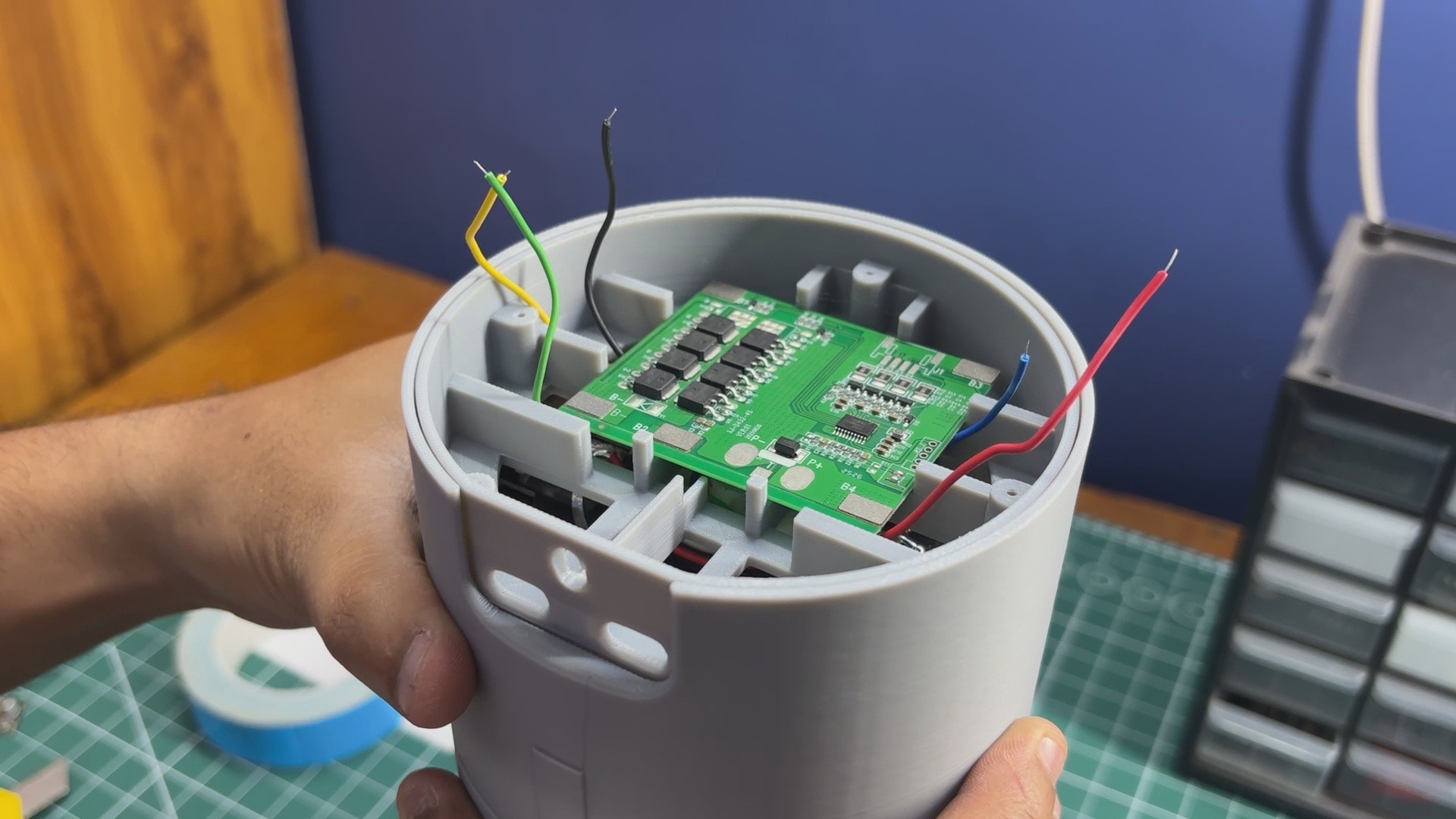

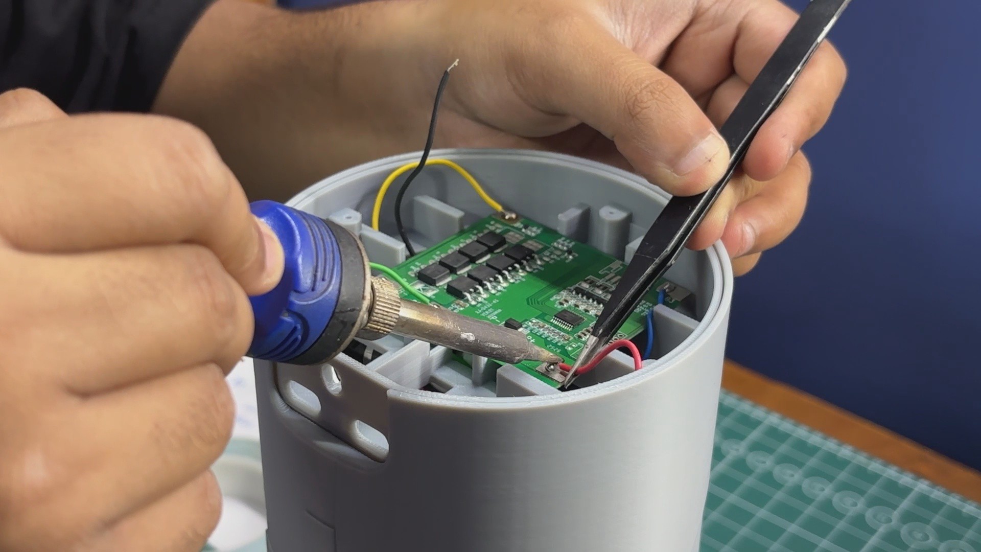

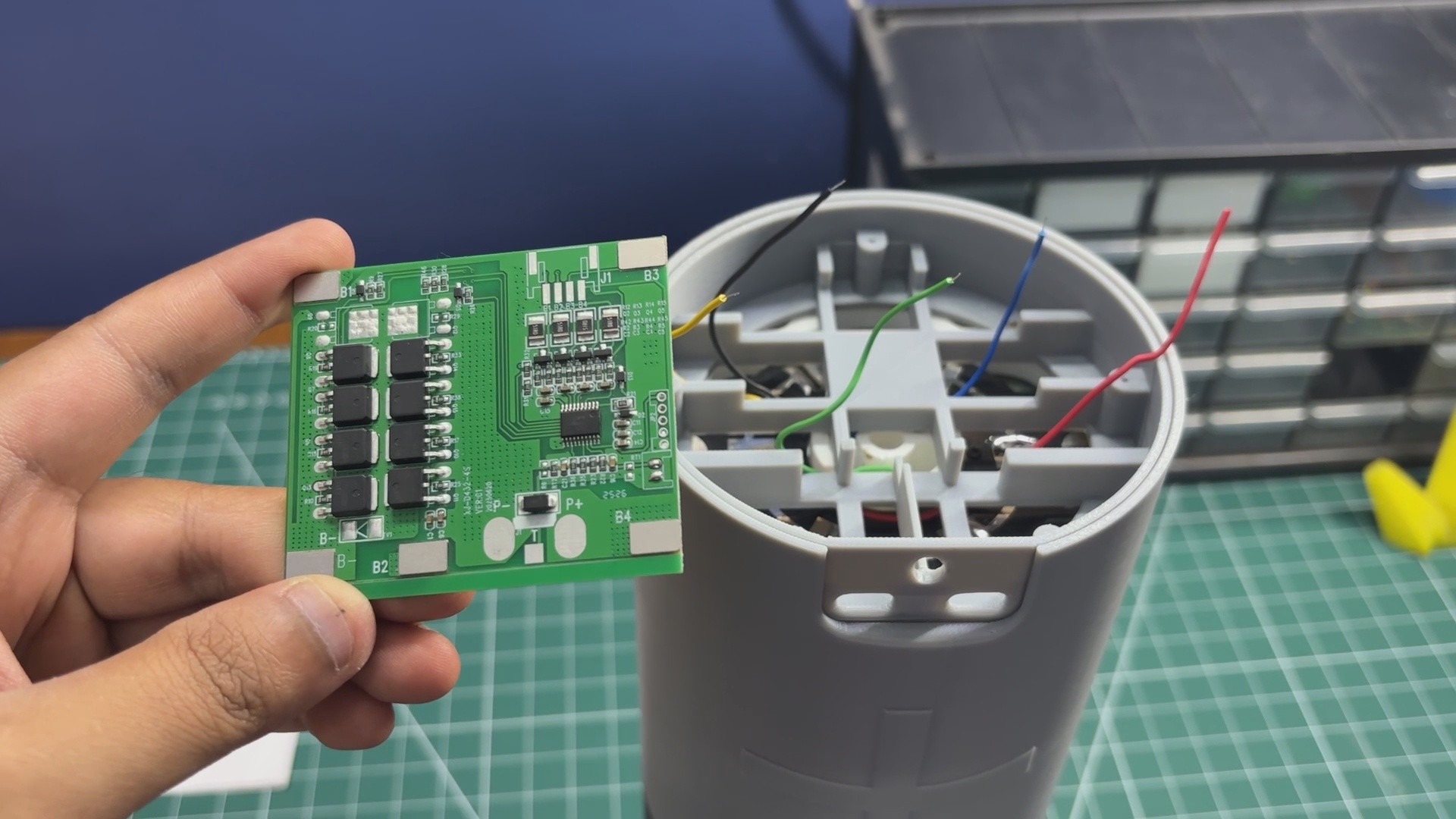

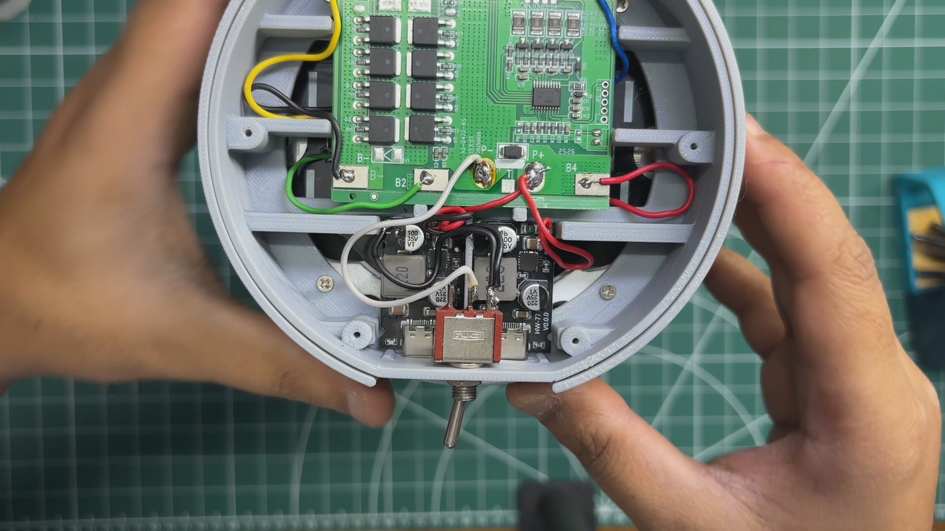

We begin the final assembly process by mounting the BMS inside the inner support part. To secure it in place, I applied a piece of double-sided thermal tape and then placed the BMS on top. The thermal tape keeps the BMS firmly attached while also helping transfer heat to the mounting surface.

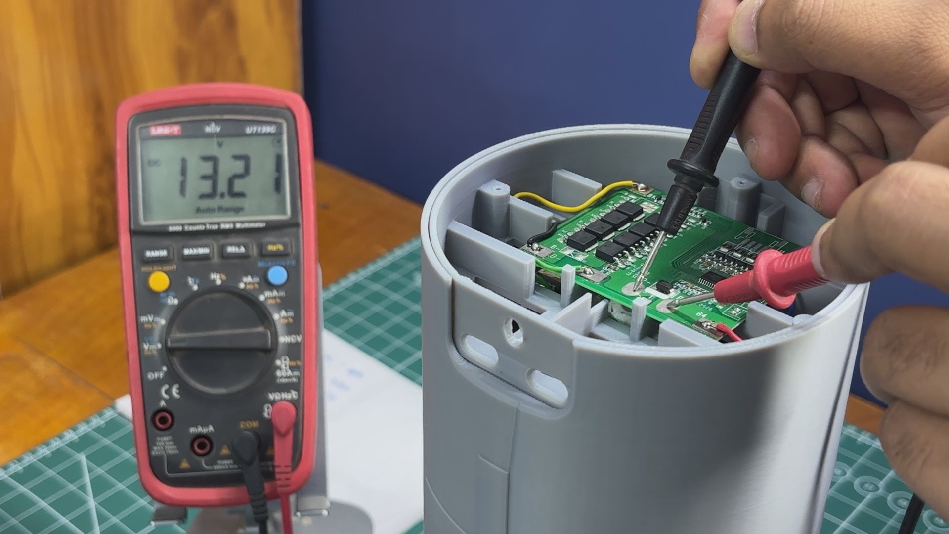

Next, by following the wiring diagram, the BMS is connected to the battery pack. The B- terminal is connected to the battery negative, B1 to the 3.3V tap, B2 to the 6.6V tap, B3 to the 9.9V tap, and B+ to the 13.2V positive terminal of the battery pack.

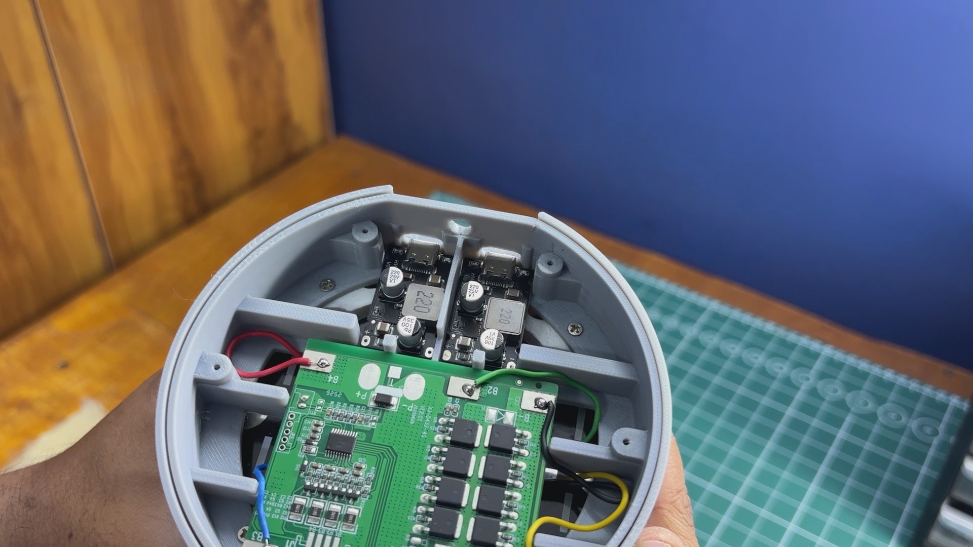

The two 65W USB-C PD modules are then installed. Thermal tape is applied beneath each module before placing it into its respective position.

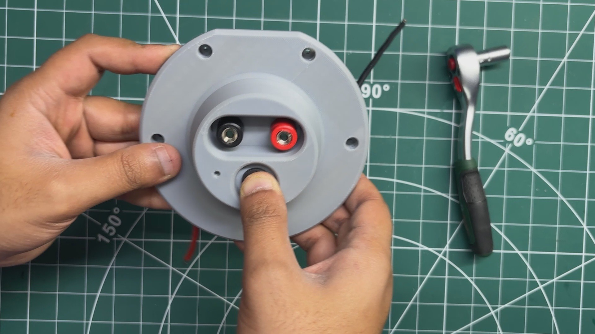

After that, the lever switch is installed just above the PD modules and secured using the supplied mounting nut.
The wiring of the PD modules is fairly straightforward. First, the VIN and GND terminals of both PD modules are connected in parallel. The combined VIN connection is then connected to the P+ terminal of the BMS.
For the negative connection, the combined GND terminals of both PD modules are connected to the COM terminal of the lever switch, while the NC terminal of the switch is connected to the P- terminal of the BMS. In other words, the switch is placed in series with the negative supply line, allowing it to connect or disconnect power to both PD modules simultaneously.
Finally, the pre-assembled top cover is connected to the battery pack by soldering the red wire from the banana connector to the P+ terminal of the BMS and the black wire to the P- terminal.
With all the wiring complete, the top cover is positioned onto the enclosure and secured using five M2.5 screws. This locks the entire assembly together and completes the final assembly of the giant Duracell battery pack.

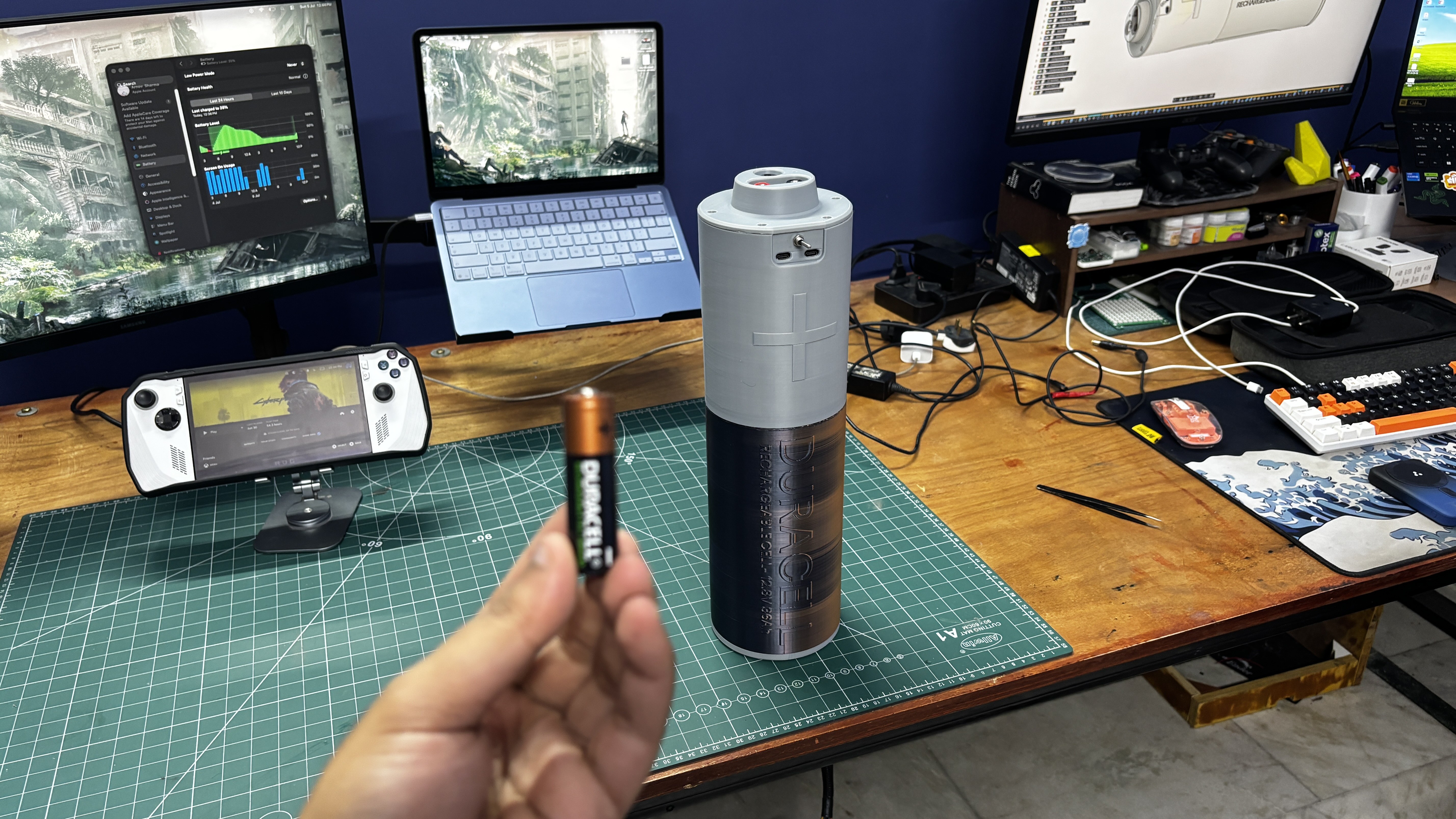

RESULT

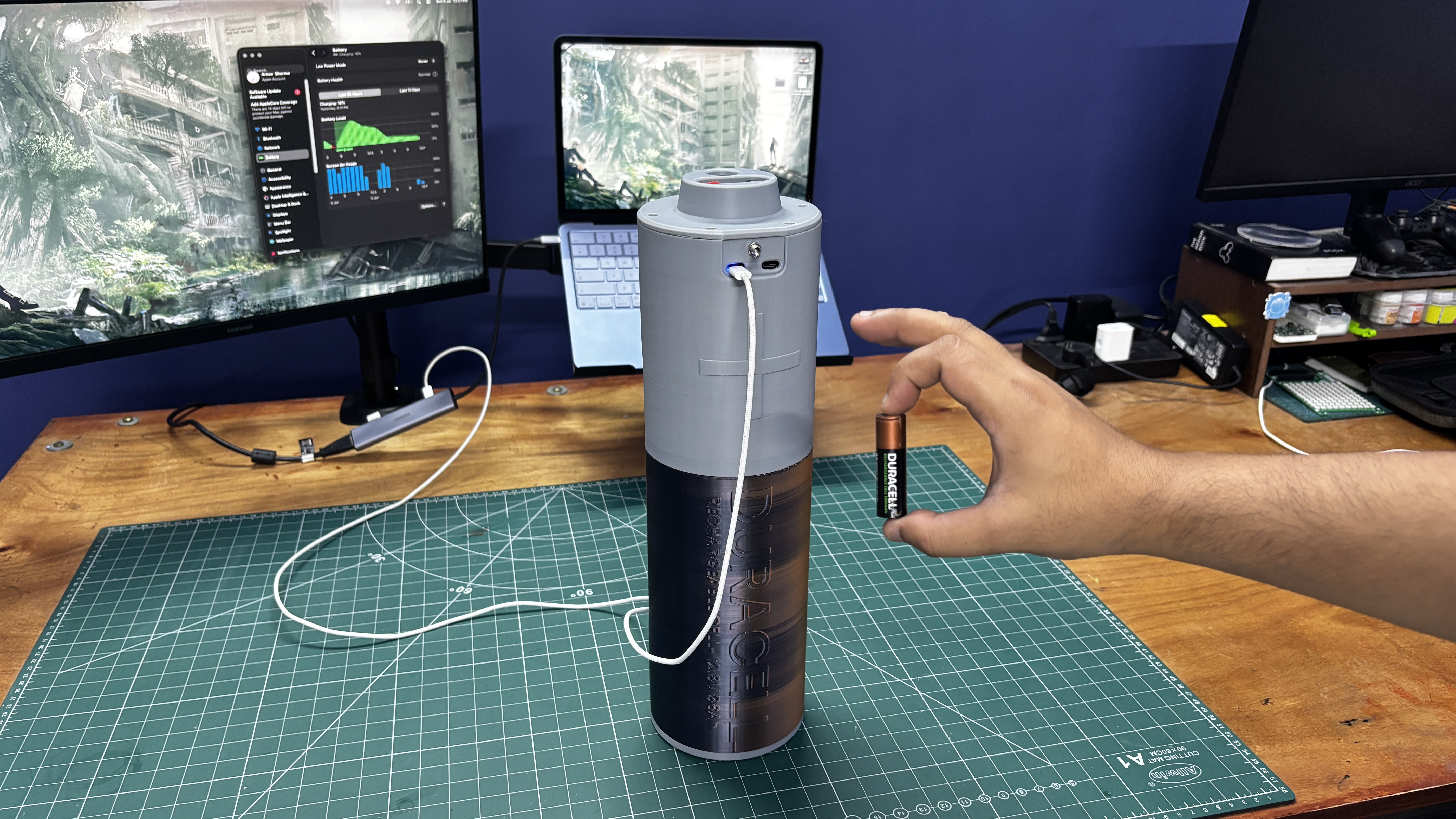

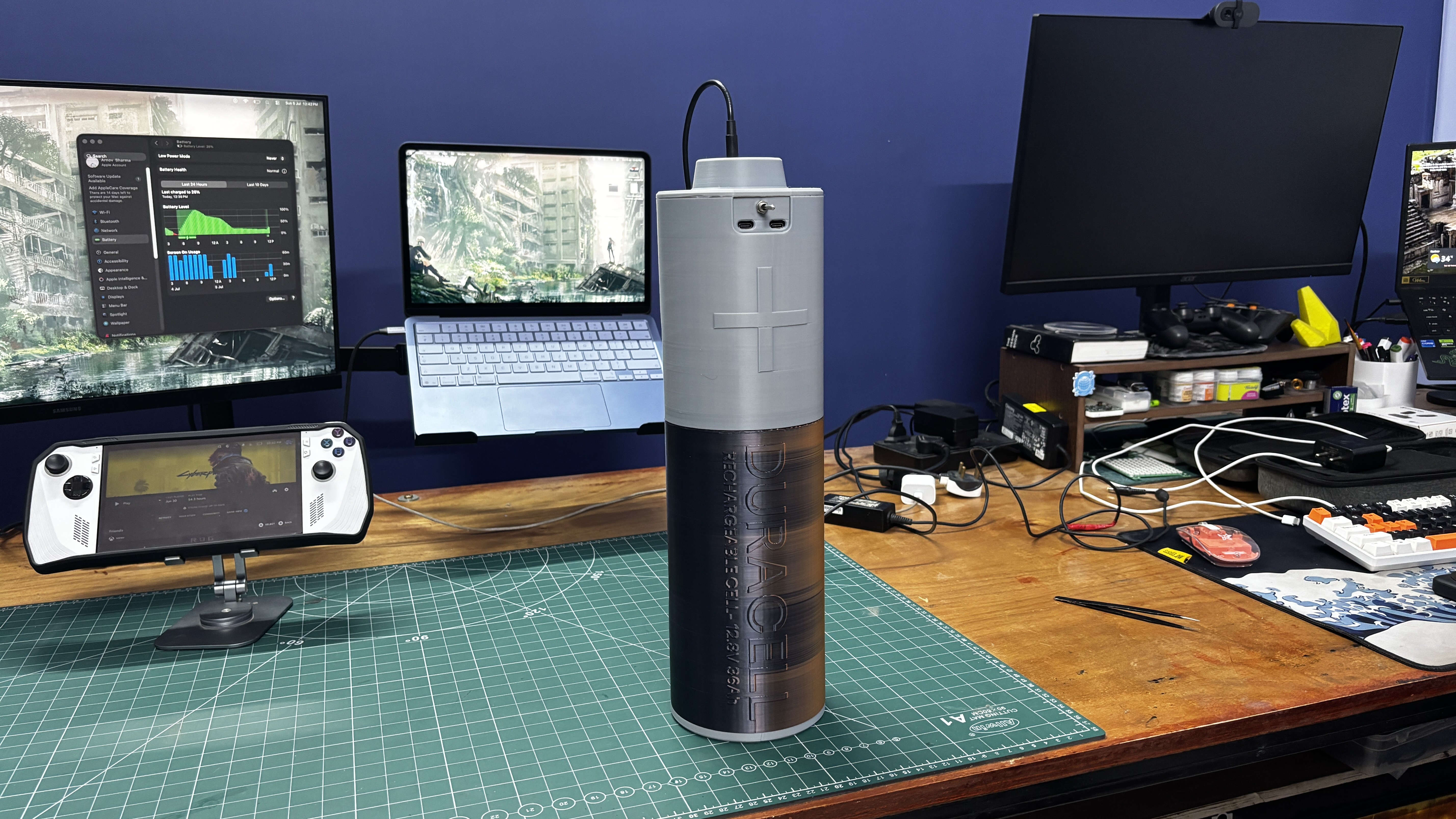

And here's the final result of this giga build—a Duracell battery that is definitely not AA-sized!
The completed battery pack weighs around 4.7kg and provides a stable 13.2V output, making it suitable for powering a wide range of 12V devices and DIY electronics projects.
Thanks to the onboard dual 65W USB-C PD modules, it can also be used as a portable power bank for charging PD-compatible devices such as smartphones, tablets, handheld gaming consoles, and even laptops.
10
WORKING DEMO

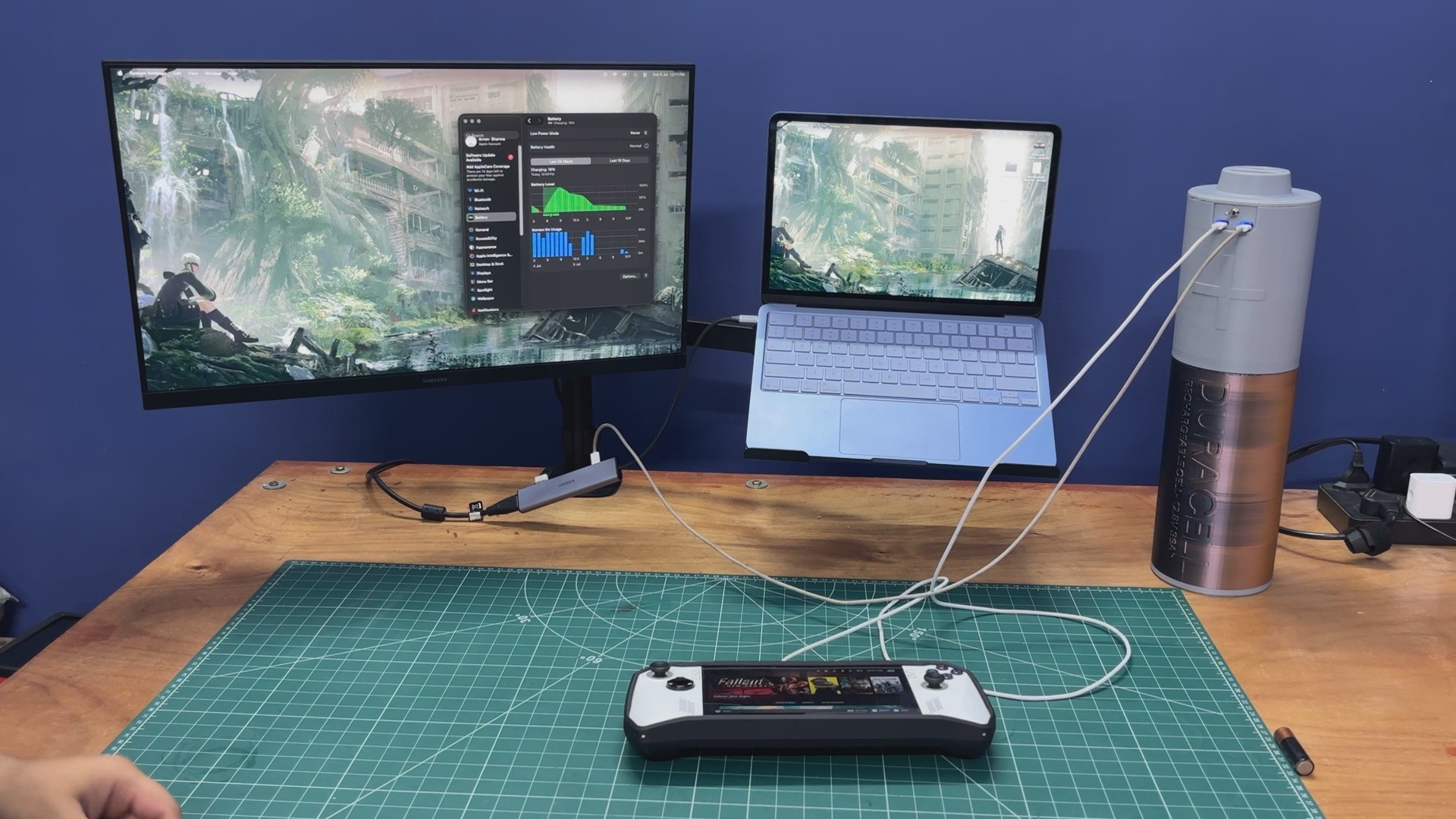

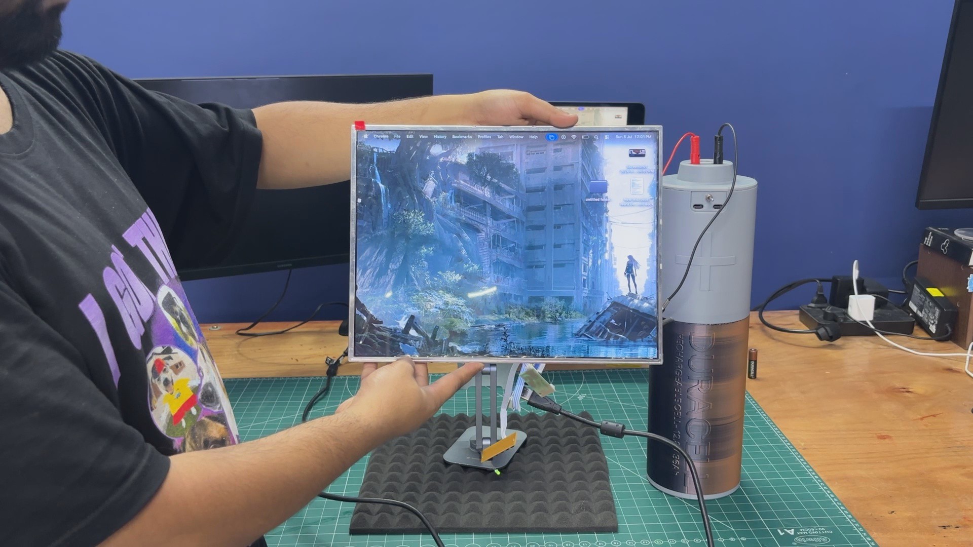

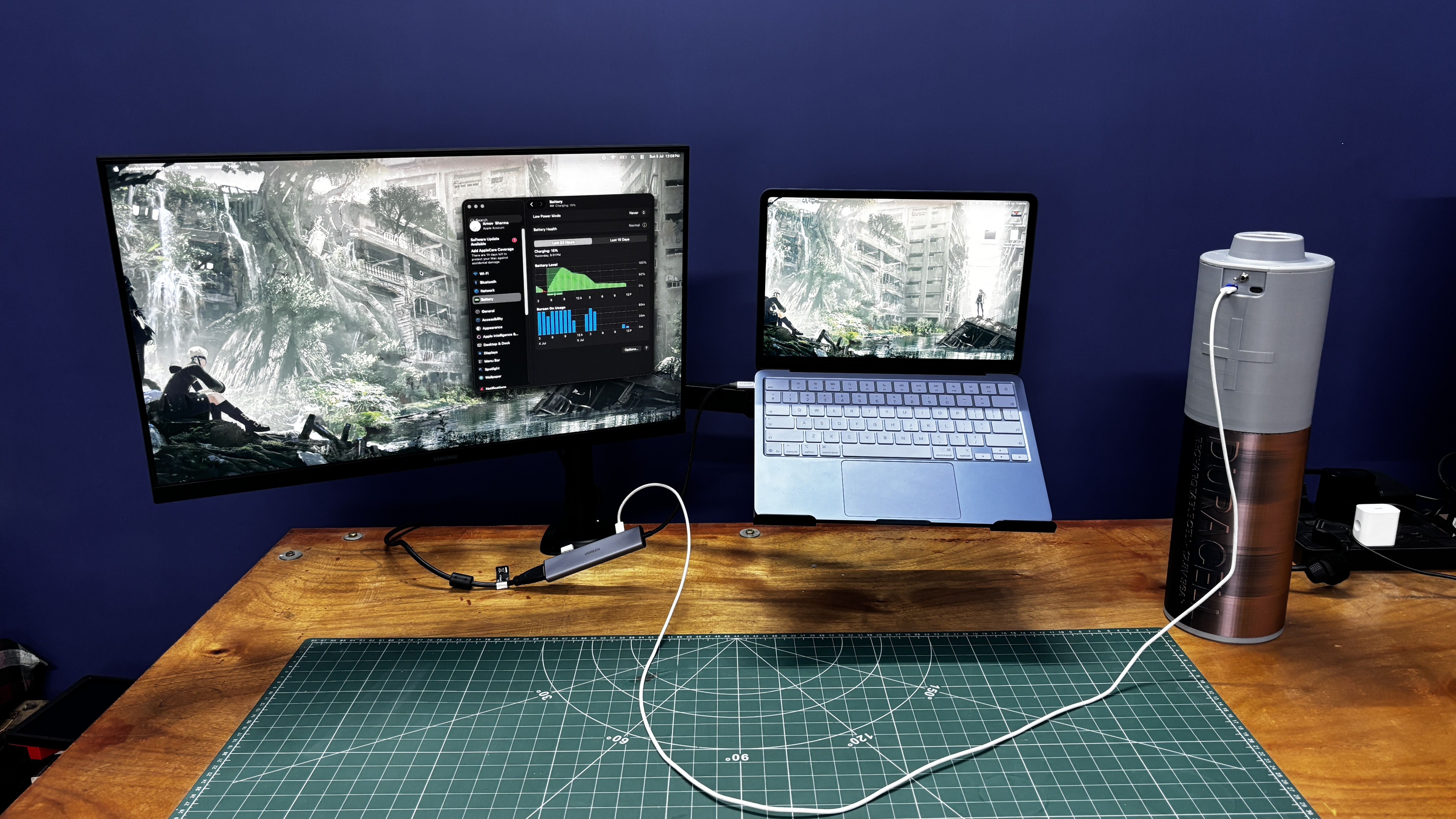

To test the battery pack in the real world, I first connected a 12V monitor that I had previously disassembled for an upcoming project. Using a pair of banana cables, I connected the monitor's driver board to the battery pack's output terminals, and the display powered on and worked perfectly.
Next, I tested the onboard USB-C PD modules by connecting my MacBook with a USB-C-to-USB-C cable. The laptop started charging immediately without any issues.
I then repeated the same test with my ROG Ally, and it also charged normally through the PD module.

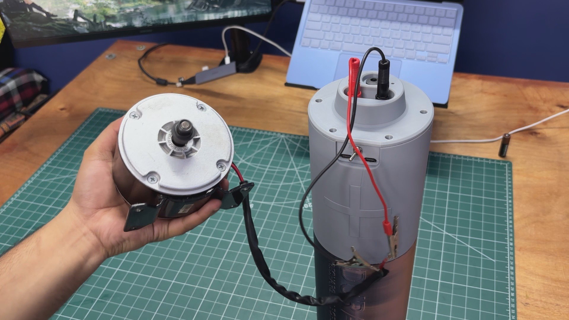

Finally, I connected a 250W e-bike motor directly to the battery pack's output. As expected, the motor ran without any problems, confirming that the battery pack can comfortably power higher-current 12V loads.
For charging the battery pack, I used a 12V 5A charger capable of delivering approximately 60W of charging power. Since the battery pack has a capacity of roughly 470Wh, a full charge takes around 8 hours with this charger.
